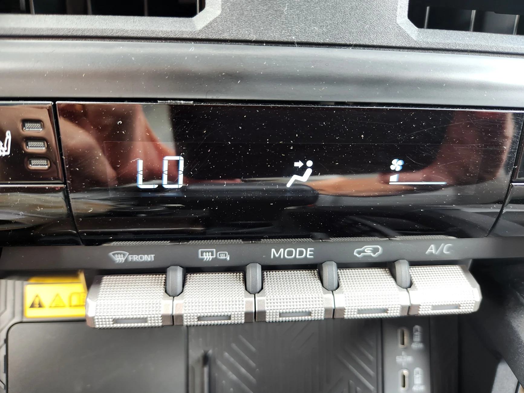

Our 2025 still blows cold air if the AC button is not lit and the vent system is turned on.
Probably normal but wondered if anybody knew the details.

That's because you have it on auto, it decides when to turn the a/c on and off, but as you probably noticed, it's blowing cold air because it's summer.

It doesn’t always display auto when the temp is higher than your setting. It’s in the manual too.

There is a setting you can configure to disable a/c on auto. I did that, as I want more control over when a/c runs. Set that to see if that changes the behavior.

Auto is displayed when in that setting. It is not in auto.
Anytime you manually override any function (like manually changing the fan speed) the "Auto" light turns off because the system isn't in full control. However all other functions will still be automatically controlled like the A/C. Secondly, setting the temperature to "LO" will automatically engage the A/C because "LO" is the systems lowest temperature output, meaning as cold as it can get.
