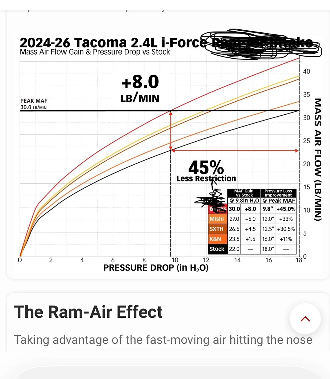

Is this legitimate information?
I'd say it's mix of good and “depends how they got it.”
Using inches of water (inH₂O) for pressure drop is solid. That’s a standard way to measure restriction across an intake, so that part of the data is meaningful.
If that airflow was measured with a calibrated flow bench or an external device (like an anemometer setup)then it’s real airflow data.
If it’s coming from the vehicle’s MAF, then it’s only as accurate as the calibration. Change the intake, change the MAF housing or flow characteristics, and now you’ve potentially changed how the sensor reports airflow, not necessarily how much air is actually moving.
You can end up with charts showing “more airflow” when in reality you may just be seeing a shift in how it’s being measured.
Pressure drop = good, real data
Airflow = only valid if you know how it was measured
We all know that Banks is a long-standing U.S. company and they have great engineers and a real test facility. While I want to have high confidence in this graph, the engineer in me still wants to know how the air flow data was collected.
