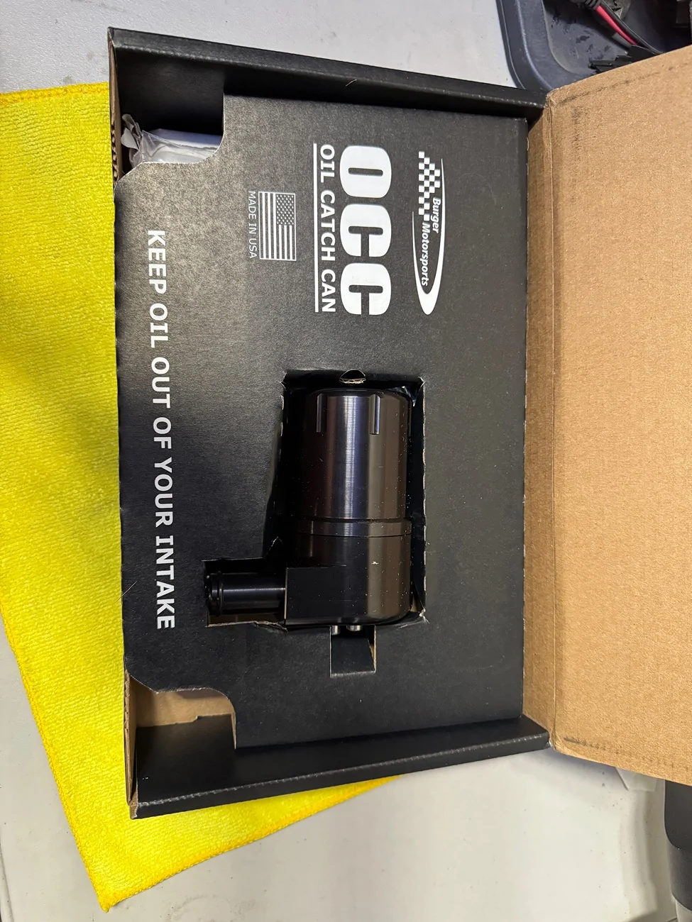

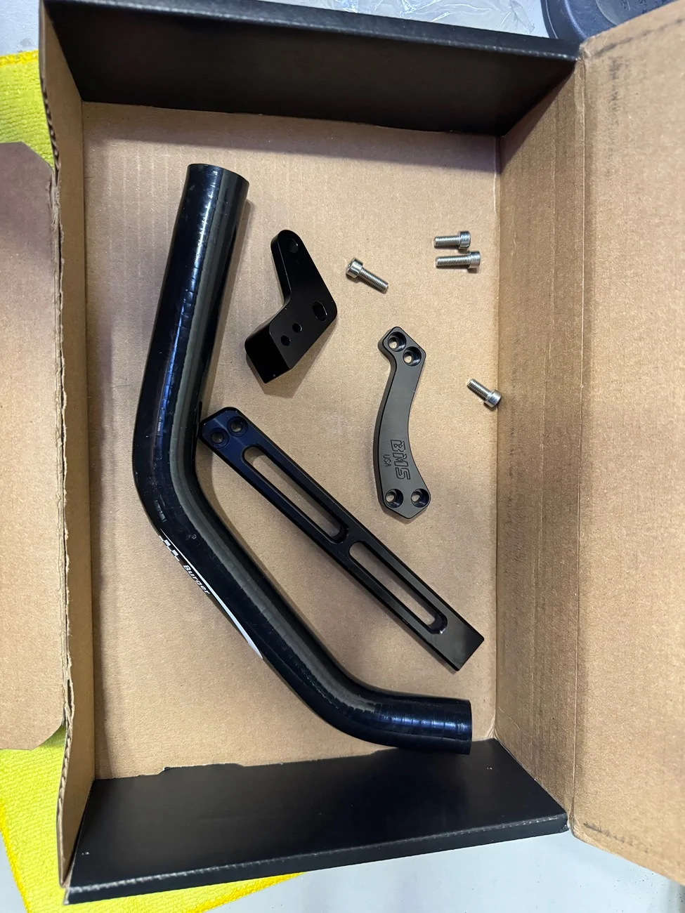

Open the Box of Mystery!
2025 2026 4runner 6th gen Burger Motorsports / JB4 Oil Catch Can - install & review 1776306161219-yh
Above:
Make sure all your parts are present !

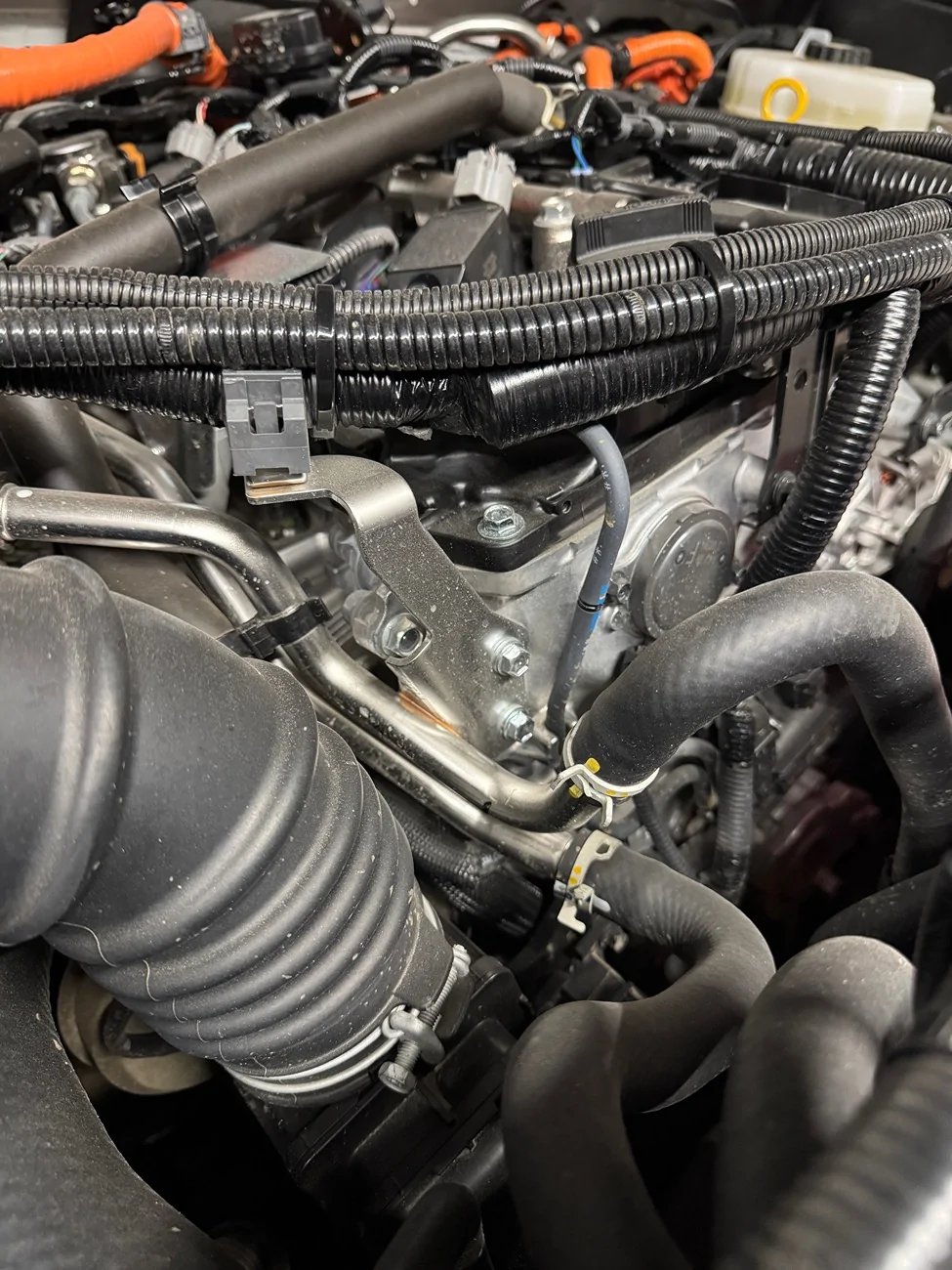

Locate your work area!
Above : Remove the 2 10mm Bolts!

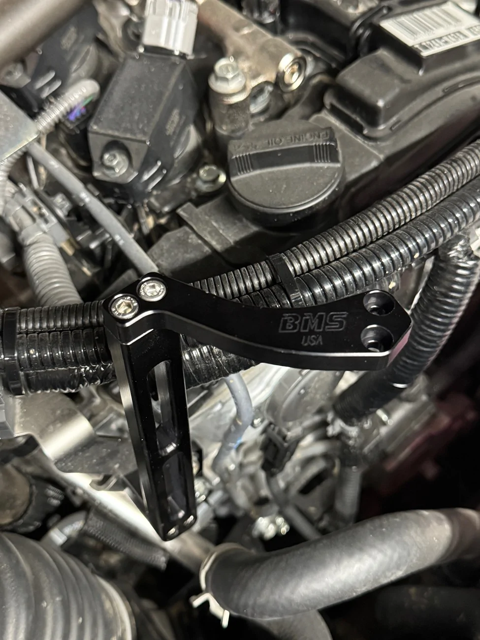

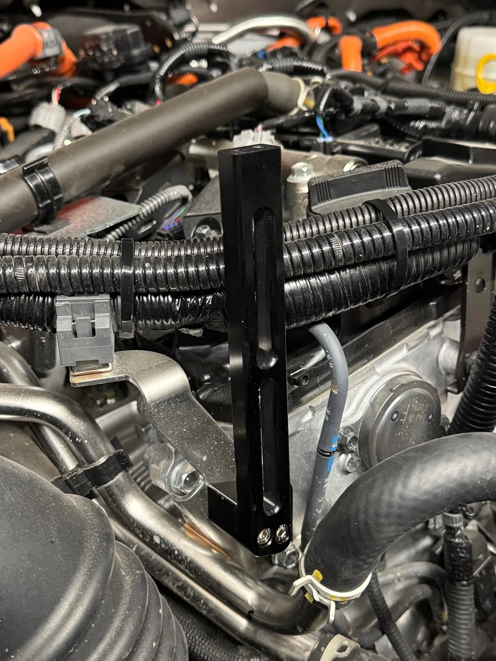

Next attach the Oil Catch Can Mount to the Riser!
Above:

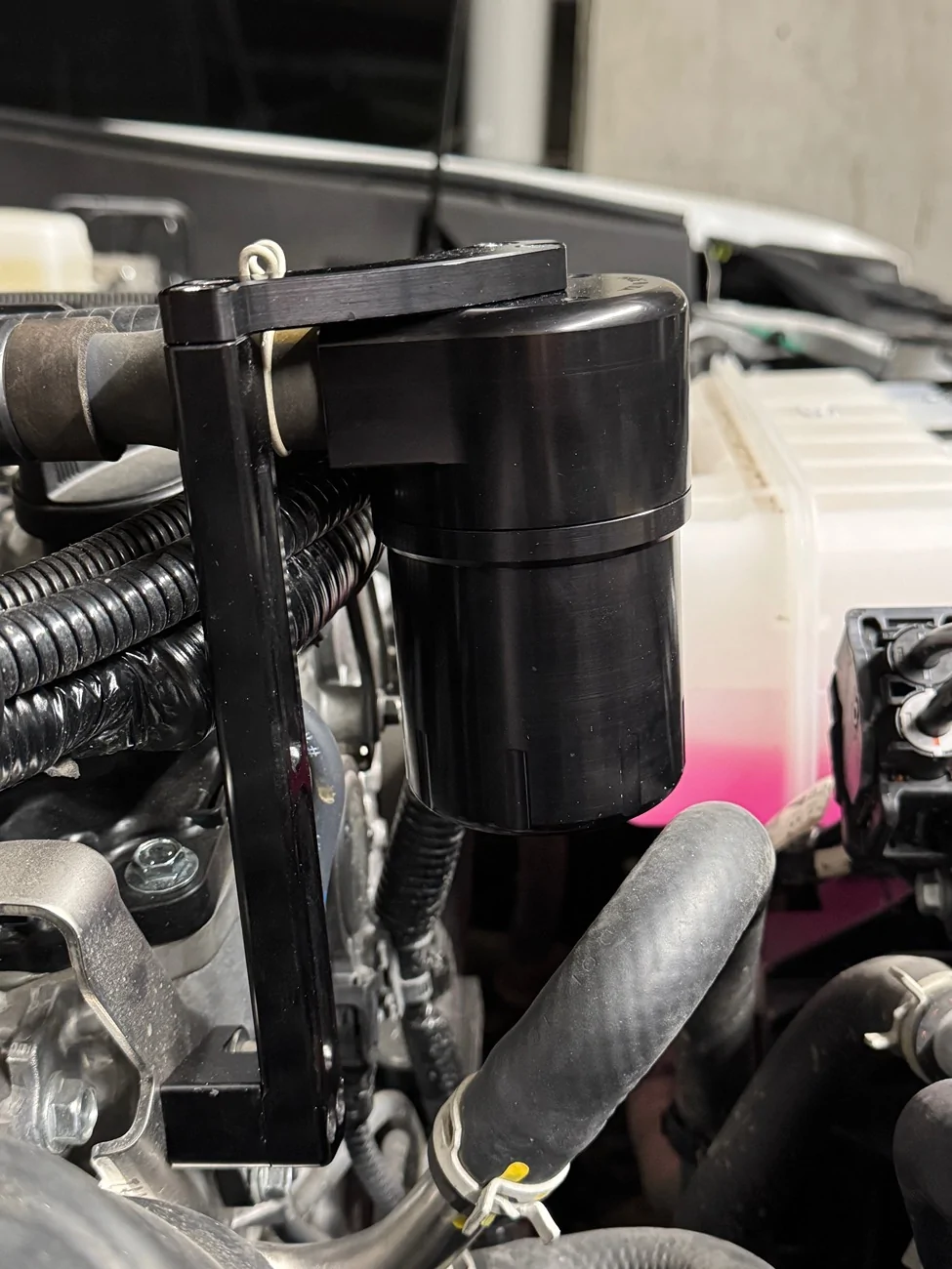

Mount the Oil Catch Can to the Riser!
Above:

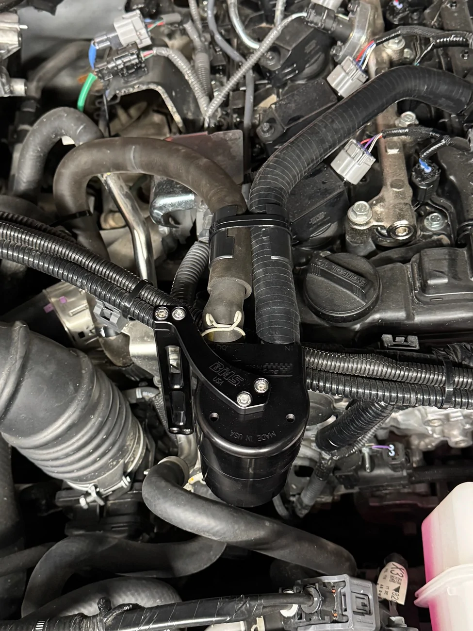

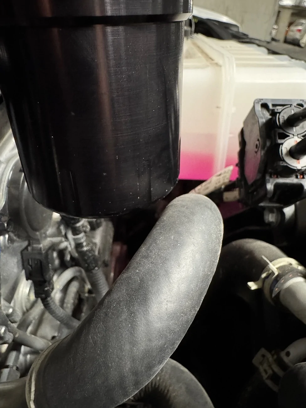

Relocate the Original Hose to the left Oil Catch Can inlet, use the Burger Motorsports hose to the Original inlet on the Engine and the other side to the Oil Catch Can!
Below:
Now gently Pull back slightly on this hose to the forward of the engine bay to avoid any rubbing!
All done!
Just check the catch can every once in a while and empty and clean every Oil Change!
This install was very simple and took basic knowledge to perform.
We choose Burger Motorsports Catch Can because it had the the shortest hoses and this is critical for it to work well.
Hope this helps you all make the right choices for your 4Runner!
