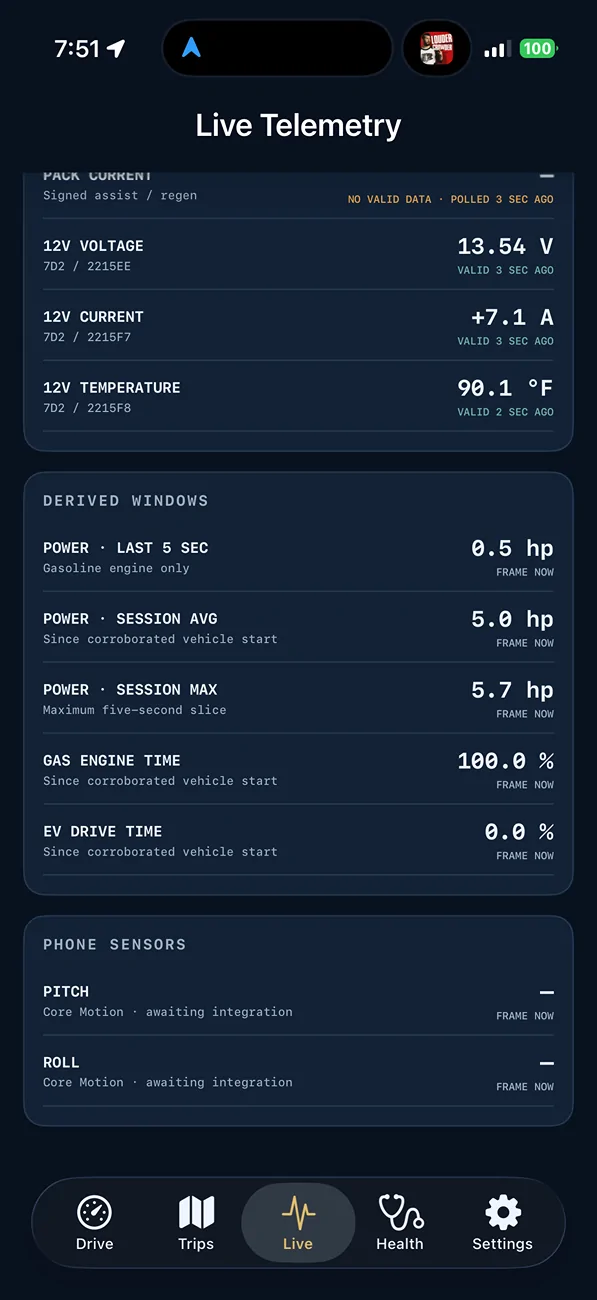

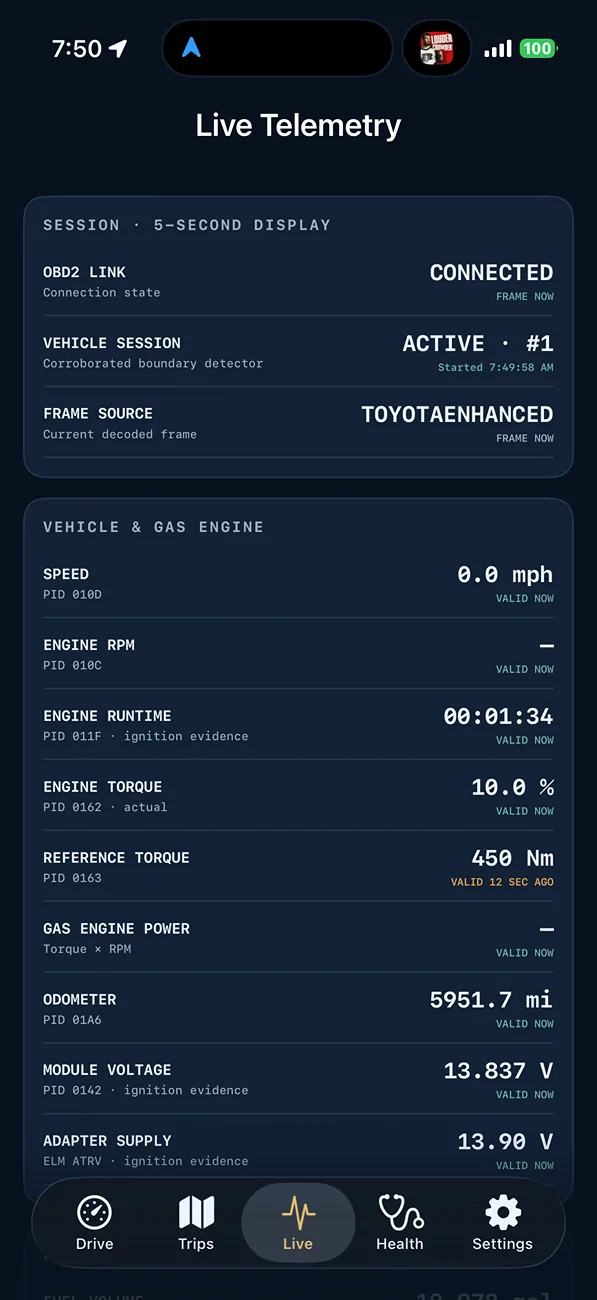

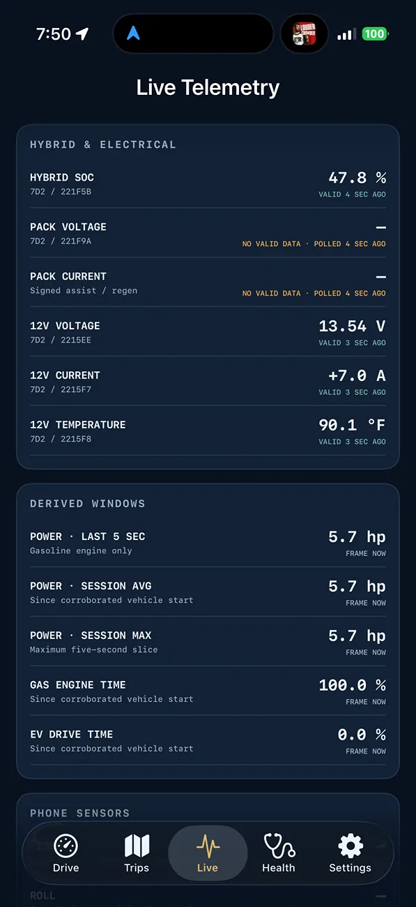

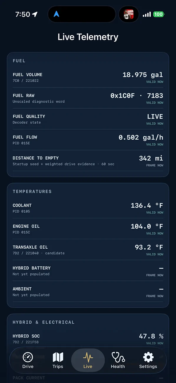

Did a bunch of testing/PID Sniffing last night and here is all the data I can currently capture from the ODB2
I will continue to "sniff" out the other items, right now I am working diligently to find the Roll/Pitch info. At minimum I can use the iOS devices accelerometer and pipe that data into the app. I will b using the Altimeter of the iOS device to capture altitude for the overloading page.
Let me know if there is something missing you would like to have added and I will see what I can do.

I'm not sure how Toyota does it. It's a mystery to me. But what I'm going to be doing is a one-minute running average based on the fuel flow and the total fuel in the tank and then also taking into account the EV portion of it so that over any one minute in time you'll have a fairly accurate distance to empty. Obviously if you accelerate past a truck or something, I didn't want it to shoot up and shoot down, so I'm trying to give a running average over the period of time,
