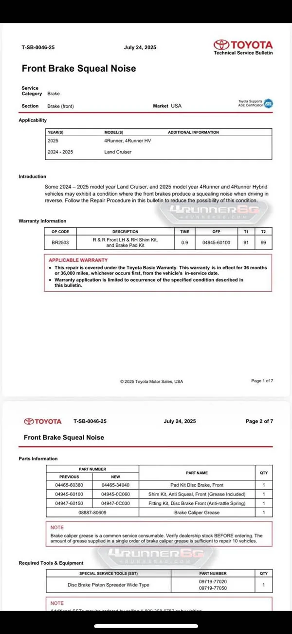

Toyota Technical Service Bulletin – T-SB-0046-25
Date:
July 24, 2025
Title: Front Brake Squeal Noise
Service Category: Brake
Section: Brake (Front)
Market: USA
Applicability
Year(s):
  • 2025: 4Runner, 4Runner HV
  • 2024–2025: Land Cruiser
Introduction
Some 2024–2025 model year Land Cruiser, and 2025 model year 4Runner and 4Runner Hybrid vehicles may exhibit a condition where the front brakes produce a squealing noise when driving in reverse. Follow the Repair Procedure in this bulletin to reduce the possibility of this condition.
Warranty Information
OP CODEDESCRIPTIONTIMEOFPT1T2
BR2503R & R Front LH & RH Shim Kit, and Brake Pad Kit0.904945-601009199
Applicable Warranty Notes:
  • This repair is covered under the Toyota Basic Warranty.
  • This warranty is in effect for 36 months or 36,000 miles, whichever occurs first, from the vehicle’s in-service date.
  • Warranty application is limited to the occurrence of the specified condition described in this bulletin.
Parts Information
PREVIOUS PART NUMBERNEW PART NUMBERPART NAMEQTY
04465-6038004465-34040Pad Kit Disc Brake, Front1
04945-6010004945-0C060Shim Kit, Anti Squeal, Front (Grease Included)1
04947-6015004947-0C030Fitting Kit, Disc Brake Front (Anti-rattle Spring)1
08887-80609Brake Caliper Grease1
Note:
Brake caliper grease is a common service consumable. Verify dealership stock before ordering. The amount of grease supplied in a single order is sufficient to repair 10 vehicles.
Required Tools & Equipment
SPECIAL SERVICE TOOLS (SST)PART NUMBERQTY
Disc Brake Piston Spreader Wide09719-77020 / 09719-770501
Note:
Additional SSTs must be ordered by calling 1-800-933-8335 if unavailable.
Original Document:
2025 2026 4runner 6th gen Front Brake Squeal Noise Fix - official TSB brakes fix! (TSB-0046-25) brake-squeal-noise-tsb-fix

I just happened to be at the dealership today and mentioned this TSB. Unfortunately the parts are on back order, but I have an appointment later this month to hopefully address the noise.

Just be warned the back order of parts has no estimated date for when parts will make it in. They will order them for you but won’t be able to estimate when the fix will be able to take place
Good to know. I'll look into getting an oder in quickly. Hopefully my area has some.

If I were you, drive on your current ones a dn wait so you can get brand new pads right before your warranty is up.
I’m just curious to see if this actually fixes the issue or if it happens again. If it’s the latter, I will absolutely wait 30k miles to have fresh pads put on.
Yup, they just estimated the time for me, if they’re not in- no biggie.

For sure. Me Too. Personally, I think some models got the wrong shims or the batch of shims that were installed on some models were simply too long. Couple that with maybe forgetting a bit of grease, and you get the squeal. Once they put the correct shims on with a bit of grease, you won't have the problem again.
If you order the parts by yourself and replace them yourselves and properly grease them, it will cost you like $20 in shims and grease, and when the time comes down the road, go get new brakes right before you hit 3yrs or 36K. ;)

Took mine in today to get inspected for the TSB and when I came back they said they surprisingly had all the parts in stock and were able to replace everything today! God is good!🙏🏽🙏🏽🙏🏽

Mine only squeals in reverse when the vehicle is cold. Called my closest dealer and was told my VIN was not listed for the TSB repair. Huh? I didn't want to leave my daily drive there for a couple days for them to figure it out.
Mine did the same thing and I explained to them the TSB states all 2025 4Runners that are having the issues of squealing in reverse had to explain to them that I had the TSB in front of me could send it to them to see and after telling them that the all of a sudden found it. They told me to take it in for inspection and replaced all parts today.
