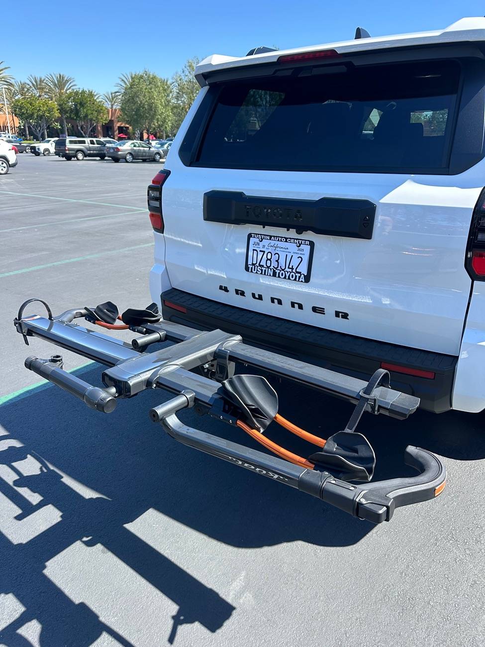

No issues with my 1Up rack! This is the last bike rack you’ll ever need, all aluminum construction and no plastic. Looks great on the new SR5, though I wish I spent the extra $50 to get a black 1UP at the time. The back up camera is definitely a little obstructed compared to my previous vehicle that had an aftermarket hitch.
Nice Yeti

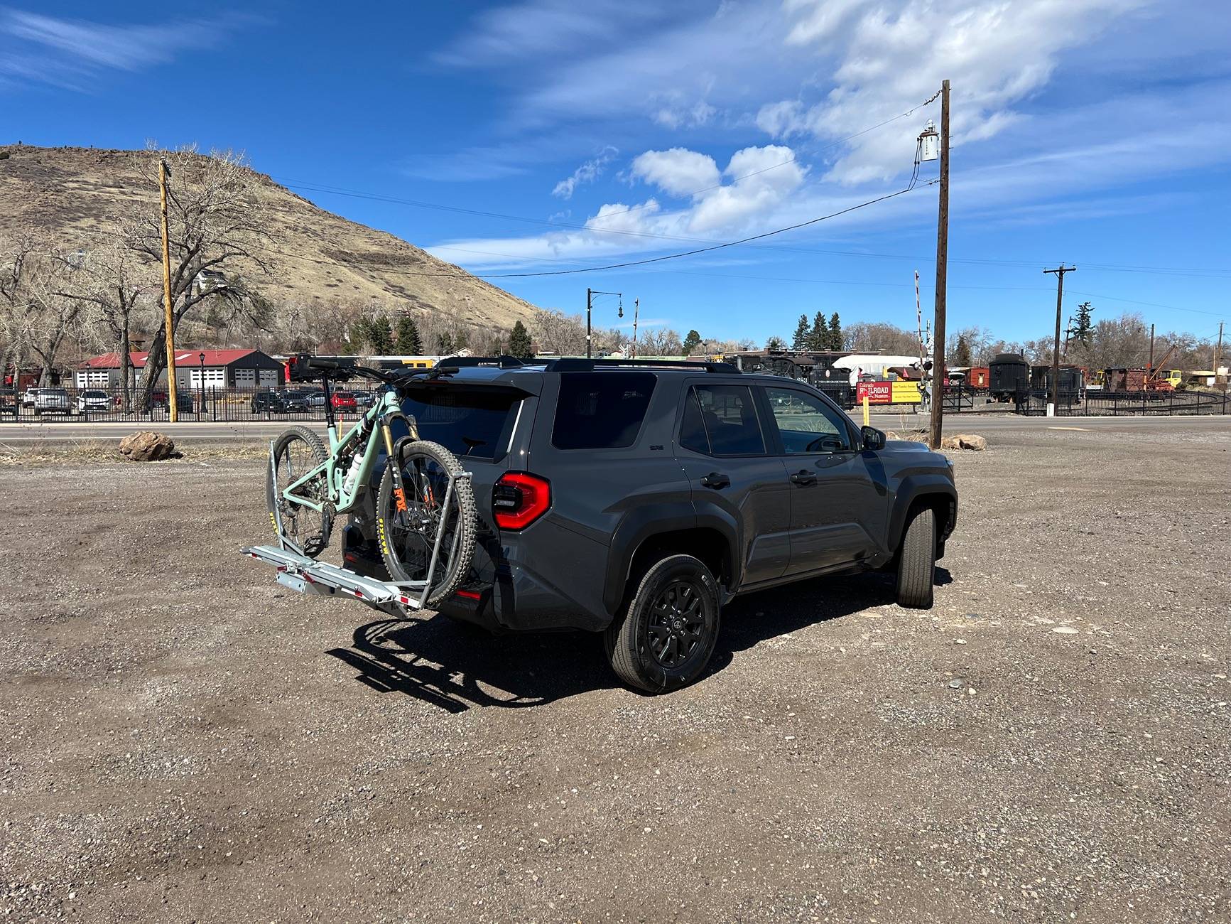

Here is ours! Kuat NV Base 2.0. This rack gets constant use (this is from a race this past weekend).
The automatic braking was obnoxious until we turned it off, and it is a little frustrating that the trunk cant be opened while the rack is on and folded up. May eventually get a small extender to avoid that issue (but the rear window helps!)

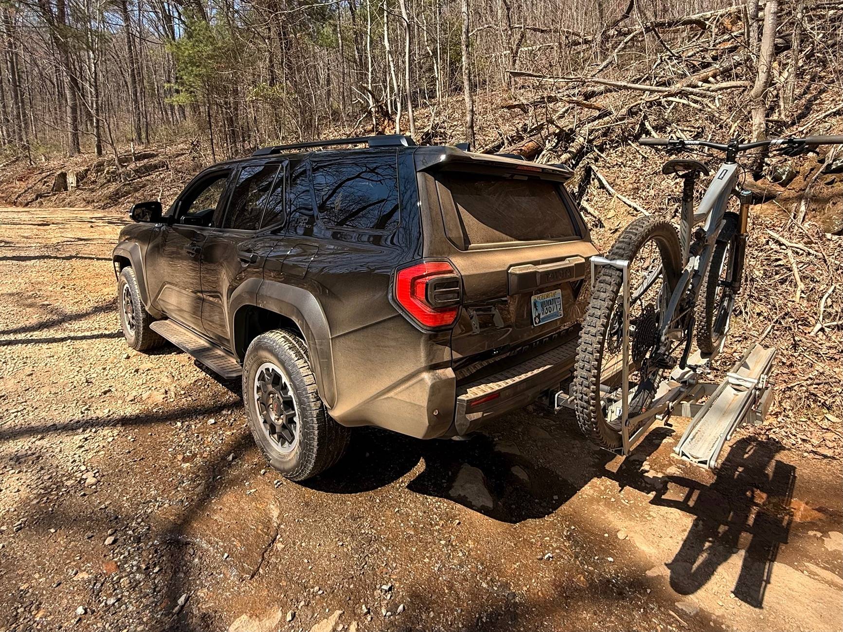

I finally took delivery of my 6G and put on a Kuat swing out and 1up rack. Works fine. I selected “yes” when auto trailer detection was prompted. This lets the front parking sensors work when the rear parking sensors are disabled. If you simply disable the parking sensors yourself, Toyota doesn’t provide the ability to disable front/rear independently.
My only complaint is the annoying warning message that the PKSB is disabled and the tow mode is enabled.
Toyota should have a bike rack mode with less warnings on the dash.

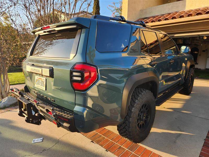

I have a 1UP USA single tray Rack. I can adjust how far it slides into the hitch receiver to have it just clear the back hatch in the up position. Only trouble I ran into was finding a hitch pin that was thin enough to pass through both the hitch receiver and the the part of the rack that slides into it. Wound up using the longer hitch pin by 1up but had to use foam tubing to cushion the excess length to prevent rattling. All in all, I'm happy with the set up.
