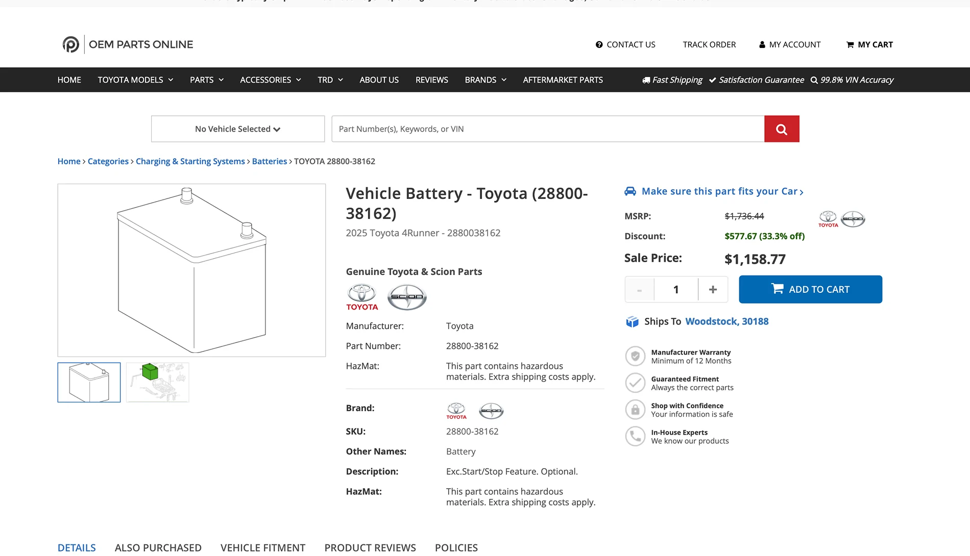

I searched for a Toyota OEM battery for the 4R and got a "discount price" of $1,158.77. Really!!! I saw this at a few online Toyota dealers!
Calling a few dealer parts department got me a price of $207.36. This was for a Toyota OEM Trustart battery. The part numbers do not match the original battery installed.

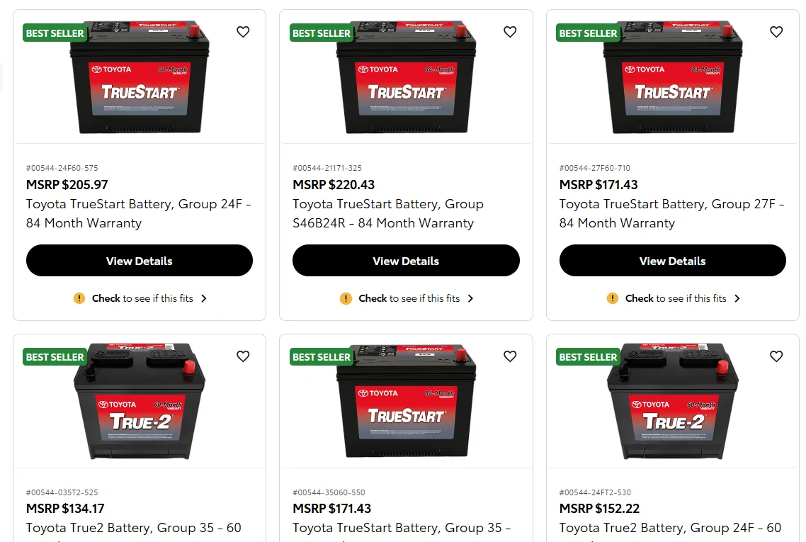

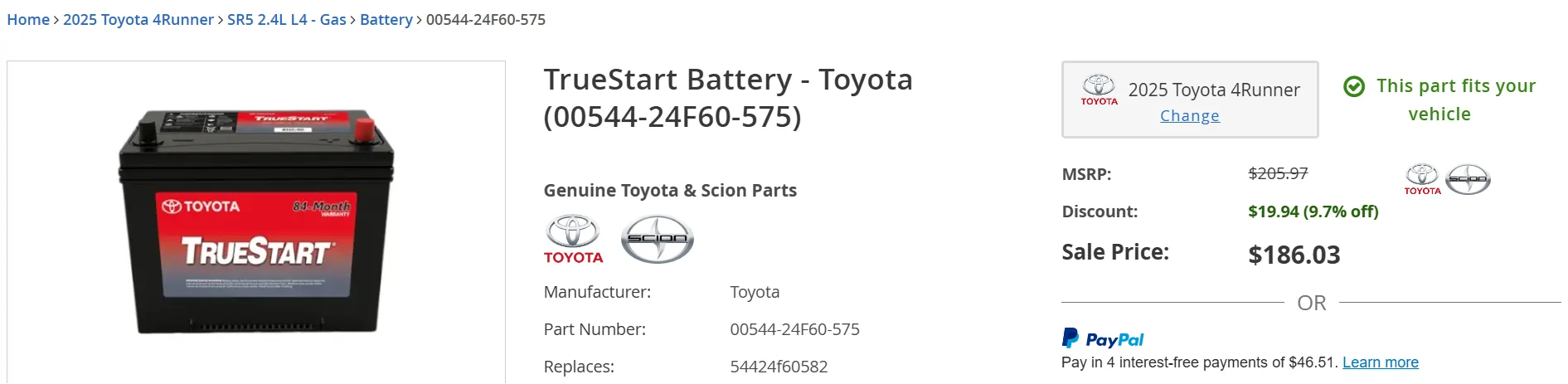

Specifically a dealer has this

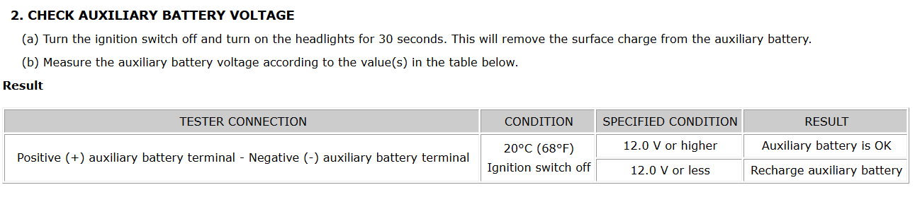

Thought I would give an update on my 4Runner platinum model with iforce max engine. After another look at the battery (no visible manufacturer name) by rocking the rear end of the 4r hard I could see the water level in the battery.. What I thought was the water level were the plates inside different height's? ..Ok water level ok. Now Fluke volt Meter reading 12.1 volts! To me that's low right! I now think this is a normal reading because the engine does not have a standard alternator with voltage regulator to charge 12 volts battery. The hybrid system is used to keep the 12 volt battery charged. It's all done electronically and it's quite possible that the charge rate could be closer to 12 volts then standard alternators trying to maintain 12.5 to 12.9 volts. I will be periodically checking it now and have cancelled my appointment with Toyota dealer tomorrow.

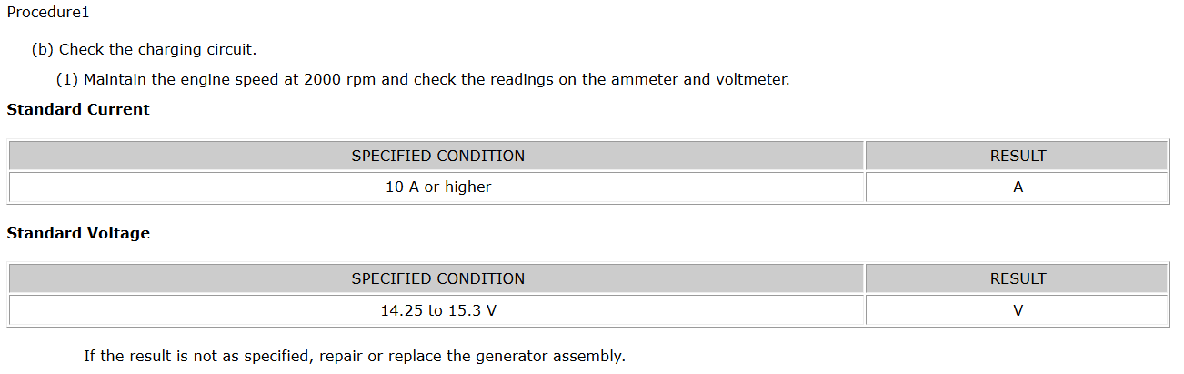

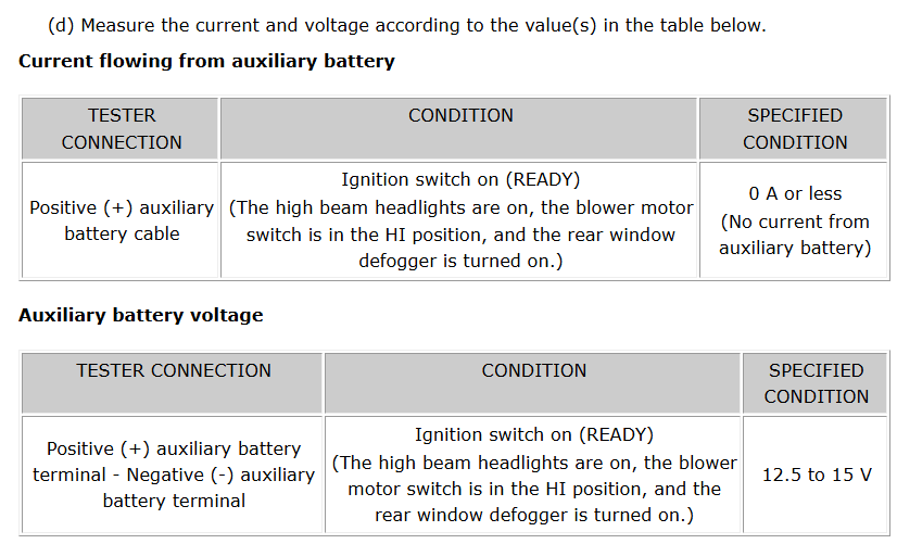

Hybrid aux battery (12v for vehicle electronics and settings)
2025 2026 4runner 6th gen Battery for 2025 SR5 - Toyota Parts Online quoting $1158.77 1782398222140-p4
Unlike other hybrids, this does have an alternator
testing battery with alternator charging (ICE on)
2025 2026 4runner 6th gen Battery for 2025 SR5 - Toyota Parts Online quoting $1158.77 1782398418696-bx
Testing battery with hybrid dc/dc inverter charging (ICE off)
2025 2026 4runner 6th gen Battery for 2025 SR5 - Toyota Parts Online quoting $1158.77 1782398503628-nu
