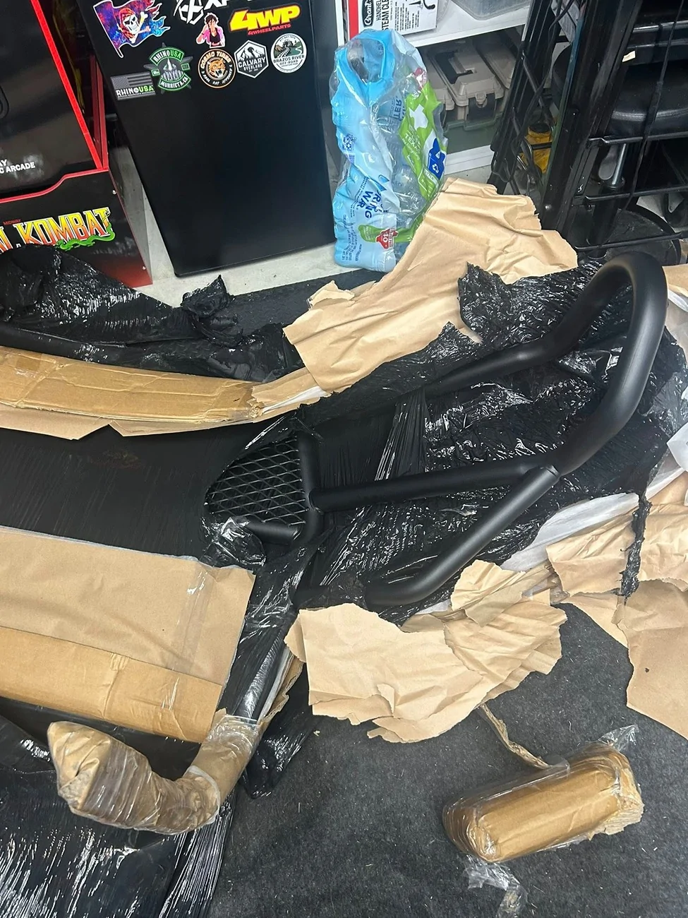

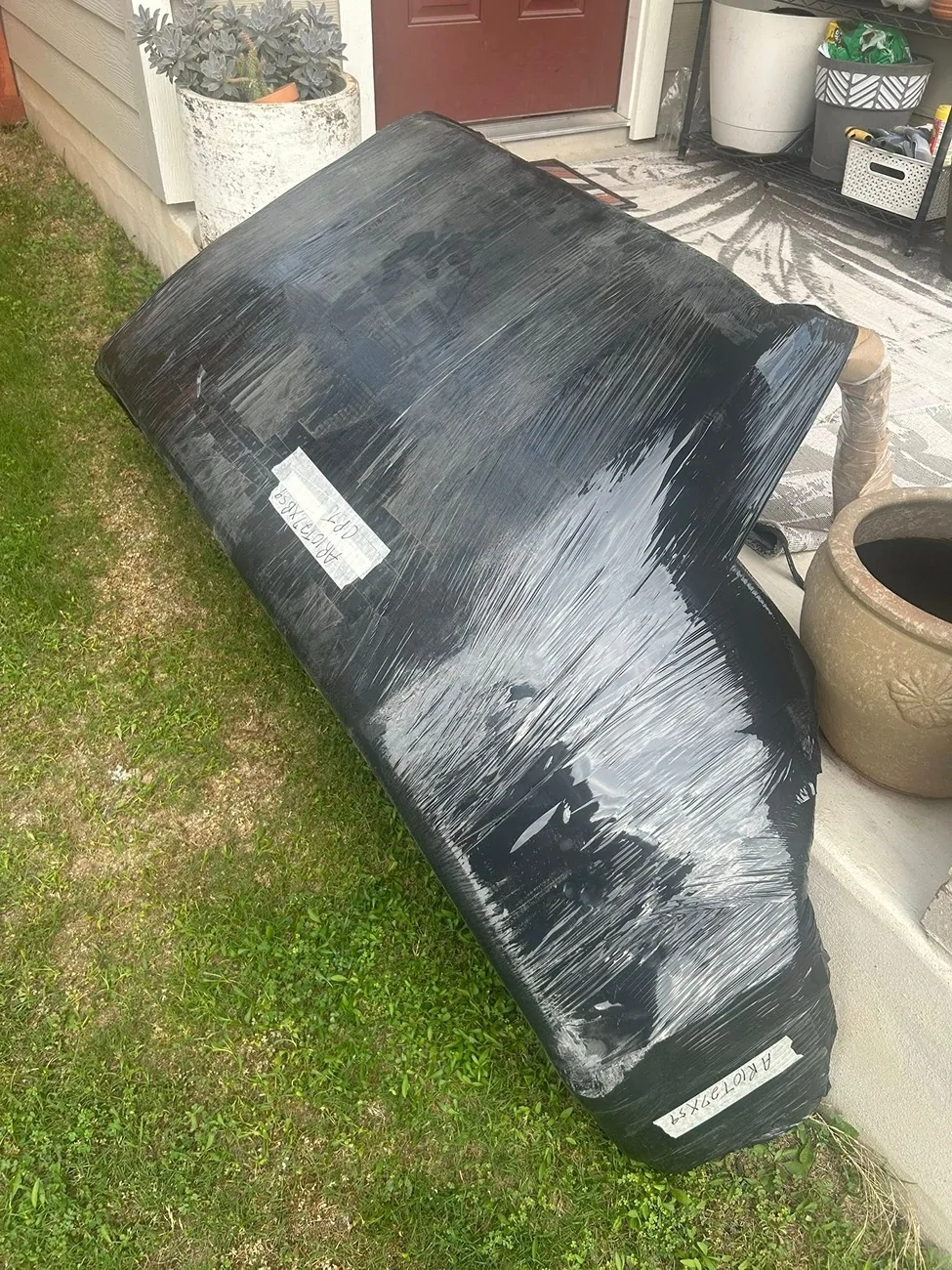

First of all, the order and shipping were reasonable and easy, (Granted I'm also in Texas so experience may vary.)
Took a week or so for the manufacturing process and just a few days to ship.
Brush guard was extremely well packaged, they could've drug it here behind the truck and it would've been fine.

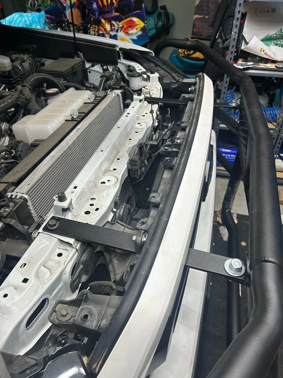

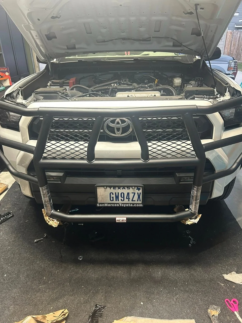

The build itself feels quality and install takes less than an hour or so. (Its definitely not some cheap thin metal junk like you see a lot of on ebay) Did it by myself except for just needing my wife to help me hold it at the top until I got the bottom bolts started.
Bottom bolts on to right where the tow hooks are, just take the bolts out of there, remove the hooks, put this on.
You COULD stop there, it's plenty solid without the upper mount, but I went ahead and did the top as well:
2025 2026 4runner 6th gen Arc-Rite Grille/Brush Guard install on 25 SR5 706650496_26878334101834935_6079864471062688368_n
The plastic cover that goes here comes off very easy. (Shoutout to Toyota for making plastic clips that don't immediately disintegrate when you remove them.)
It does go back on afterwards, just had to trim a bit on the under side to clear the right bracket.
And that's it, easy money installation.

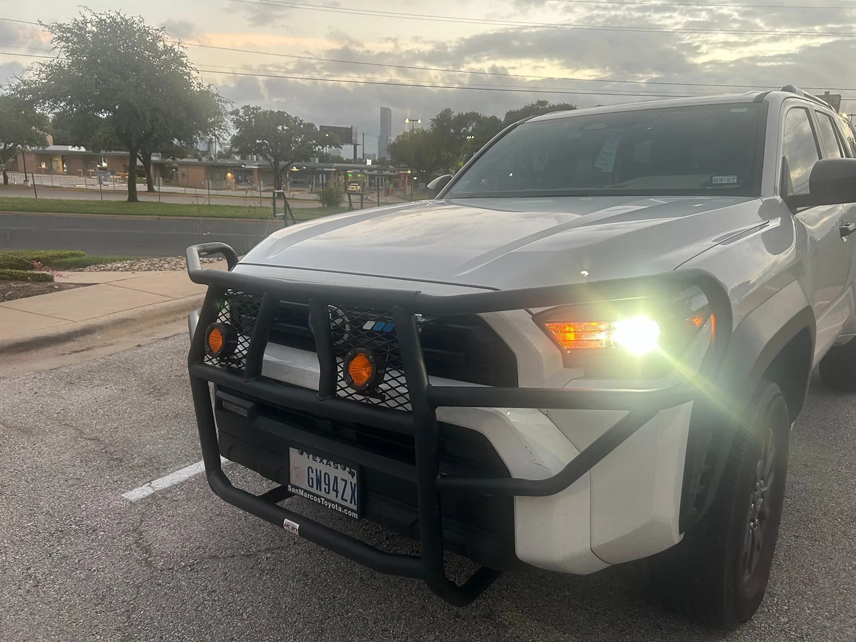

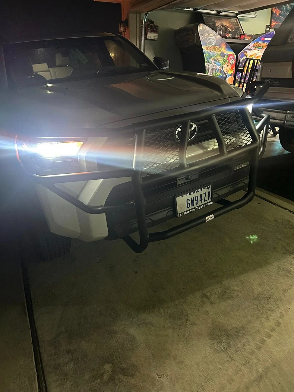

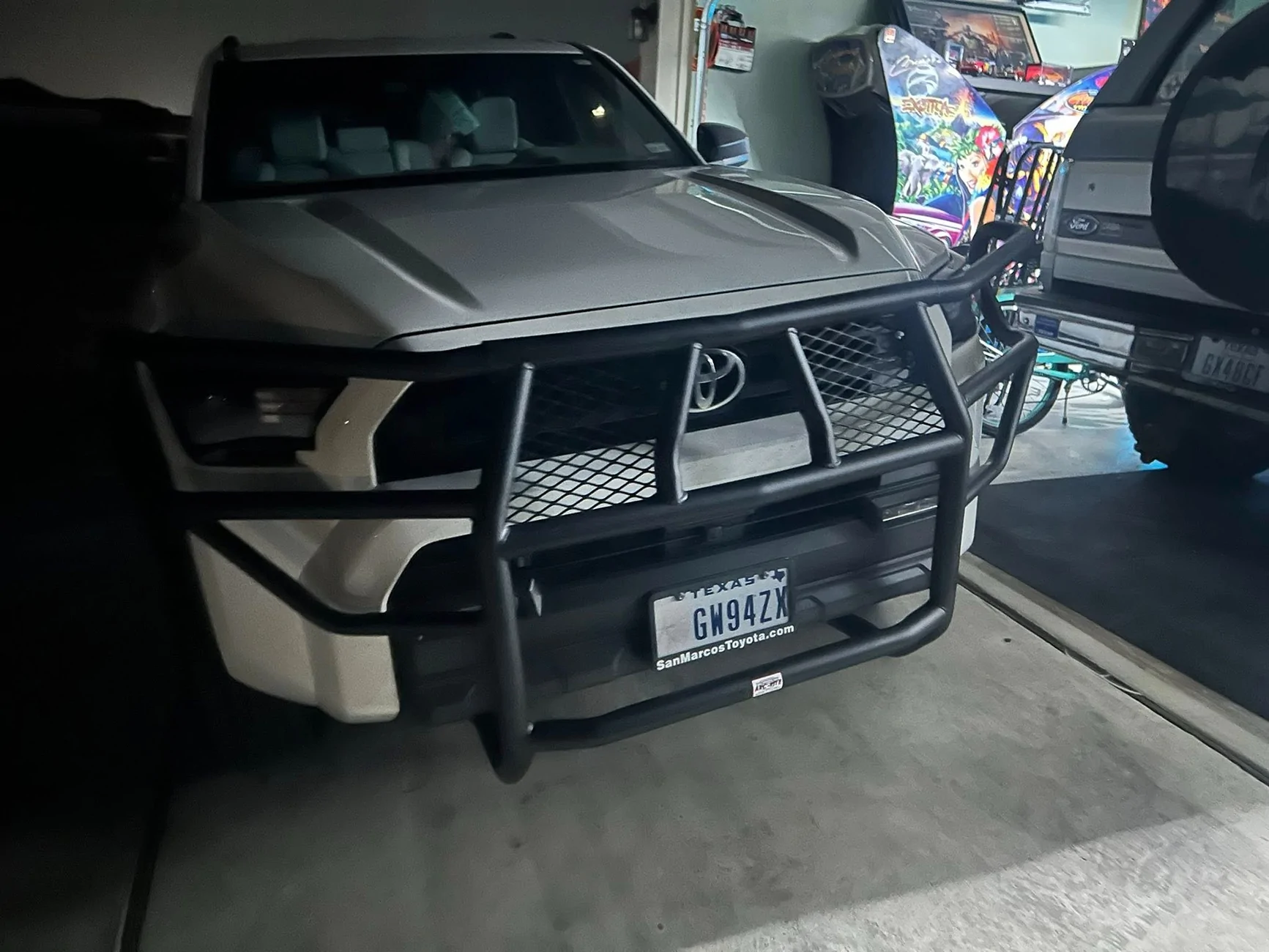

Would I use it to push cars out of the way? No, but will it protect the front of your 4Runner from brush and the like? yes.
2025 2026 4runner 6th gen Arc-Rite Grille/Brush Guard install on 25 SR5 706035948_26878333755168303_6687218570214503426_n
2025 2026 4runner 6th gen Arc-Rite Grille/Brush Guard install on 25 SR5 706078219_26878333171835028_3185507779279548698_n
I also later added some extra fog lights to it using these brackets: (it does not from manufacturing have light mounting holes).

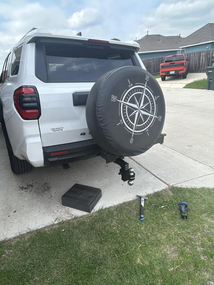

Plus bonus Photo of the rear spare tire rack:
2025 2026 4runner 6th gen Arc-Rite Grille/Brush Guard install on 25 SR5 708376647_26878712151797130_2867394715354057360_n

bracing the top of the guard into the front grill/radiator support is wild... I've never seen that for obvious reasons.

So mine doesn't have the parking sensors being an SR5, but no warning messages or intereference with the adaptive cruise.
well dont expect much for bracing due to how thin that support bar is outside of brushes and what not.
might survive a lite tap in a parking lot but not much more.
