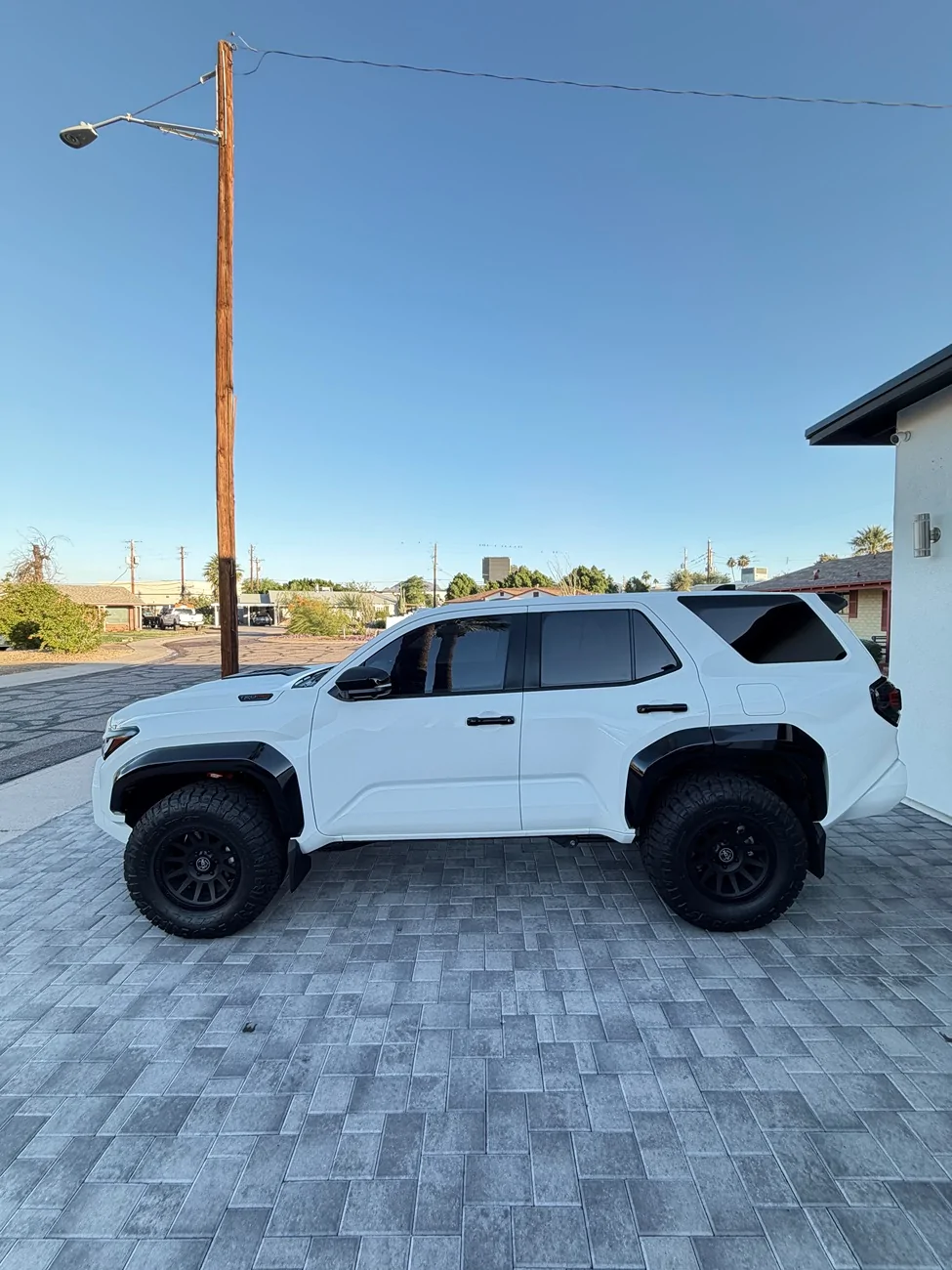

Took it off if you are in AZ I will sell it you.. to me the roofline looks better with it off.

Piece of cake. Toughest part was lifting it off the roof myself. Pit some anchor points into garage Ceiling and used lift straps raising it 4 Inches and then drove out from underneath it.
Took about ten minutes to cover up the tracks with toyota Track parts
Agree lifting it off without scratching the roof or side of the truck is the hardest part. Two people can do it using a blanket to slide the rack on the roof. Its not heavy at all.
