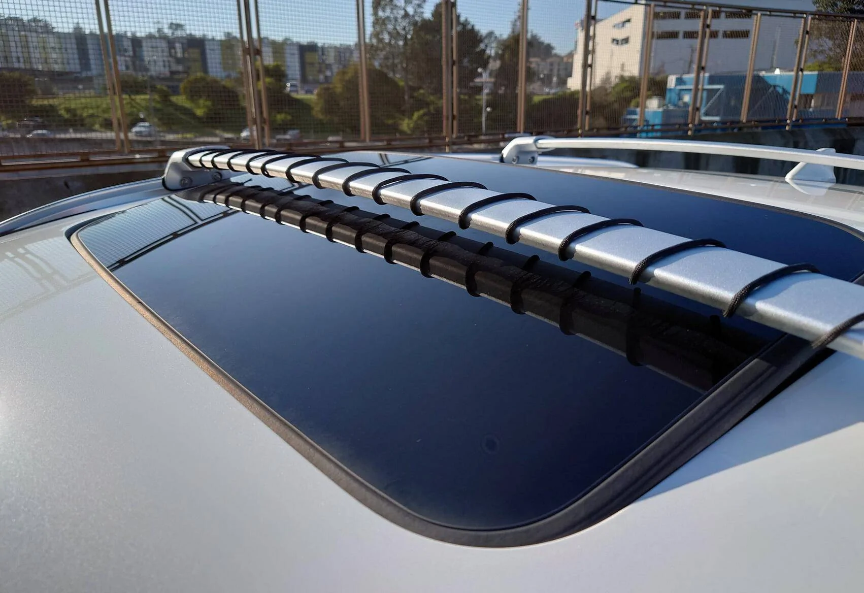

Depending on the type of wind noise coming from the cross bars, you might be able to mitigate it by wrapping a bungee cord around each bar. It's a common solution to fix whistling, but it's not clear that is the same issue being described here. Anyway, it might be worth a shot? Here's an example from another forum:
2025 2026 4runner 6th gen Anyone else hear wind noise from the back cabin with all windows up? dasfasd
