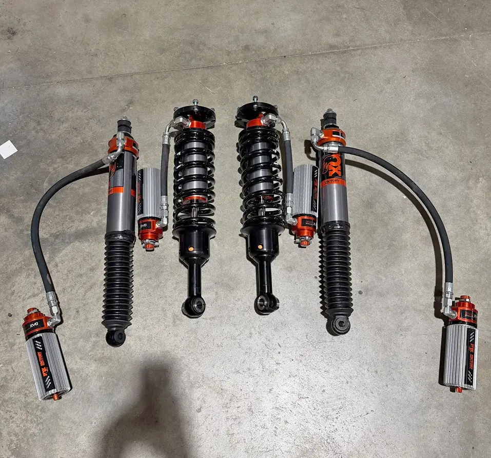

We just received our set of Fox 3.2 IBP Factory Race Series shocks today! I wanted to throw a quick photo up, these things are MASSIVE! We will be shooting an install video with them next week for anybody that's interested.

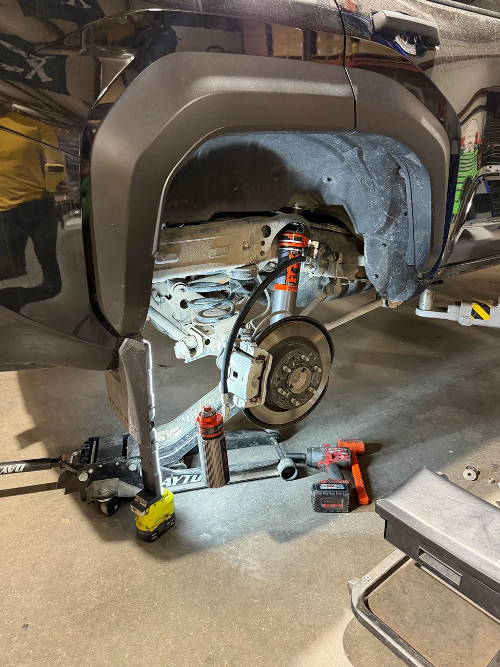

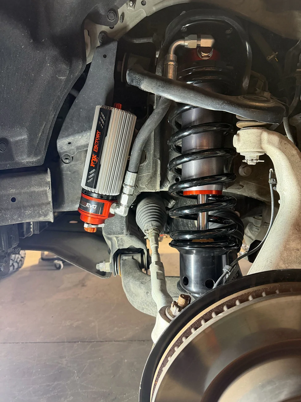

Just finished up the install this afternoon and it came out great! Video should be up in the next week or so. Excited to put some miles on them and see how they feel!

Some post-install notes for anybody considering these beasts.
You'll need wheel spacers or an aftermarket wheel with a +35mm or numerically lower offset, otherwise your tires will rub on the reservoirs. I am running factory wheels with Spidertrax 1" wheel spacers for sufficient clearance.
If you are installing onto a non-hybrid vehicle you will want to reduce the preload on the coilovers. Out of the box they will lift the front 3". If you reduce the preload as far as the shock allows you will end up with about 2.25" lift.
The reservoir brackets at the front can be a little tricky to secure to the frame. I've sent some feedback to Fox engineers which may improve on the bracket in the near future.
The instructions recommend running at the #4 positions for front and rear on the DSC Evo's. I have the adjusters set at #3 on high and low currently for around-town driving.
Looking forward to getting off pavement with them and feeling the internal bypass magic!
