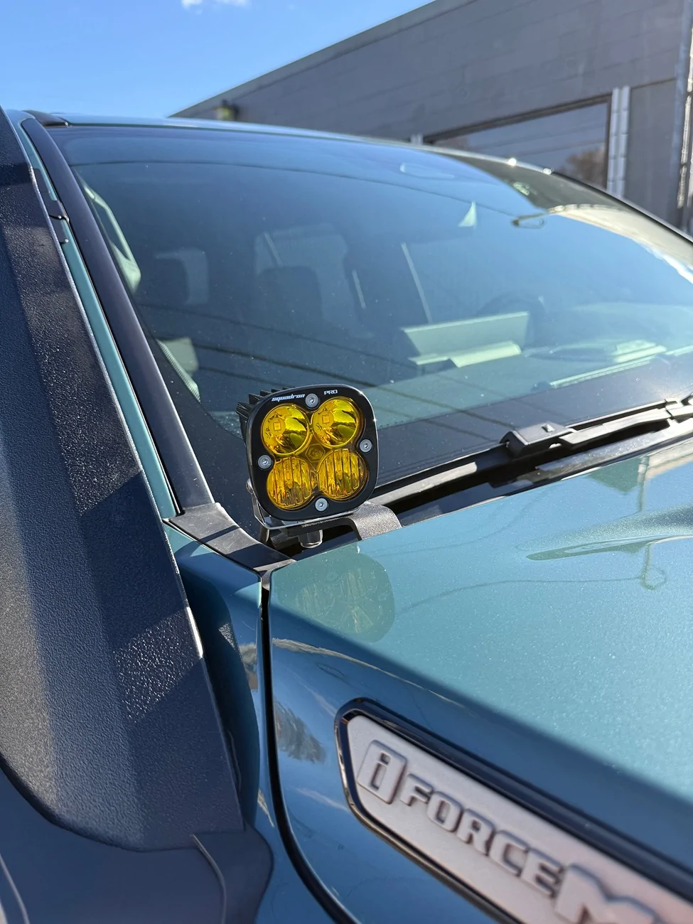

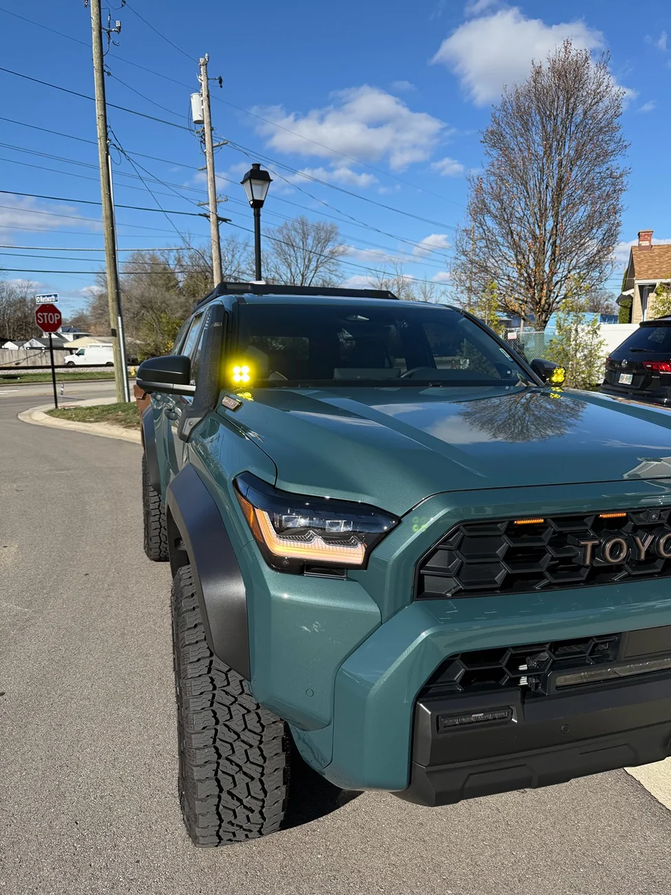

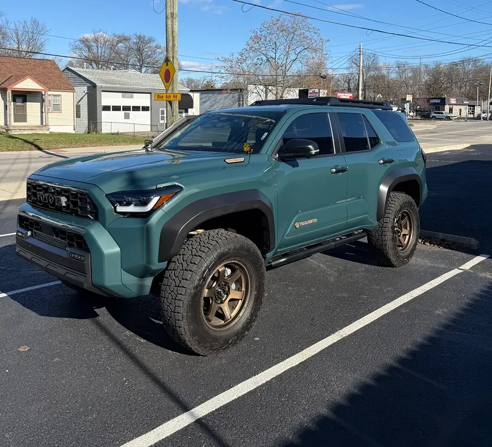

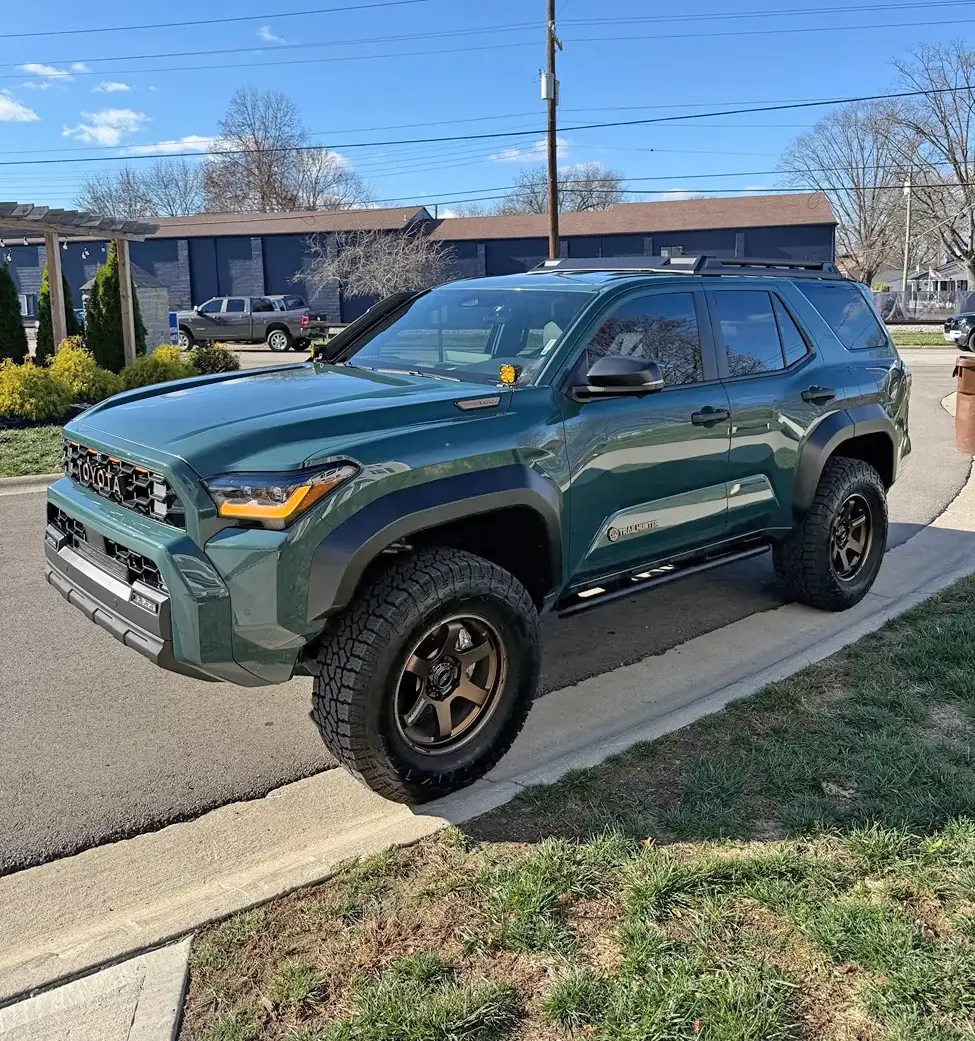

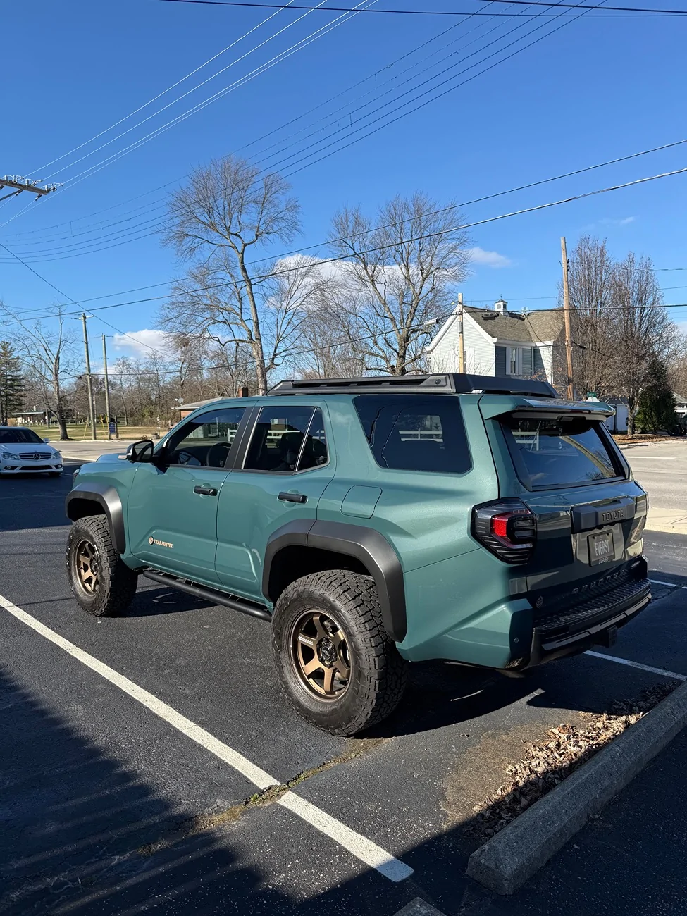

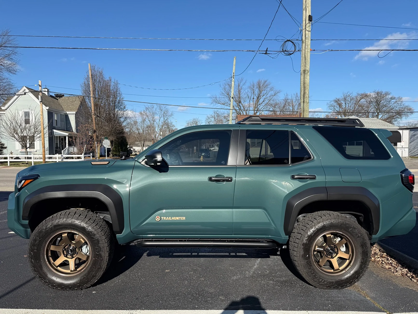

The Westcott lifts for the TrailHunter which fit the Old Man Emu suspension have started shipping. Was able to have mine installed this week along with some Baja Squadron Pro ditch lights. Used Westcott brackets for the lights.
Really happy with how the lift sits. Definitely a noticeable difference!
Wheels / Tires / Lift Specs:
Bronze Volk TE37SB 18x8.5 +22 offset wheels
Falken Wildpeak A/T4W LT285/70R18
Westcott Preload Collar Lift
