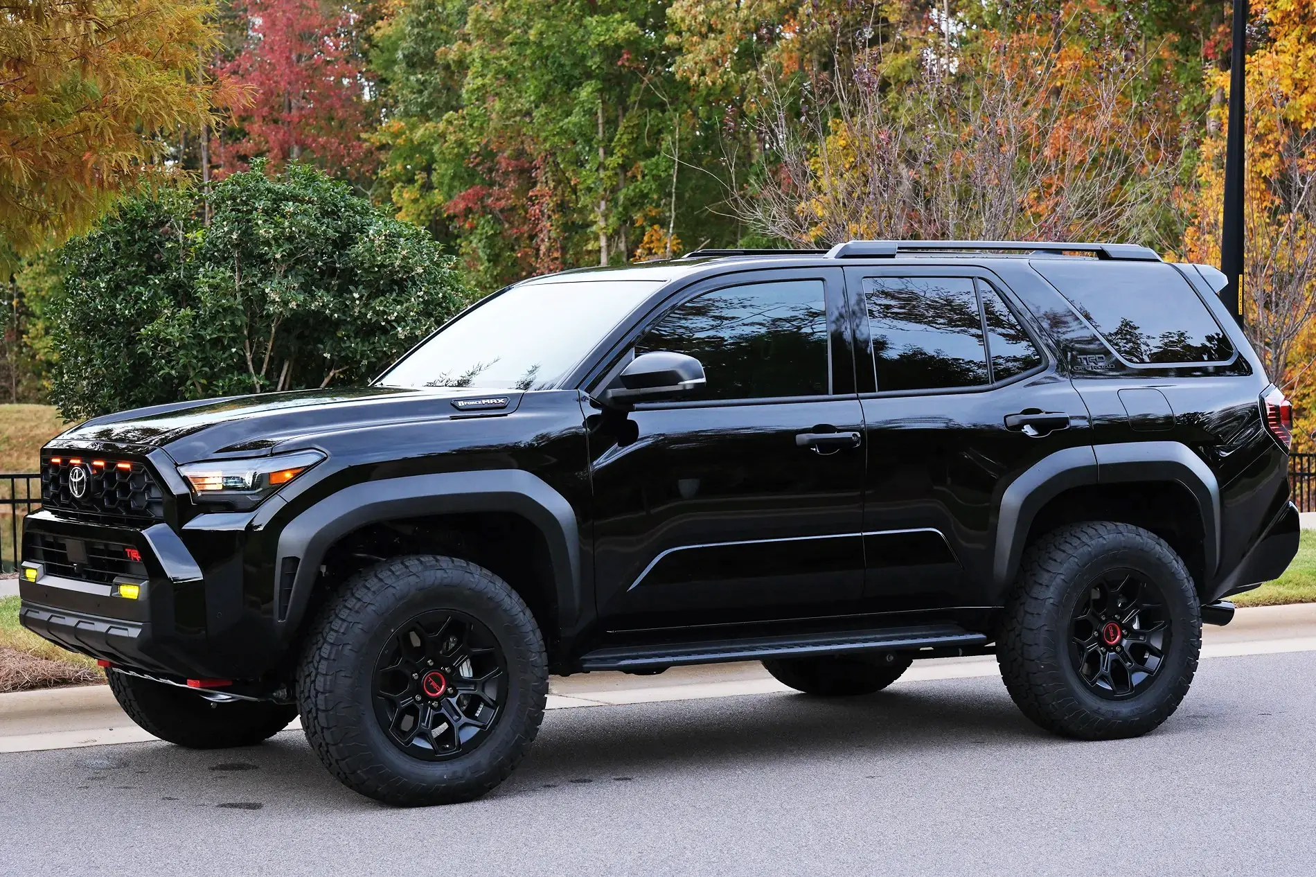

Finally made the swap - took off the TRD Off-Road headlights and threw on a set of TRD Pro headlights.
I have always been obsessed with those amber DRLs on the TRD Pro and the Traihunter... and man, they look even better in person! 🔥🔥
The install was 100% plug-and-play, zero issues. Also adding the sxth cold air intake, the turbo sound good!

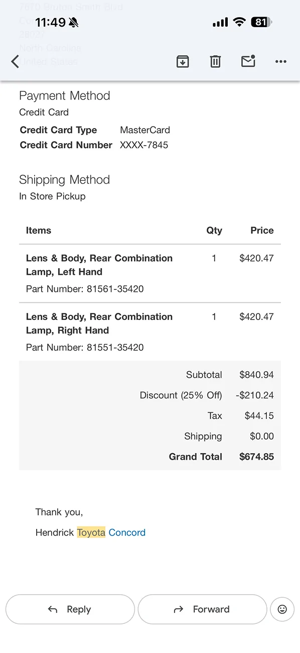

Yes I also have the premium tail lights.
For discount code is: GRob25Q324

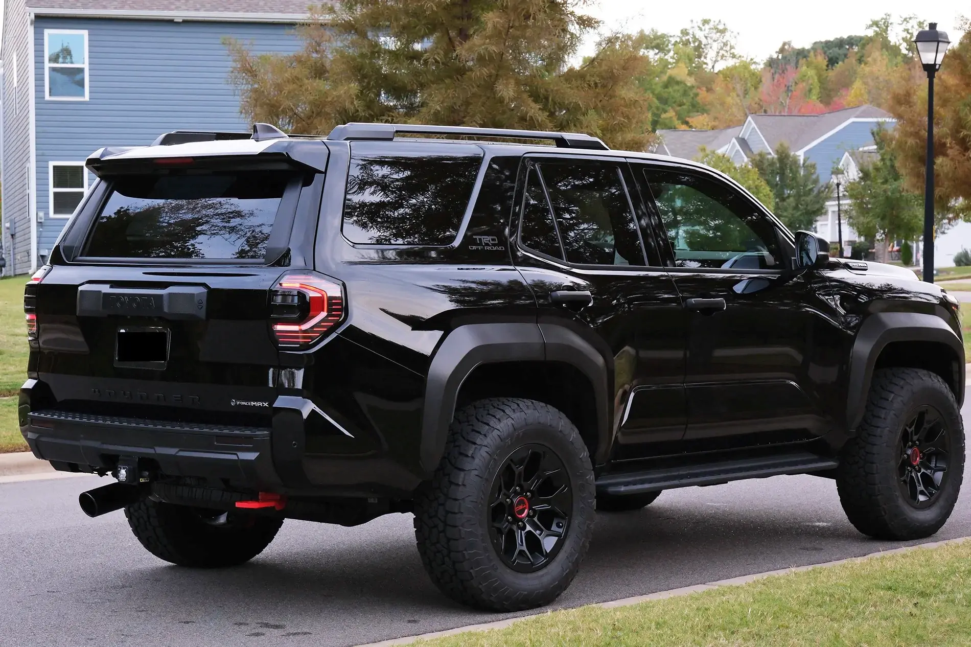

2025 2026 4runner 6th gen TRD Pro headlights & tail lights installed / swap on TRD Off-Road Premium ORP IMG_2571
2025 2026 4runner 6th gen TRD Pro headlights & tail lights installed / swap on TRD Off-Road Premium ORP trd pro tail lights installed on TRD Off-Road Premium ORP
