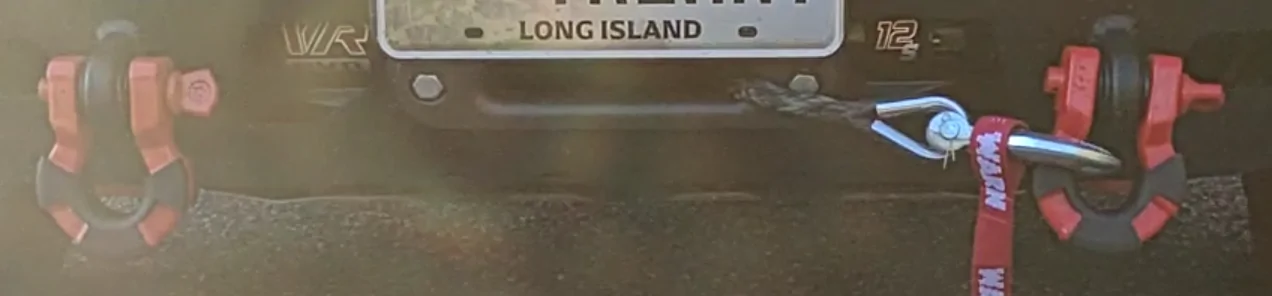

You can access the clutch through the cut-out (HIgh lift jack port?) on the right side of the fairlead. In the picture below, you can see where it says "12S" on the body of the winch inside behind the bumper through the port. It's tight but reachable. It's not really visible from man-height - stealth, as it were - but you can see it where you crouch down like I am in the shot below.
I installed the EVO 12S, might be more ergonomic with a 10K# if its smaller all-around but you can still reach right in and flip the lever.

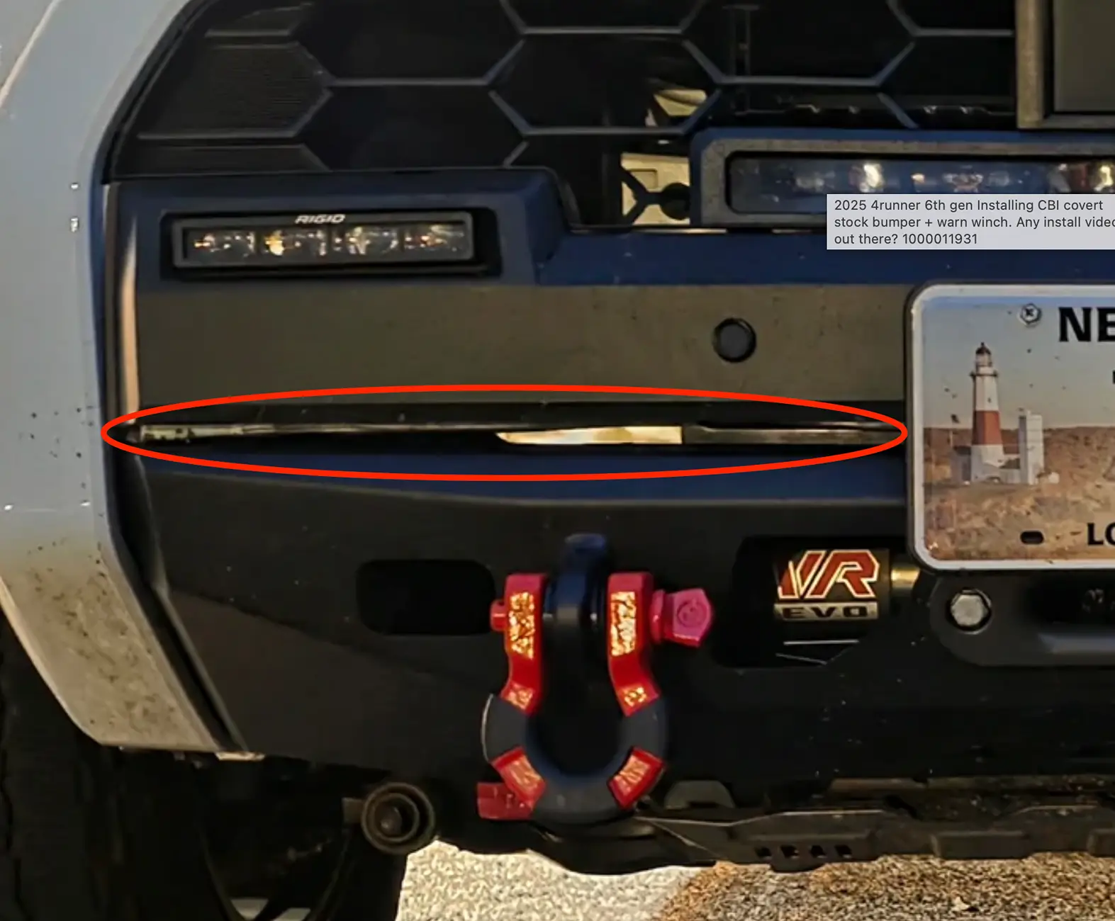

I'm curious - could you take some calipers and measure the gap between the bottom edge of the grille, and the top of the CBI bumper? I notice that the gap seems fairly wide and the cut plastic is somewhat visible in some of the install videos I've seen, so I'm thinking about installing something like this to act as a compressible gasket which would seal the gap and have a more finished look. Curious what others think about this...

I think that's just an odd angle which you wouldn't normally see. I'm crouched down to show the ports in the bumper and the oem skid plate. You're looking out through the bottom/side which is back-lit by the garage lights. You can see it through the stock grille up 6" higher as well.
Sure you could put a rubber gasket on top of the bumper (I think maybe you accidentally linked another item above) but I don't think it'd normally be visible. You could also cut the bumper differently and leave more material than I did. It's just a piece of plastic. I cut it down to the trim in a couple of stages and settled on what I thought looked best, which was cutting away all of white/body lower fascia so just the black part with the fog lights and license plate rides above the bumper.
