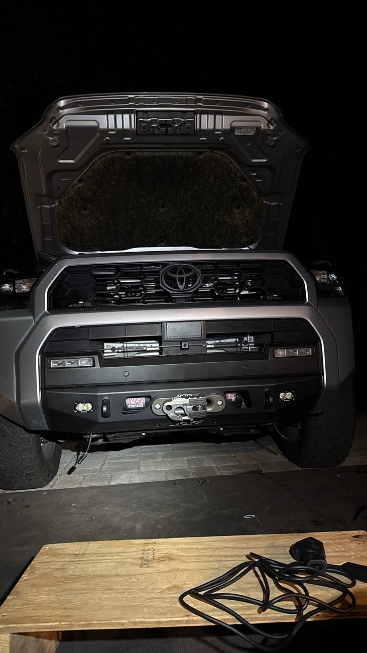

Been searching for an install on the 6th gen but no luck. I have found a photo tutorial on another forum site. But I’d prefer a video walk thru haha
2025 2026 4runner 6th gen Installing CBI covert stock bumper + warn winch. Any install videos out there? IMG_2606

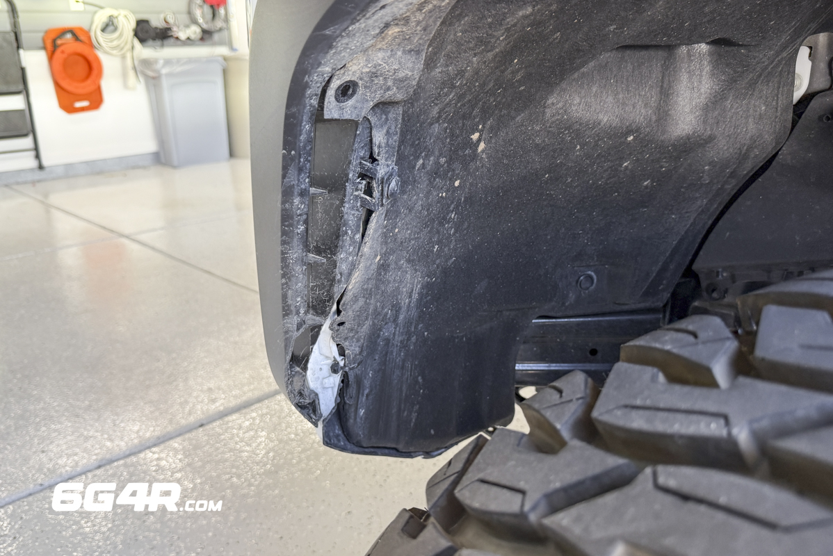

Remove the 10mm bolts and clips holding the felt liner, fender flare, and fender together. Your fender wells might look different since we have done some trimming to fit our 35" tires. Here you can see all the clips and bolts off with the liner separated from the flare.

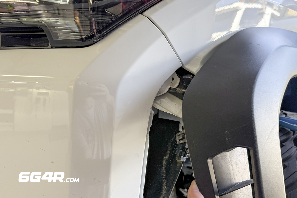

Now pull back on the fender flare and access the 10mm bolt holding the side of the bumper to the lower headlight area.

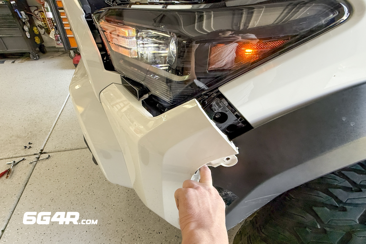

Step 4. Front Bumper Side Plastics
2025 2026 4runner 6th gen Installing CBI covert stock bumper + warn winch. Any install videos out there? cbi-super-stock-install-6g4r-3-
This part might be a little nerve-racking, although it's very simple. Just pull straight out on the bumper cover and release the tabs that slot into place. A quick pull is usually better than slowly pulling on the bumper plastics.

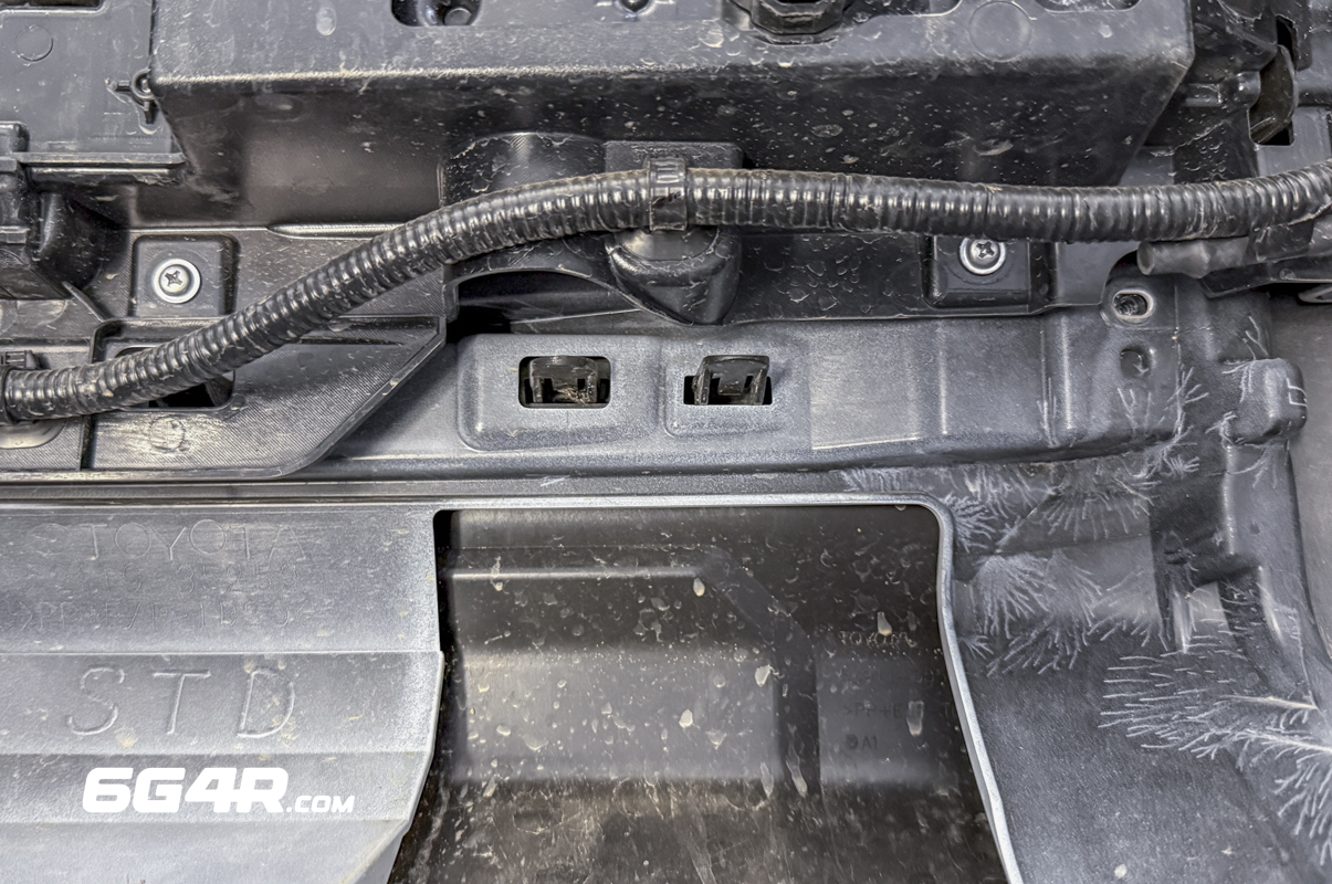

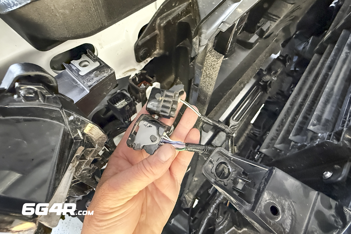

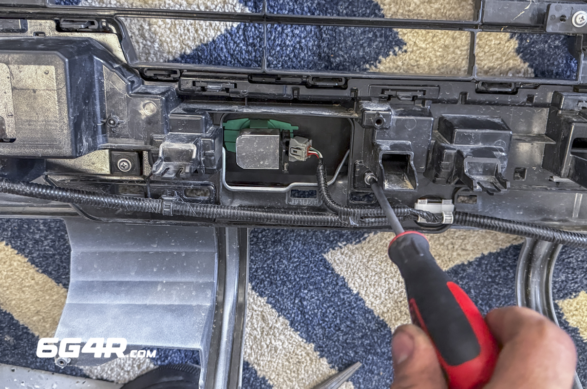

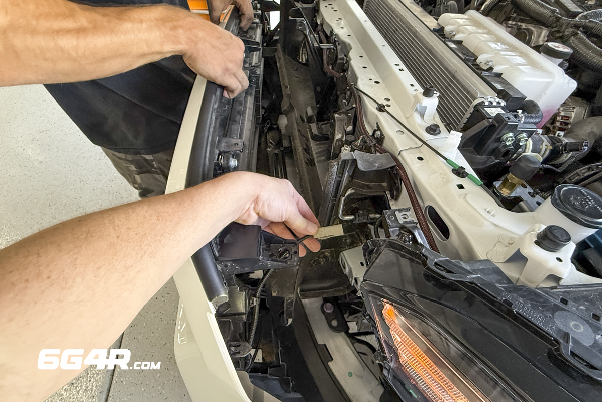

Step 5. Remove Passenger Clip
2025 2026 4runner 6th gen Installing CBI covert stock bumper + warn winch. Any install videos out there? cbi-super-stock-install-6g4r-6-
Unclip the light grey passenger side clip.
Step 6. Remove Driver Clips
2025 2026 4runner 6th gen Installing CBI covert stock bumper + warn winch. Any install videos out there? cbi-super-stock-install-6g4r-7-
Unclip both passenger side harnesses.

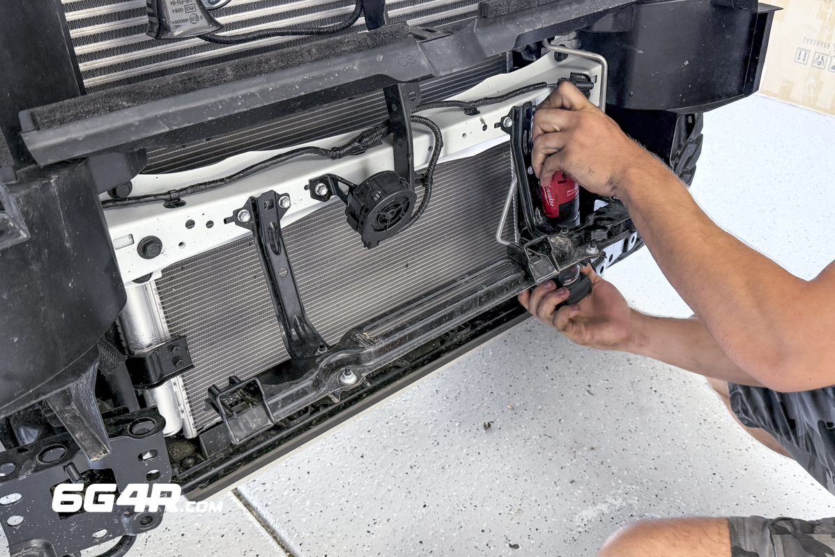

Step 7. 19mm Bolts on Crash Bar
2025 2026 4runner 6th gen Installing CBI covert stock bumper + warn winch. Any install videos out there? cbi-super-stock-install-6g4r-8-

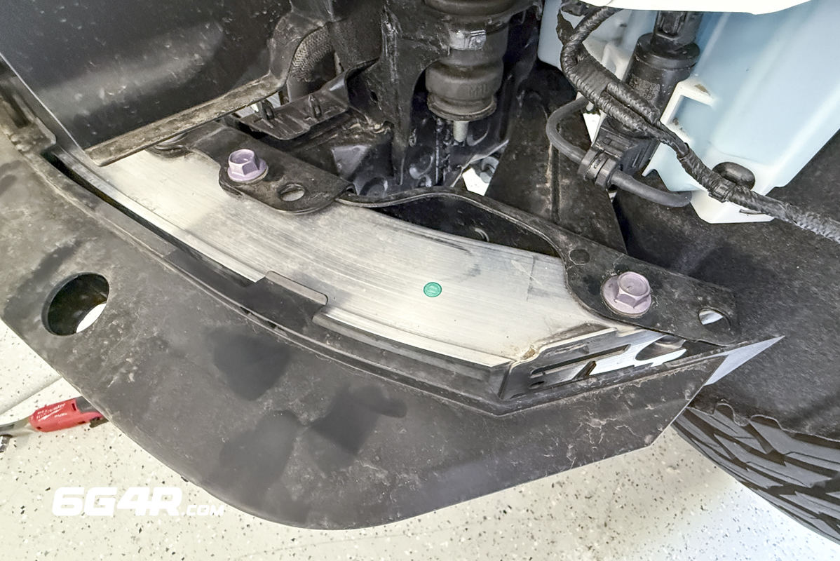

There are 19mm bolts holding the crash bar in place on the top and bottom. Remove all these bolts.
Step 8. Remove Crash Bar
2025 2026 4runner 6th gen Installing CBI covert stock bumper + warn winch. Any install videos out there? cbi-super-stock-install-6g4r-9-
Just pull straight out on the crash bar and set it to the side. You will not reuse this piece.

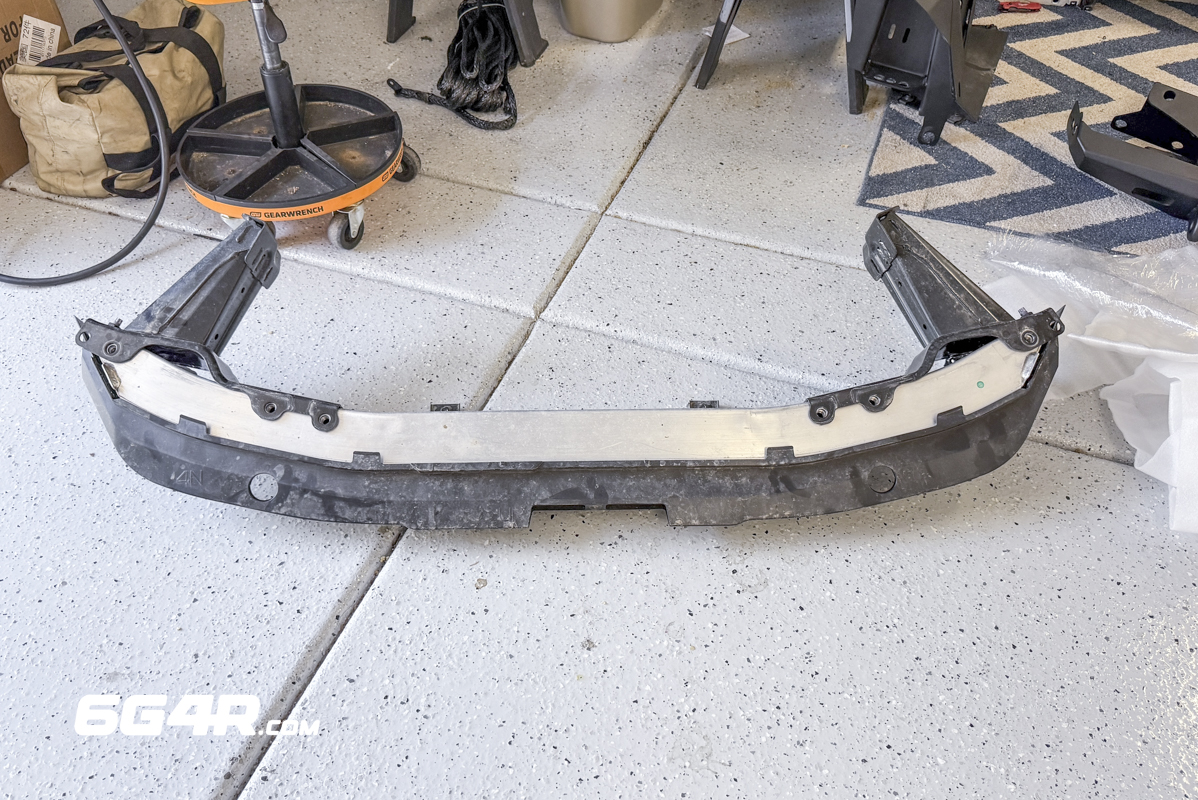

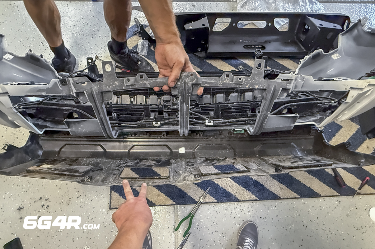

Step 9. Center Support Brace
2025 2026 4runner 6th gen Installing CBI covert stock bumper + warn winch. Any install videos out there? cbi-super-stock-install-6g4r-10-

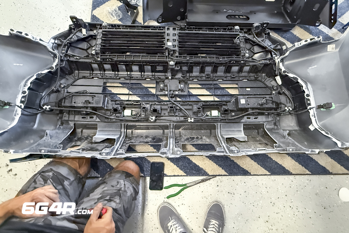

Step 10. Prepare Bumper For Trimming
2025 2026 4runner 6th gen Installing CBI covert stock bumper + warn winch. Any install videos out there? cbi-super-stock-install-6g4r-11-

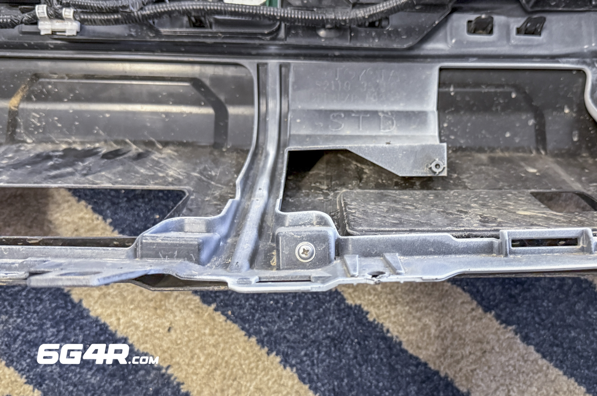

Set the bumper on a rug or something soft to prepare the bumper for trimming. Be careful not to damage any of the sensors or adjust the grille shutter or grille shutter harnesses. If you alter any of these, you may get some check engine lights after the installation.

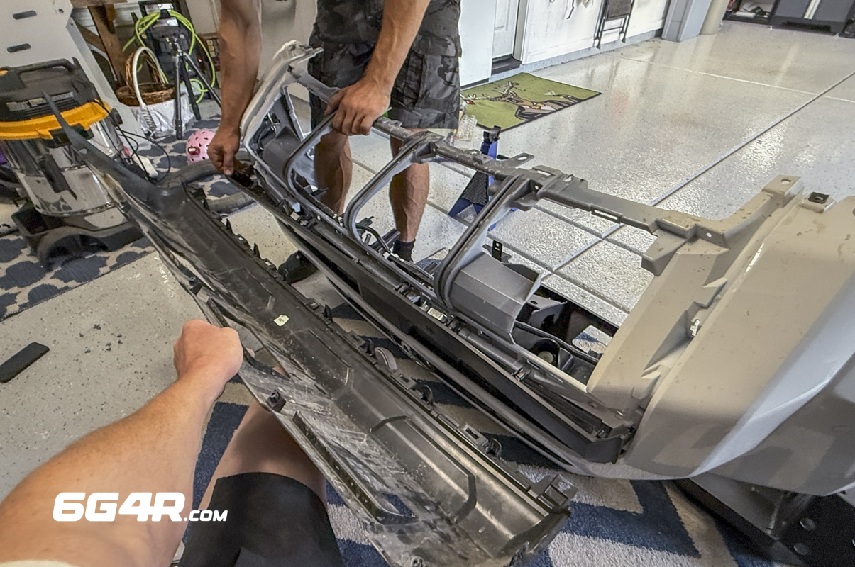

To remove the center lower valance, start by removing the screws on the lower and upper valance. I believe there are 12 total screws holding the top and bottom together.
Step 12. Separate Clips on Lower Valance
2025 2026 4runner 6th gen Installing CBI covert stock bumper + warn winch. Any install videos out there? cbi-super-stock-install-6g4r-13-
Once the screws are removed, loosen the tabs that are holding both the upper and lower valance together.
Step 13. Pull Back Lower Valance
2025 2026 4runner 6th gen Installing CBI covert stock bumper + warn winch. Any install videos out there? cbi-super-stock-install-6g4r-14-

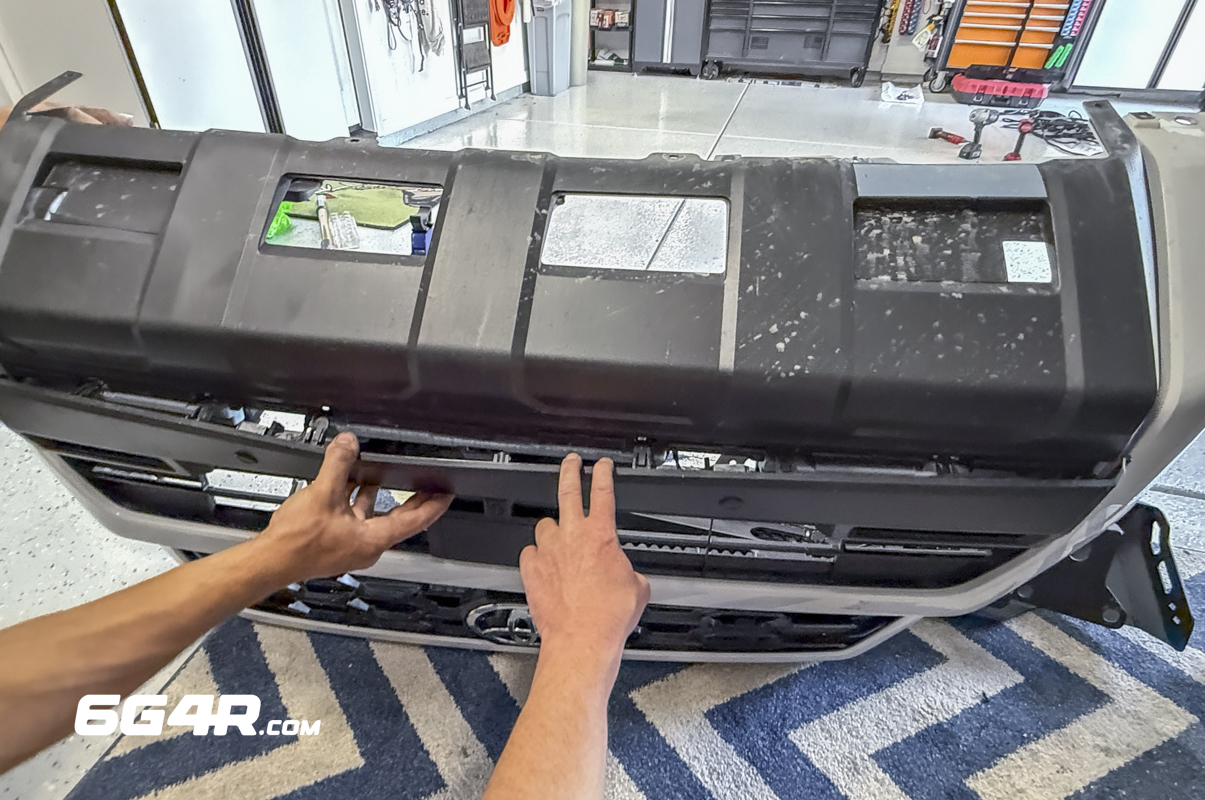

The lower valance is sandwiched between the upper valance and the backside of the bumper plastics. You will need to turn the bumper over, and pull back the upper valance in order to pull out the lower valance.

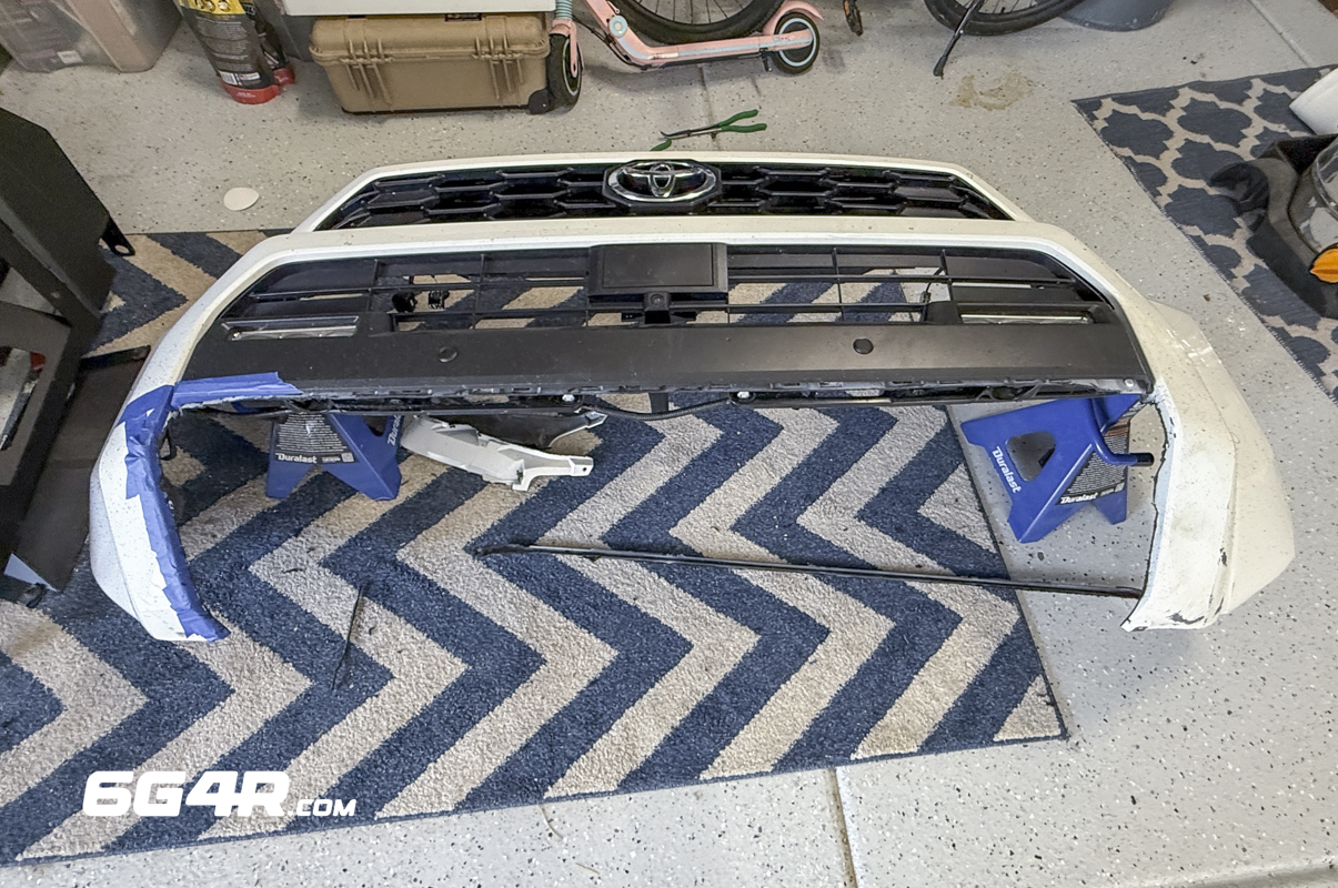

Step 14. Separate Lower Valance Cover
2025 2026 4runner 6th gen Installing CBI covert stock bumper + warn winch. Any install videos out there? cbi-super-stock-install-6g4r-15-
Now, fully remove all the last clips holding the lower valance in place on the factory bumper plastics.
Step 15. Remove Lower Valance
2025 2026 4runner 6th gen Installing CBI covert stock bumper + warn winch. Any install videos out there? cbi-super-stock-install-6g4r-16-
The lower valance should be free to remove. You will not reuse this piece.
Step 16. Re-Secure Top Valance
2025 2026 4runner 6th gen Installing CBI covert stock bumper + warn winch. Any install videos out there? cbi-super-stock-install-6g4r-18-
Once the lower valance is off, re-secure the top valance back to the factory bumper plastics using all the screws and tabs.

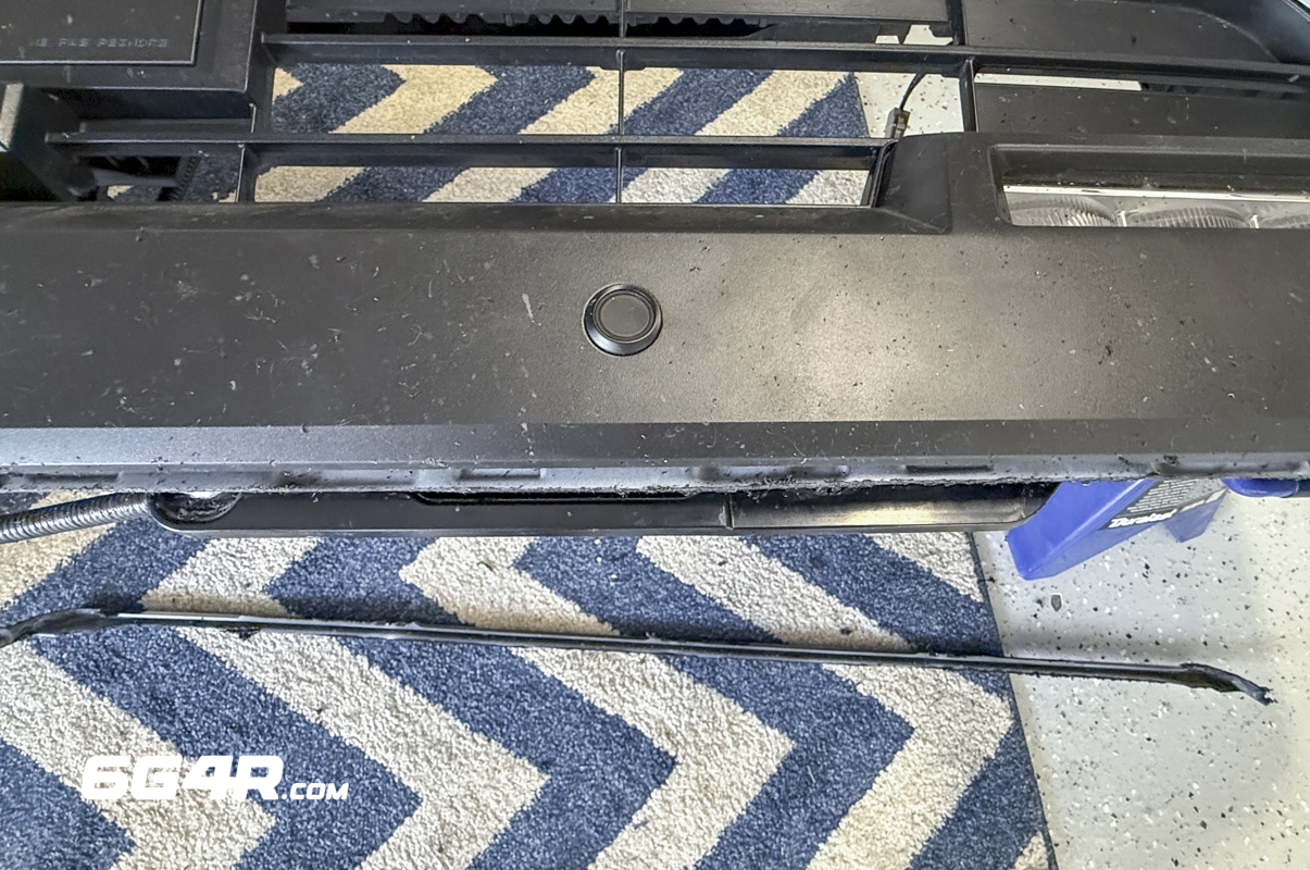

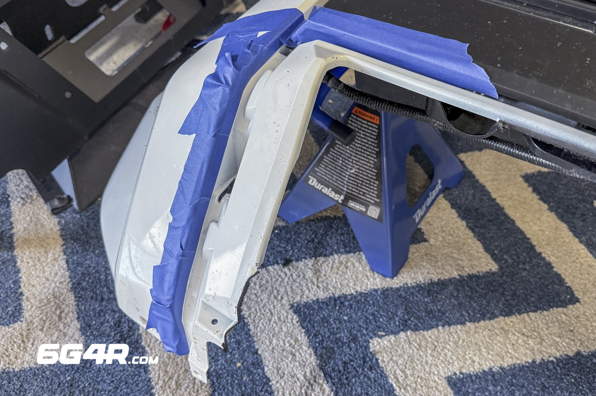

Step 17. Trim Lower Valance
2025 2026 4runner 6th gen Installing CBI covert stock bumper + warn winch. Any install videos out there? cbi-super-stock-install-6g4r-20-
Here is a rough idea of the final cut line. Since we didn't have any installation instructions, we first cut out the center portion, did some test fitting, and then marked our final cut lines.
Step 18. Upper Valance
2025 2026 4runner 6th gen Installing CBI covert stock bumper + warn winch. Any install videos out there? cbi-super-stock-install-6g4r-22-
Be careful when cutting along the top line, not to cut this black plastic piece behind the bumper plastics. This black plastic piece will slot behind the CBI bumper, which provides support for the bumper's entire front clip.

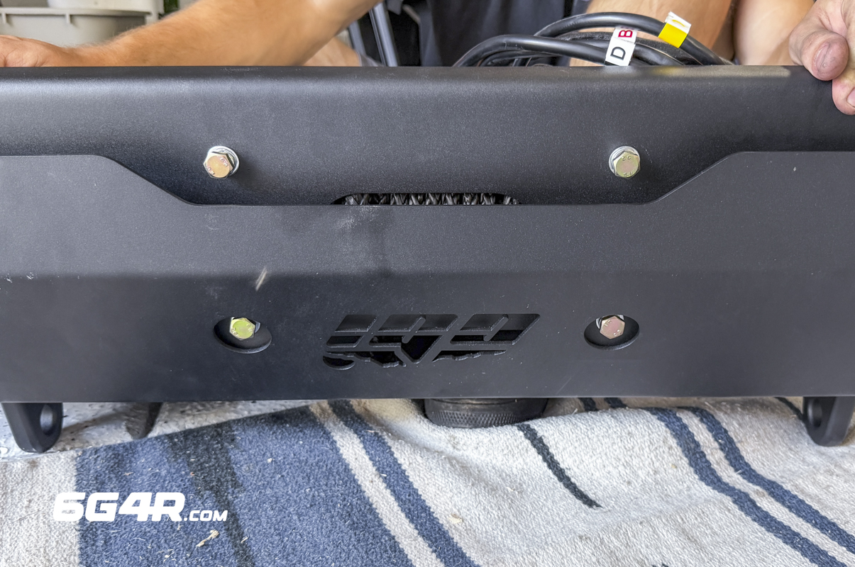

CBI provides really good access for the winch bolts. Bolt on your winch and get ready to mount the bumper.

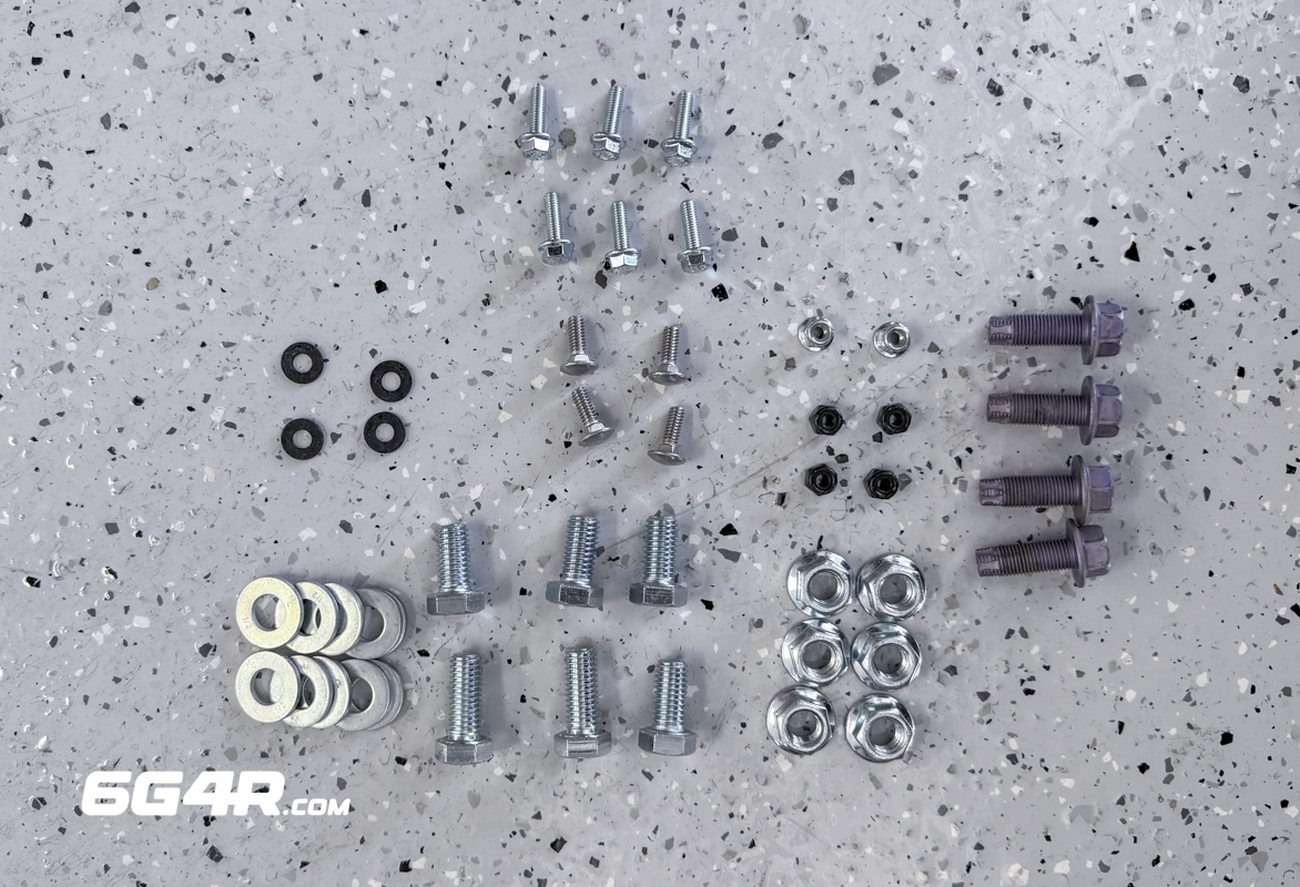

Step 21. Bumper Hardware
2025 2026 4runner 6th gen Installing CBI covert stock bumper + warn winch. Any install videos out there? cbi-super-stock-install-6g4r-24-

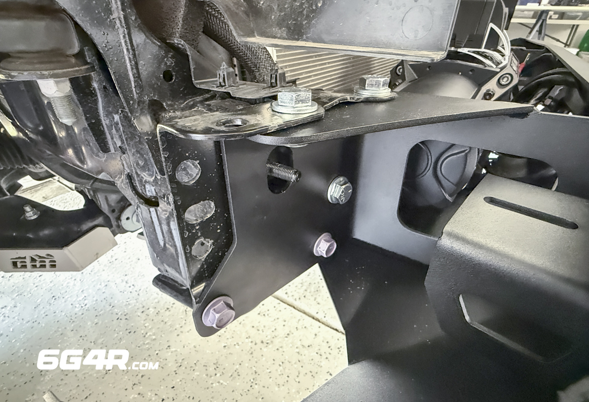

Here is the hardware provided by CBI + the OEM 19mm bolts on the top right. CBI provides you with the bumper and two sets of support brackets. One support bracket for the lower bumper corner in the wheel well, and another large L bracket that we did not use.
The 1" hardware + flange nuts go on the top of the bumper and mount from the top down.
The 1 1/4" hardware + flange nuts go on the lower portion of the bumper and mount from the front to the back.
Re-use the factory 19mm bolts where you can into the pre-threaded factory nuts.
The small carriage bolts are used to mount the side brackets that connect the CBI bumper to the OEM bumper plastics + felt liner.

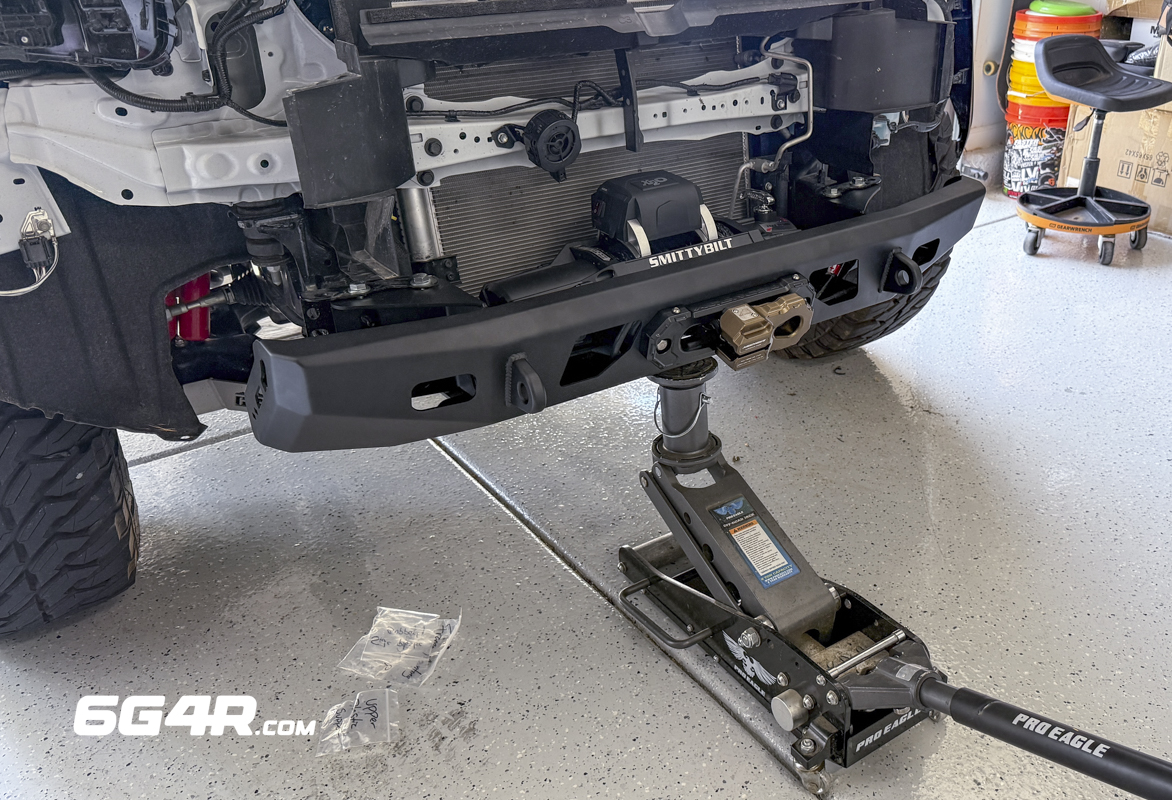

Step 22. Dry Fit Bumper
2025 2026 4runner 6th gen Installing CBI covert stock bumper + warn winch. Any install videos out there? cbi-super-stock-install-6g4r-25-
Test fit the bumper into place and loosely attach your hardware all the way around.

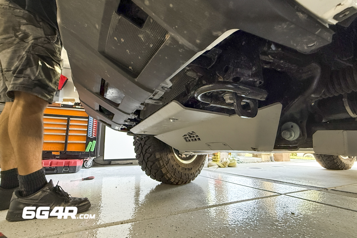

Step 23. Mount The Bumper
2025 2026 4runner 6th gen Installing CBI covert stock bumper + warn winch. Any install videos out there? cbi-super-stock-install-6g4r-26-
Here is a look at how the hardware is mounted to the bumper and frame rail.

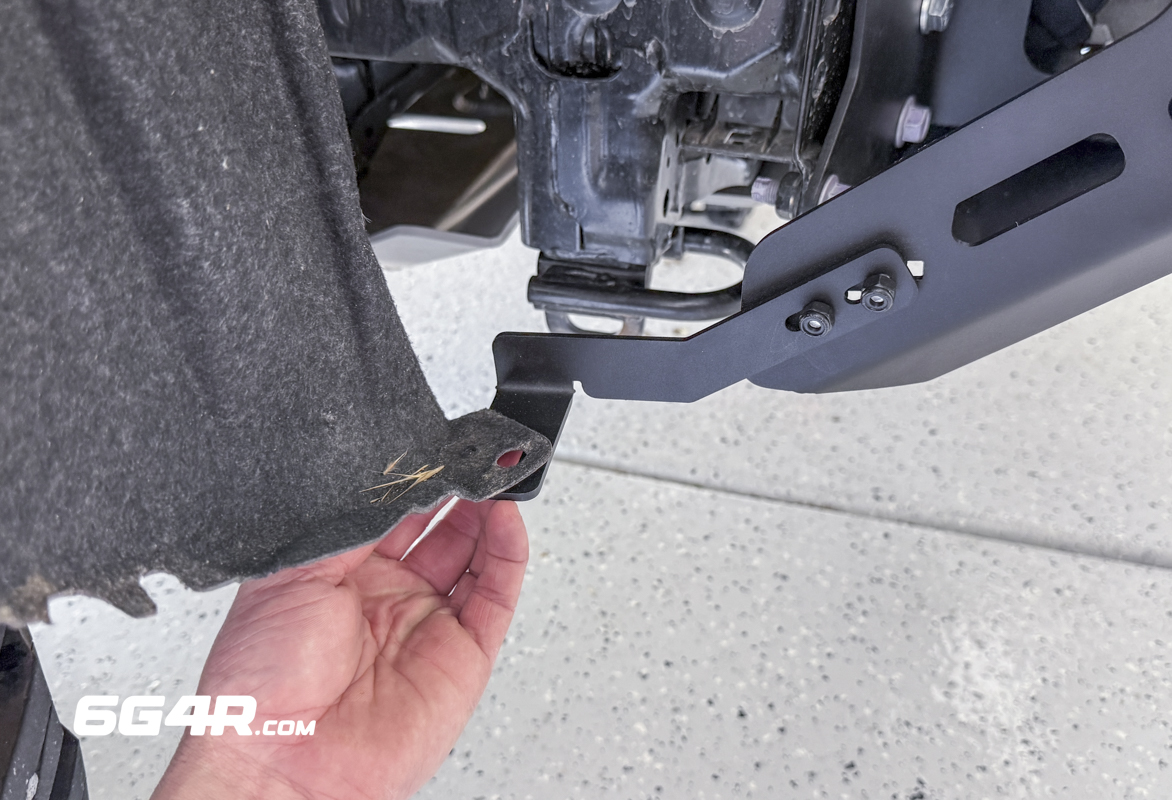

Step 24. Side Support Brackets
2025 2026 4runner 6th gen Installing CBI covert stock bumper + warn winch. Any install videos out there? cbi-super-stock-install-6g4r-27-
Mount the side support brackets with the carriage bolts.

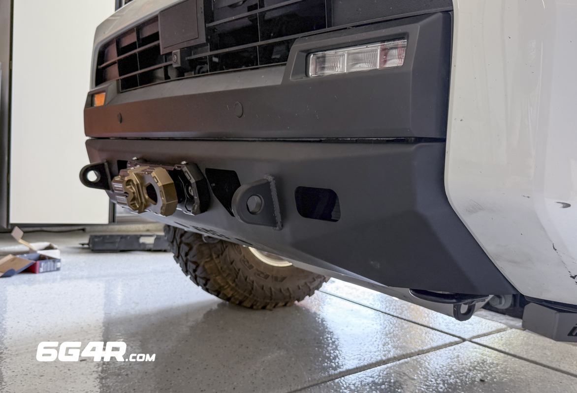

Step 25. Final
2025 2026 4runner 6th gen Installing CBI covert stock bumper + warn winch. Any install videos out there? cbi-super-stock-install-6g4r-28-

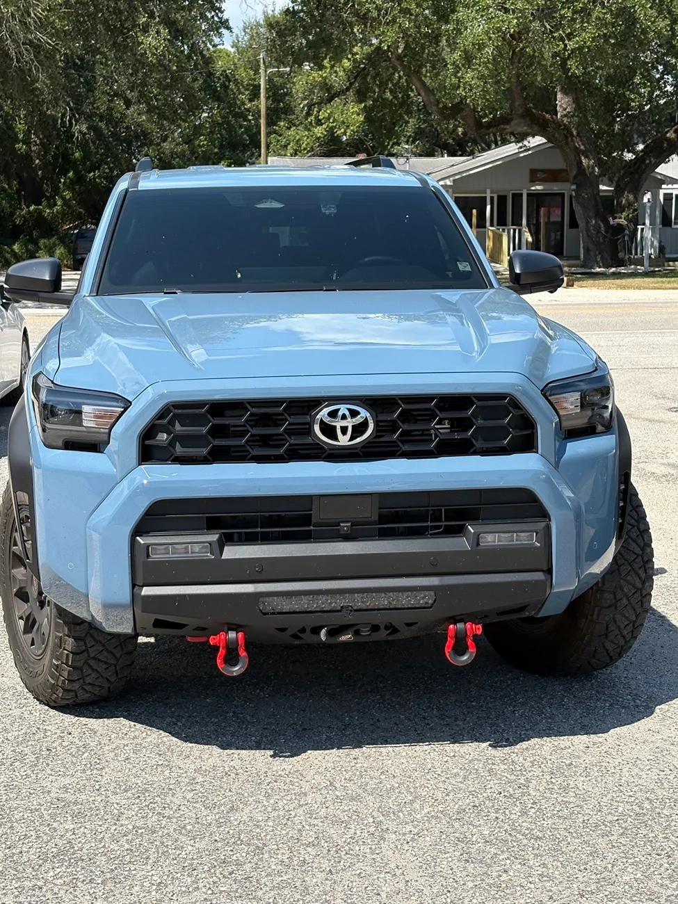

And to answer about reaching the remote plug in. My hand can actually reach it through the front bumper. A bit tight. But do able for myself.
2025 2026 4runner 6th gen Installing CBI covert stock bumper + warn winch. Any install videos out there? IMG_2630

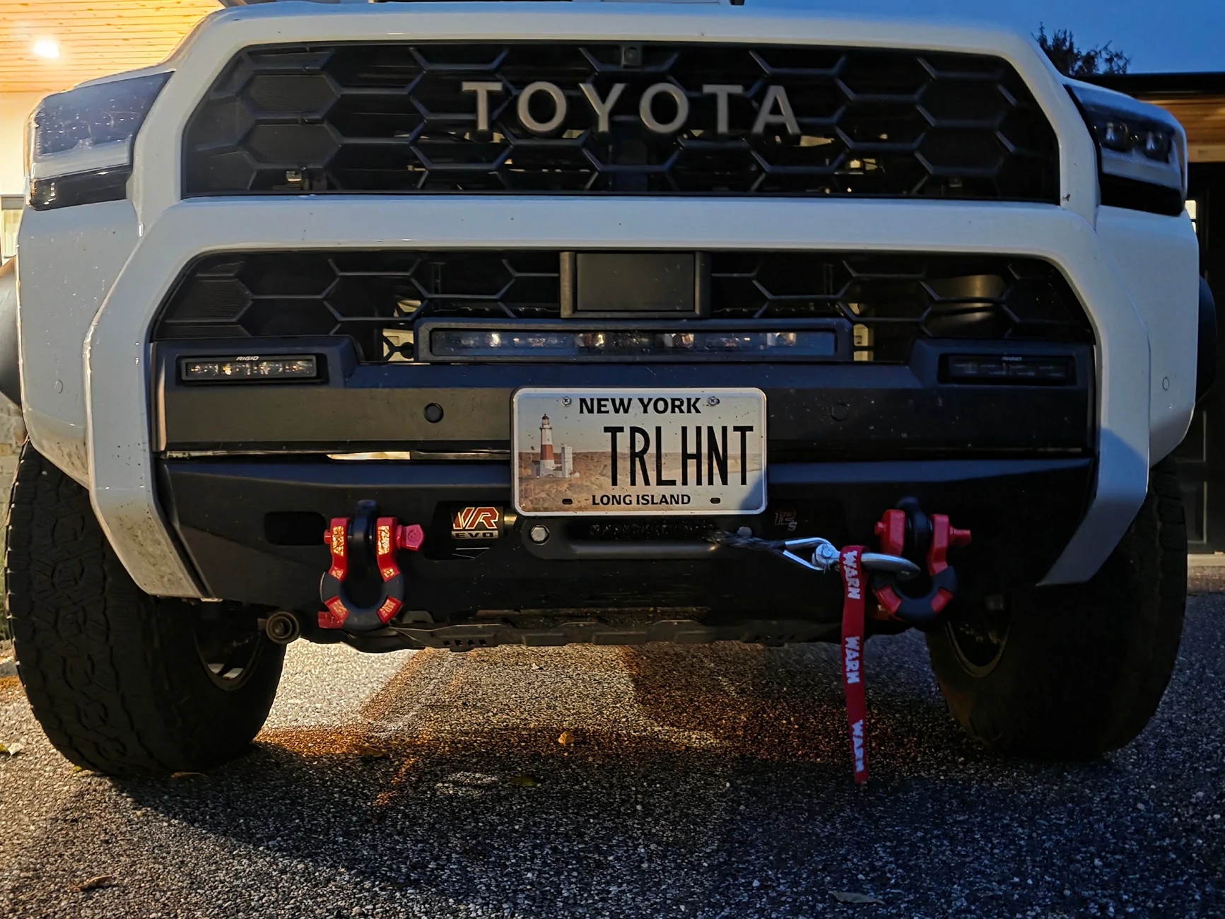

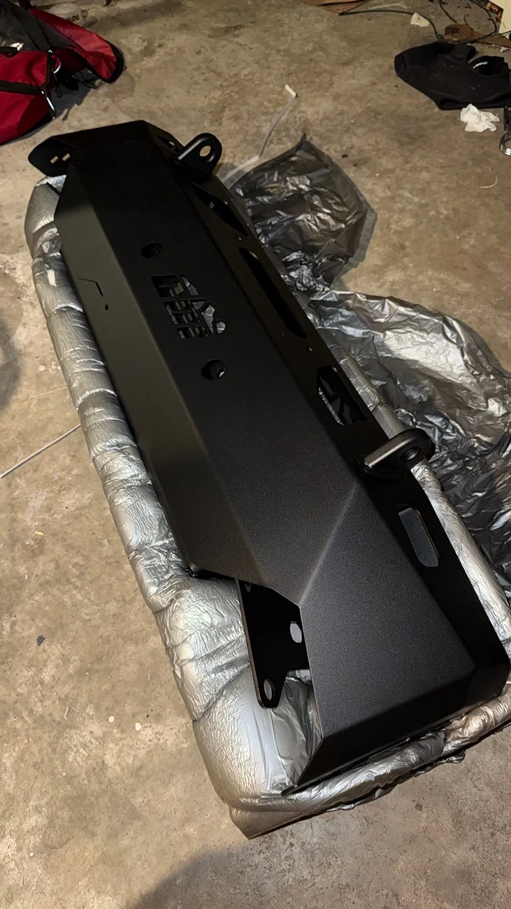

i just installed one and videoed most of it but i haven't had time to edit everything yet. is there a certain part where you're stuck? i can DM it some clips. i can reach the controls through the bumper from the outside.
2025 2026 4runner 6th gen Installing CBI covert stock bumper + warn winch. Any install videos out there? 1000011931
