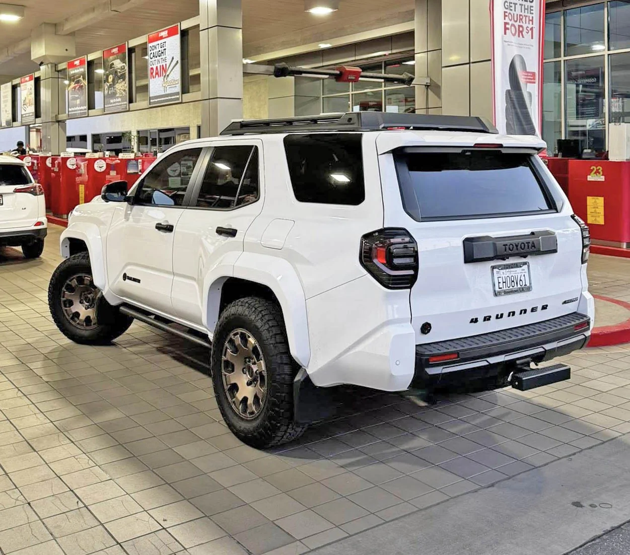

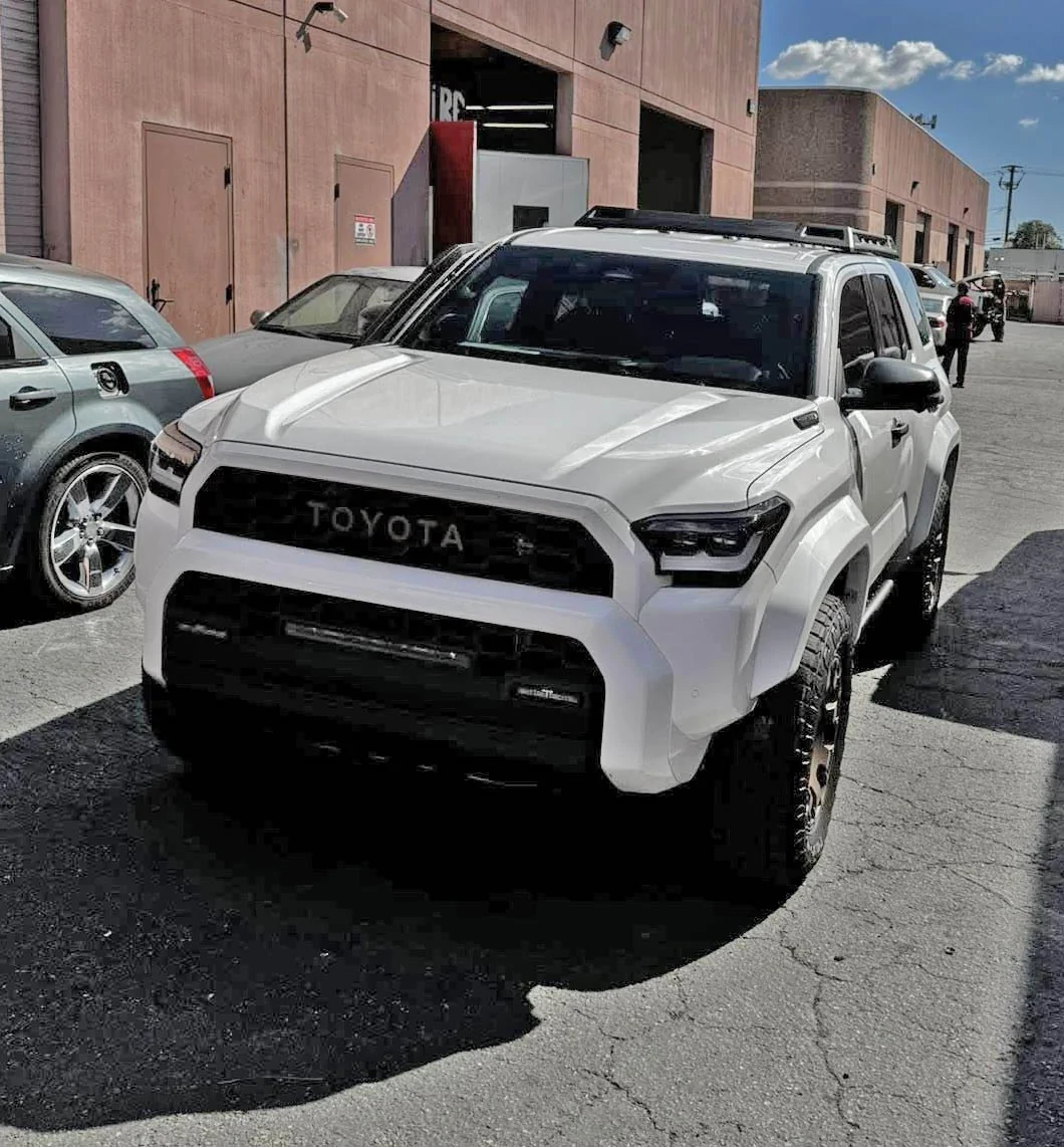

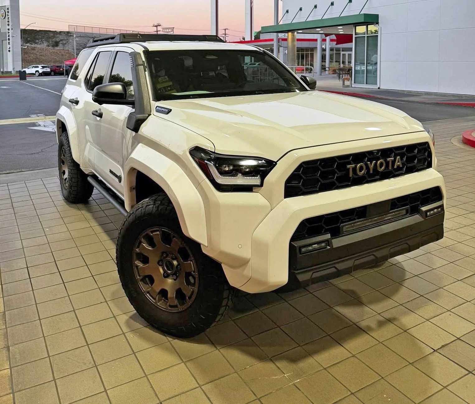

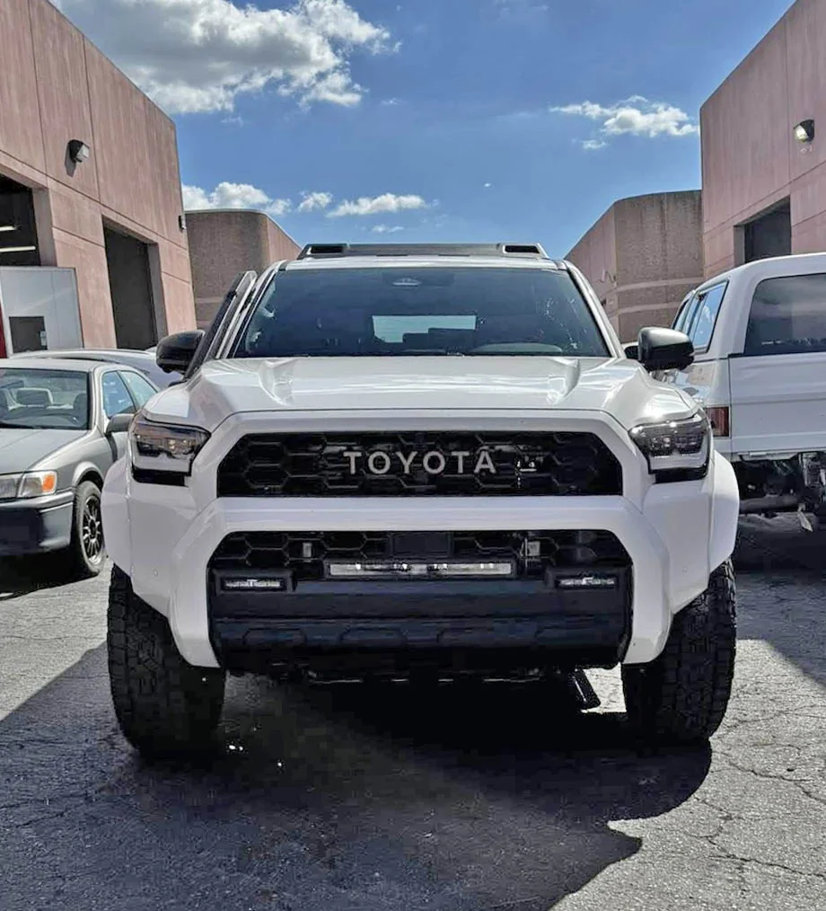

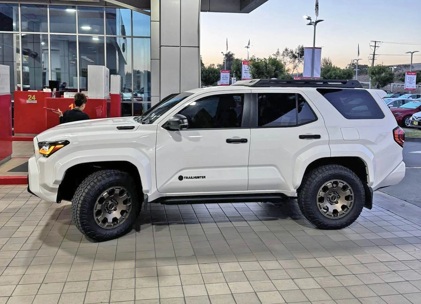

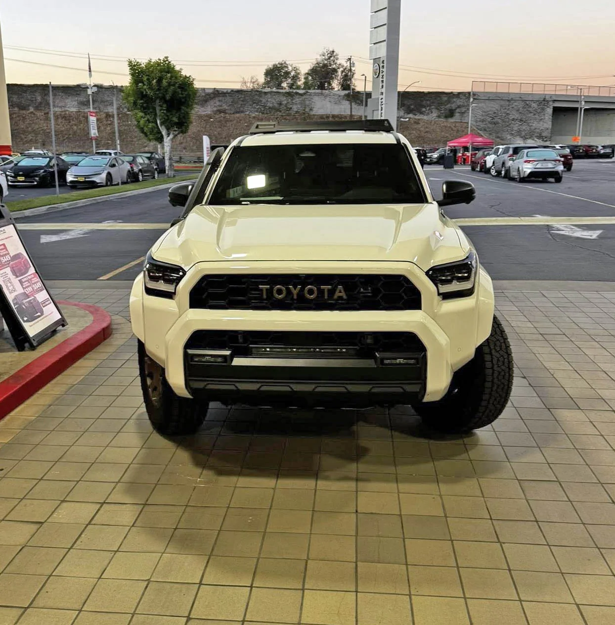

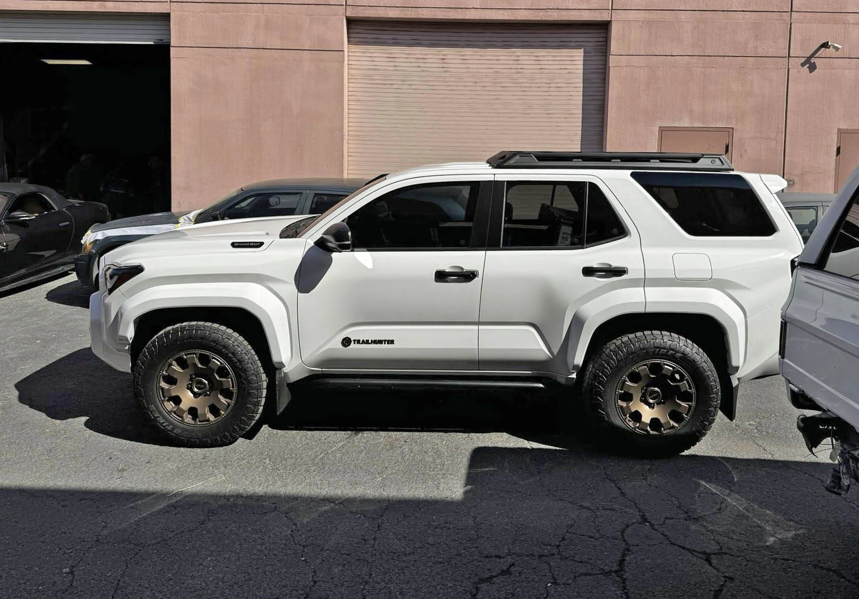

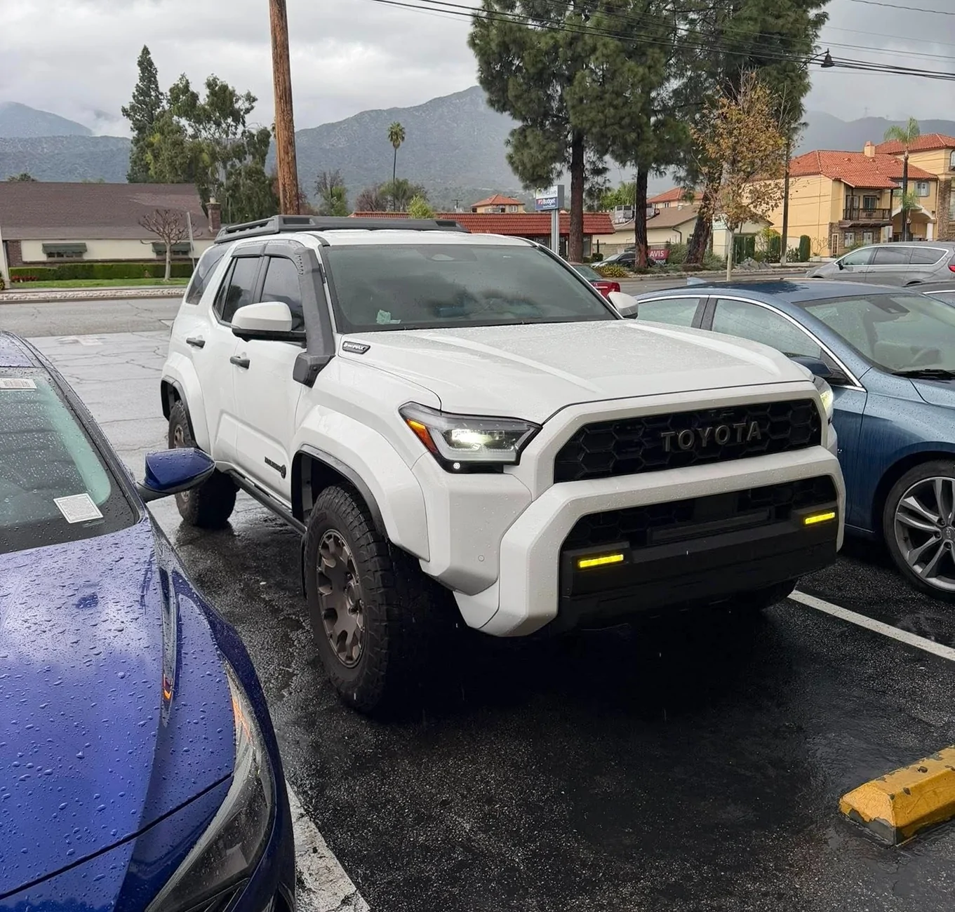

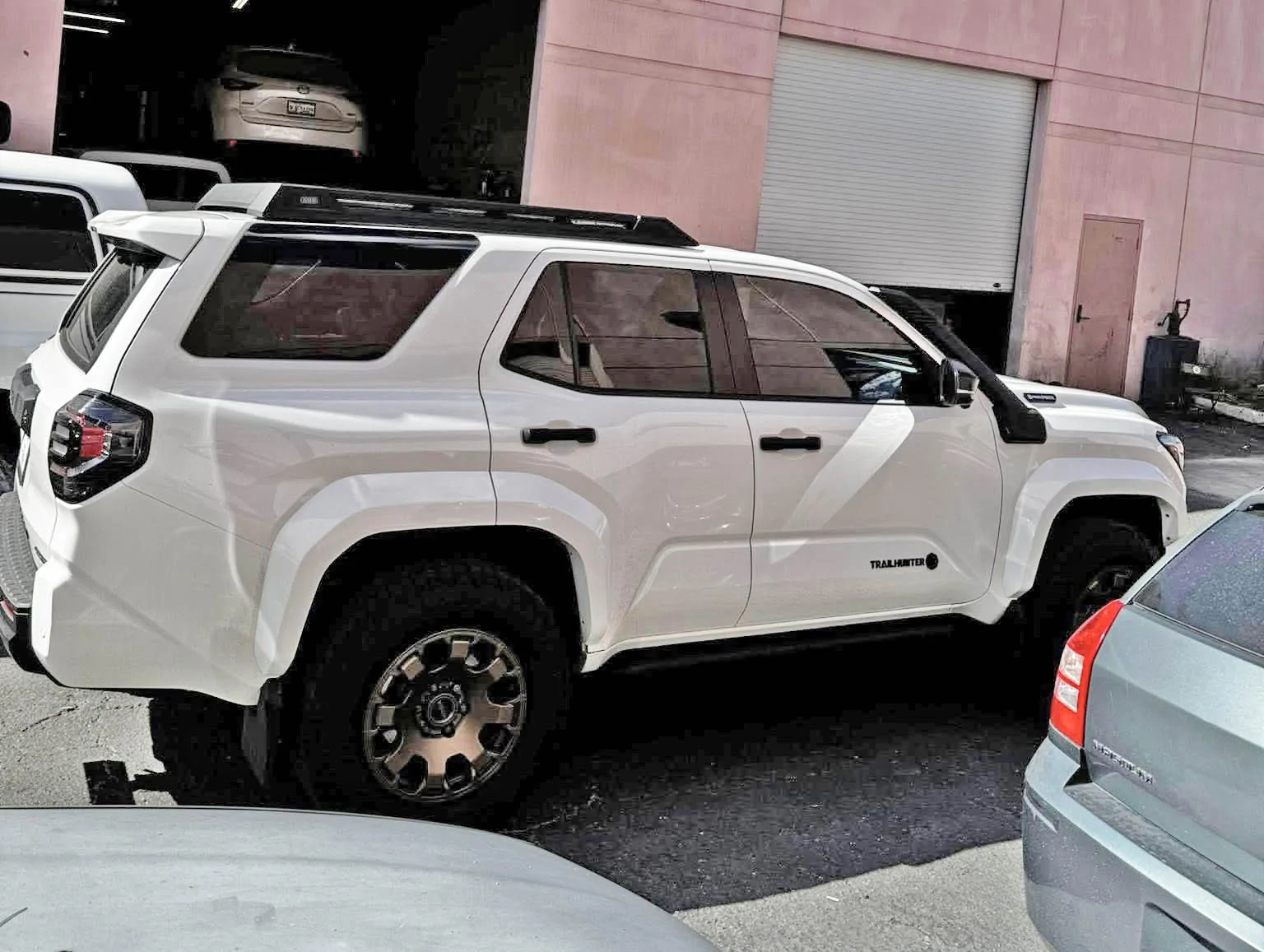

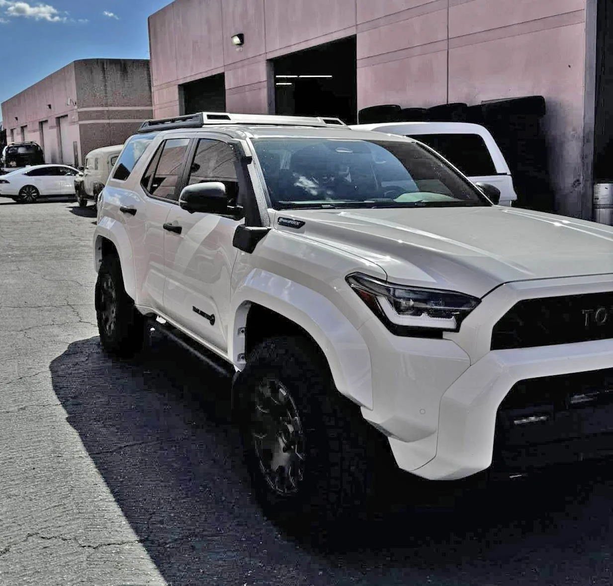

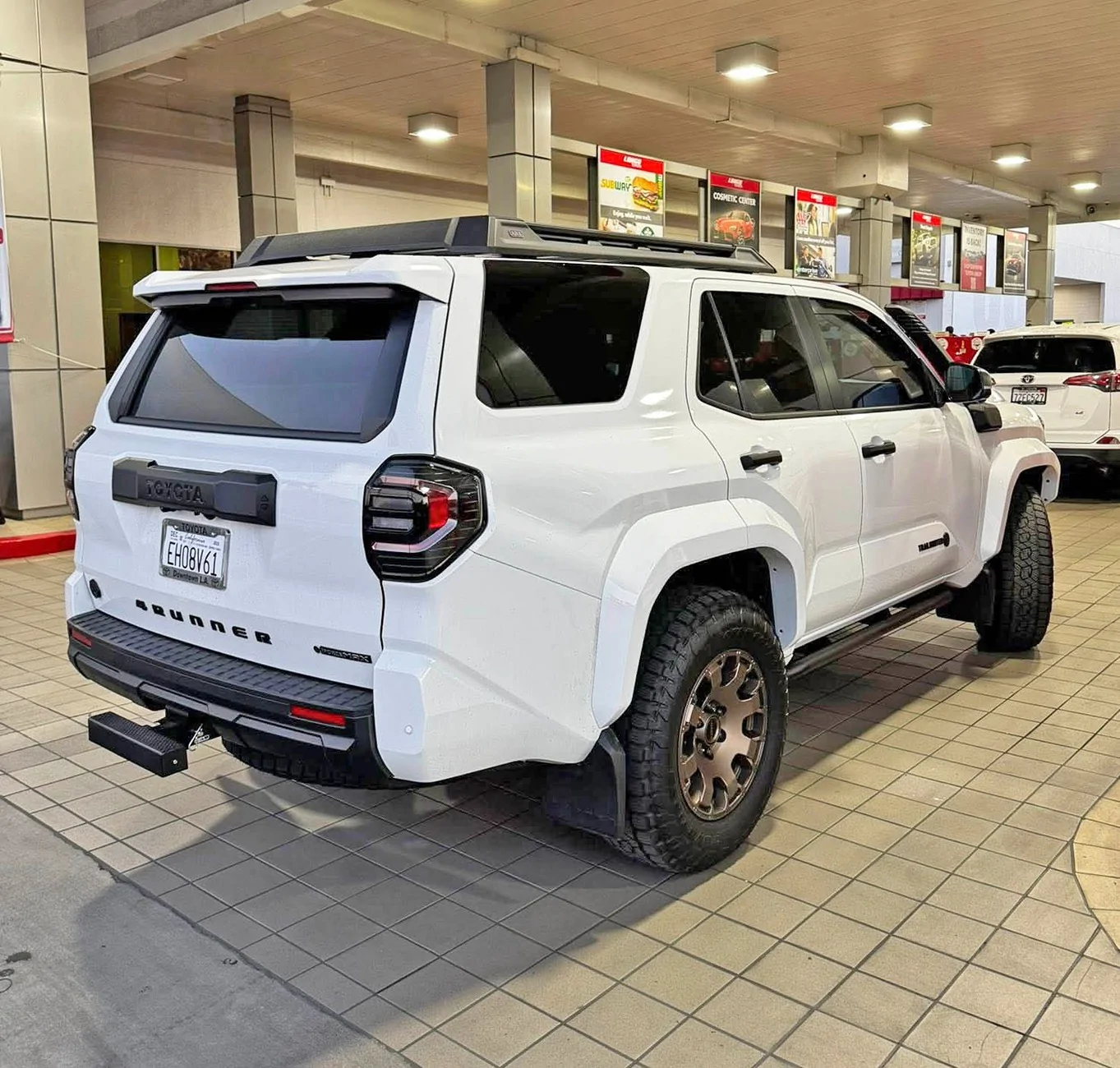

My 4Runner Trailhunter with DIY painted fender flares in case anyone's thought about color matching their fenders.
Process:
  • Find color code for your 4Runner
  • Buy aerosol spray can in this color
  • Also buy 1 can of primer, 1 cans of 2k clear coat, 180 grit sanding paper, grease cleaner, adhesion promoter spray
  • Remove fenders flares
  • Sand until smooth > clean with degreaser > apply adhesion promoter > 2-3 coats of primer > 3-4 coats of paint > 3-4 coats of clear coat
  • For reference / comparison: professional paint shop route will cost $800-1400 for a professional paint match spray
I don't know how the fender flares look up close, but looks decent at this distance. And a DIY paint match spray probably only looks OK with non-metallic colors like Ice Cap.
The front and rear valance were also painted black.

Looks great! One thing to add to your list is you HAVE to wear a respirator with that 2k clear.

I’ll answer any questions people have. I installed the ez fenders to retain some protection but I’ve gotten nothing but compliments about how nice the fenders look painted. Really gives it that aggressive wide look.

Got a few quotes and it was 1300-1500 to paint 6 flares. It was ridiculous.
What eased my mind was that the flares can be replaced easily. The color difference was much more noticeable when I first put them on. I don’t know if I got used to it or the sun made them match, but I don’t see a difference anymore.
Plus, it was a fun low risk project. Had a lot of fun with it and it turning out great is a big plus.

how many cans of spray cans did you used? thinking of doing this too

1 can of primer
2 cans of paint (I only used 1, but these coats are more time sensitive so better safe than sorry)
1 can of clear

thanks for the response, are these for all 6 pieces flares? did you sand it?
