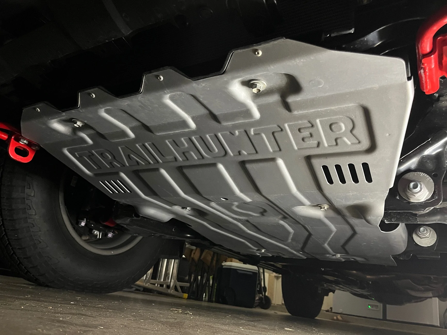

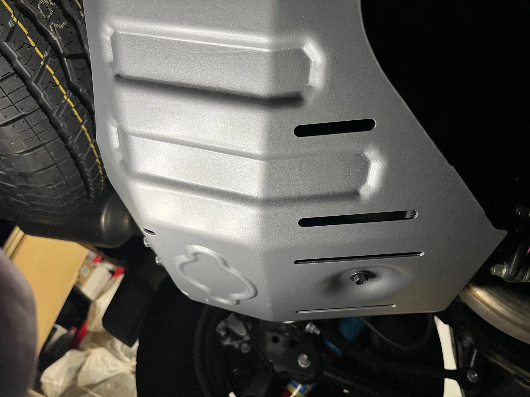

Got 2 out of 3 TrailHunter skid plates. I feel good about it!
The differential brackets is a major pain to install even after brake lines brackets were undone, still hard to rotate under the stabilizing bar. The rubber band and brackets are interchangeable BUT they are angled (taller portion toward the center). I went ahead and undo 5 brake line brackets to make it easy, but i still had to be careful not to damage the line. Pretty happy with the overall result. Thanks @Cory39744 for the differential plate!
I have been searching for the transfer case skid plate, the last piece out of the 3, if anyone getting rid of theirs , i’d be happy to pay for it.

2025 2026 4runner 6th gen TrailHunter steel skid plates (2 of 3) installed on TRD ORP gas nonhybrid IMG_4847
2025 2026 4runner 6th gen TrailHunter steel skid plates (2 of 3) installed on TRD ORP gas nonhybrid IMG_4848

They look great. Do you have part numbers for all 3 Trailhunter skid plates?

Nicely done! I did the TRD front on my Sport Premium. Not have a lift or ramps, it was a struggle for one man. Had to use scissor jack for help. I will hold off on the other 2 but plan on them. 😄 And the front has been broken in when I crawled over gravel road ditch in rural area in Loudoun.
