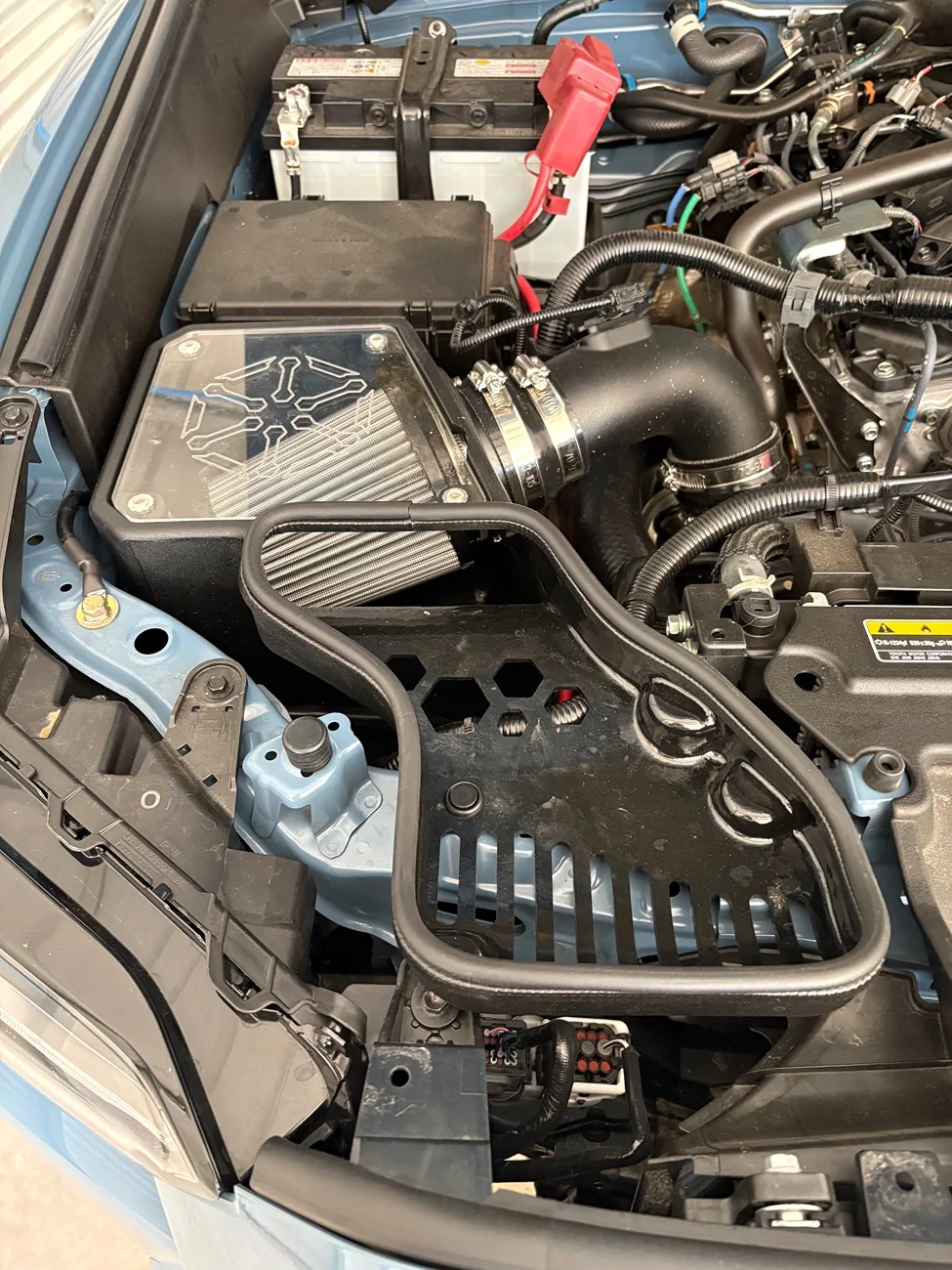

I recently installed the SXTH Element CPLT Intake on my 2025 Toyota TRD ORP, and overall I’m very pleased—but it wasn’t without its headaches. If you’re thinking of installing this yourself, especially if you’re not mechanically inclined, there are some things you’ll want to know first.

I’m not mechanically savvy—this was my first time installing an air box. If you’re like me, expect to spend more time than 15-20 minutes. It took me about an hour.
2. Obstacles from Previous Modifications
I had a winch installed previously, and the cables routed to the battery in the engine bay/fender area were in the way. I had to move those cables out of the way so I could properly install the new airbox.
3. Fitting the Pieces
The components are high quality, and everything is machined and molded well. But some of the connections are tight. To get the intake tube and airbox properly seated, I needed lubrication (a little WD 40 worked) on the rubber seals and joints so parts would slide together without forcing things too hard.

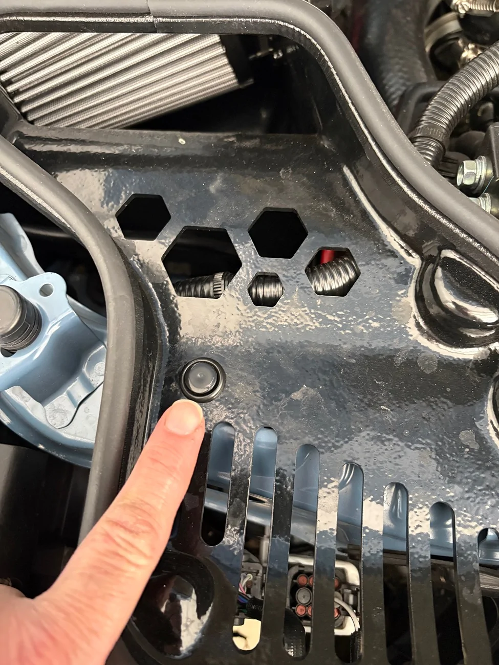

6. Aftermarket Button Snap
I had ordered some aftermarket button snaps off Amazon and found those to be a better fit to hold in the airbox. The snap in/out works a little differently, but they hold better in my opinion.

It’s not a cold air intake. That inlet lets in underhood hot air. Poor design in my opinion.
If it works it works. (not that I take this post to be proof of that) But I agree it does not look good.
If you're going to let in air from behind the radiator, then why even have that stupid channel at all? Or for that matter any of the rest of the box around the filter?
Maybe just to reduce noise from the turbo inlet. I have another car with a turbo & cai with no box, and that makes a lot of vacuum sucking, turbo impeller, and waste gate & bypass valve turkey gobble noises. The stock intake on that same car is bizarrely silent thanks to some weird side chambers that can't be doing anything but resonating.

Thank you for all the feedback on our intake. Seeing this discussion means a lot, and we genuinely appreciate you taking the time to share your experiences, good and bad.
Fred, a special thanks for your detailed review. It’s incredibly helpful, and I’m glad you’re enjoying the performance and quality.
Vincenzo and bkw777, I want to address your questions directly. It’s a fair point and one we get often with this style of intake.
Our intake isn’t a fully sealed “cold air” setup. The factory system already pulls air from the grille area, and our design builds on that to maximize flow. The open-box design is intentional and does three main things:
  • More Air, Less Restriction: It removes factory bottlenecks and gives the turbo a smooth, unrestricted path to pull in air.
  • Air Temps Stay Consistent: Testing shows no change to inlet temps at idle, and cooler charge air when moving thanks to constant airflow from the fender opening. This keeps heat soak from becoming an issue.
  • Better Sound: We didn’t design this to be quiet. We wanted the induction sound to match the performance, so you get an aggressive engine note without the vacuum-cleaner effect.
As Fred mentioned, the result is a noticeable performance gain with a sound you’ll actually enjoy. We’re proud of the engineering behind this kit, and we’re always here for your questions or ideas.
