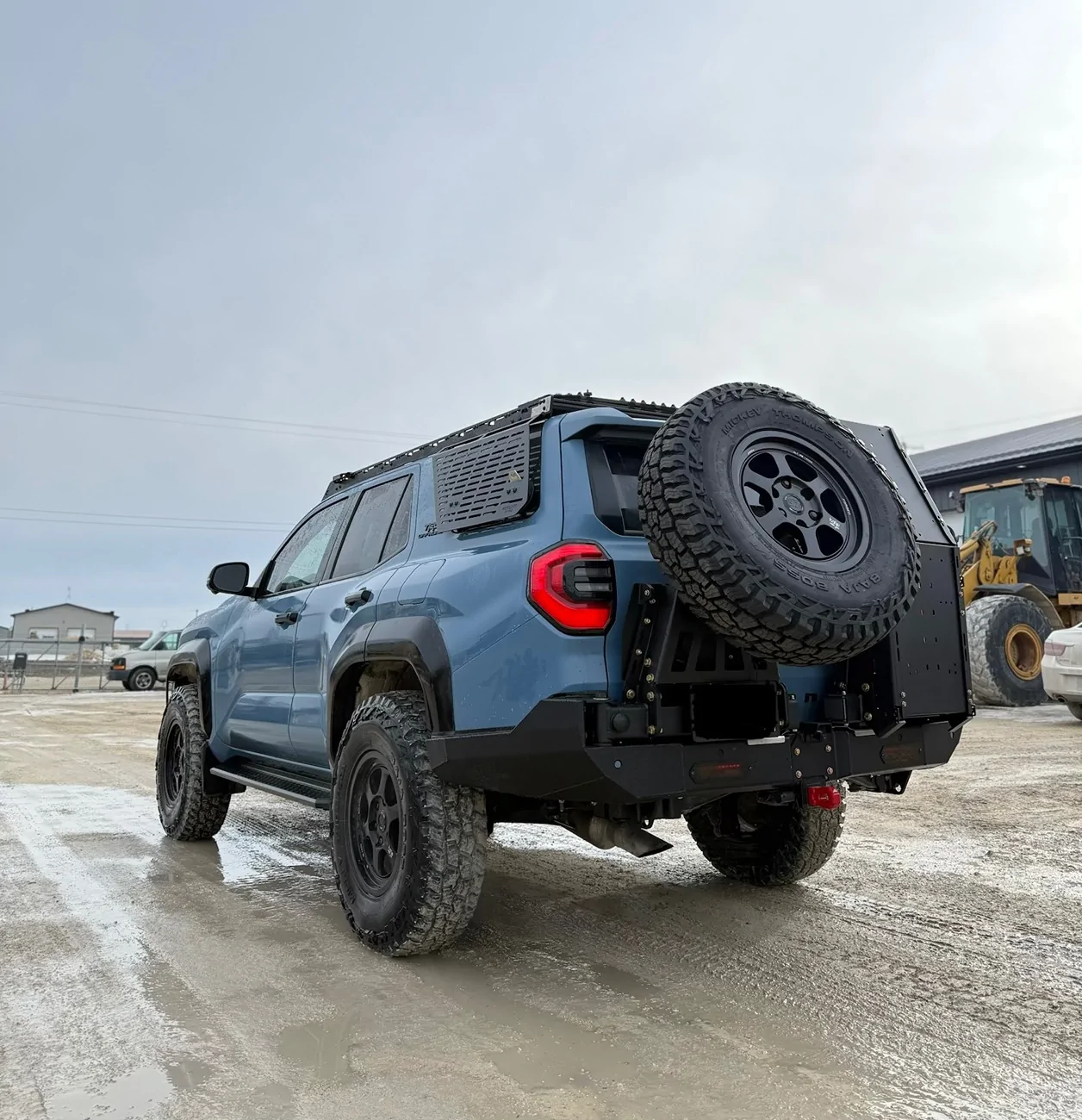

2025 4Runner Expedition Build – Overview
▣ 2025 TOYOTA 4RUNNER TRD OFF-ROAD PREMIUM
Expedition Build Spec Sheet
▣ PLATFORM
2025 Toyota 4Runner TRD Off-Road Premium
Heritage Blue
Matte PPF + Gyeon 4-Year Ceramic Coating
▣ WHEELS & TIRES
Forged 17×8 Wheels (Zhigu Manufacturing)
Mickey Thompson Baja Boss A/T — 255/85R17
Wheel Mounting & Balancing
▣ SUSPENSION
Westcott Preload Collar Lift Kit
Preload Collar Installation
▣ ARMOR & PROTECTION
OK Expedition Skid Plate Package
Dissent Low-Profile Front Winch Bumper
Dissent Dual Swing Rear Bumper
-Driver Side Tire Carrier Swing-Out
-Passenger Side Overland Panel Swing-Out
-Backup Camera Relocation
Woolwax Undercarriage Coating
▣ RECOVERY SYSTEM
Warn VR EVO 10-S Winch
Agency6 1.5" Hawse Fairlead
Agency6 Billet Shackle
Agency6 Rear Hitch Soft Shackle Block
OEM Toyota Forged Tow Hooks
Soft Shackles
Bunker Industries Traction Boards + Roof Mount
Bunker Industries Tire Deflator / Inflator Kit
TowWorks Hitch Lock
▣ LIGHTING
Alibaba Grille Fog Lights
Baja Designs Squadron Pro Amber (Grille)
Baja Designs S2 SAE Amber Fog Lights
Roadvision Rear Bumper Lights
▣ ROOF & OVERLAND SYSTEM
Westcott Low-Profile Roof Rack
Agency6 Billet Grab Handles
Agency6 Shovel + Mount
Alibaba Custom Rooftop Tent
Vanultra Low-Profile RTT Mount

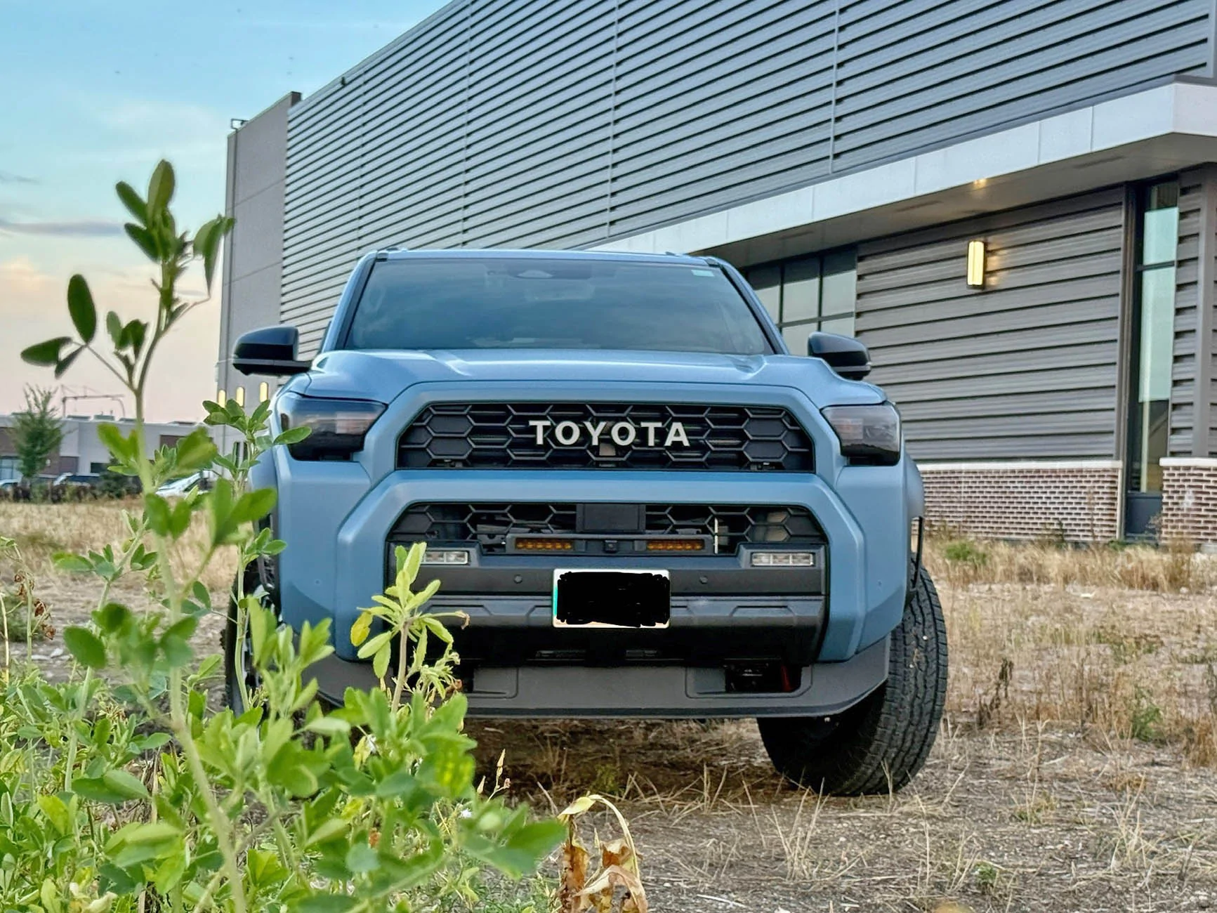

Then I swapped on aftermarket TRD Pro Grille that is optimized for TRD ORP. For those interested, it keeps the camera in the OEM position, so you do not need to extend the camera or get it recalibrated.
2025 2026 4runner 6th gen 🇨🇦 Ice Fishing Build - Dual Swing-Outs/35”/Winch ab0c03a8-f96d-47d4-b033-59c1f7d7a399-jpeg
Alibaba order, 125 USD and it comes with amber fog lights + harness.

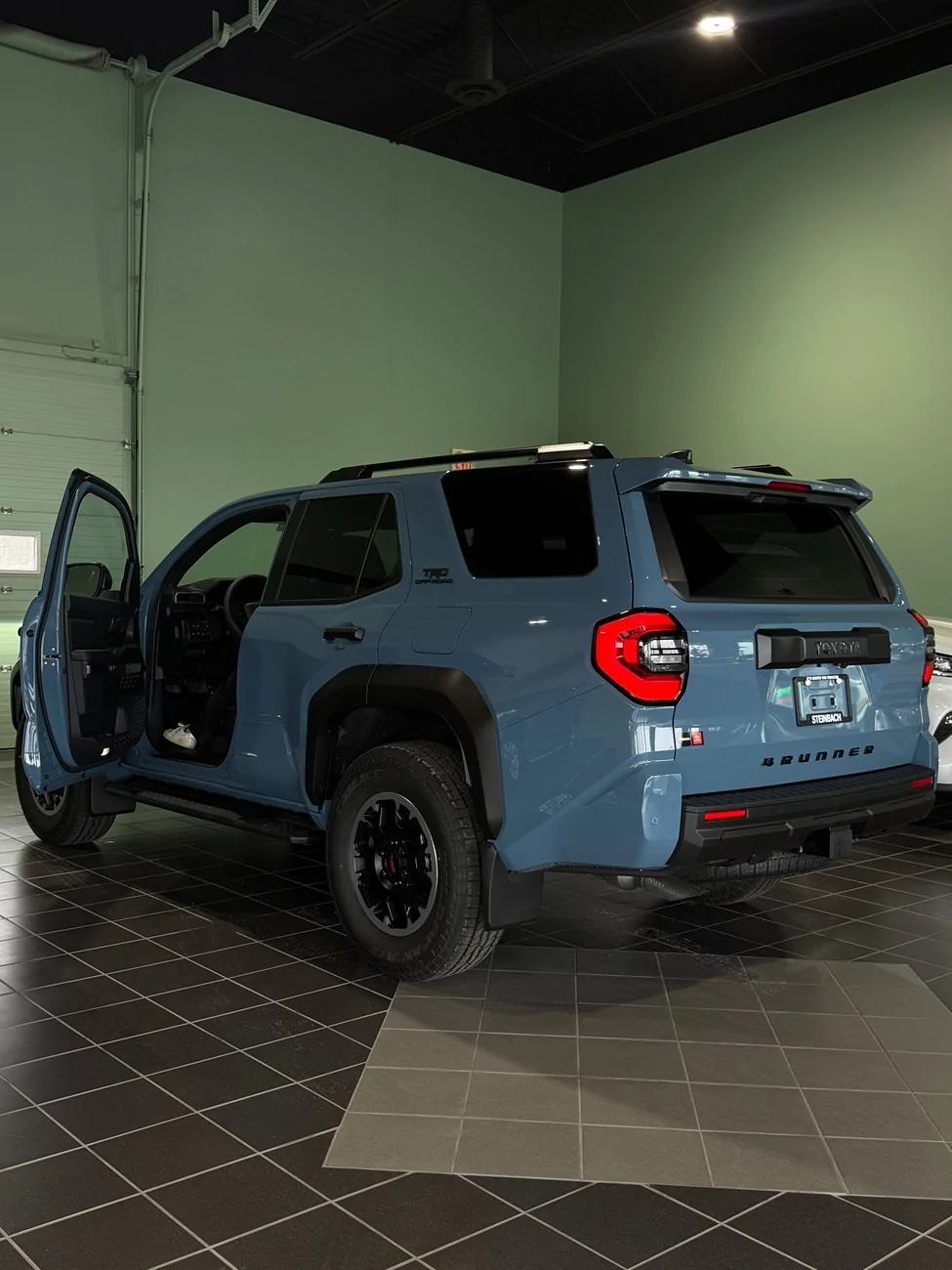

Picked it up last month and have been making a number of mods.
2025 2026 4runner 6th gen 🇨🇦 Ice Fishing Build - Dual Swing-Outs/35”/Winch IMG_2793

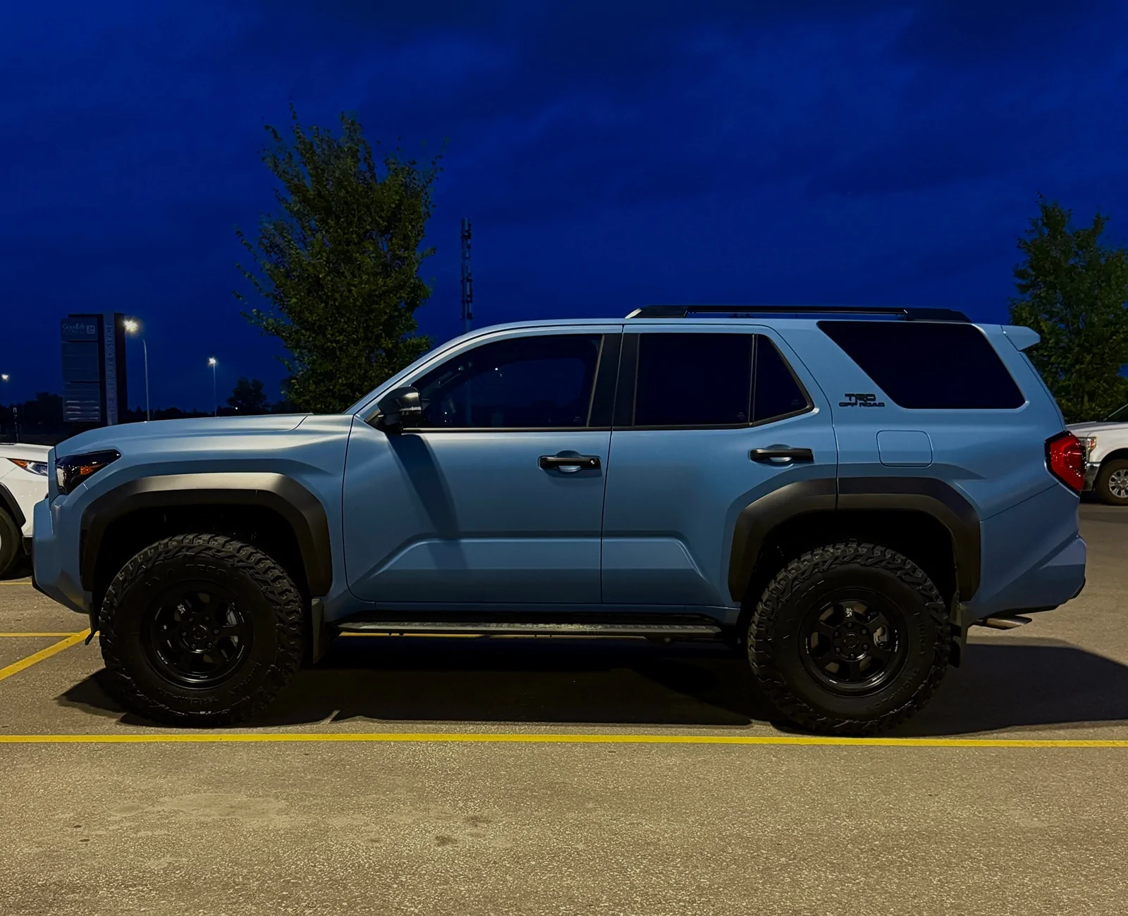

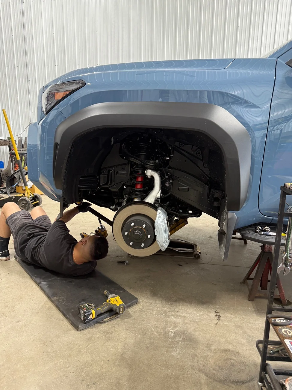

First change was throwing on Westcott Preload Collar Kit (2.5" front, 0.75" rear) with CKAutoFab in Manitoba.
2025 2026 4runner 6th gen 🇨🇦 Ice Fishing Build - Dual Swing-Outs/35”/Winch IMG_2905
Kevin getting down and dirty. There's no other man in Central Canada you would want working on your truck.
Then I took it to get it wrapped over at Modify.Me in MB.

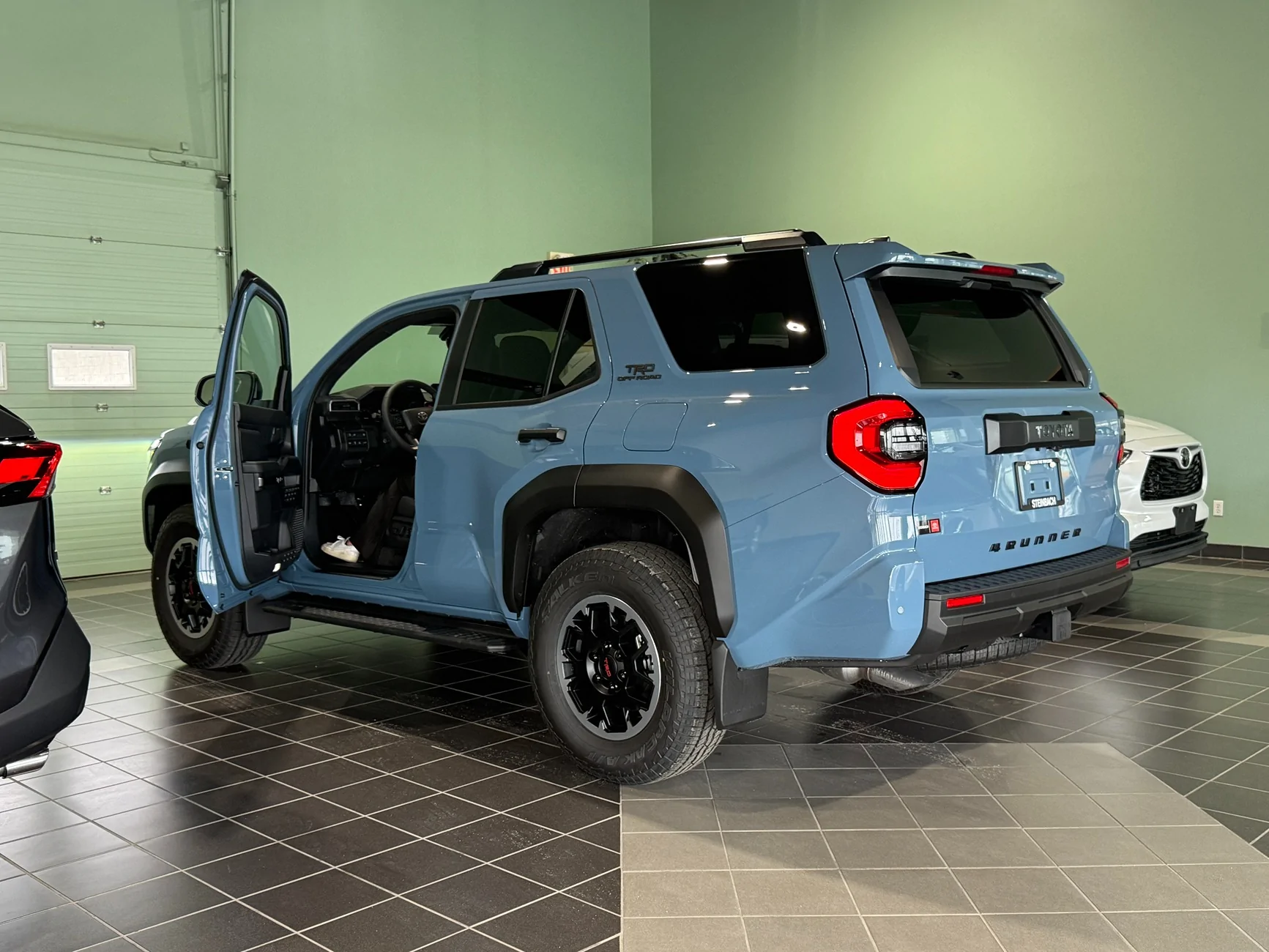

2025 2026 4runner 6th gen 🇨🇦 Ice Fishing Build - Dual Swing-Outs/35”/Winch IMG_2983

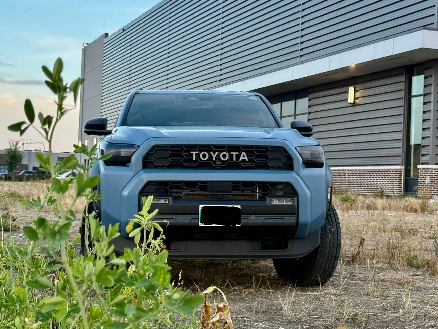

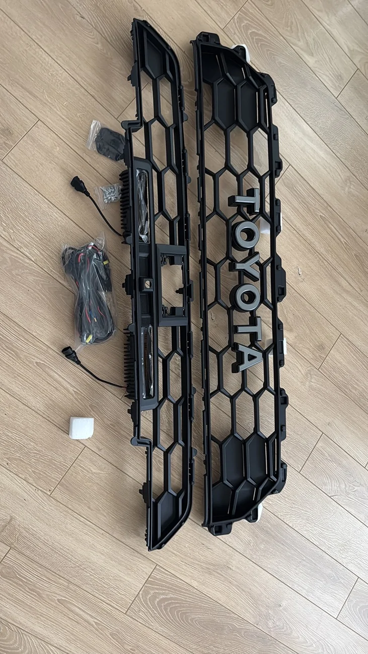

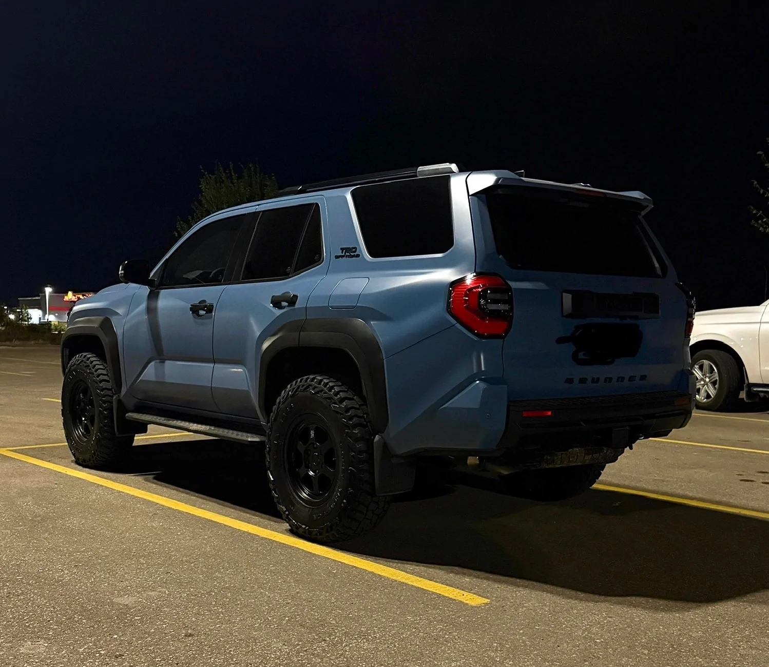

Then I swapped on aftermarket TRD Pro Grille (Heritage Grill) that is optimized for TRD ORP. For those interested, it keeps the camera in the OEM position, so you do not need to extend the camera or get it recalibrated.
2025 2026 4runner 6th gen 🇨🇦 Ice Fishing Build - Dual Swing-Outs/35”/Winch IMG_3089
Alibaba order, 125 USD+120 USD shipping and it comes with amber fog lights + harness. to order simply dm me

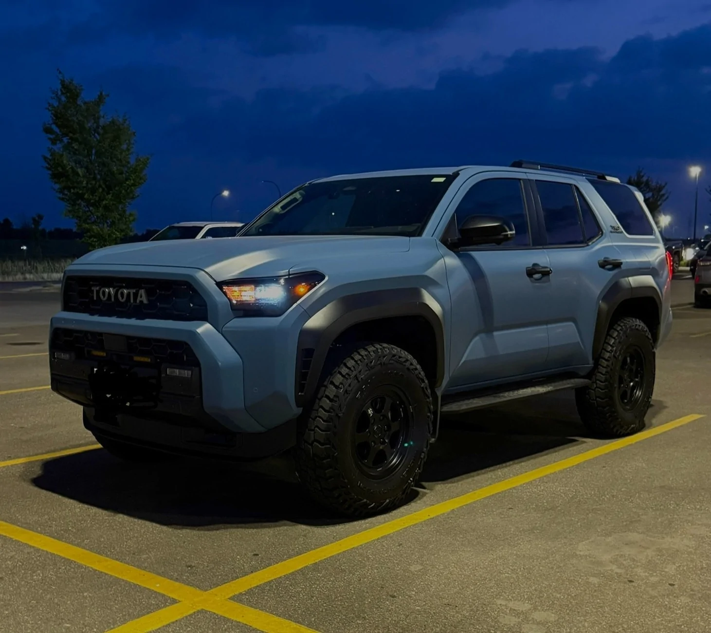

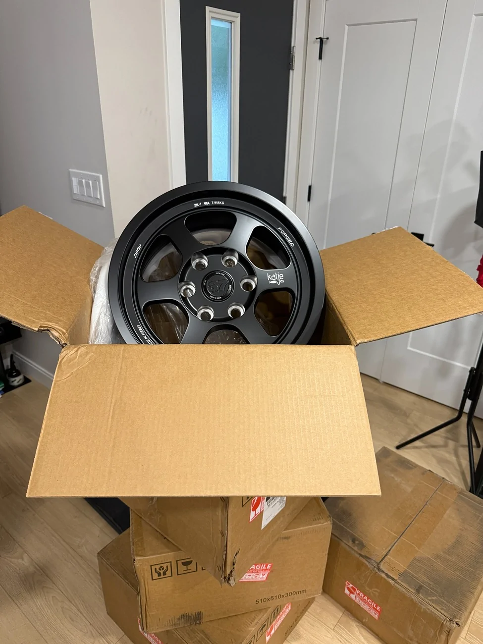

Next steps are to wrap these wheels in 255/85r17 Baja Boss A/T
2025 2026 4runner 6th gen 🇨🇦 Ice Fishing Build - Dual Swing-Outs/35”/Winch 89AB69F2-A07B-4694-B207-24BF4D72A103
2025 2026 4runner 6th gen 🇨🇦 Ice Fishing Build - Dual Swing-Outs/35”/Winch IMG_3226

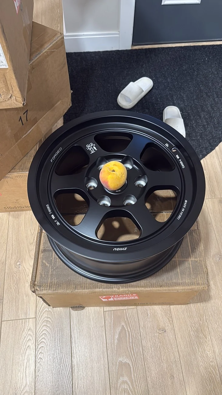

Alibaba forged wheels from Zhigu, 1450 USD for set of 5, 9.8 kg per wheel. 17 X 8" +30mm

Hey Van thanks for your question and points. I’ll try my best to tackle them point by point.
1. The width will be reduced by half an inch and height increased by 2 inches. The real problem I might have is in the increase in scrub radius. But in terms of safety, these tires will provide better load bearing capacity than OEM falkens.
The pizza cutters are known to have better performance in snow than their wider counterparts.
2. Speedometer isn’t much of an issue, something that we will learn to adapt too
3. Narrower tires with lower psi actually offer more grip. And going through the snow in MB I think I will gain an edge. Not lose it
4. As for aesthetics, I don’t mind it at all
5. As for potential for increased wear, I’ve “offset” that as best as I could with the +30mm offset while increasing 2” in height. The narrow tires will mean I will be doing less wheel well modifications to fit 34.5” tires
