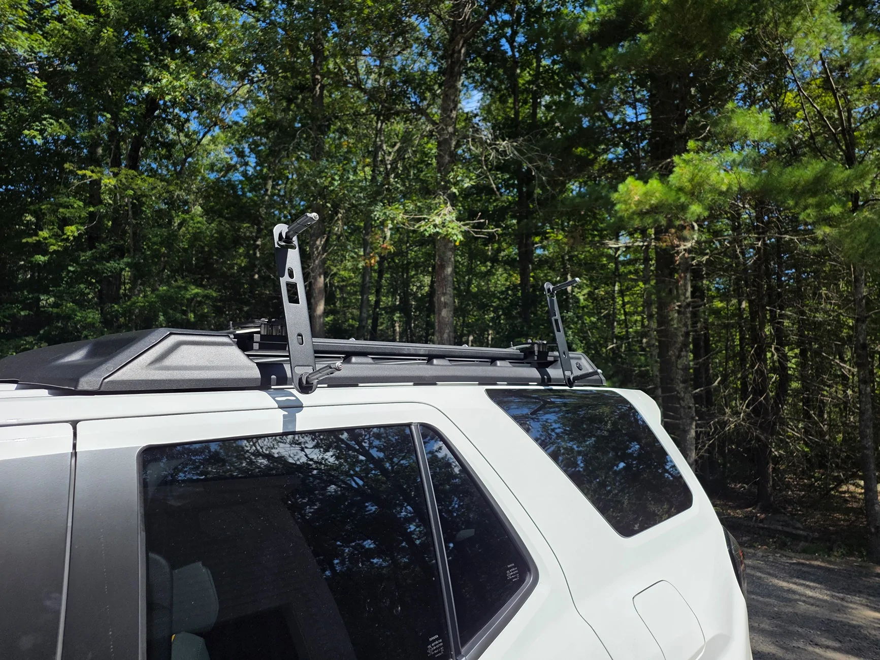

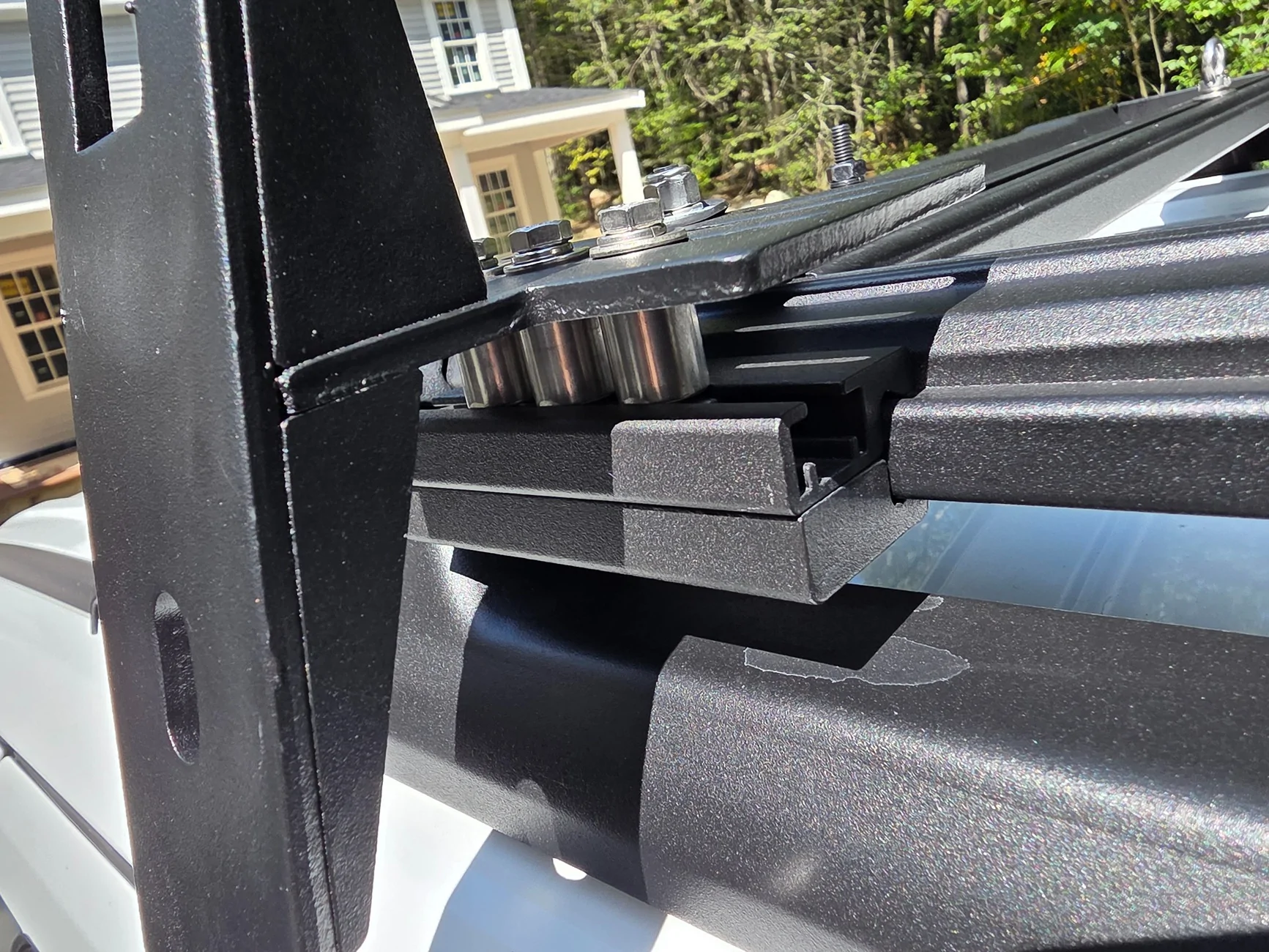

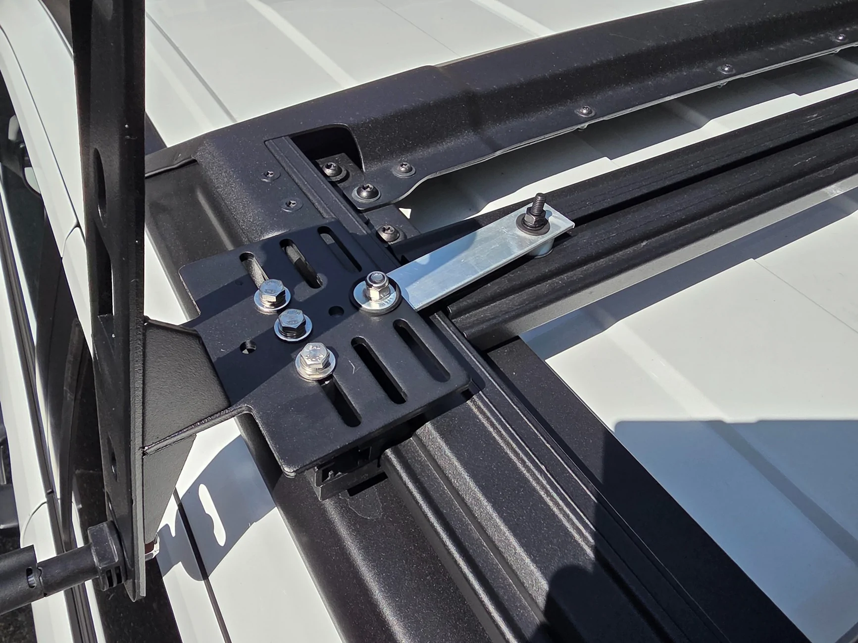

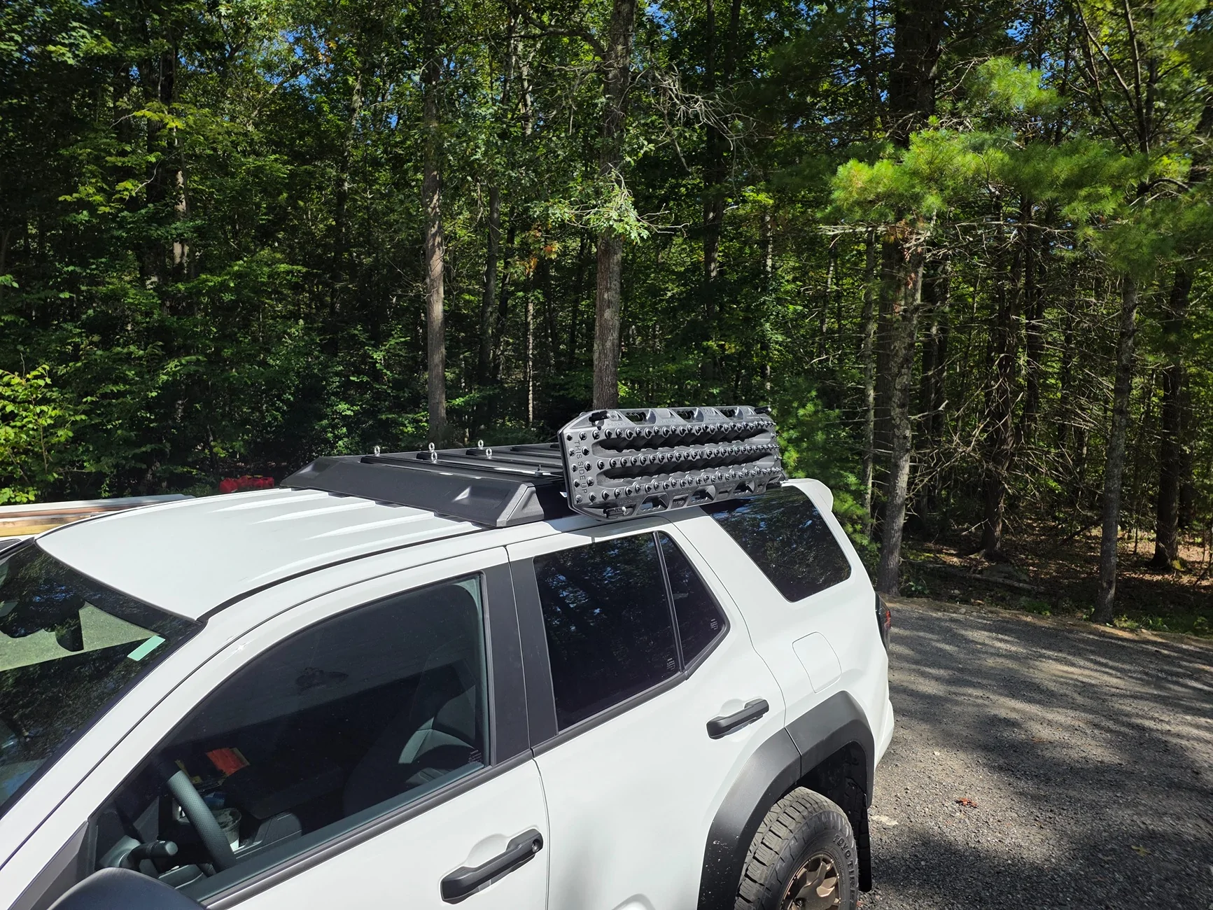

I don't right now, and my car is getting some work done so I can't get some for a few days.
I used these mounting brackets as you saw in the post above:
Maxtrax Mounting bracket - https://a.co/d/8fq0jE1
To get them to work I bought a couple of the T-track attachments from ARB - https://a.co/d/55FDxg8. Then I realized that they hang a bit too low and prevent the doors from opening, so I elevated the brackets using some aluminum spacers - https://a.co/d/i6c4FUX.
Then to give it a bit more strength I made an additional fastening point out of some aluminum bar stock from Home Depot and used this T-track hardware to connect each bracket to the cross bars as well as the side bars - https://a.co/d/bWpEIvU.
I know that sounds like a lot but it only took about 30 mins once I figured out what I wanted to do. It's much stronger than just the brackets alone. It also only takes about a minute to put them on and take them off the rack.
I will post some pics once I get the car back.

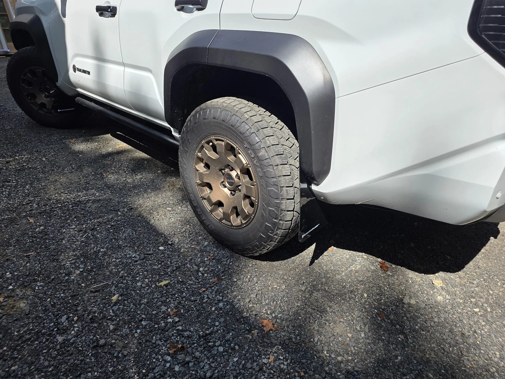

Here are some views of the car. Close ups of the maxtrax brackets, andI just added the Rally Armor mudflaps.

Awesome! Thanks so much for the explanations and pics! I really thought it would be more straightforward, and it has not been haha. Appreciate it.

Yeah, it was a pain. Lots of ways to mount on top but limited for side mounts.
