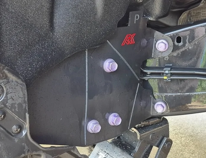

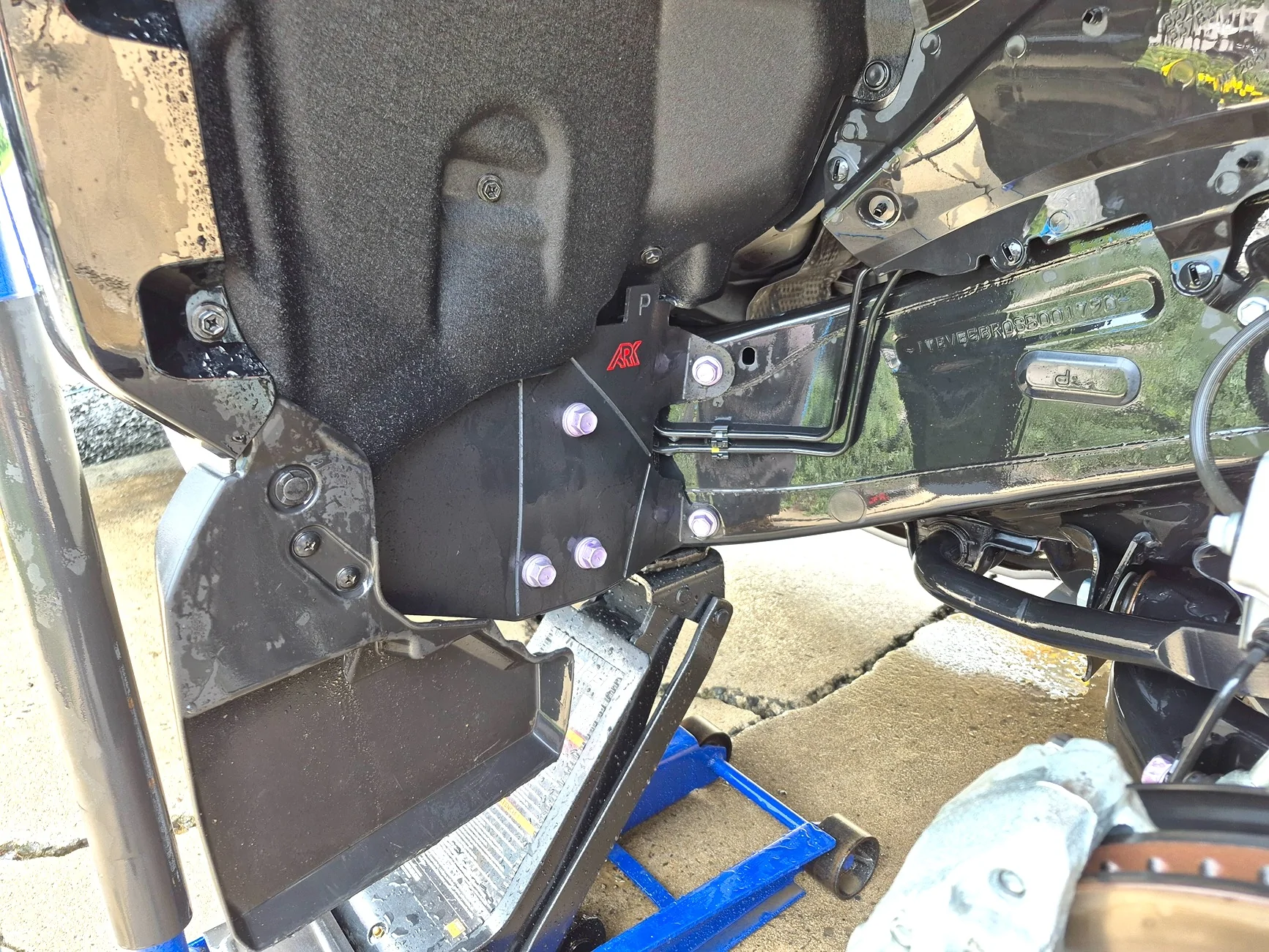

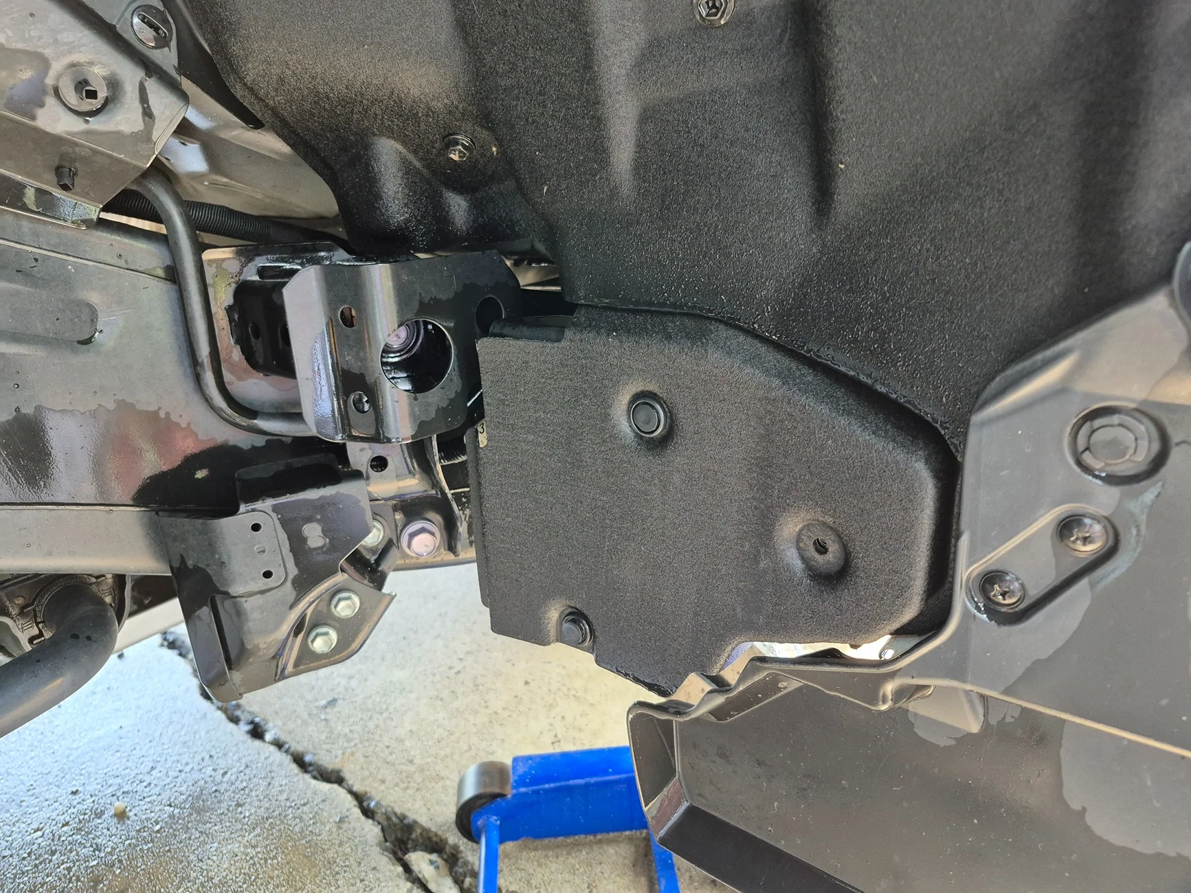

Finally got the ARK crash plate delete covers installed. I didn't rub my tires unless I was going up or down a steep grade and turning full lock but I tend to do that every weekend.. lol
I was hoping for these to help keep some of the mud and grit out of the hole deleting the crash plate creates but it'll need to be tested. Might actually trap the gunk and make it harder to clean out... Juries out, will report back...
Was going to do a writeup on removing the crash plates but there's already a couple of those posted.
Crash plates came within a few days of ordering them, plenty sturdy and I think they'll hold up. I like that they slotted the holes, makes install and ability to set them flat in a good position easy.
Installing these was simple, once the crash plate is removed, position the cover in place by bending them at the designated lines and mold them to the frame, install OEM bolts, I'm gonna probably end up getting black bolts to replace them, but don't over tighten. They will deform.
I've read where some had to remove their mudflaps to install these, on mine I didn't have to, they fit right up against the screws which kinda holds them in place.
They could probably be installed with some finesse without removing the tire, but I'm old and my finesse days are over...lol I just removed the tires and even with the added time it probably was easier.

Before:
2025 2026 4runner 6th gen ARK Crash Plate Delete Cover installed 1-1
After:
2025 2026 4runner 6th gen ARK Crash Plate Delete Cover installed 3 (1)
2025 2026 4runner 6th gen ARK Crash Plate Delete Cover installed 3 copy
