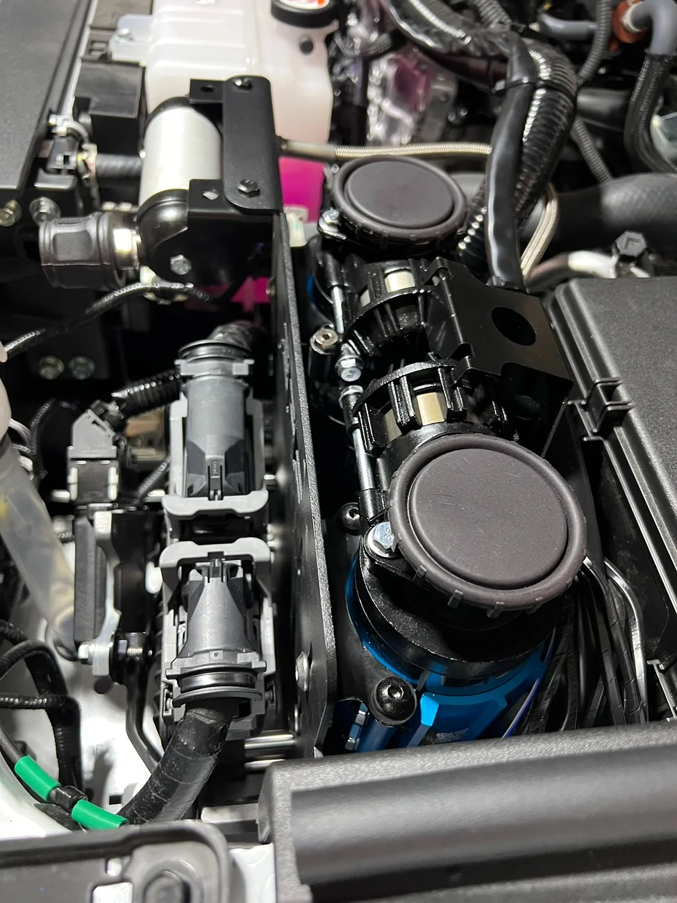

Finally got the time to get this done on my Platinum.
Install went pretty smooth, no hiccups.
I got the HF twin, basically same as the old ARB since they were the manufacture for the old ARB twins, but 1/3 of the price.
This thing pumps air 10x faster than my Dewalt portable.
2025 2026 4runner 6th gen Air compressor installed with BPF 2025+ 4runner twin compressor mount IMG_1873
2025 2026 4runner 6th gen Air compressor installed with BPF 2025+ 4runner twin compressor mount IMG_1872
2025 2026 4runner 6th gen Air compressor installed with BPF 2025+ 4runner twin compressor mount IMG_1874
2025 2026 4runner 6th gen Air compressor installed with BPF 2025+ 4runner twin compressor mount IMG_1875

How did you get power to the unit. Just finished the bracket install, now just pondering running power

Fuse bot at the passenger side of the vehicle (when looking at engine, left side)
got my idea from here:

Okay great! Both reds to that single connection and ground out wherever you can find it?

Yeah the negative to where ever connected to chassic, just not direct to the jump connection in the fuse box.
For the red, go with the small one, the big one you may have to cut the plastic that is holding it, which I don't like so I went with the small one.
