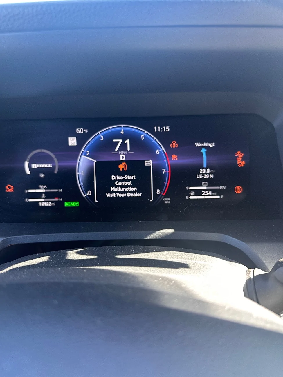

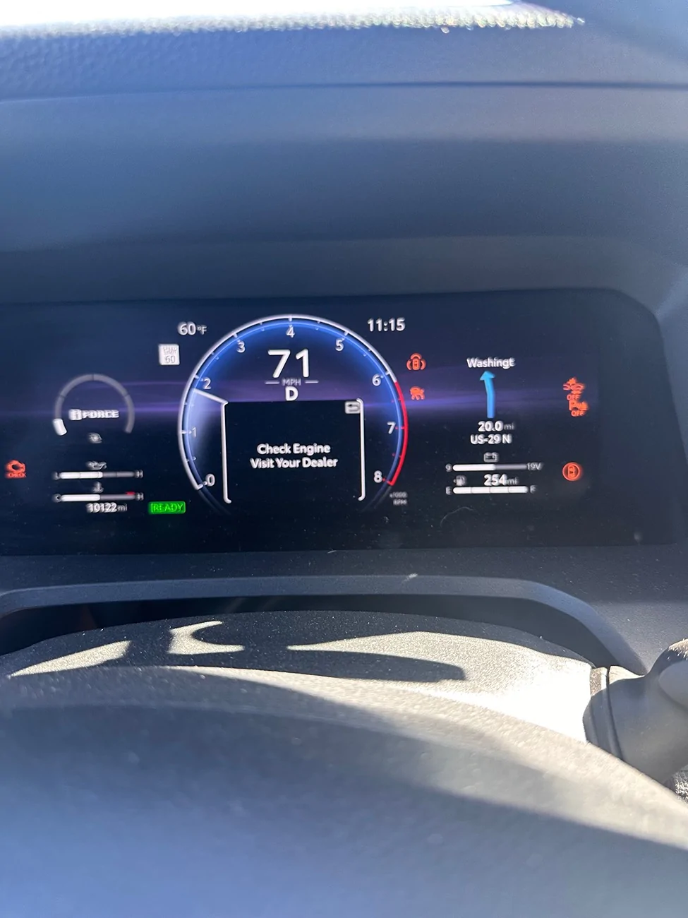

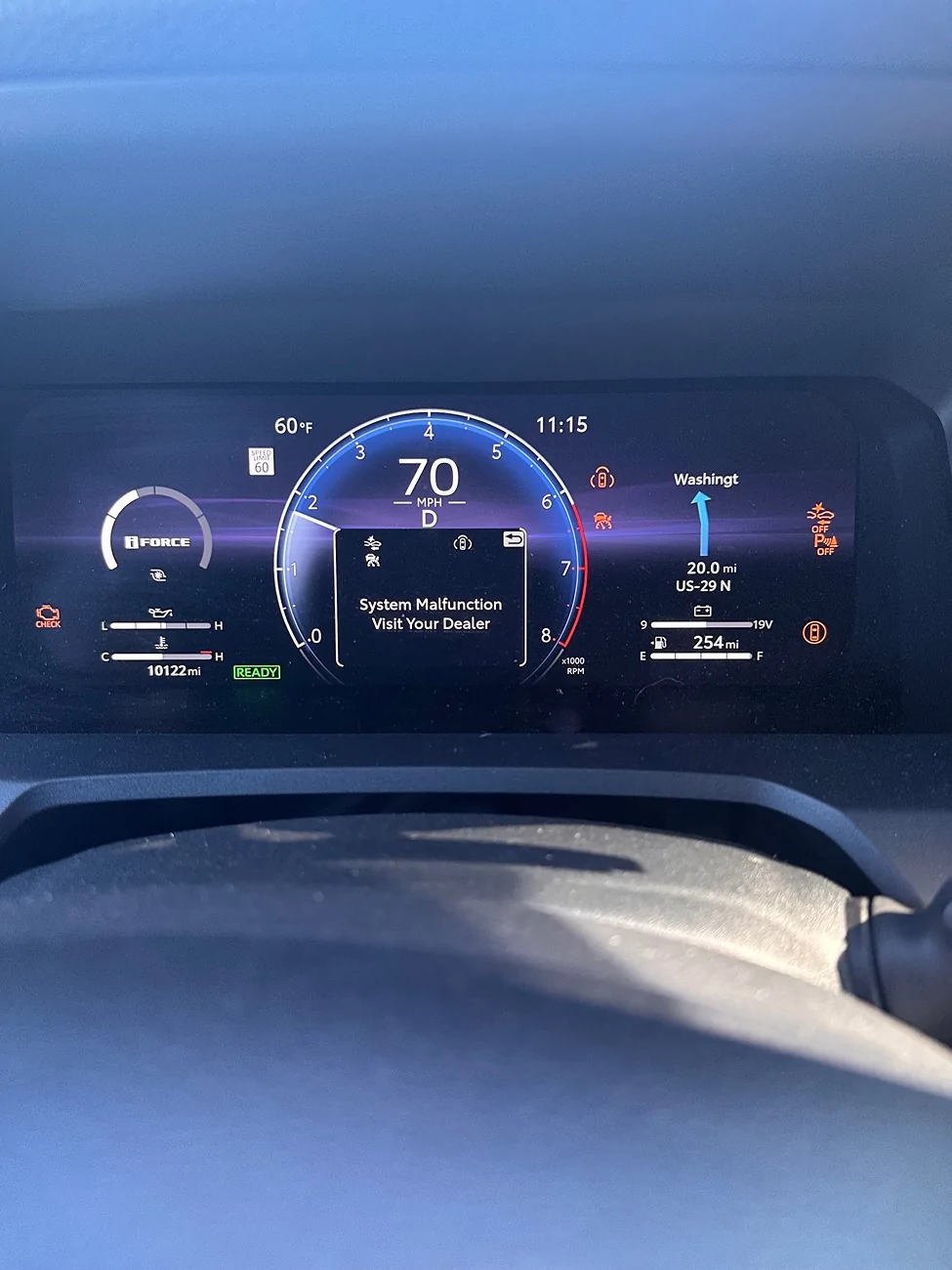

Was down at Overland Expo East this weekend. Beautiful weather and got to see lots of cool rigs. Got there Thursday. On Saturday I opened my rear hatch to do some stuff and had it open for quite a bit. Went to close it and ‘dead’ - like zero power. Thought, that’s odd. I am running my fridge and everything else off my power station. Had all my interior lights off if I opened doors and had separately powered lights I used. I do have a kill switch that I know has very small parasitic draw if you don’t turn it on, but I had it on. So went to start the car and it was dead. Like dead. Nothing even lighting up on the dashboard. Pulled out my Noco, dead. 🤦🏼‍♂️ So guy next to me jumps me with his Noco. Takes many tries but finally starts. Let it run for a bit. Figure it’s okay. This morning go to leave, dead again. Noco doesn’t work after several tries. . So guy jumps me old fashioned way and it starts up. But I now have check engine light and the following messages flashing. Drove 6 hours home and worked fine but I never shut it off, even when I filled for gas. No freaking clue what is going on.

If I had to guess, I would say you have a bad battery. Do you have a code reader or any way to read your voltage?

You likely triggered a bunch of low voltage codes. As to why this happened to begin with? I cannot really say I can only speculate that the engine may have timed out and turned off? Or maybe there is some overload protections that may have been triggered?
