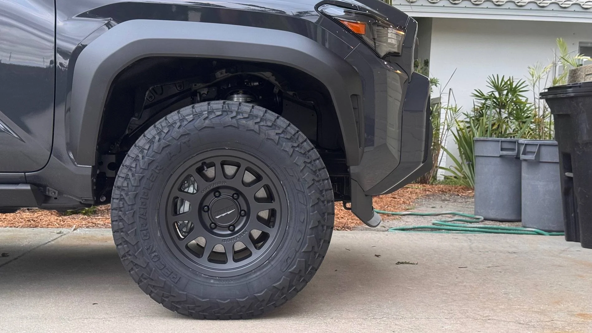

I am running 33’s but on a 0 Offset and I went with a 2.5 collar lift in front. I still rub a little bit in reverse full turn of the wheel. So watch your offsets

We started getting a little rub when full lock in reverse even with the collar lift. Nothing major but I felt it the other day. Its mostly due to my offset being zero.
If you dont want any rubbing I would try to keep the offset on the positive side for sure.
