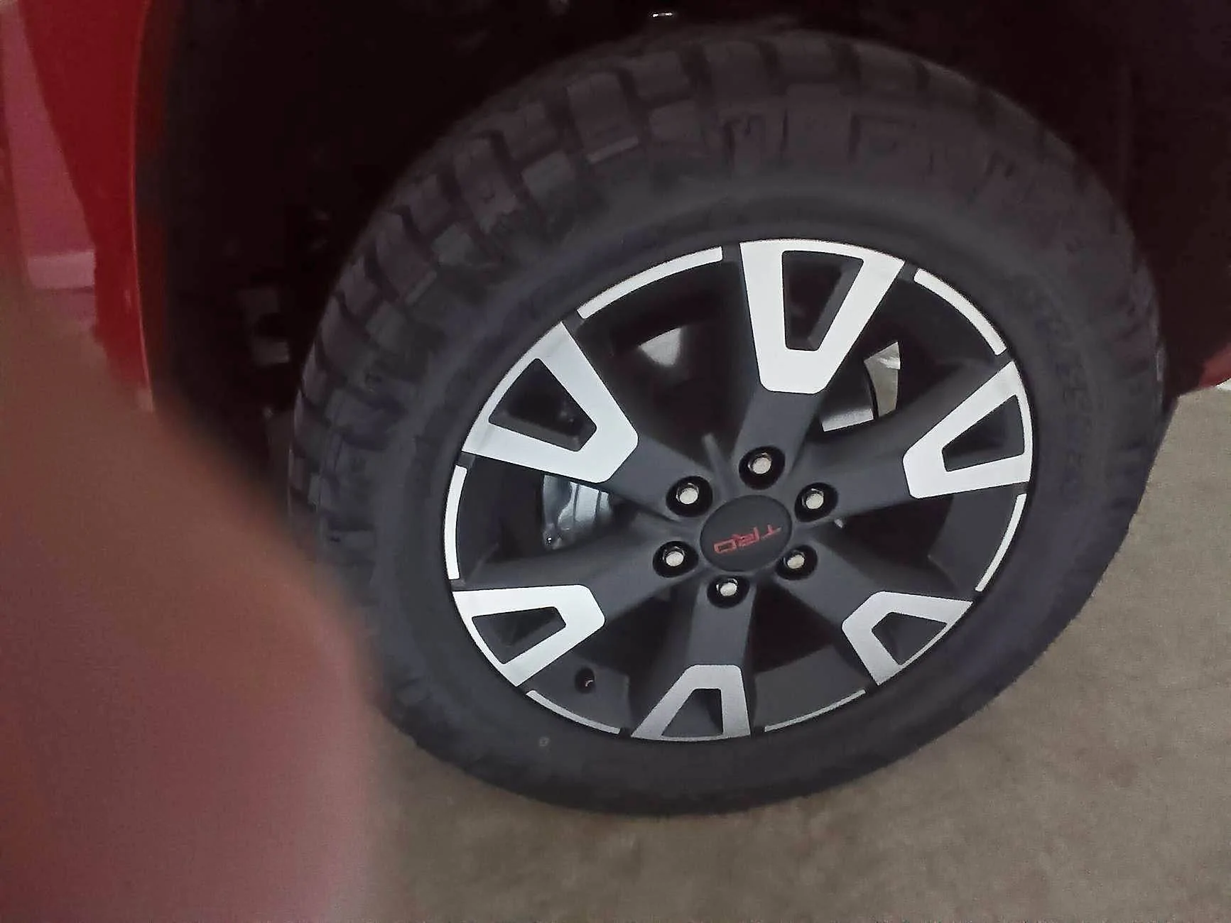

This is what I upgraded to - Nitto Ridge Grappler AT tires in 275/55R20 size.
No lift kit. No rubbing and are not noisy. Surprisingly smooth on the road.

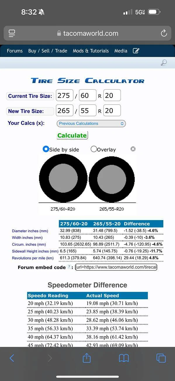

Are you changing wheels? If so, what? And are doing a 1" level kit to get the extra clearance?
The 275/60/20 are 33” tall . Many members upgrading their 18” rim to 33” tires. Thirty three is 33” your side wall and width will be different . Most companies 265/55/20 about 10.43” wide. The 275/60/20 are 10.83 wide
