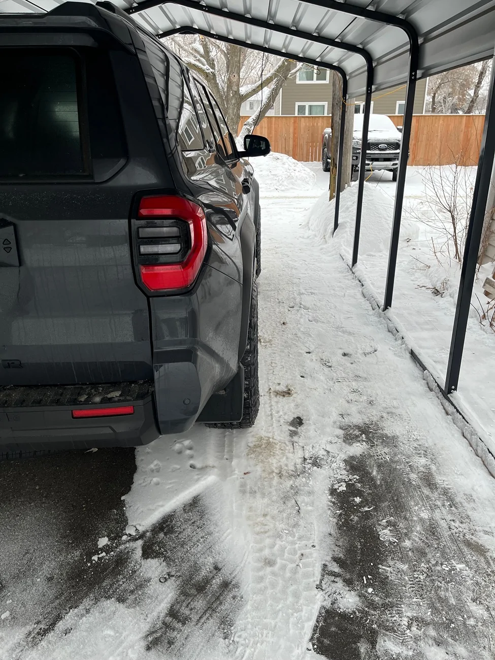

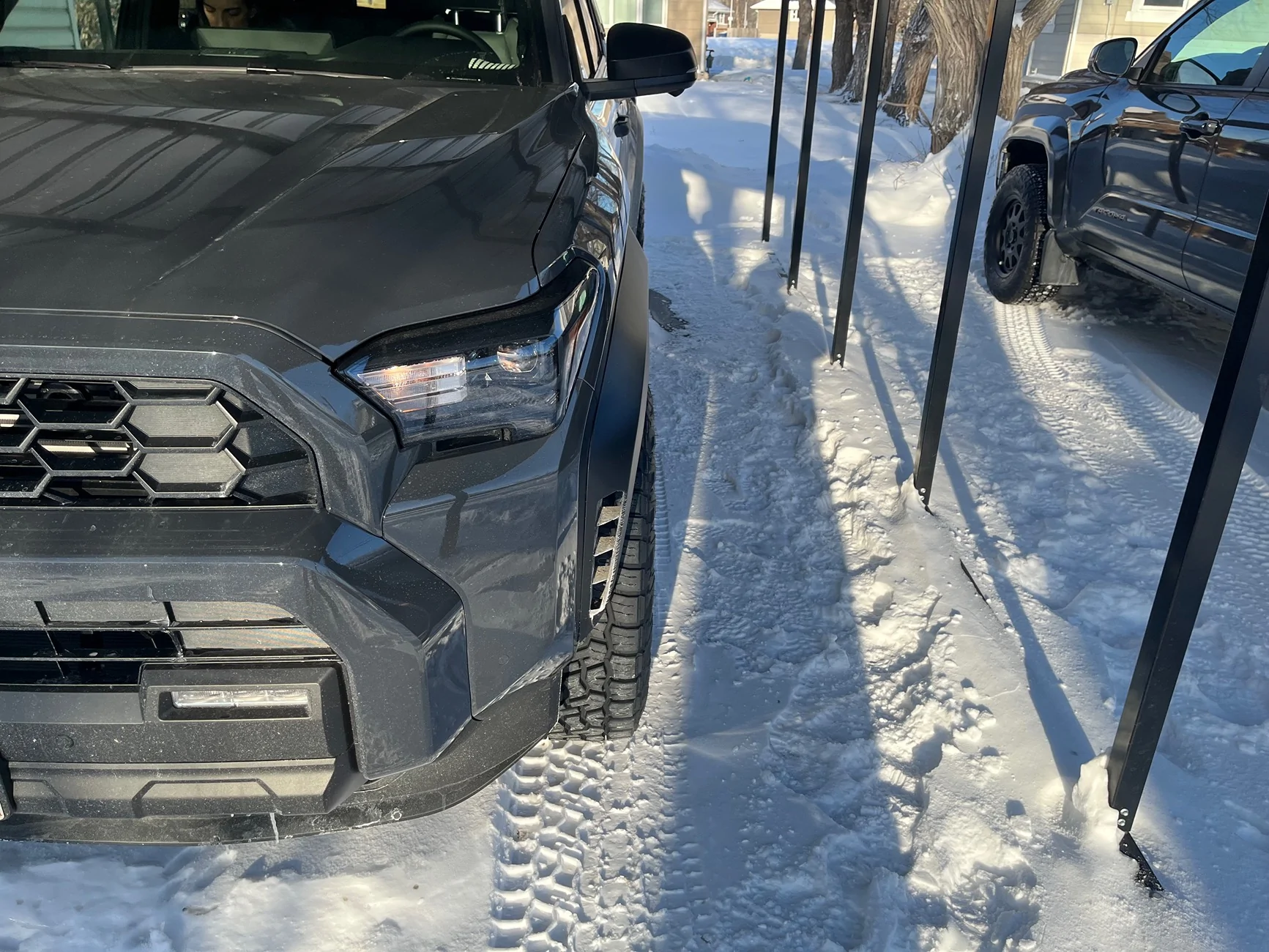

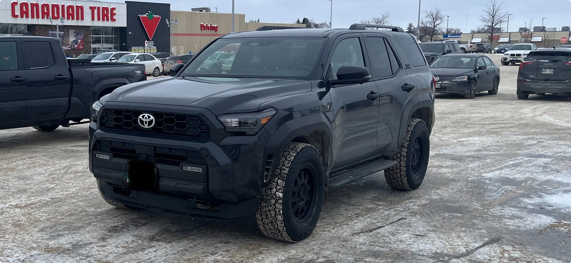

I’m running that tire size. Plenty of room. No rubbing (not even close)
Rubbing will be non existent. I’m running trd off road wheels from a 4th gen Tacoma powder coated all black.
do you have any pics? getting a trd sport, hoping to put 285-70-17 with +35 offset
