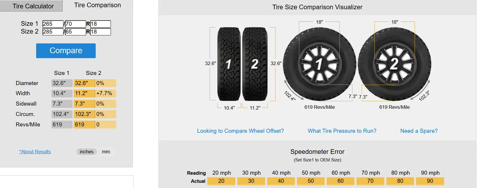

Thanks for the insight. I like the idea of a lil taller but about the same width or slightly wider if I can find a C range tire.
I didn't realize the 285/65/18 was about the same height and only wider than the stock tires.
Basically looking at around a 33 but staying same width. And seeing that type of tire on the stock ORP rims.

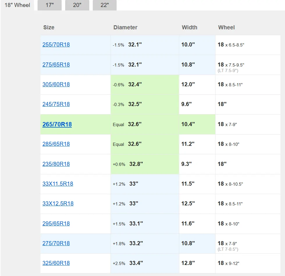

you can also compare oem size and see the safe zone of comparable sizes you can fit also (green zone)
