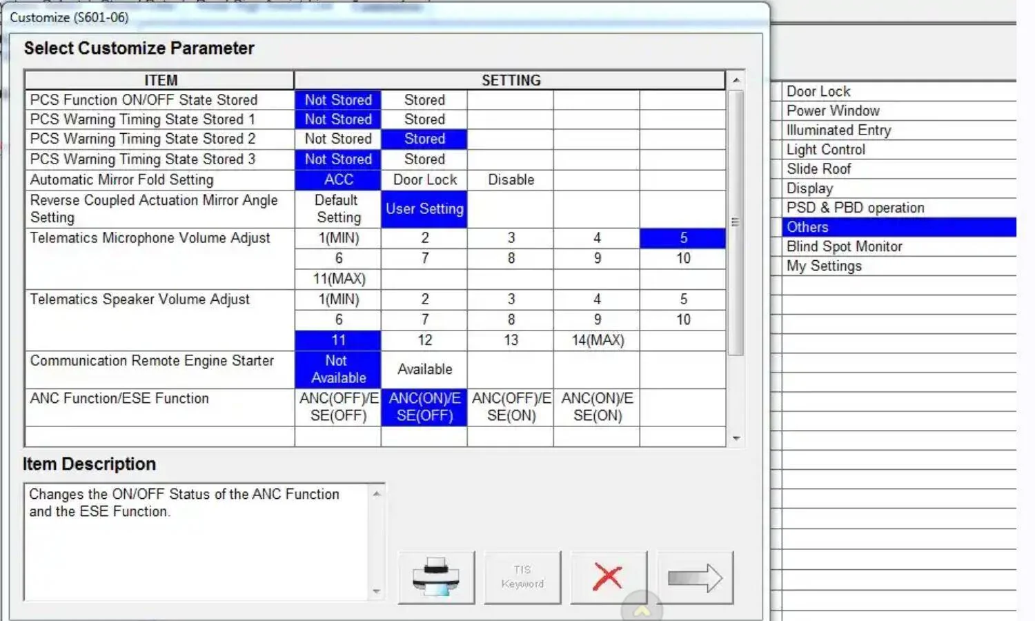

we turned it off on our 23 tundra platinum via carista (or techstream if you have it on a laptop or can get the dealer to turn it off for free)

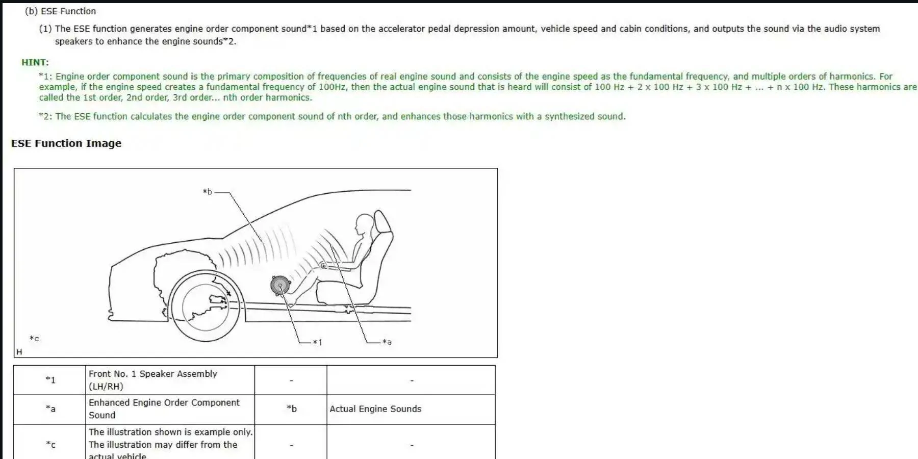

the way toyota pipes in fake engine noise is mostly noticable at lower speeds. once you get up in speed its toned down in volume somewhat, but its also dependent on headunit volume.
the fake engine noise volume is independently controlled by another module outside of the headunit volume control.
37
2,070
1,166
here is more info...
The "fake engine noise" setting on a Toyota is called "Engine Sound Enhancement" (ESE), and it can be accessed and adjusted through the vehicle's onboard diagnostics system (OBDII) using a tool like a Carista adapter, allowing you to turn it off if you wish to hear the real engine sound without the enhanced audio simulation; most often, this feature is found on sportier Toyota models
here is better explanation and pics of techstream (its not accessible by the customer directly)
forgot to add, the ANC is noise cancellation feature

Can any obd app like Torque turn it off or only Carista can do it? Carista app is a subscription-only app.
torque is mostly a read only app and reset codes. you have to be able to do what techstream can do and change variables. carista mimics techstream so thats how that app works.
and you can pay like $10 for a month and be done with it. i gave up trying to keep techstream on a laptop, just easier to pay $10 for a month test things out and set what i like/dont like and never change them for the life of the vehicle.
just less hassle in the long run

Thank you. Didn't know we can pay per month. That'll work ?
