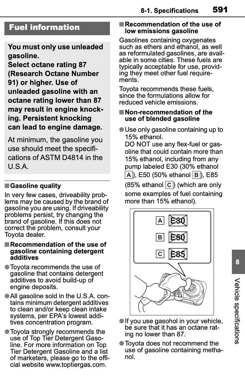

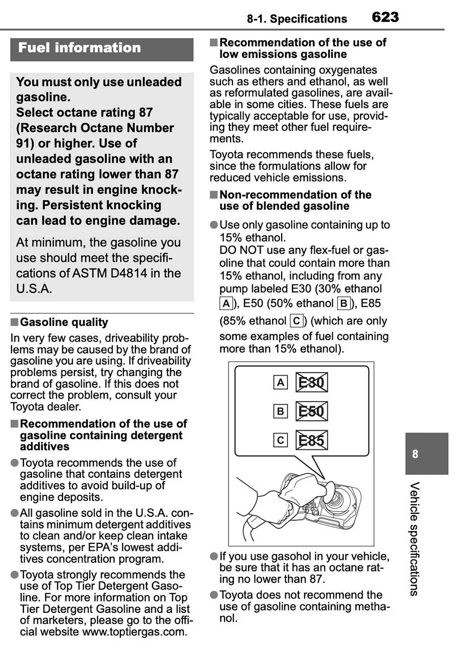

For reference -- here's what the 2024 Tacoma owners manual say about fuel grade / octane:
You must only use unleaded gasoline.
Select octane rating 87 (Research Octane Number 91) or higher. Use of unleaded gasoline with an octane rating lower than 87 may result in engine knock-ing. Persistent knocking can lead to engine damage.
Source:
Tacoma owners Manual (Gas / non-Hybrid)
Tacoma owners Manual (Hybrid)
Gas engine (2024 Tacoma):
2025 2026 4runner 6th gen Premium fuel 91 octane gains 20 hp / 14 lb-ft torque (vs. 87 octane) on gas engine 2.4L i-Force -- dyno test Screenshot 2024-12-13 at 5.54.53 AM
Hybrid engine (2024 Tacoma):
2025 2026 4runner 6th gen Premium fuel 91 octane gains 20 hp / 14 lb-ft torque (vs. 87 octane) on gas engine 2.4L i-Force -- dyno test Screenshot 2024-12-13 at 5.55.20 AM
