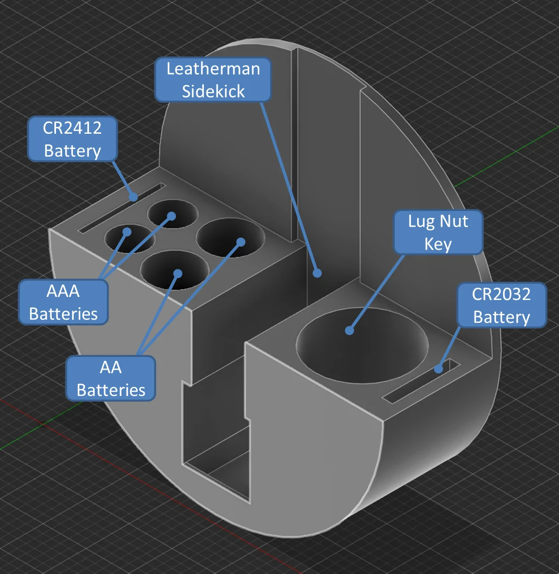

I got bored on a 5hr flight and figured I would make the "secret cubby" organizer. The main things I wanted to store are the lug nut key and a spare battery for the key fob (and card fob). I was also able to fit in a Leatherman Sidekick (though I'm sure other small multitools would fit). On the back there is a cut out for 2 command strips to help hold this in place (some velcro strips would work too, though they might need some trimming). I added some moleskin to the inside of the upper Leatherman cutout to help hold it into place and help silence any rattling. I think a slot or 2 for keys would be a good option, but with how easy it is to break into vehicles, I thought it might be better to not include it... STL included so you can add yourself if you think it is an acceptable risk.
NOTE: the point of this organizer is not to be something you use daily, just something you use in a pinch (key fob/headlamp goes dead, wire needs cut, etc)
Download the STL file: https://www.4runner6g.com/forum/att....44585/?hash=150193f05f6807d93562383f8201d05b
STL image

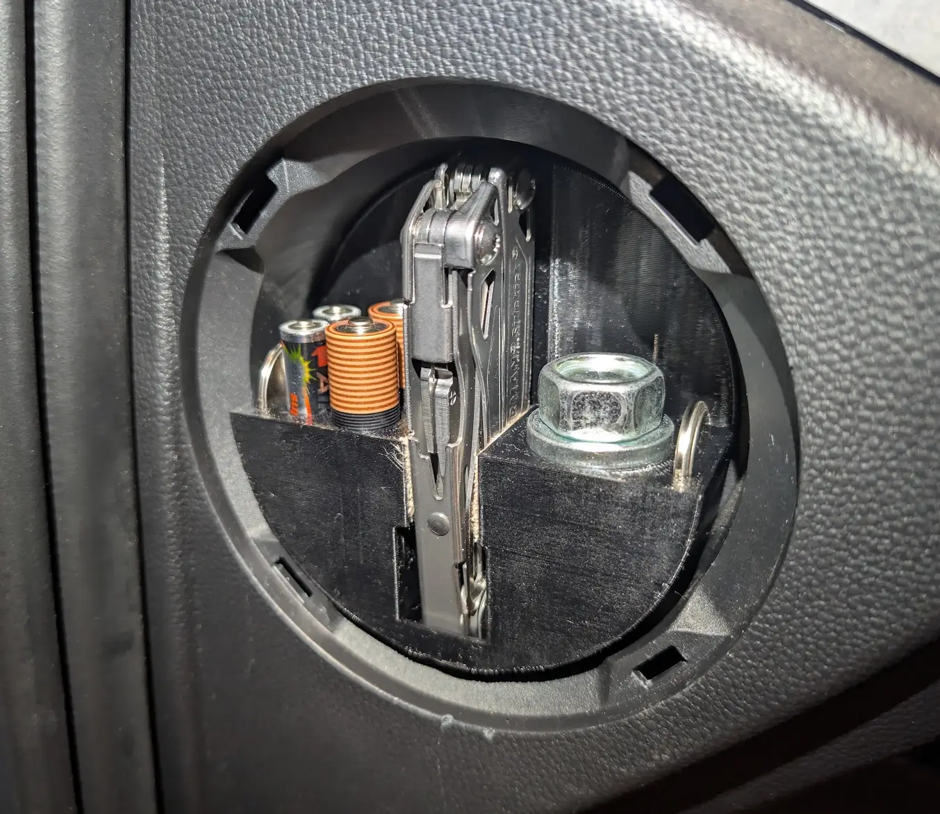

Installed Image
2025 2026 4runner 6th gen Secret Cubby Organizer 3D Print DIY (STL included) {filename}
(Black plastic doesn't photograph as nice as the grey stuff from the other post, sorry!)
Some notes:
  • Command strips do not stick to the plastic in the cubby very well
  • A layer of moleskin on each side of the Leatherman stops it from shaking (maybe have it wrap around to the front of the organizer to stop fraying and improve longevity)
  • I removed the pocket clip on the Leatherman to help it fit better
  • Getting batteries out is a little challenging, but with command strips (or velcro) pulling out the organizer isn't an issue
Potential modifications:
  • Adding an angle/champers to help guide the multitool in
  • Key slot (at your own risk)
  • Slots for some common socket sizes
  • Socket wrench or screwdriver with different tips
  • Flashlight
  • Air Tag/Pixel Tag (go Android) if you forget your parking spot often
  • CR123 batteries
Enjoy! And if you make some changes take a pic and share!

This is really cool. Wonder if it fits the Toyota Leatherman I got that fits in the cubby? This would be a way better replacement than the OEM-style holder since it holds so much more. Curious if the measurements are the same.
ROBERT18452
Robert
Jun 9, 2025
151
72
Scranton, Pennsyltuckey
25 Gen6 4runner limited
My FUEL wheel lock is much longer than what you depict. Most likely it will not fit.
127.0.0.1
876
764
earf
a bunch of Toyotas
keyfob takes a CR2450...5mm thick
not 2412 nor 2032
and why not an 18650 holder ?
all my lights (flashlights or headlamps)
I may have in or around the 4runner use 18650's
