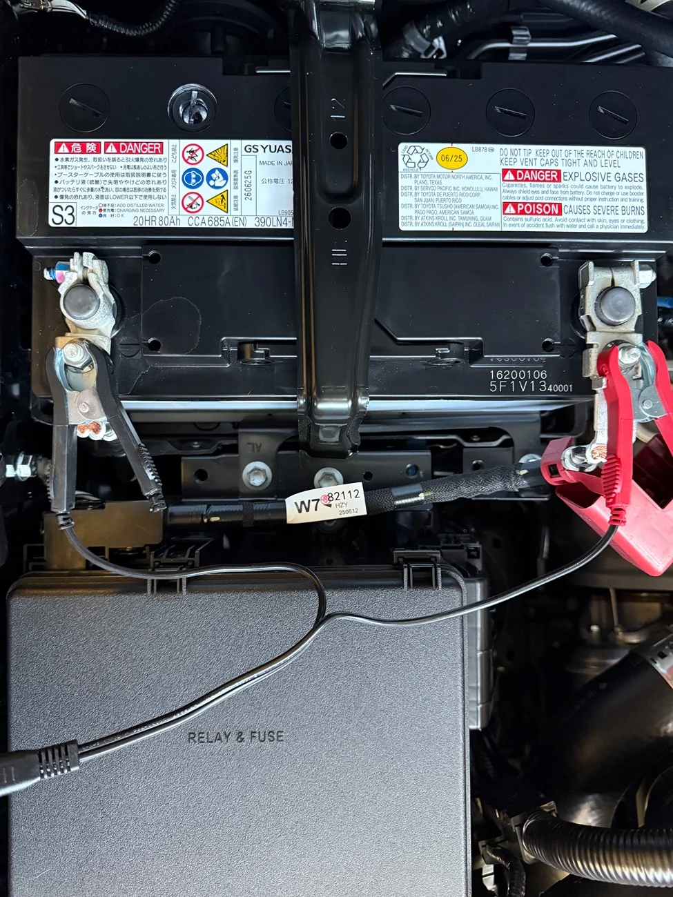

Here's my battery. If anyone can confirm that this is one or the other.
2025 4runner 6th gen 12v Volt Battery- Traditonal Flooded Lead Acid or AGM IMG_9030
I do think it's the Traditional Flooded with the vent caps on top of battery.
I believe AGM batteries are completely sealed.
Need the experts to chime in. My knowledge about car batteries is limited.. Thanks.

It's a traditional flooded battery in your pic as the AGM's are completely sealed. The AGM usually have AGM marked somewhere on it. You can always look in your owner's manual as they would specify the recommended or required battery type.

Thanks @djw4run! I appreciate your help! Now I have peace of mind that I'm charging in the correct settings!

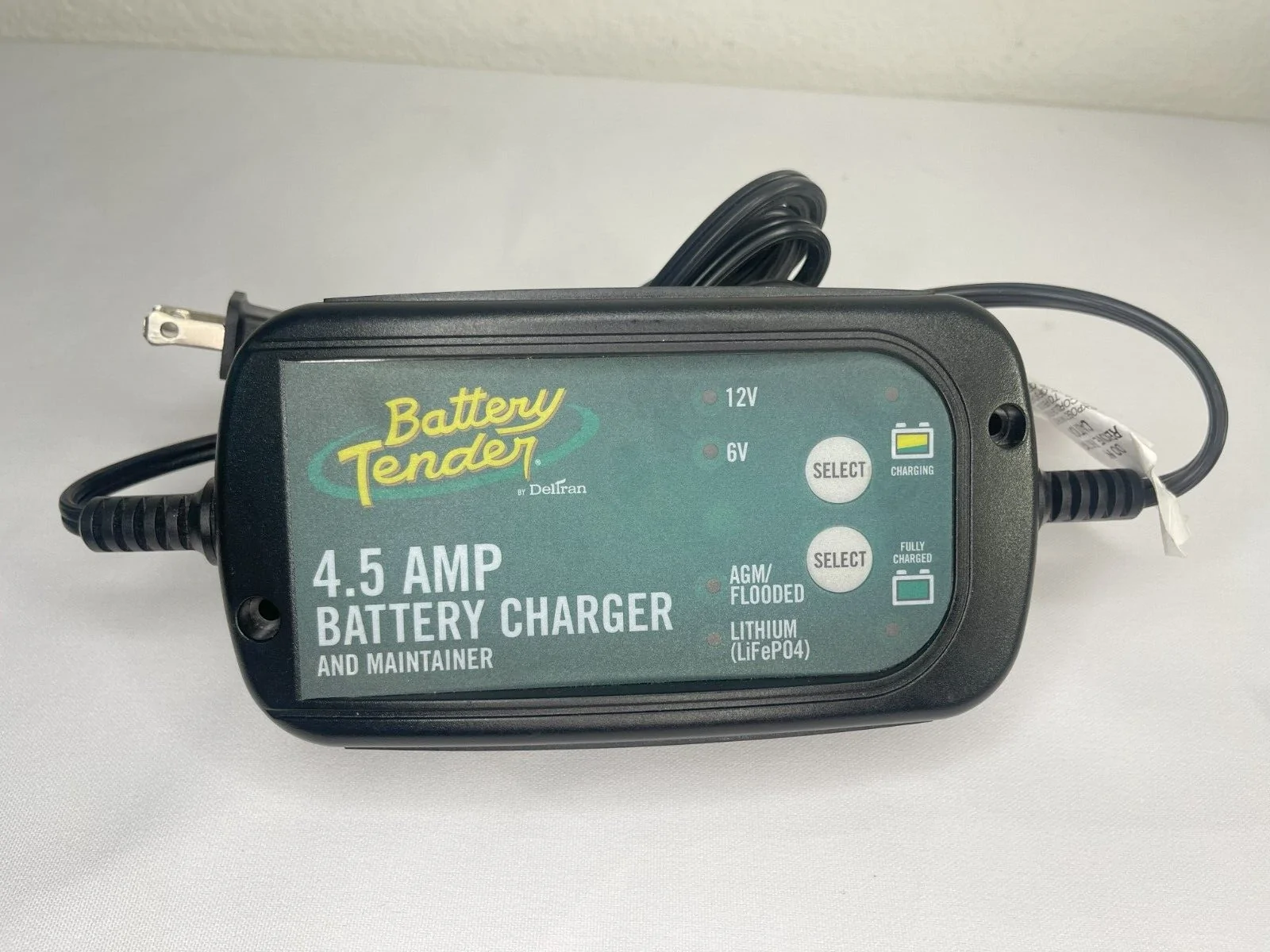

FWIW The 4,5a battery tender I have has AGM and flooded on the same setting.
Charged and maintained my BMW's 92Ah AGM battery just fine.

Right, the only two options are 6v or 12v charging, and AGM/Flooded or Lithium charging.
