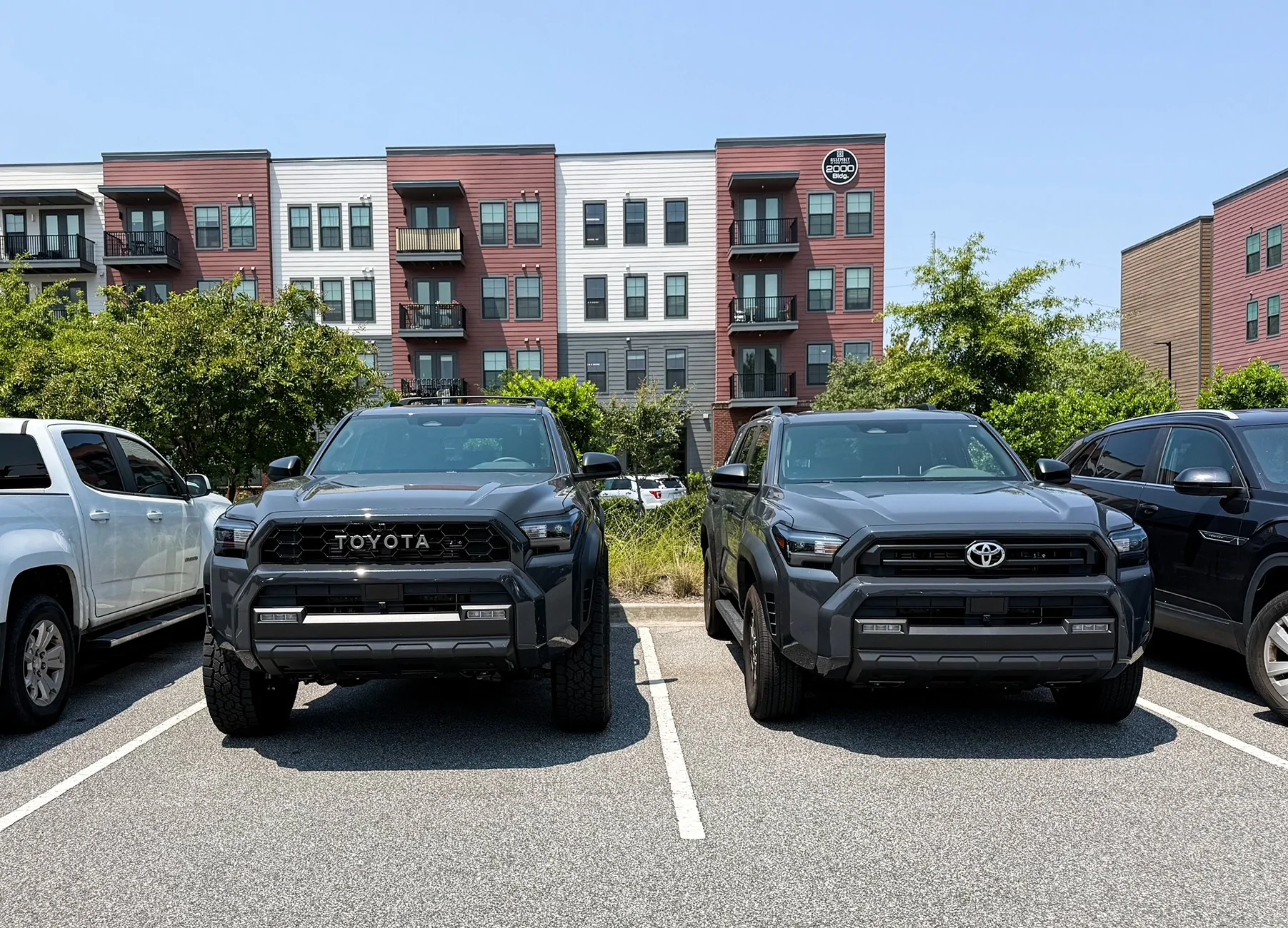

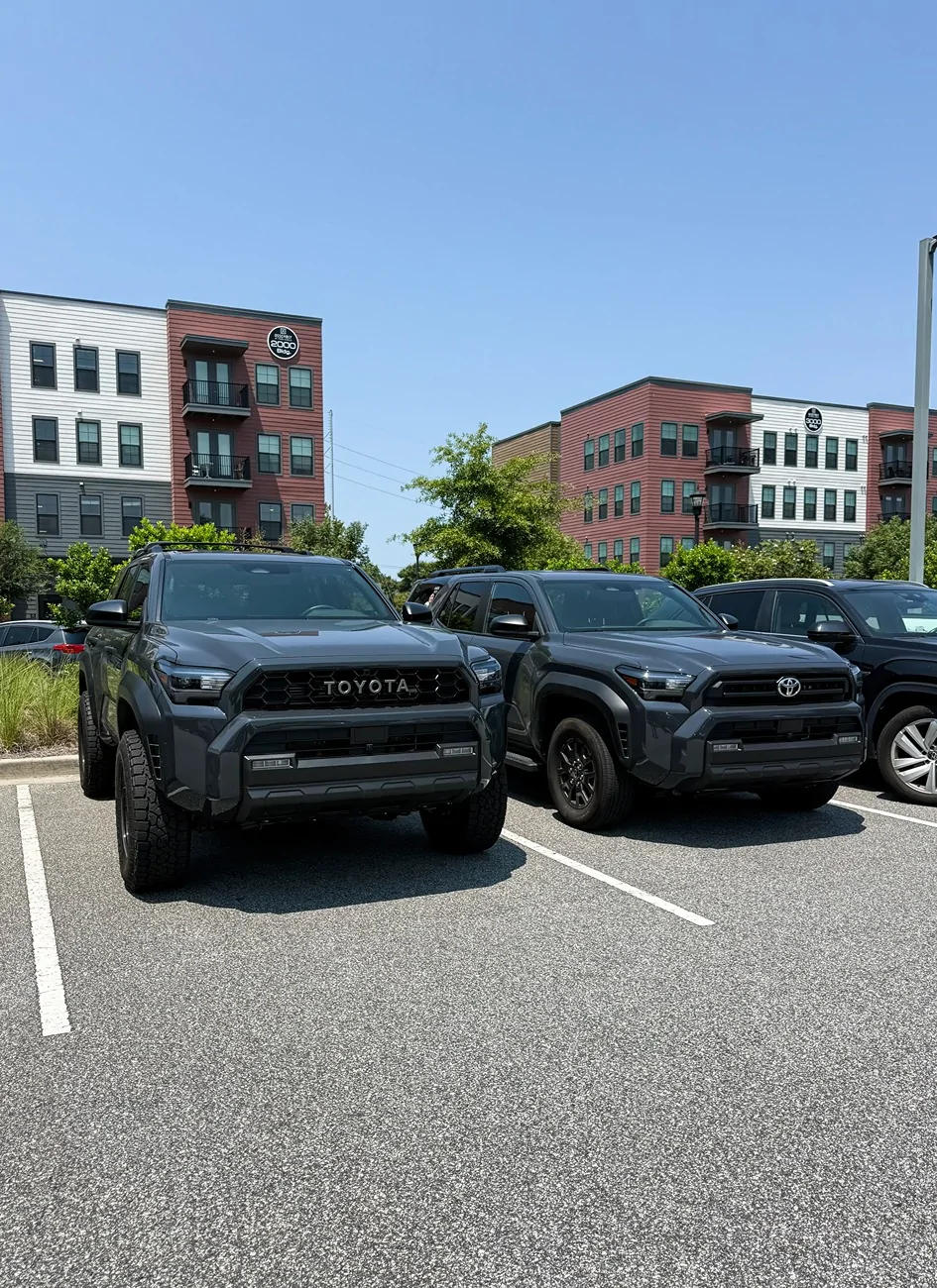

I figured someone might be looking for this kind of comparison photo between a stock SR5 and a lightly modified SR5 with some of the typical upgrades.
Right is a stock SR5
Left is an SR5 with 33" tires (285/70R17) & a Westcott Preload Collar Lift kit

Im definitely one of those someones, this is EXACTLY what Ive been looking for and the timing is crazy.
Ive got my 285/70s going on this weekend and I was planning on getting the WD lo pro rack. I was also looking at the WD pre load kit for after, but its all pending on how the 2 previous mods affect the 4R fitting in my abnormal garage.
I currently have roughly 2.5" of clearance in my garage for the shark fin antenna. The 285s should add 1.1" and the WD lo pro is lower than the antenna, so those 2 should be good.
If they are, I was planning on a small level for the front.
Are you using the full WD kit on yours? collar and spacer up front, puck in the back?
Really appreciate the post, the timing is unreal and exactly what Im looking for as we speak 🍻

That’s crazy! I knew someone would be looking for this.
Yes I’m running the full kit - collar and spacer up front and puck in the back. Glad this helped you out!

What parts did you use for the lift? And factory wheels or after market?

Where did you get that grille?

Grill is OEM from Toyota (Part #53101-35170)
Lift is Westcott Preload Collar Lift Kit - Used the full kit front & rear
Wheels are aftermarket (Method MR318)

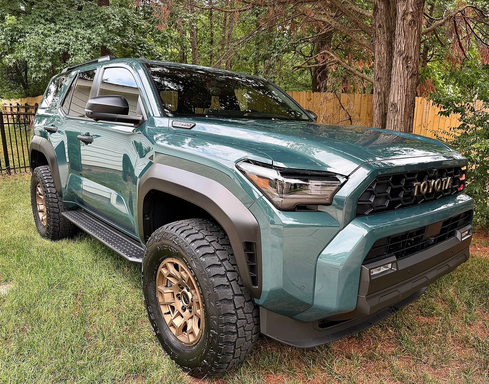

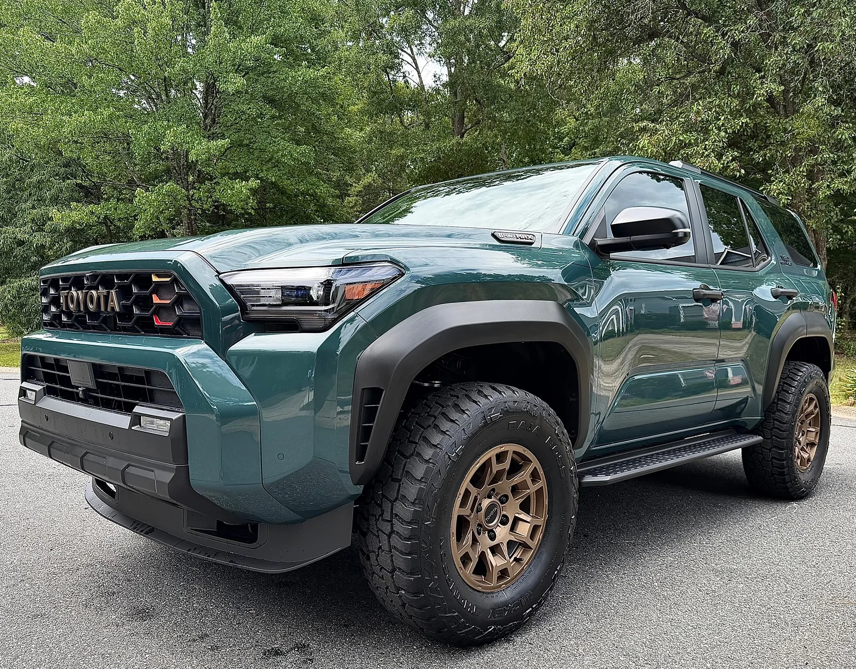

I also have installed the Westcott design 2.5 front .75 rear preload collar kit to my 2026 ORP and added Mickey Thompson Baja boss 285’s

Looks awesome! Bronze wheels look great on Everest

Looks great. The grille part number says it doesn't fit an sr5. I just wanted to double check it fits before I buy it. And how hard was it to put on?
Thanks

The grill fits - it's technically off a TRD Pro so the part number shows up as not fitting on an SR5. The Trailhunter grill will also fit on an SR5. The process for installing the grill is a bit involved due to how Toyota sandwiches it in between a bunch of other trim. Nothing too insane, just a lot of screws and clips. There are a few different how-to videos somewhere on the site here though!
