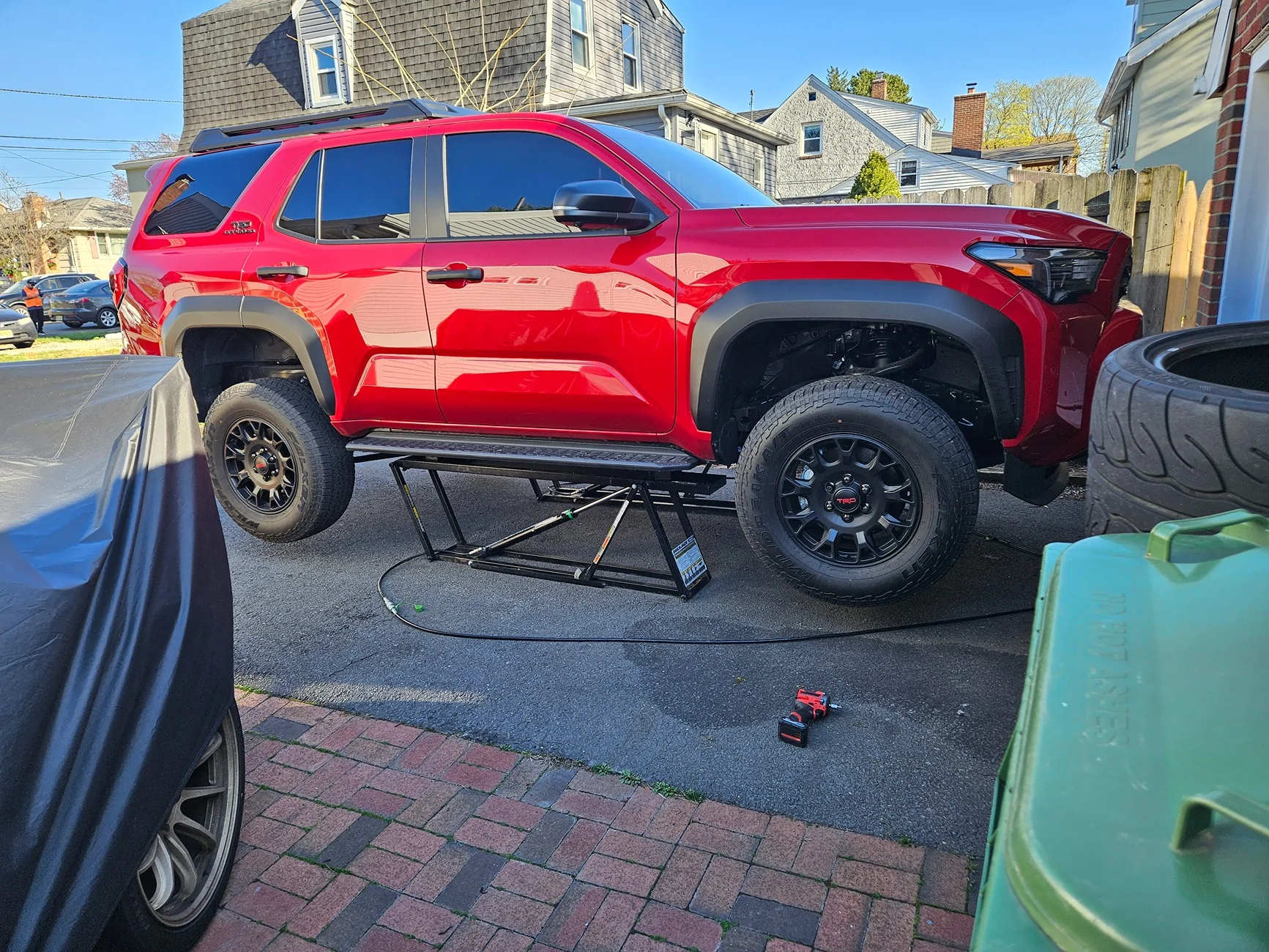

I bought this while it was still at sea in april of 2025 trying to get my hands on a red orp with a tow package. I wouldnt call this a build by any means but its a collection of some bolt ons, adjustments and personalization.
2025 2026 4runner 6th gen TRD ORP racecar support towing rig / daily driver 20250405_140312
2025 2026 4runner 6th gen TRD ORP racecar support towing rig / daily driver 20250424_173928

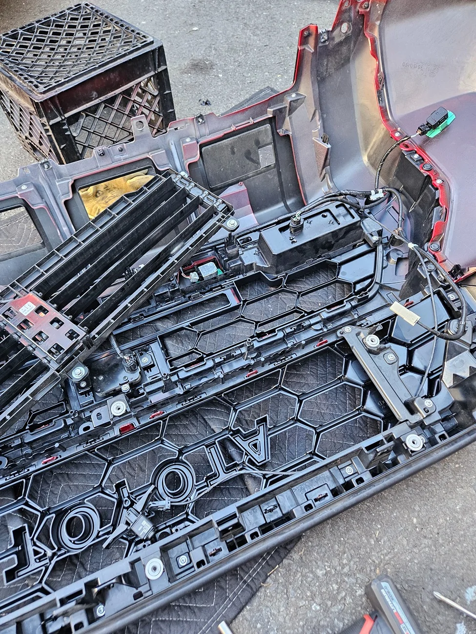

One of the earliest jobs was installing a proper subwoofer and an intake to hear this childish turbo flutter. I went with a K&N because of how complete the system was right to the turbo inlet.

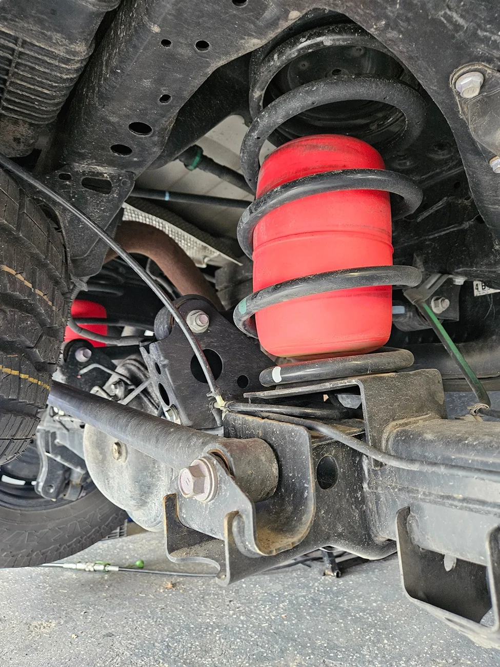

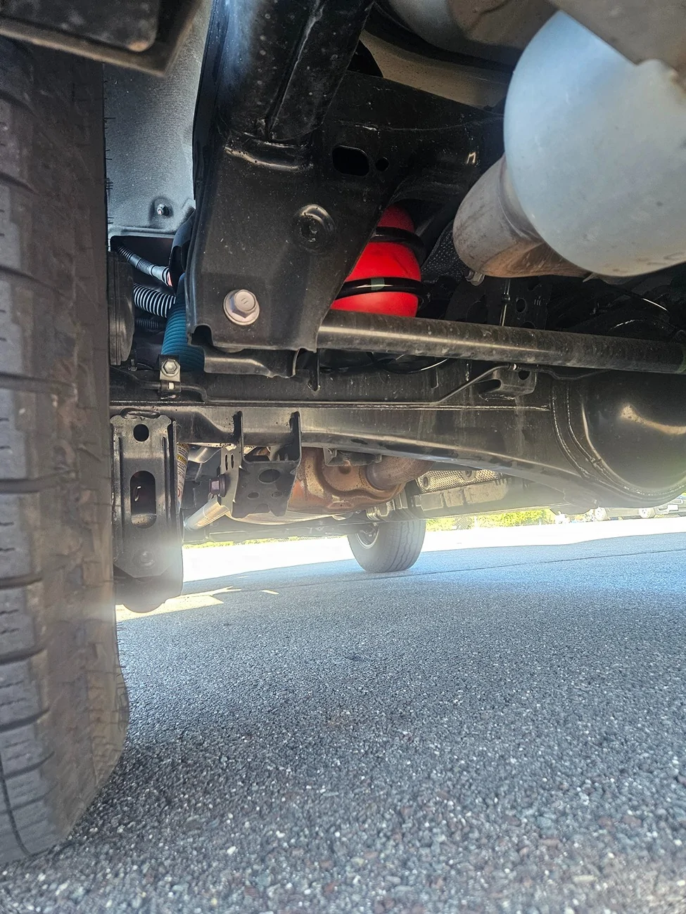

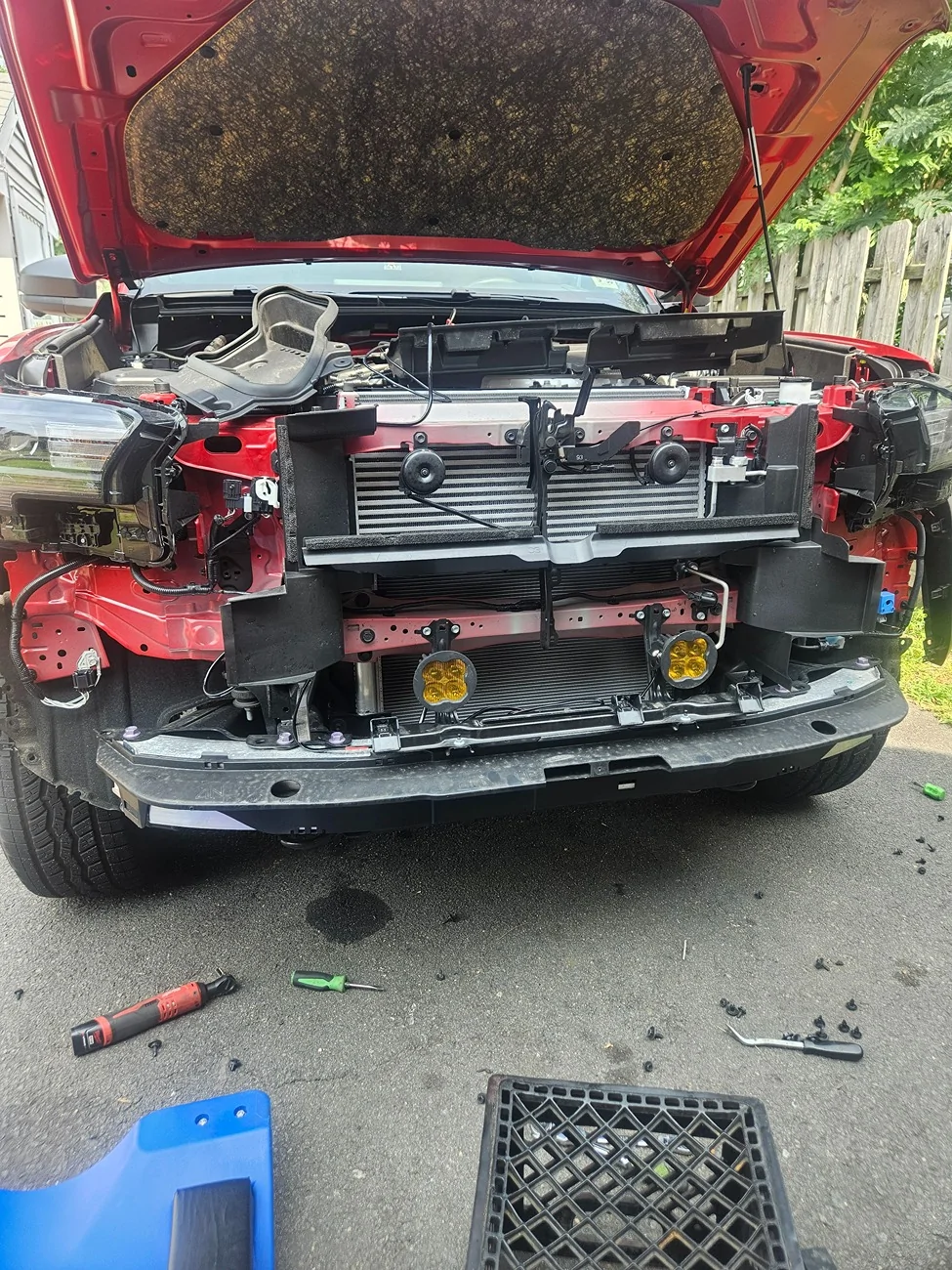

After towing a few times it became apparent that the rear suspension needed support so I put in airlift airbags followed by some diode dynamics fog lights i had sitting around from my cayenne S I had before this for the early morning fog to the race tracks.
2025 2026 4runner 6th gen TRD ORP racecar support towing rig / daily driver 20260327_122005

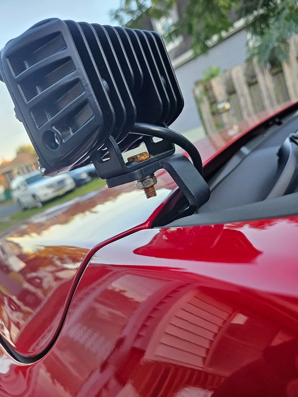

Some cali raised spot lights for the dark mountain roads when fog isn't present

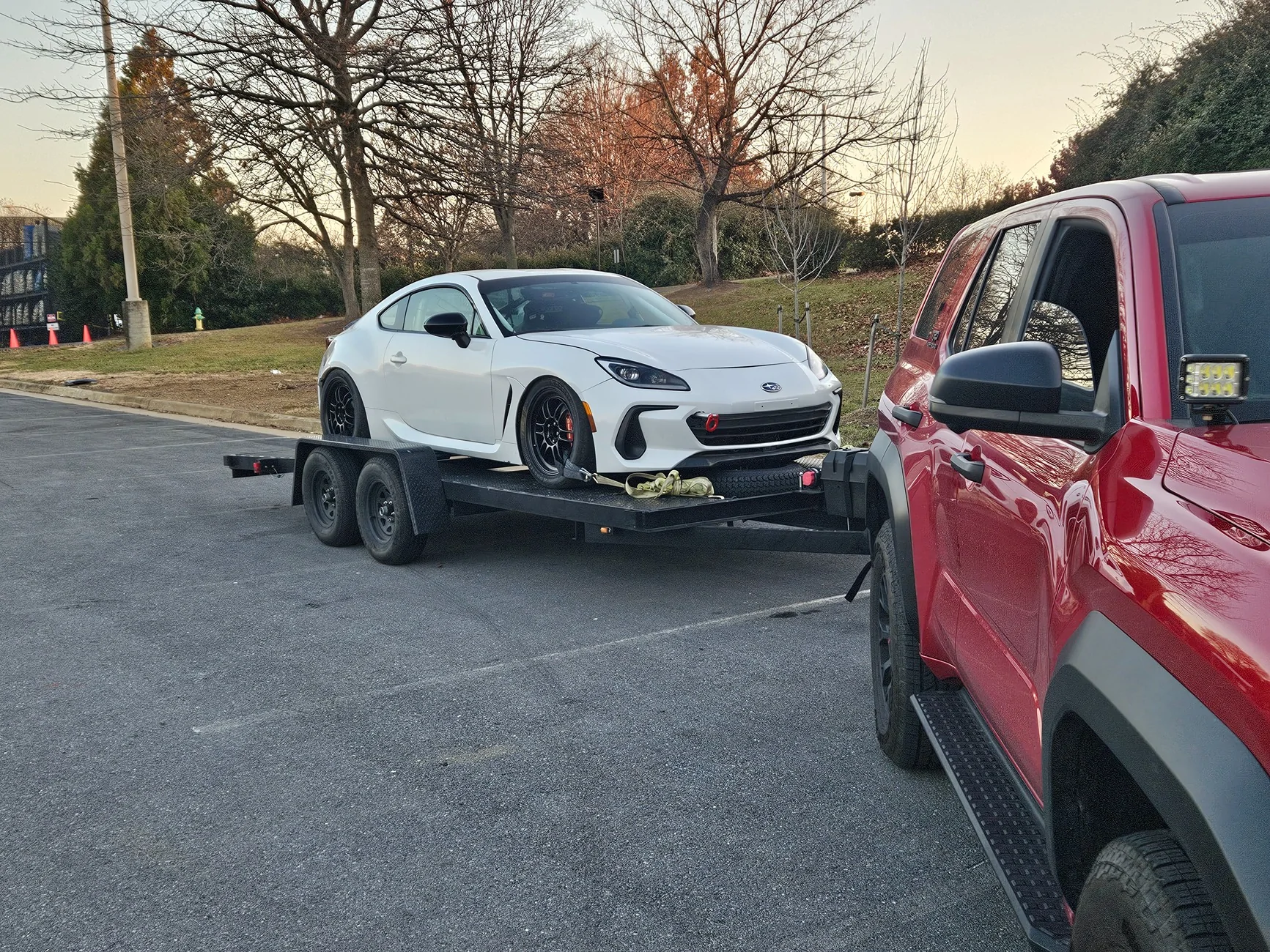

Took a road trip out to pickup a new race car.
2025 2026 4runner 6th gen TRD ORP racecar support towing rig / daily driver 20251212_163715

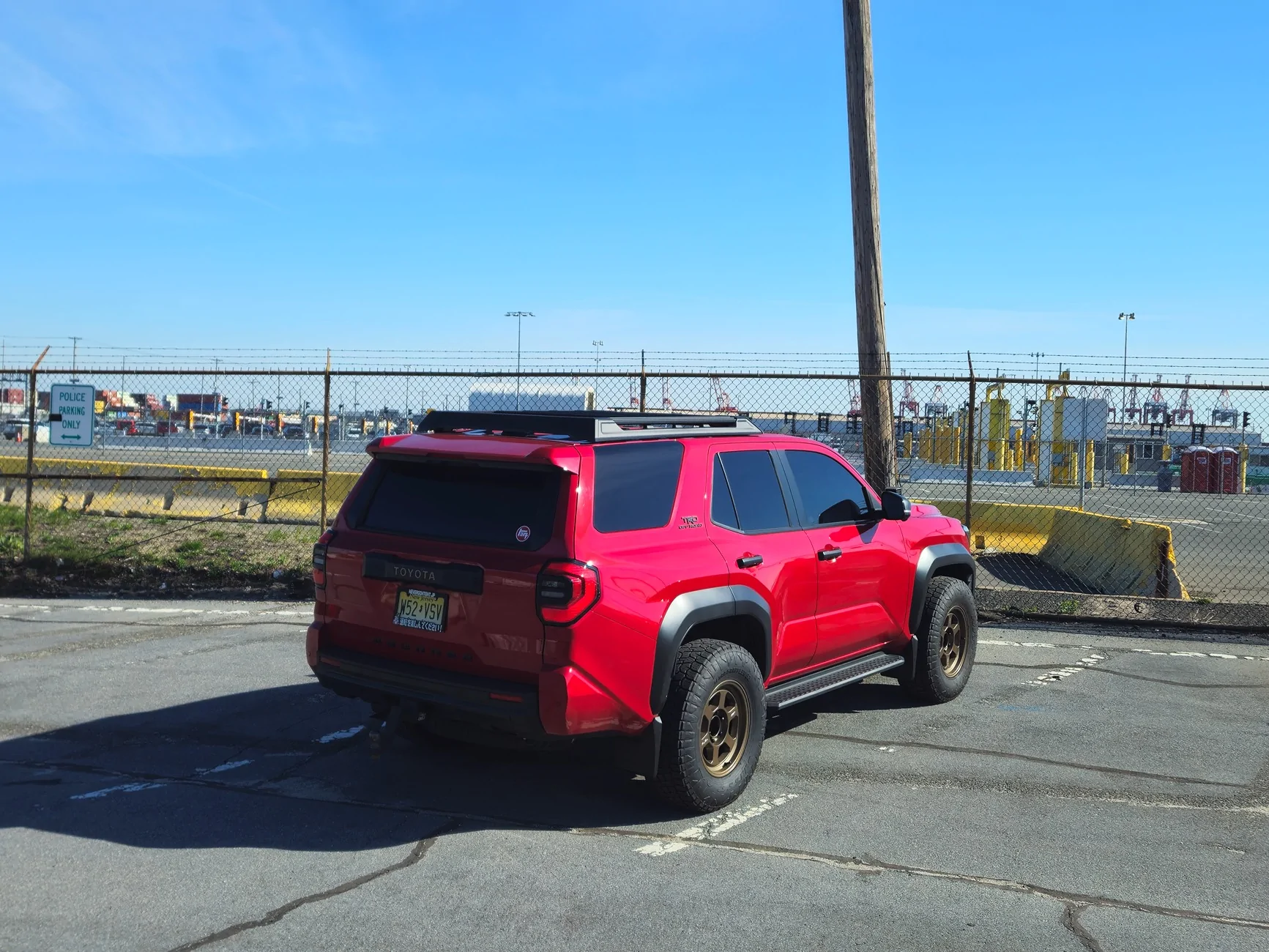

Finally moved onto wheels, and sold off the black optional wheels and roof rack forced on me by toyota and installed a trail hunder grill and bronze lettering on the rear.
2025 2026 4runner 6th gen TRD ORP racecar support towing rig / daily driver 20251003_155403
2025 2026 4runner 6th gen TRD ORP racecar support towing rig / daily driver 20260515_174352

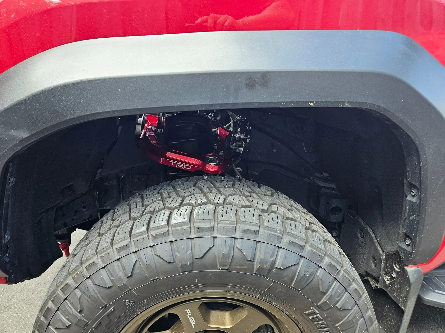

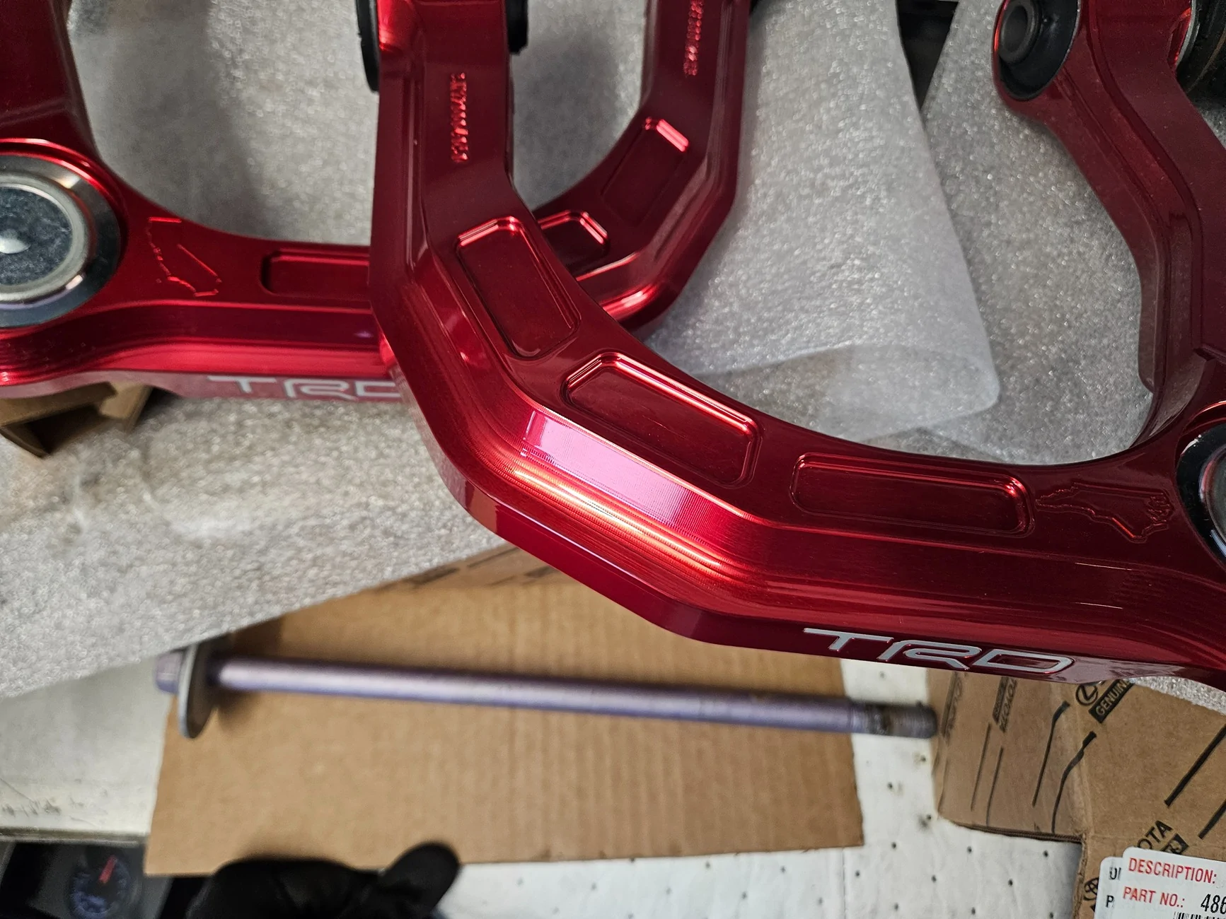

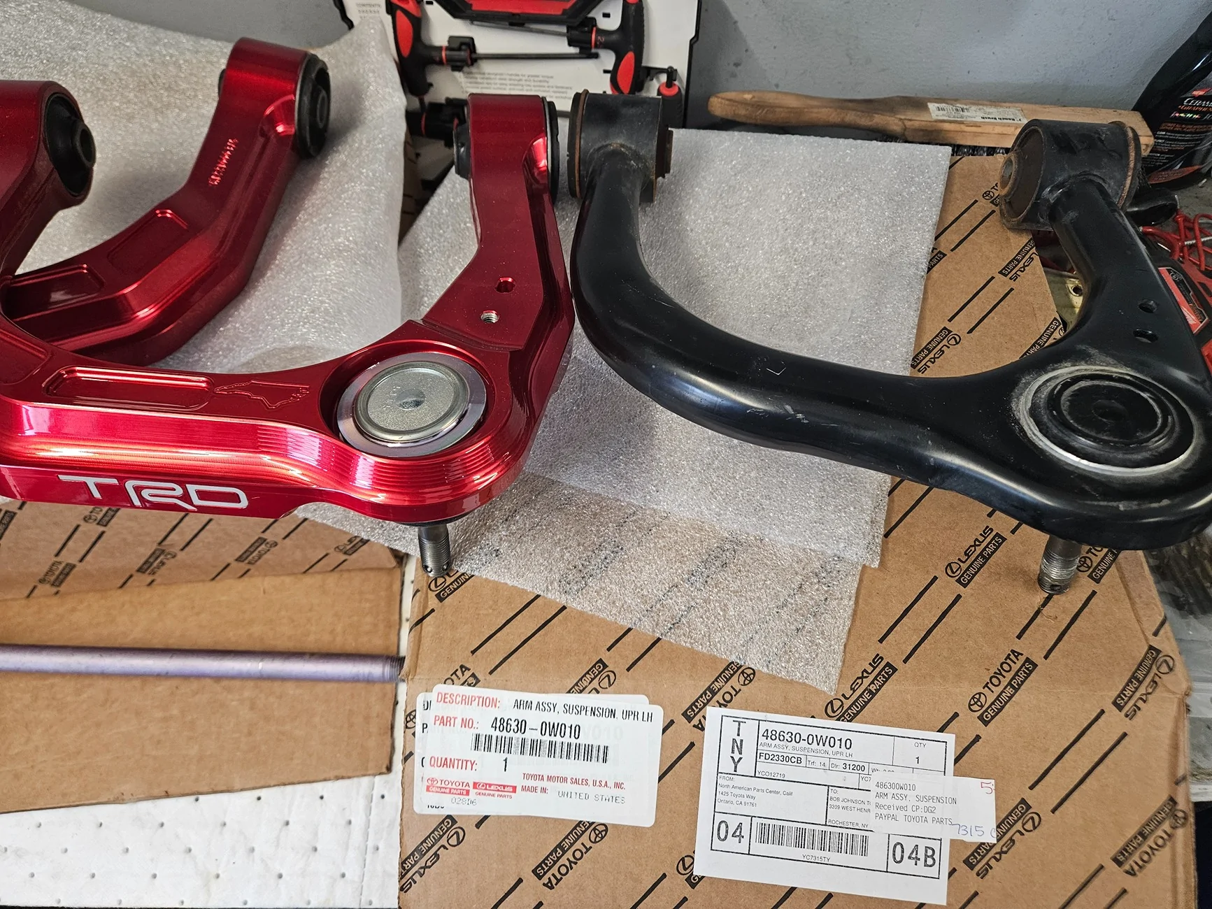

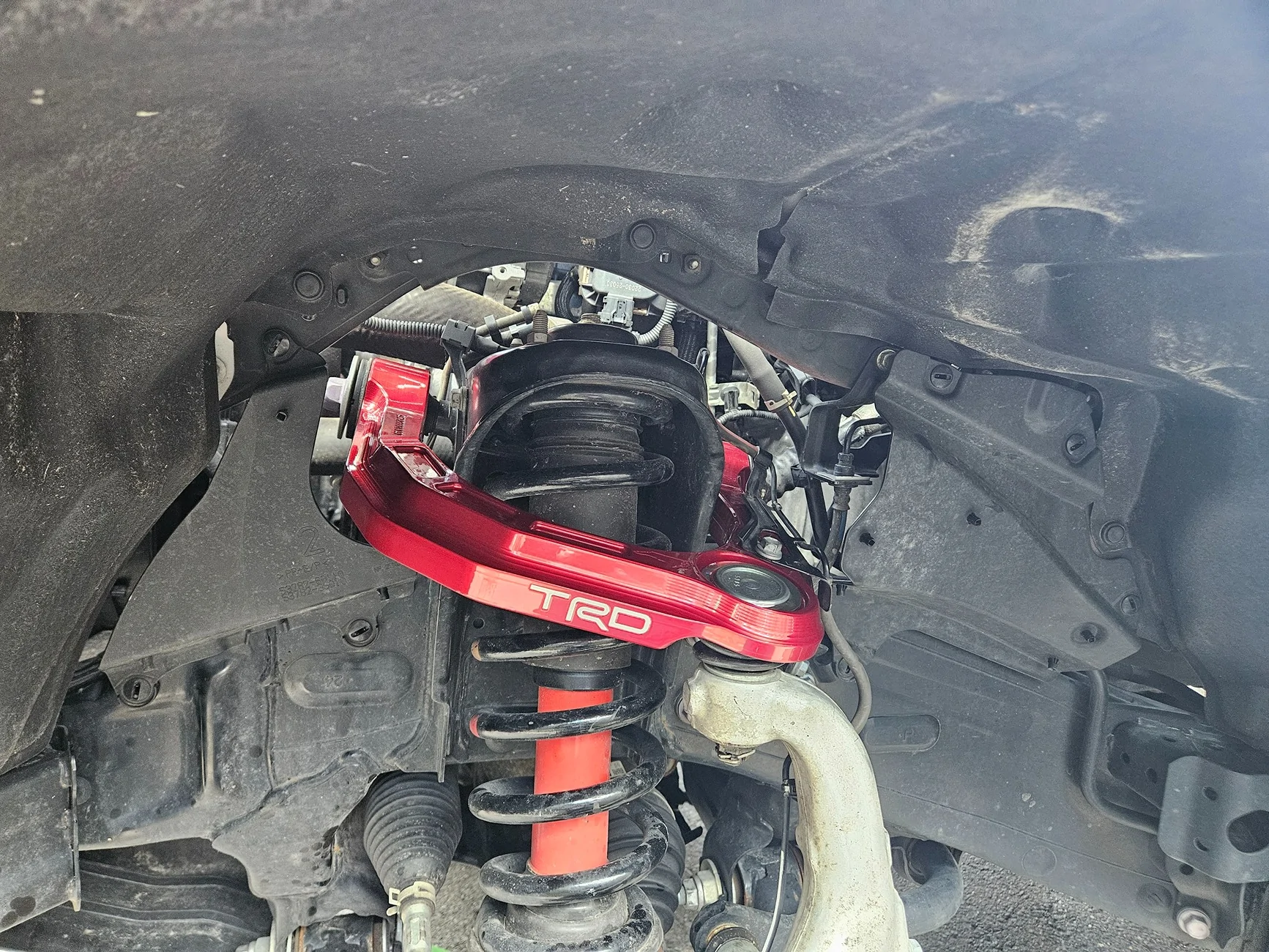

And most recently the TRD FUCAs
2025 2026 4runner 6th gen TRD ORP racecar support towing rig / daily driver 20260530_130522
2025 2026 4runner 6th gen TRD ORP racecar support towing rig / daily driver 20260530_130530
2025 2026 4runner 6th gen TRD ORP racecar support towing rig / daily driver 20260530_132421
2025 2026 4runner 6th gen TRD ORP racecar support towing rig / daily driver 20260530_132710
2025 2026 4runner 6th gen TRD ORP racecar support towing rig / daily driver 20260530_132657

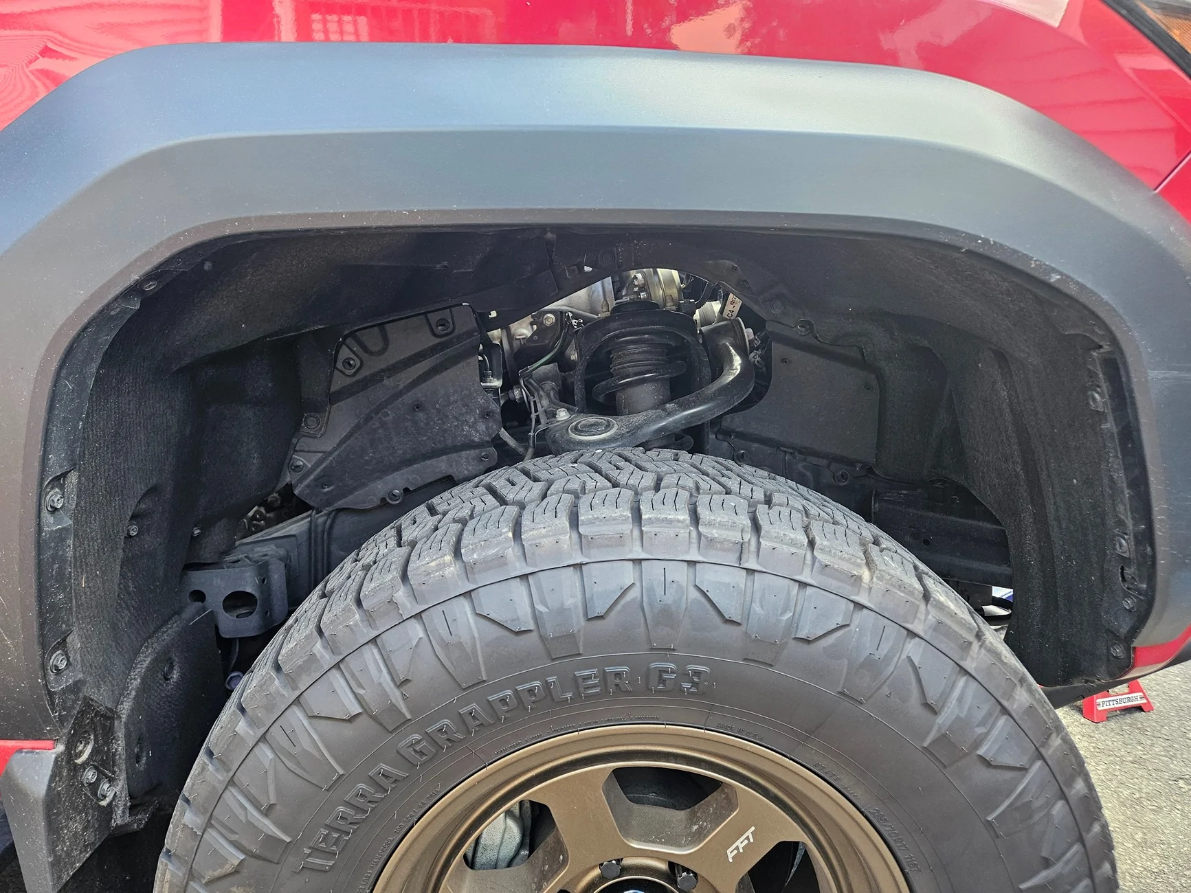

Pretty cool detail in the TRD arms, they have 2 different states stamped on the top, one is cali and the other is.... Maybe Tennessee?? Idk haha
Nice "adjustments and personalization"!
Am fairly certain that state outline on the TRD UCA is North Carolina. Cool detail.
That's North Carolina. I have no idea what the significance is though.
Very nice build. Enjoy!
Thanks ya i have no idea, maybe its a manufacturering plant or an off road testing area for Toyota?

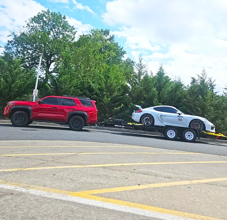

I just did similar this past weekend towing my 3200lb track car on a U-Haul auto transport trailer....5500lbs total trailer load. However, the tongue weight max of 550 was blown through at my 610lb reading. Even though 610/5500 is 11%. Wondering what your ratio is. Your cars and trailer look lighter, maybe 5000lbs? Your tongue weight?
My 4R (a 2WD SR5) towed like a champ...like you said, temps don't move no matter the haul. For handling, I do have upgraded tires (760lbs more per axle), helper rubber "springs," and an aFe roll bar.
Joey_Midnight
Joey_Midnight
Apr 6, 2025
157
149
NJ
4runner ORP, GT4, BRZ
My open trailer is 1550lb, the GT4 is 3100, the brz is 2800 and my camaro is 3600. I don't check tongue weight, I just put the cars all the way to the front of the trailer, engine towards the hitch. I have pulled in 4wd as well and the trans temps remain stable so its definitely built well, I could have never pulled like this in my old 5th gen.
I'd say the trailer brake and airbags are my most important features for towing well on this, I also run 5w20 oil instead of 0w20 for a tad more viscosity stability and shear strength

My 2018 was red, love that color. The 6th gen pulls so much better than the 5th gen.

@Joey_Midnight would you mind sharing more info on that airbag setup? I also tow my car to the track and noticed a good sag in the back but didn’t feel like handling was compromised
Joey_Midnight
Joey_Midnight
Apr 6, 2025
157
149
NJ
https://www.4runner6g.com/forum/thr...-installed-5th-gen-version-fits-6th-gen.6133/
This is my thread on it, what information do you need on it? Without the airbags I didnt think handling was compromised too much but it was light and wandered, I was hitting the bump stops on the rear and braking was compromised because the front tires had less weight
