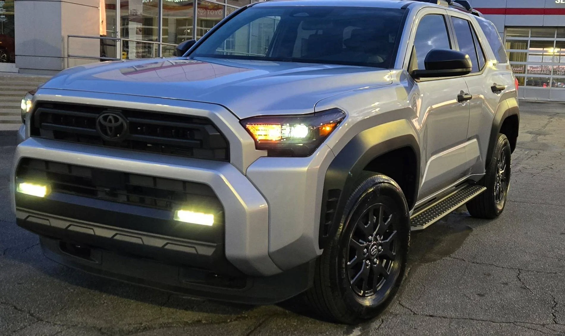

Bought a new SR5 4Runner mainly for the looks and because I’ll be living on a dirt road soon, commuting past 500 potholes daily just to reach city streets. I probably won’t go off-roading for 7–8 years. I expected a smoother ride on city roads, but every small patch or filled crack feels harsh—much more than in softer SUVs like Kia. Is this just how 4Runners ride on patched roads, or is there a way to improve comfort? ...On the other hand, would a SUV with softer ride like the Highlander or Kia Telluride even hold up to these 500 pothole stretch daily? Any advice?
