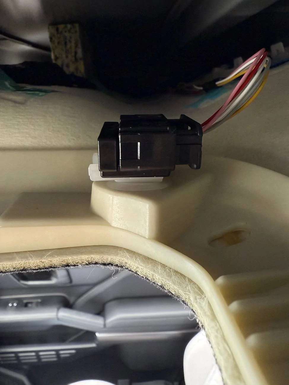

Found this cabe in my SR5 that seems to be plugged into nothing above the overhead console. That socket doesn't have any cables attached to it (Just seems to be mounted to the liner with a plastic clip as to not dangle around).
Could this be for digital rear view mirror? Any ideas?
(This is not the OEM dashcam connector, that is there too on the other side).

If the strange connector you found is #X19 in this diagram, Toyota says it’s a noise cancellation microphone? There's also a harness in that area for the sunroof ECU, and just some other junction connector?‍♂
