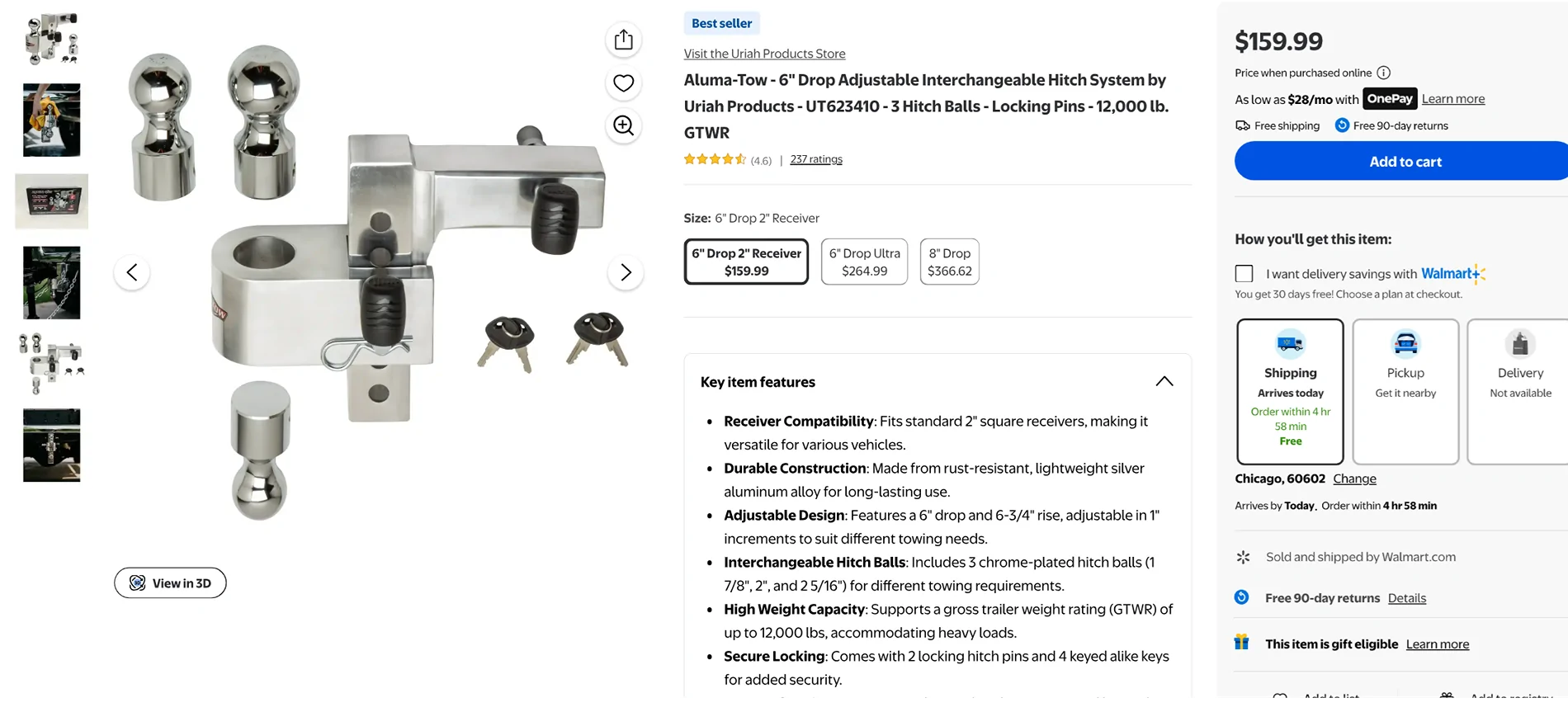

Going to tow my motorcycle to the track come spring, what drop on the hitch should I get? I'm not lifted. ORP.
36
2,015
1,133
i picked this up from walmart, i think harbor frieght has it also
only need the 2in as your max tow is only rated at 6000 lbs and the 2in ball is rated up to 7500
i went this one as the lock mechanism for the ball is recessed inside the adjustable piece for security (you have to slide the adjustable part out to access the ball lock channel)
and no i am not in chicago, thats the vpn location reporting
edit : also the lock pins for the hitch are long enough for the new 4runner hitch reciever. using one to lock my back up light currently from diode dyanmics

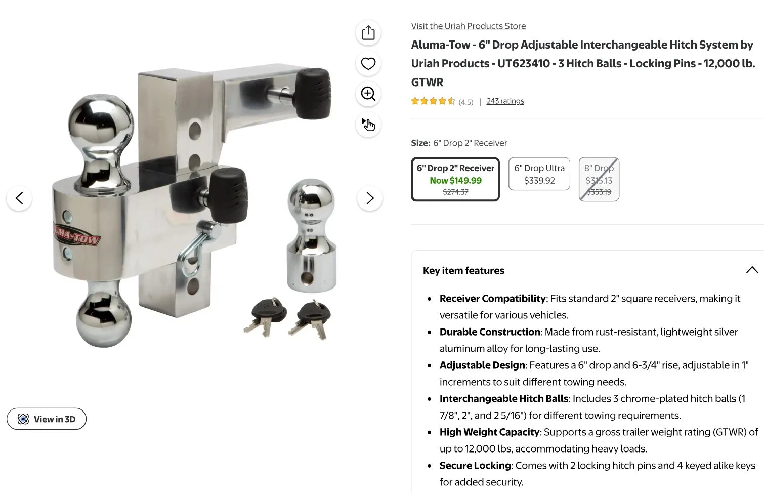

those rhino colored ones look nice, wonder how long that color lasts ?
is it just painted or ???

I have the black one. It does not look like paint, more like it’s been anodized. In any case, scratches show raw metal.
