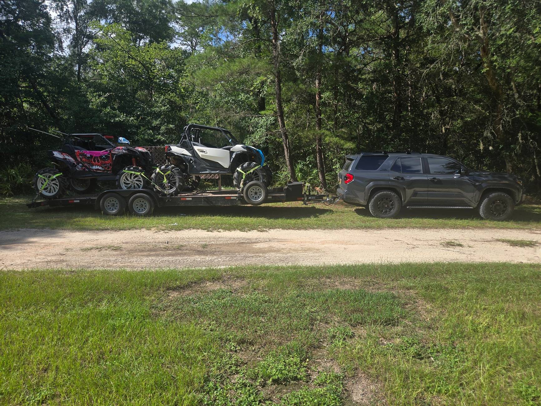

Total weight is just under 6k including the trailer, playing with hitch weight, currently at 500lbs. 2.75" of bumper sag. I think it needs airbags. Any thoughts?

I would suggest buying a good weight distribution hitch, would take care of 2 1/2 sag.
I agree, they are required above 5000 lbs.. They add ~100 lbs. to your payload capacity but it will help level out the 4R.

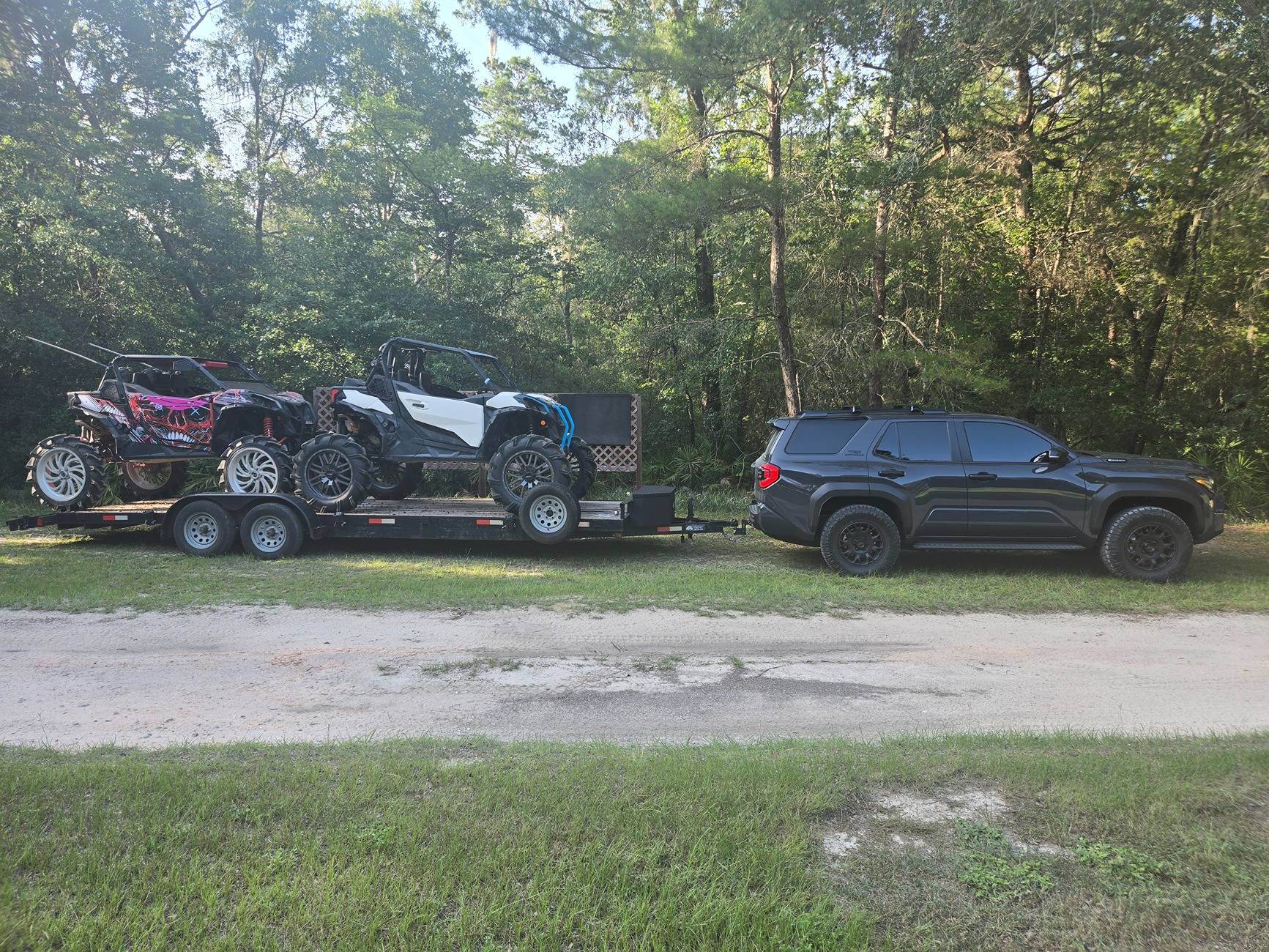

Weight distro hitch added. Pulled @70mph and had no sway
