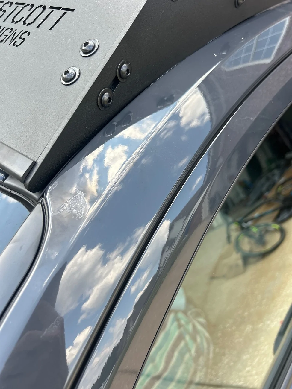

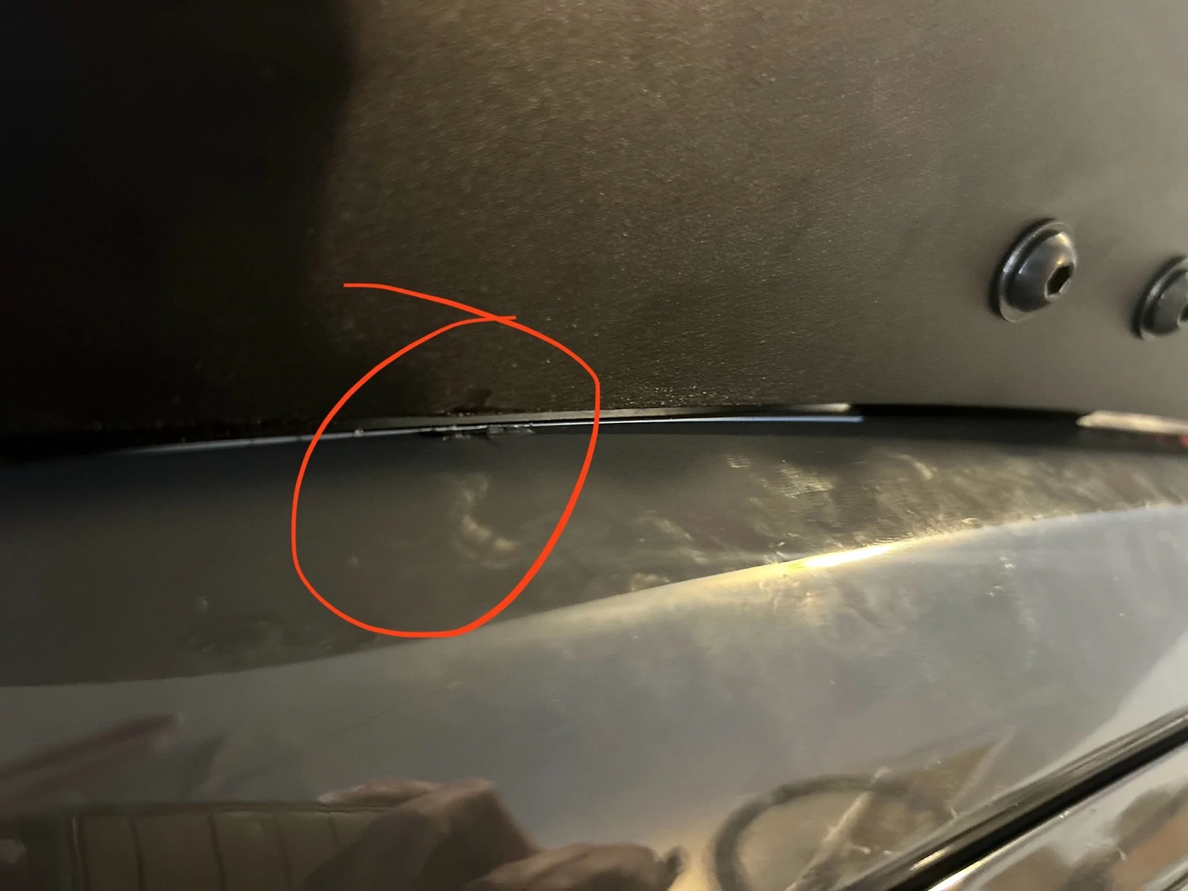

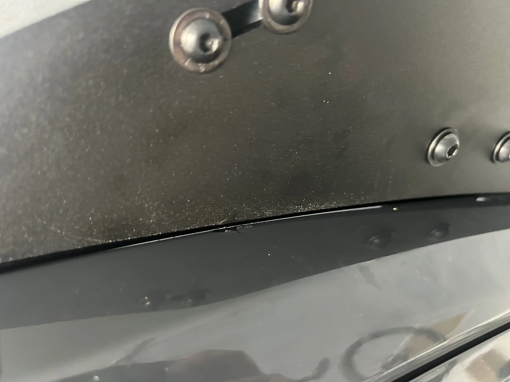

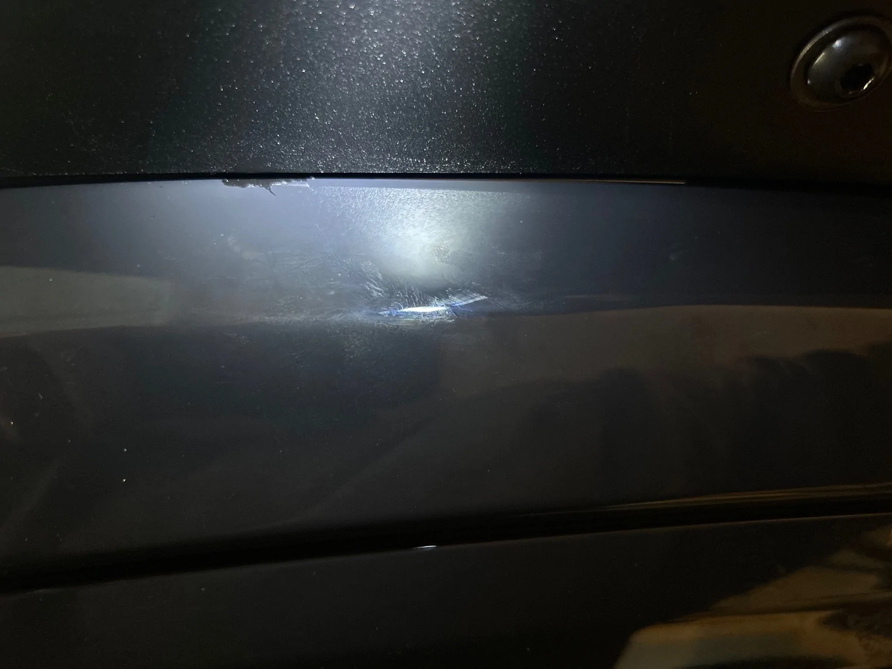

Just got this westcott roof rack on my 2025 TRD Offroad. I thought it fit perfectly drove around for awhile and then I went to see how close it actually was to my paint on the top and realized that it had actually been touching and rubbed the paint down to the bare metal.
Nothing I could currently do besides paint correct it and clear coat but had anyone else had this issue or know what might be up with it ? For basically a grand you would think this would not be an issue but it could just be me.

The key to fixing this will be making adjustment to the fairing. I'd recommend loosening the bolts to the fairing and all bolts attached to the footing. Then start at the driver side, push down on the fairing weigh your palm and lift the back while tightening the bolts. This should make the fairing more flush with the side rails, and also push the rack up from your paint. Now work your way around the vehicle, making adjustments needed if you'd like to raise it up.

I noticed this while installing my low-profile roof rack from them as well. I initially thought I had the brackets set incorrectly, but eventually figured out that I was installing it correctly.
I had to lift the fairing and the rear to keep them from rubbing on the paint. Hopefully, they come up with a fix for this ASAP.
My issue was located towards the rear of the vehicle, where the metal was in direct contact with the paint. Like the other person who commented on your post, yes, you have to push the roof rack up and then tighten the bolts. I fear that when we start putting weight on these, the bolts will eventually become loose, and halfway through the trip, you'll realize that the entire roof rack is resting and rubbing against your (our) roof. I think this is going to be a huge problem with these roof racks.

Yep I went ahead and did that. Had someone push up while I bolted it on. But now the front valence is vibrating do to it not being fully in contact with the roof. I guess that’s the next issue to fix. For a thousand dollars tho I hope westcott will offer to do something because not only have I caused a couple hundred dollars in damage to my vehicle but now it’s making a vibration sound.

The issue was not from putting it on from installation. When you bolt everything down and have it installed it doesn’t fit correctly it rubs the paint because there isn’t enough clearance. I’ve adjusted everything and talked to Westcott as well and they are thinking it’s a defect. So it’s not my fault. Westcott has been great to work with and not bashing the product it just sucks that it caused damage.

I reached out and Jeff Westcott actually gave me a call and gave me some support and recommendations on what we could do to go fix it. First couple things didn’t work but he just kept giving me work arounds and we eventually were able to fix it. He called me multiple times and gave me his phone number incase I have any more issues. I could only really find one install video, and I might have been able to figure it out on my own but there were parts of the rack I didn’t know could move based off the install video I saw. He showed me a bunch of work arounds on how to get things to fix if they aren’t sitting flush initially.
