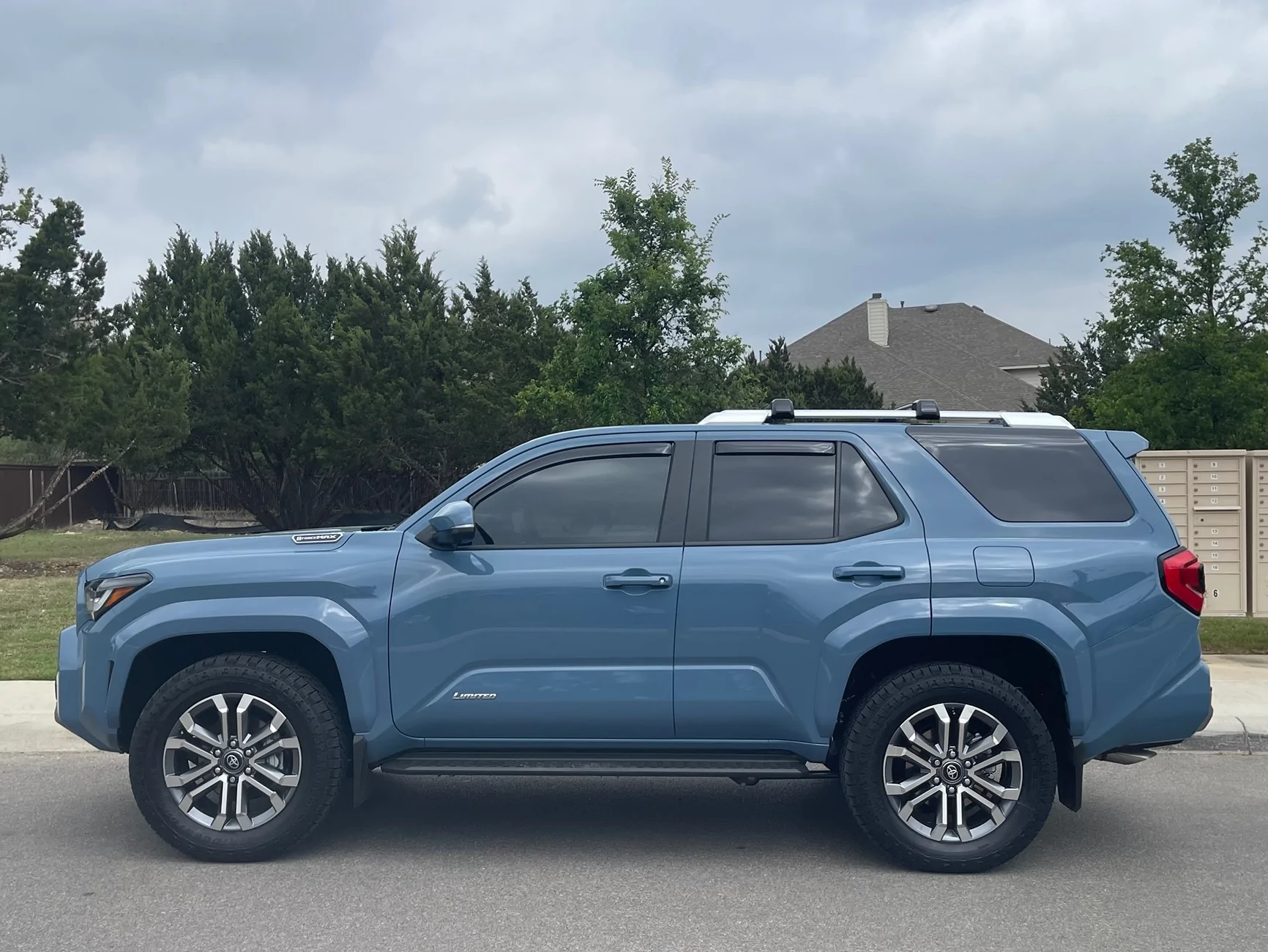

Here’s how they look. This my fourth set from WT over the years. A must have imo.

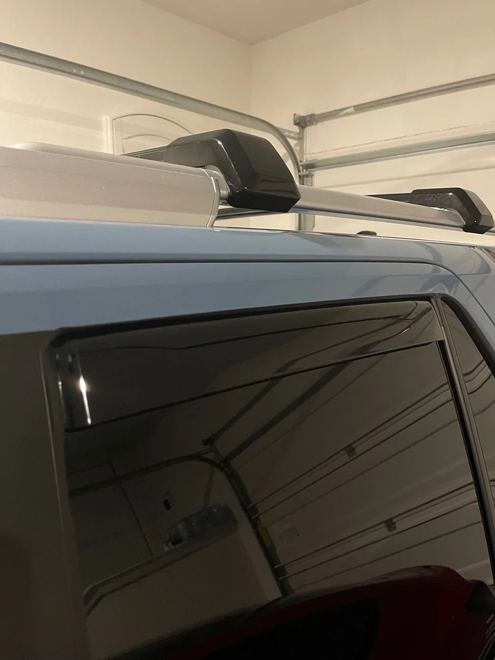

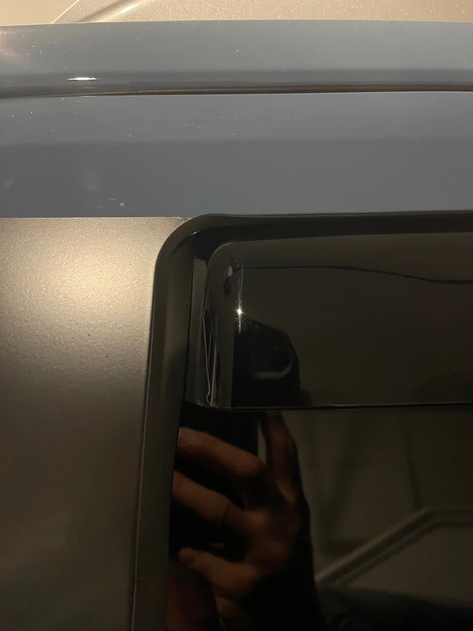

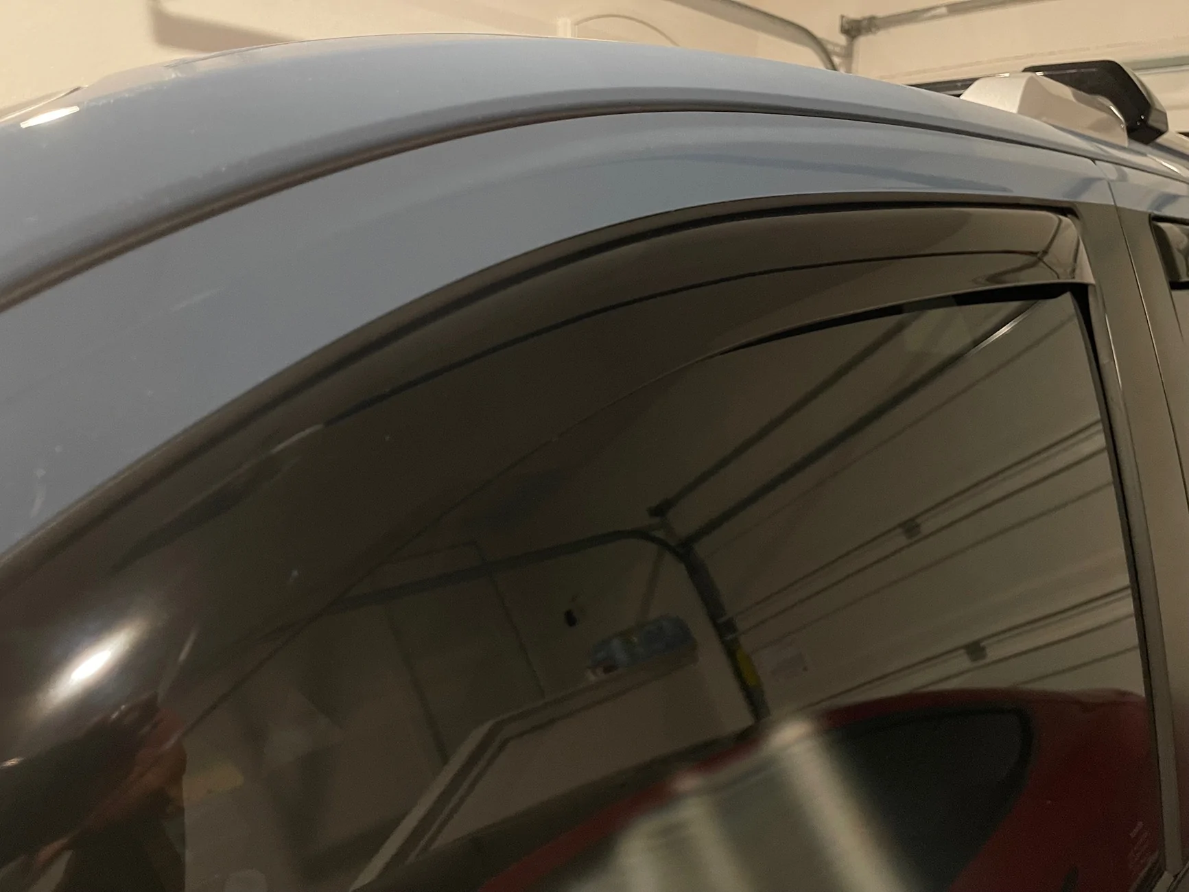

Nice. How is the application in the rear windows. For some reason, I am thinking it might be harder than it actually is. The front looked relatively straightforward, but the back seems to be a bit trickier as the trim is quite tight on the vehicle. Do you have any close-up pictures of the fit? I can’t find anything online.

Here’s a couple more pictures. The install is actually very easy. The front deflectors are held in by tension and the rear uses a combination of tension and 3M tape along the edge. Although, the rear doesn’t use nearly the amount of tension the front does. There was no interference with the windows rolling up or down. The instructions say to leave the windows up for 48hrs. Makes sense for settling in and the rear tape adhesion.
