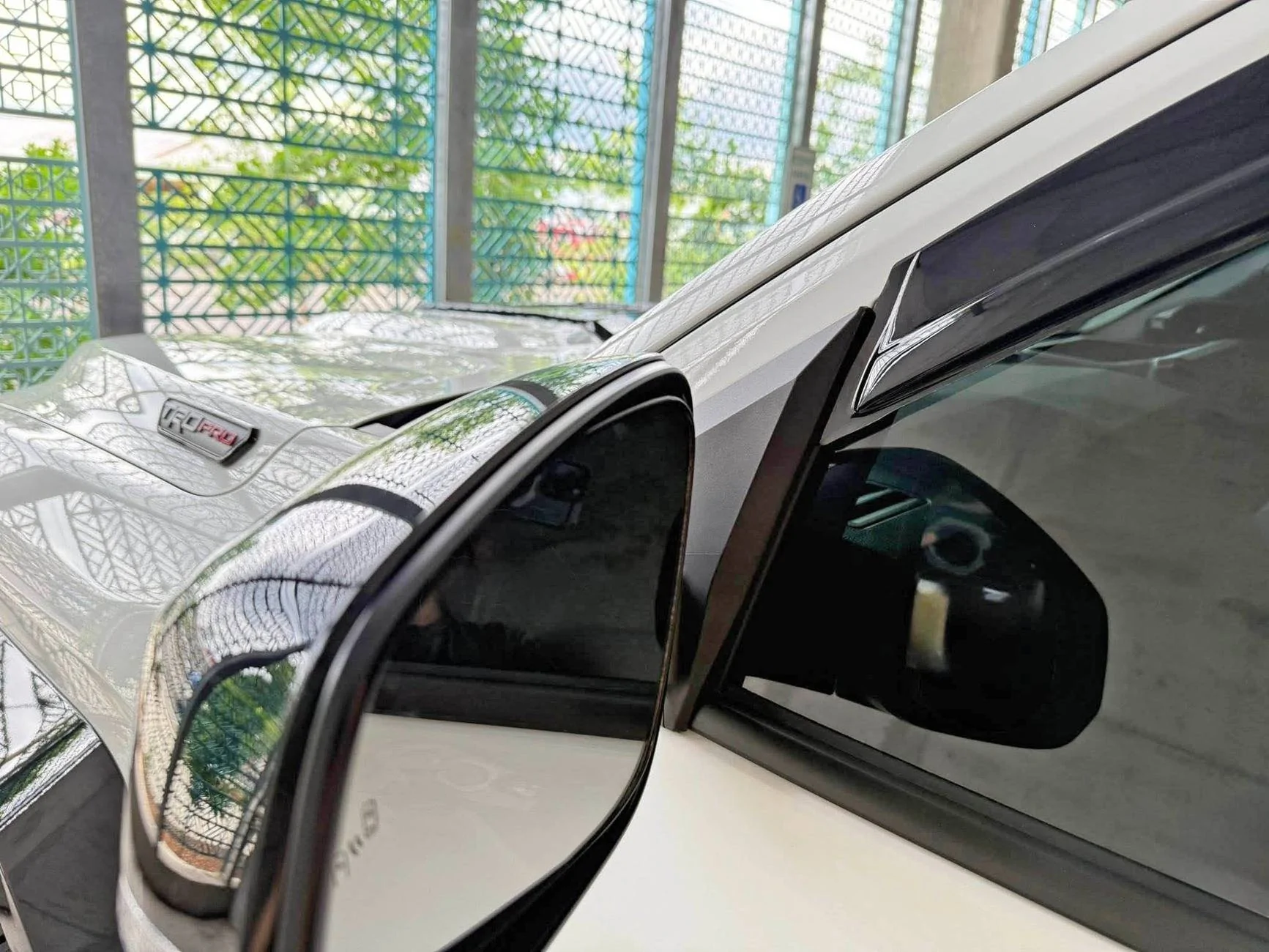

By owner: Got some Husky low profile vent visor rain guards put on. They're great.
Only pain point were the front window pieces. It has an extra cutout on the lip. Refer to photos. These are the outside mount visors so there shouldn't be any insertions required, however, these one need to be because of the lip.
Package came without any instructions, only a QR code. The code took you to an install video for a basic low profile mount that weren't the same form.
If anyone does get these, insert the lip into where your side mirrors are...not the frame of the window. Inserting into the window channel makes the piece too tight and your windows won't roll up because the sensors think there's a jam. Other than that little annoyance, I really like the product.

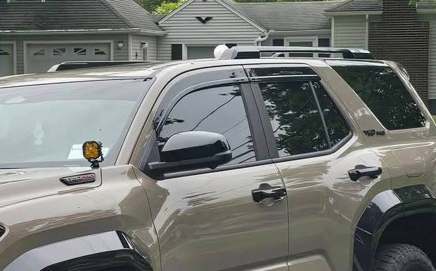

Here's how they look installed on a Mudbath TRD Pro:

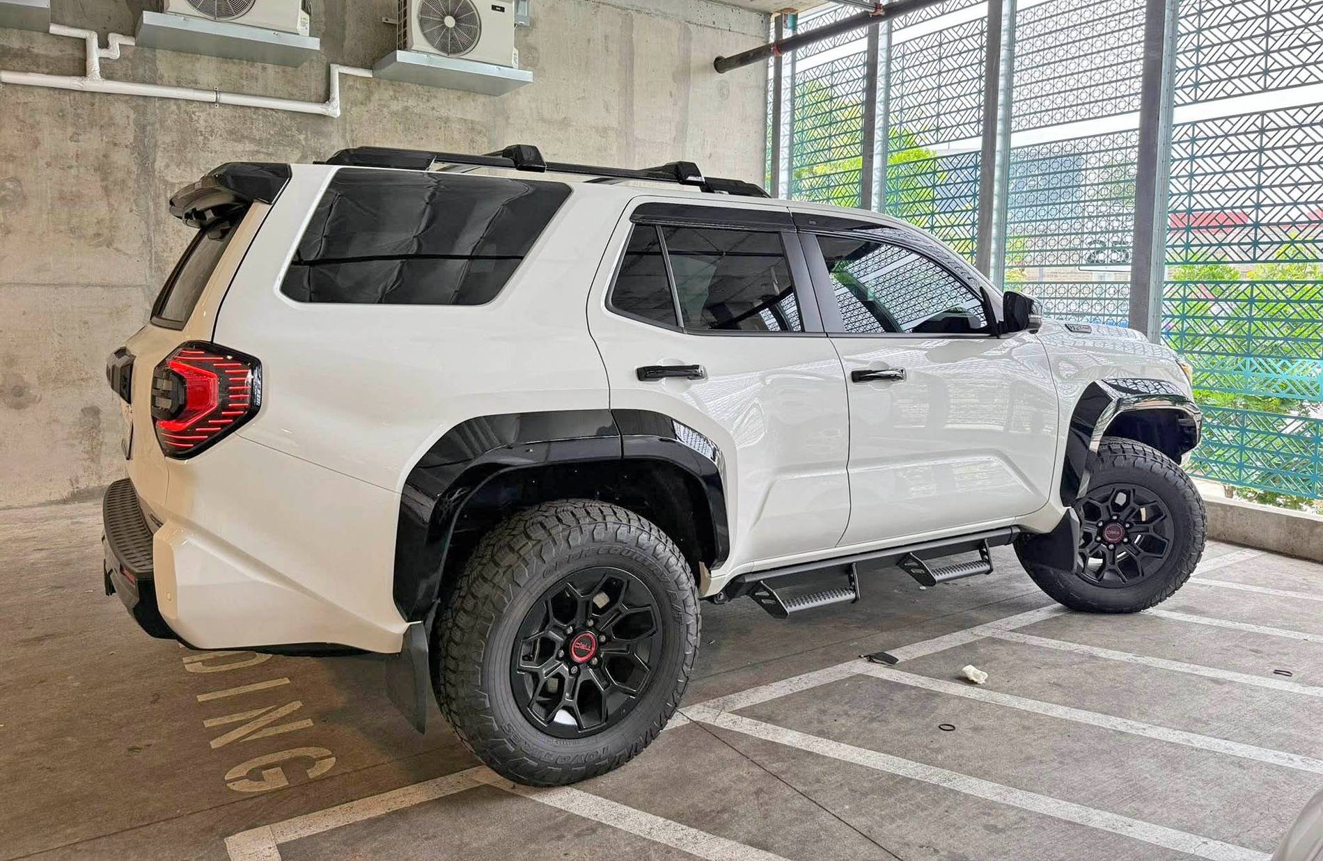

I purchased the same ones earlier this month and yes, instructions are lacking and when you call customer service to make sure you are installing them correctly, they are no help as they refer you to old instructions that are not the same.
So far, I love the window vents and I think they look great on the vehicle.

KTRAN: the lip on the front vent shades don’t fit between mirror trim as a metal bulkhead is there blocking insertion…they have to go between window and rubber seal…I inserted a small flat screw driver where you indicated and can’t go any further than 1/16” until you hit the metal attaching bulkhead….???? Any chance you could take a closer look at where you inserted the tab again?
Please and Thanks
