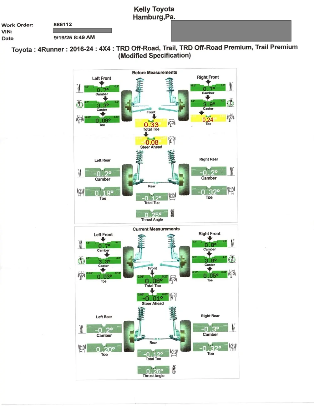

2025 2026 4runner 6th gen TRD Pro - please post a picture of your alignment sheet. Alignment 09-19-25
That's running 34" tires before and with 2" front and 3/4" rear lift after.
Tire wear is good but doesn't hold crown of road well under light acceleration.

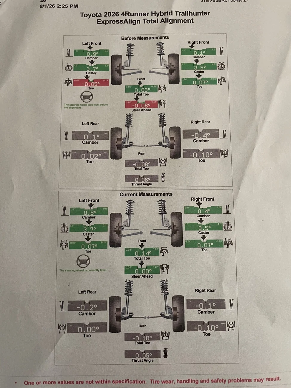

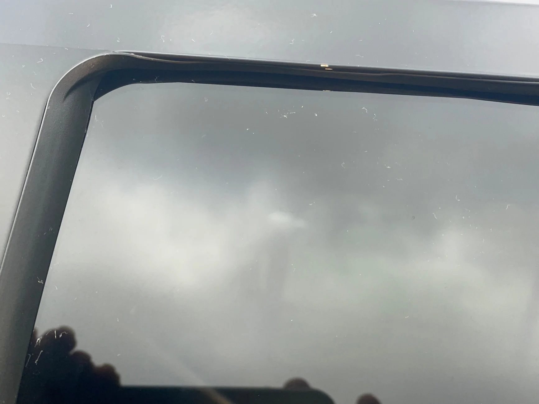

Just had my Trailhunter looked at. Stock tires. It was drifting/pulling to the right. I posted earlier about the dealership not having the alignment specs for my brand new vehicle and it took me 5 phone calls to “Toyota Customer Experience Center” (Totally worthless), a visit to 3 dealerships, none of which had the numbers, and finally a phone call to the original dealerships General Manager to finally have it looked at. They had a rep from Hunter come in and give them the numbers apparently. Also while I was there I had them look at a window channel runner that looks fugly and they said that it "was normal". Yeah right, guess I’ll have to call the GM again, although I hesitate to have them replace it and make a real mess! I just hope I don’t have any real problems going forward because dealing with them was frustrating!!)

0.1 total toe is much more. . . reasonable. I'm taking my Trailhunter in next Friday.

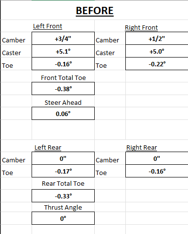

2026 Trailhunter, ~3000 miles.
A note on the alignment numbers: This shop uses an older Hunter Lite-A-Line optical alignment system rather than a modern computerized alignment rack. The toe readings on their worksheet are recorded in inches. I converted those measurements to approximate degrees using the tire diameter and the Hunter Lite-A-Line toe-measurement/conversion method so they can be compared more easily with the degree-based numbers most people are accustomed to seeing. The converted values should therefore be treated as approximate (e.g., 1/32" toe-in is shown as approximately +0.05°), not as measurements actually made to hundredths of a degree. I have left the original positive front-camber readings in inches because I have not established the specific Lite-A-Line camber scale/conversion well enough to convert those values confidently.
I continue to use this shop because of their procedure and the results I've had from them. They road-test the vehicle first to evaluate tracking and steering-wheel position, then measure the rear and front axles using the Lite-A-Line equipment, including the normal wheel/head setup and runout-compensation procedure. After making adjustments, they road-test the vehicle again and put it back on the equipment to verify the final alignment. In this case the truck was road-tested twice and checked on the alignment equipment twice. I've used this shop for other vehicles and consistently gotten straight tracking, centered steering and flat, even tire wear.
They know what I prefer, I don't have to babysit or ensure they do it right, they just do it, but generally this is one area where I relax and just let them do their thing. One has been doing this for decades, the other also a long time.
2025 2026 4runner 6th gen TRD Pro - please post a picture of your alignment sheet. 2026 4R TH BEFORE
2025 2026 4runner 6th gen TRD Pro - please post a picture of your alignment sheet. 2026 4R TH AFTER
Tech identified the steering wheel wasn't straight although I hadn't notice, and that it did track straight. After adjustment it feels the same to me.
