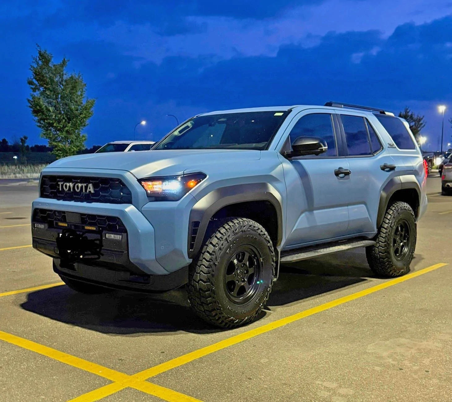

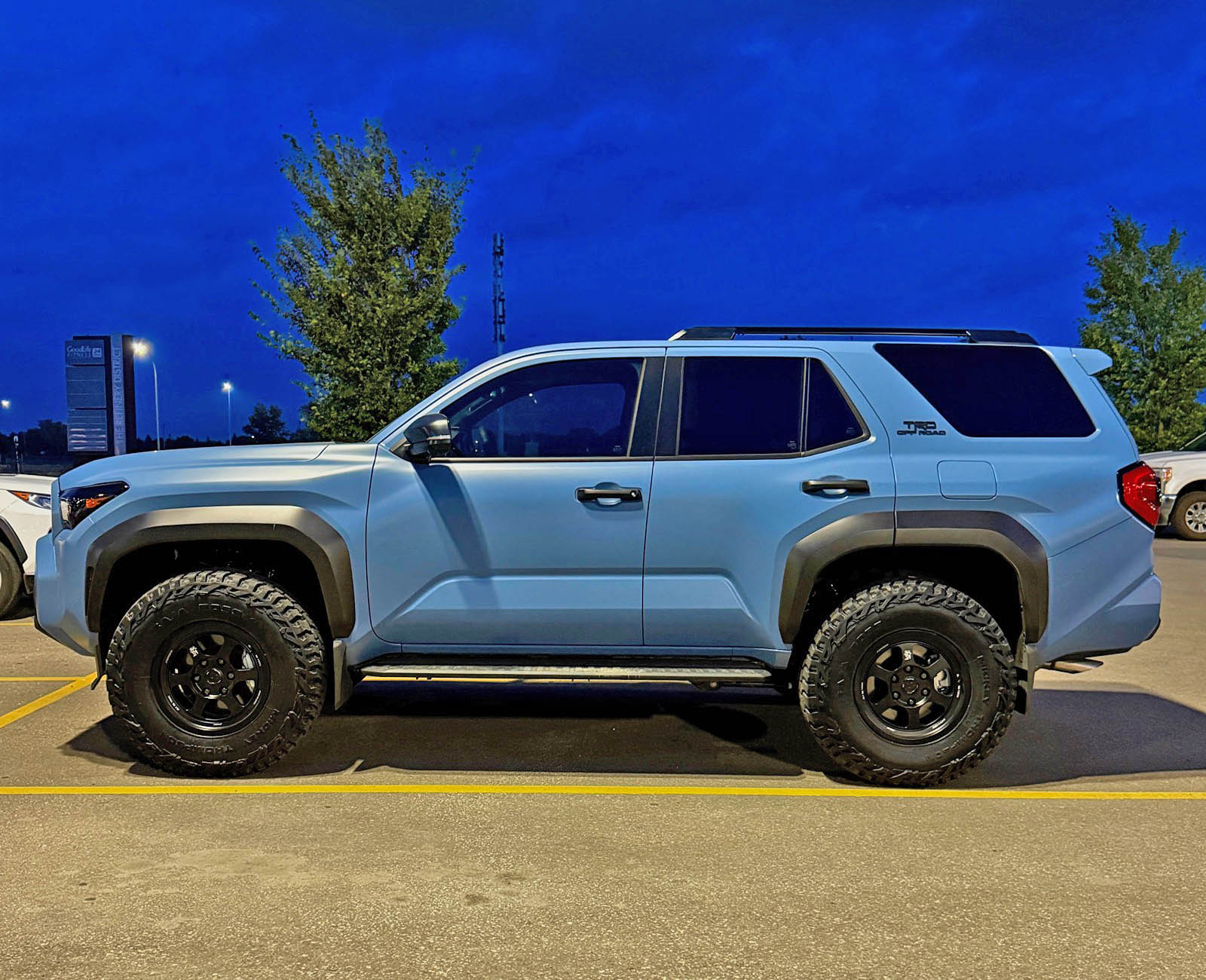

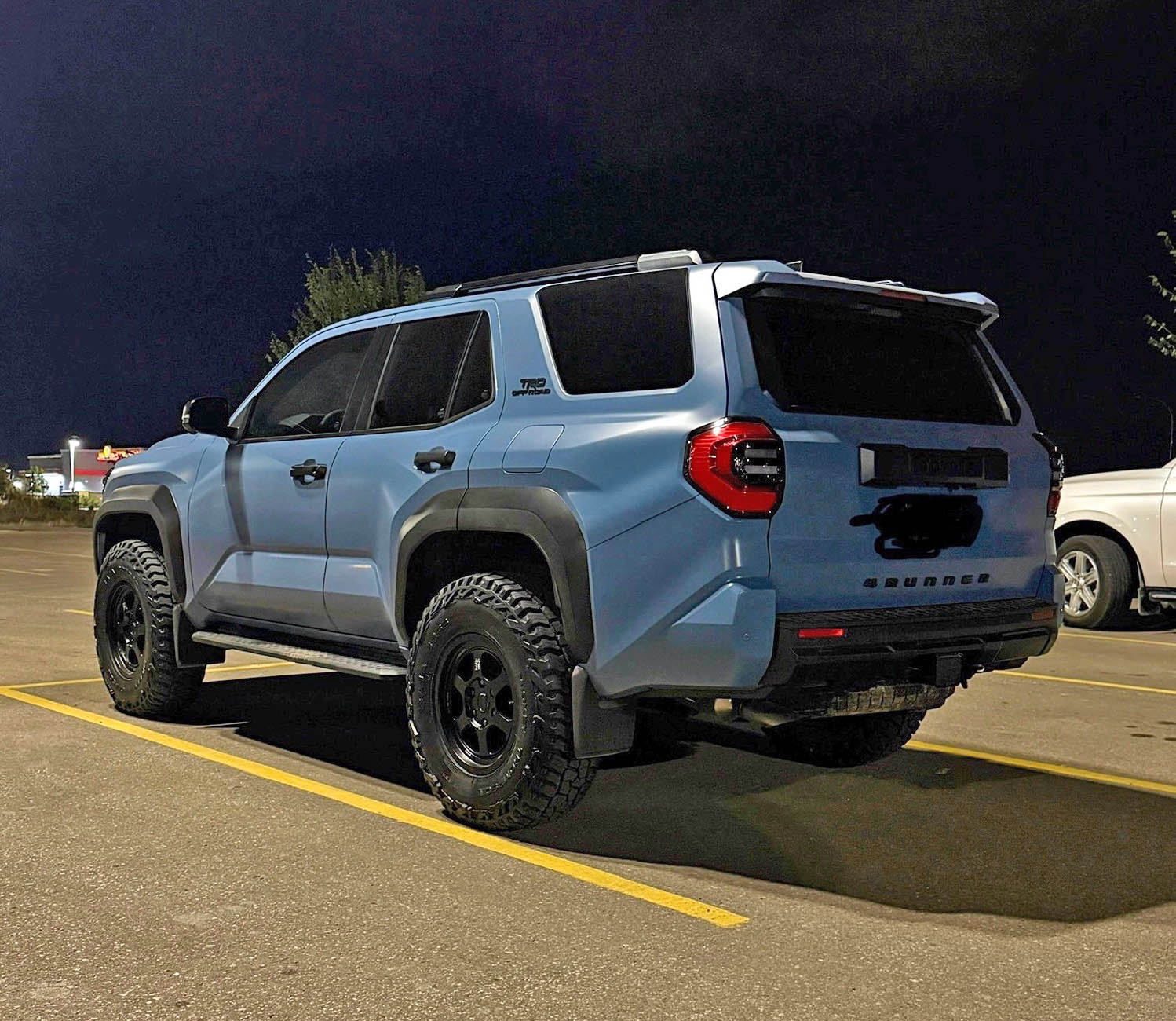

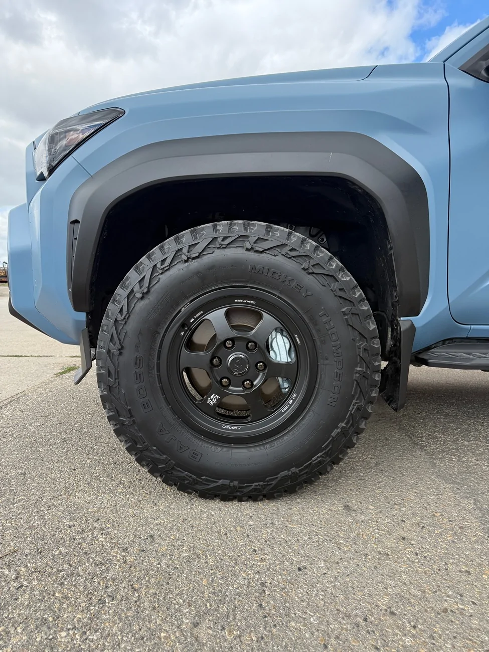

Installed the tires and rims, slight rub on mudguards. Getting alignment tomorrow.
Running 255/85/17 Mickey Thompson Baja Boss R/T
34.5” x 9.9”
Only had to trim mud flaps to fit. Caster 3.1 degrees
34.5” x 9.9”

Looks awesome! I'm also in Winnipeg (Blue ORP). I asked about some tire details in another post but curious if the no rubbing (small trim to rear) was with your lift you have now or before?
lovely! I think I’ve seen you on the roads or my wife has at least. Seems there’s a few of us.
I got rubbing, on the flaps only, even with the lift. Without the lift would have been the same. As I understand, rubbing has more to do with offset and tire dimensions than it has to do with lift. Hope this helps

Sick build man! I'm also from Winnipeg with a 6th gen trd orp blue. It's all stock right now and it handled pretty well from yesterday's storm. I wonder how did the baja boss' handle? Looking to upgrade in the future.
Terrific, drove down the perimetere in crosswinds and it was fine. We've also been ice fishing on it with 2 feet of snow and its been great. I will say if your priority is winter grip, there are definitely better options in the Nokian Hakkapellitas LT3s!

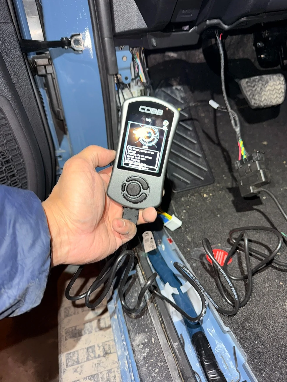

Hey all! Some quick updates
I went with @CAMTuning with a Cobb Tuning Accessport. Cam was kind enough to preload the tune file so I could get it going as soon as I picked it up. A full review to be done later
2025 2026 4runner 6th gen 🇨🇦 Ice Fishing Build - Dual Swing-Outs/35”/Winch IMG_5823
Figure 1. Removing the kick panel to bypass the CANbus to install the tune.
2025 2026 4runner 6th gen 🇨🇦 Ice Fishing Build - Dual Swing-Outs/35”/Winch IMG_5825
Figure 2. OBD connected and Accessport installed.
I attached a video of the car in sport mode for anyone interested.

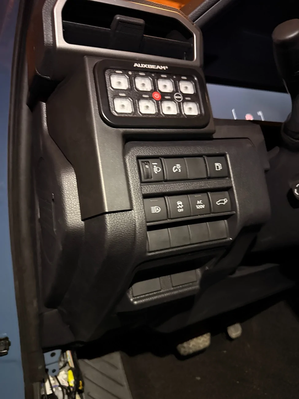

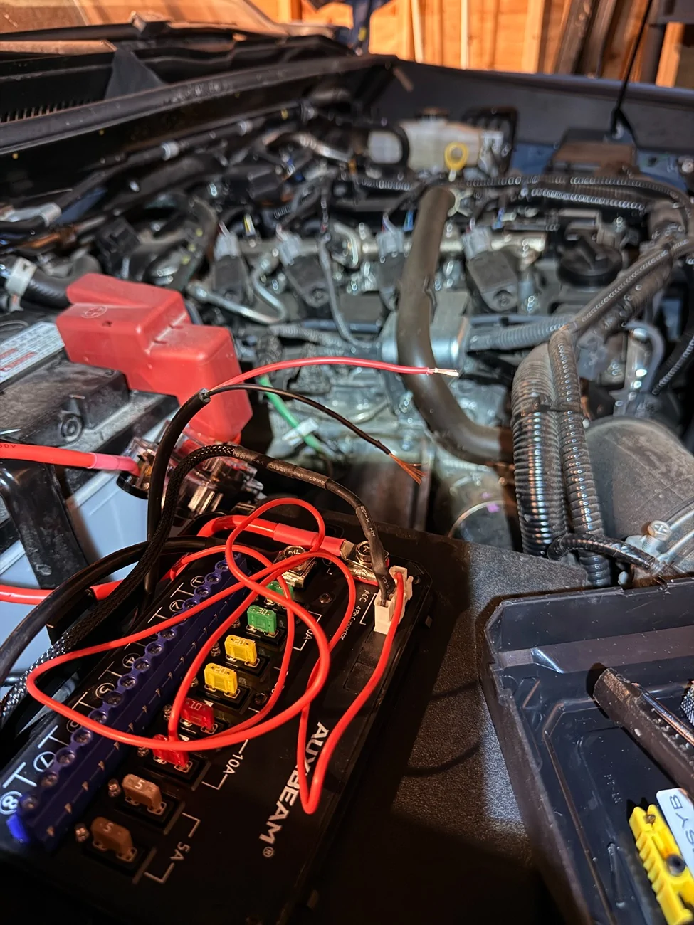

Next, installing the Auxbeam RA80 Switch Panel (Purchased through Amazon)
2025 2026 4runner 6th gen 🇨🇦 Ice Fishing Build - Dual Swing-Outs/35”/Winch IMG_5843
Figure 1. Auxbeam Switch Panel Box.

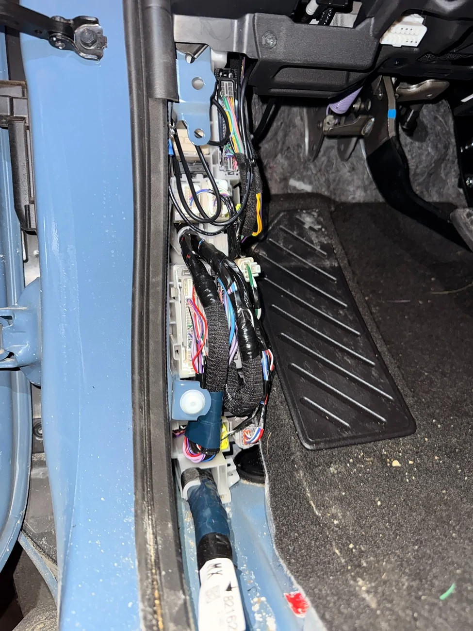

I have no experience whatsoever with electricity or working on my car. The install took about 2 hours with me taking my time and double-checking all my work.
2025 2026 4runner 6th gen 🇨🇦 Ice Fishing Build - Dual Swing-Outs/35”/Winch IMG_5829
Figure 2. Routing and connecting all the wires.
I opted to run the 10 feet long switch panel cable through the Driver's side firewall and ran it up behind the trim for a completely hidden install. I installed CaliRaisedLED's 2025 Auxbeam Switch Panel trim as well. It can be found by clicking here. Please note that I fixed the switch panel to the trim by using 2 small screws (1 on each side)that is supplied by Auxbeam.
2025 2026 4runner 6th gen 🇨🇦 Ice Fishing Build - Dual Swing-Outs/35”/Winch IMG_5824

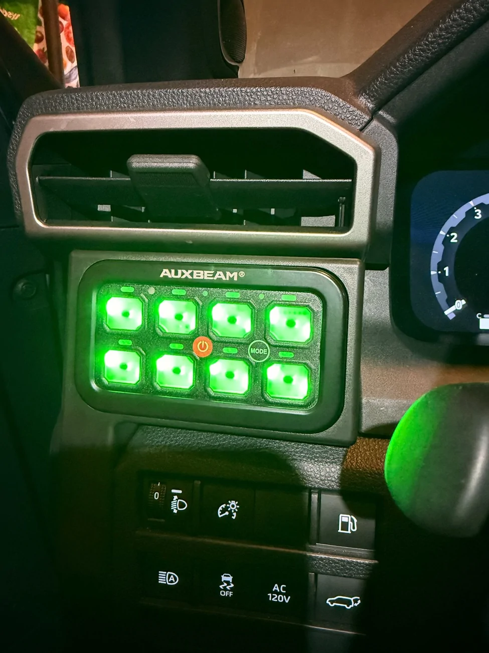

Figure 3. Installed @Cali Raised LED Switch Panel Trim and Auxbeam RA80 controller.
2025 2026 4runner 6th gen 🇨🇦 Ice Fishing Build - Dual Swing-Outs/35”/Winch IMG_5832

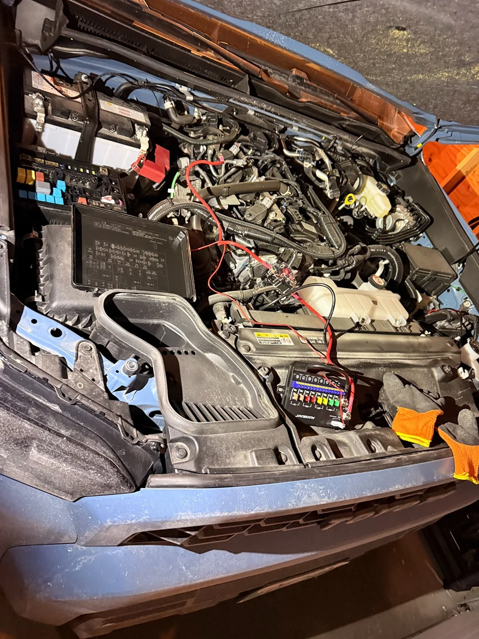

Figure 4. Power connected!
Please note that I fuse tapped into the 10A fuse (Passenger side) "ECU IGP No.2." The fuse taps provided by Auxbeam are not compatible with the OEM fuses, so I was stumped. But if you flip over the Auxbeam Fuse and Relay Box Lid, you'll find spare fuses. I took the 10A spare fuse and placed it into the tap to complete. No CEL or warnings displayed!

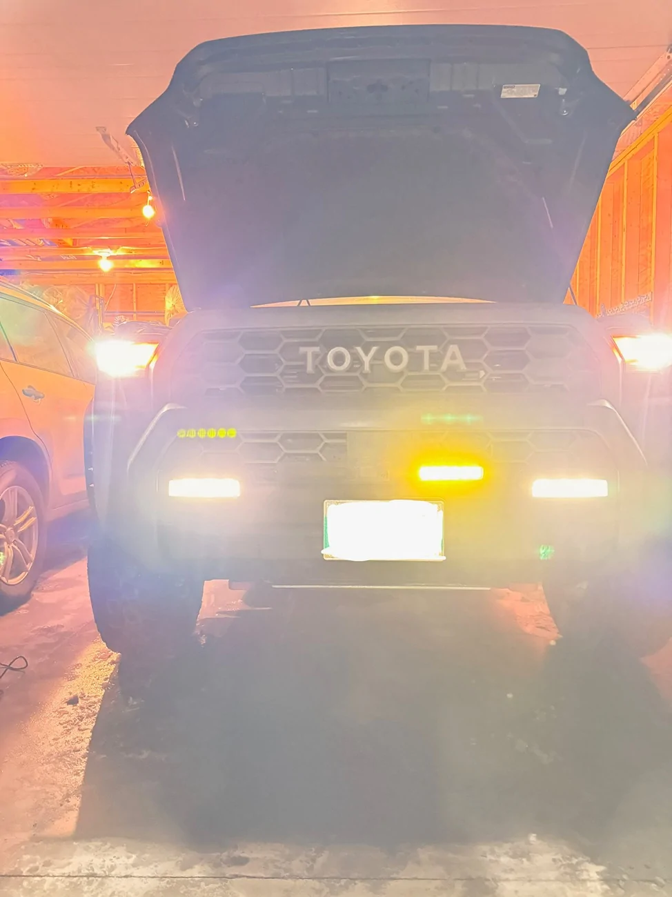

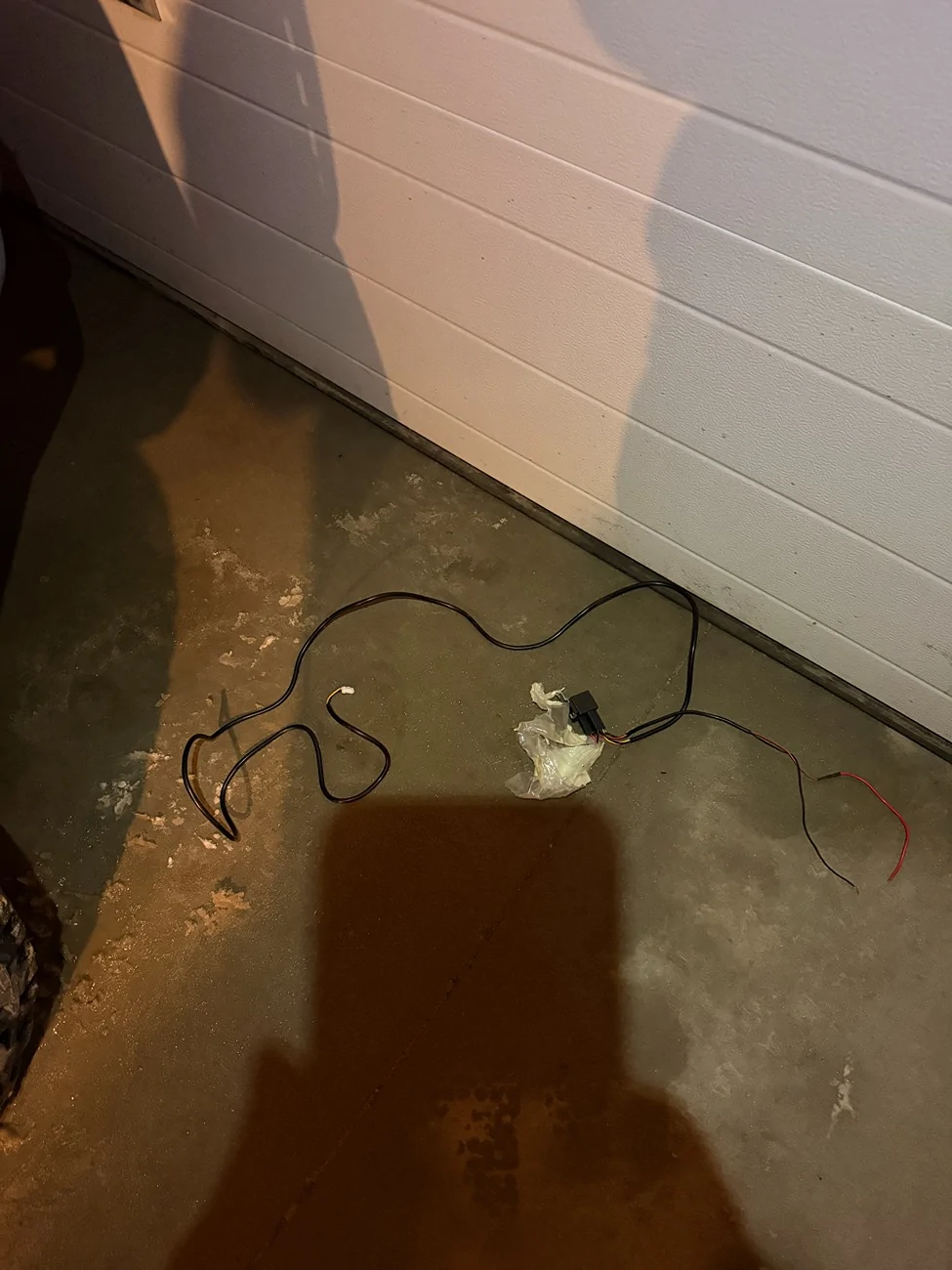

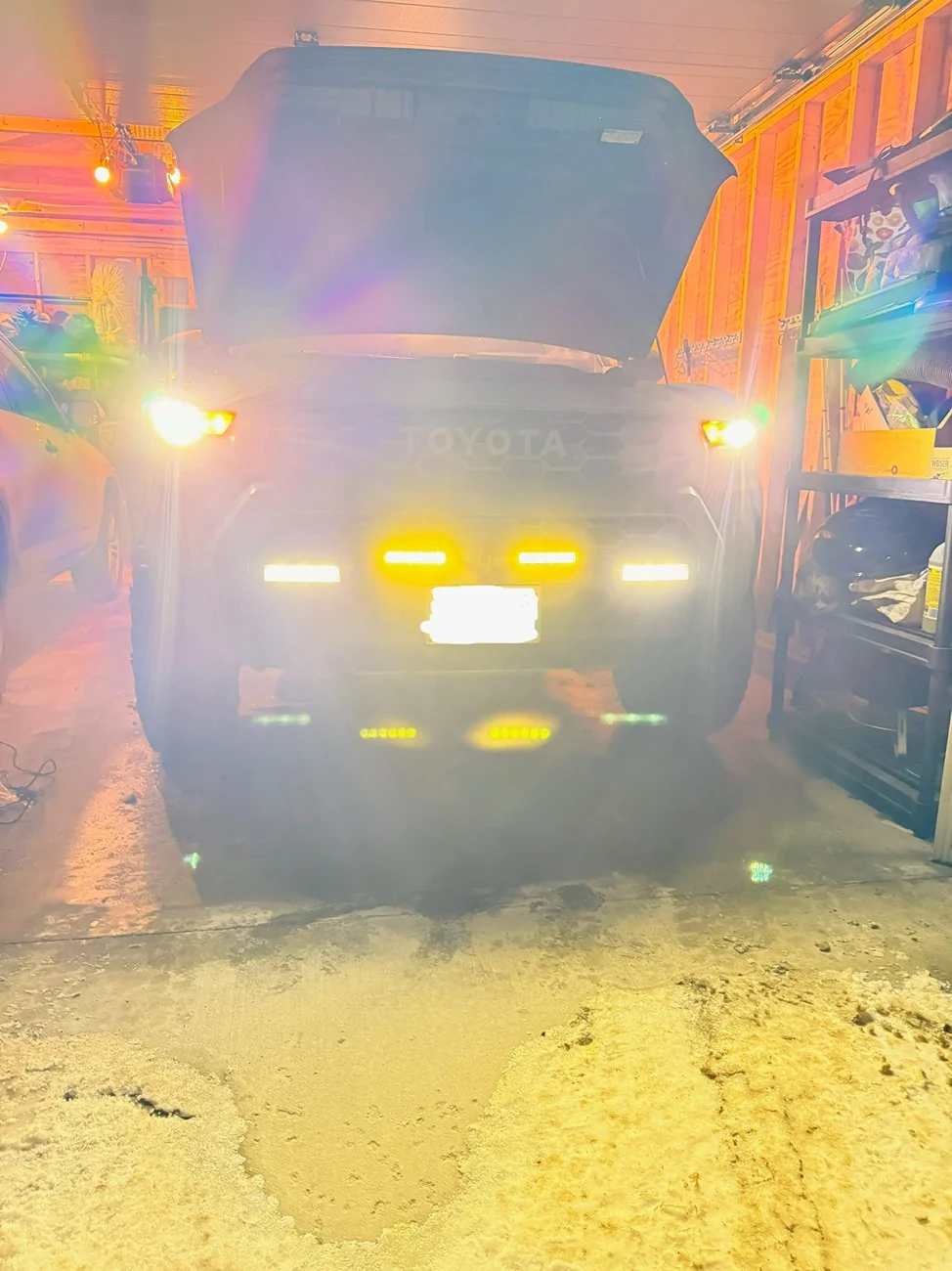

Installed amber fog lights that came with the aftermarket grille.
2025 2026 4runner 6th gen 🇨🇦 Ice Fishing Build - Dual Swing-Outs/35”/Winch IMG_5839
Figure 1. Cut off the relay and harness, leaving just the positive and negative wires that supply the fog lights.
2025 2026 4runner 6th gen 🇨🇦 Ice Fishing Build - Dual Swing-Outs/35”/Winch IMG_5838
Figure 2. Stripped the positive and negative wires and connected them to the 10 amp fuse (slot 5) of the Auxbeam.
2025 2026 4runner 6th gen 🇨🇦 Ice Fishing Build - Dual Swing-Outs/35”/Winch RenderedImag
Figure 3. Only the driver side turned on. I checked the connection and the culprit was a flipped connector.
Figure 4. First time ever wiring lights!

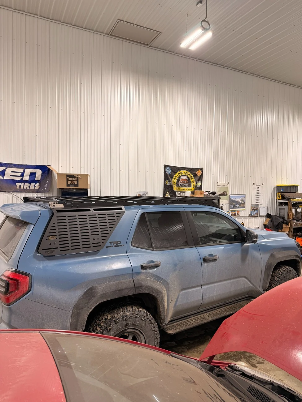

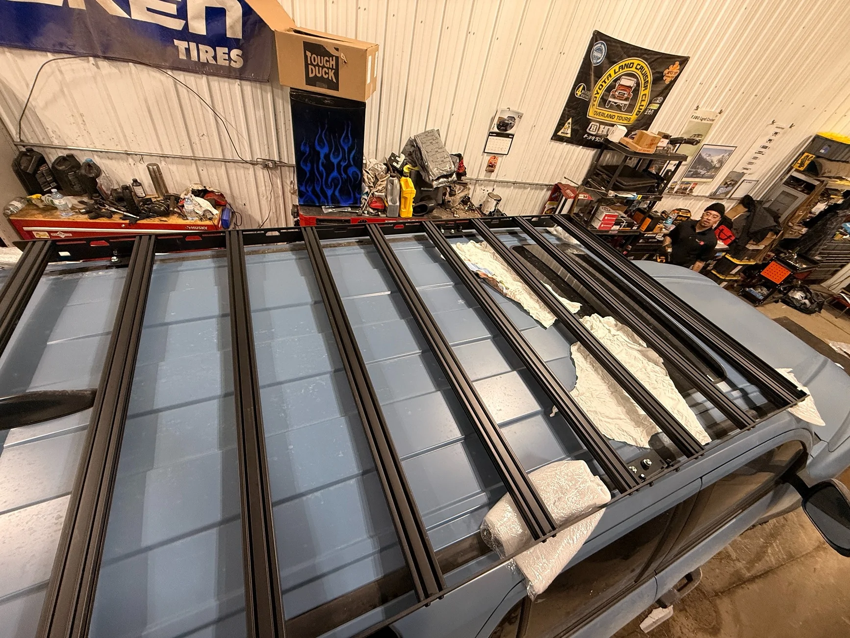

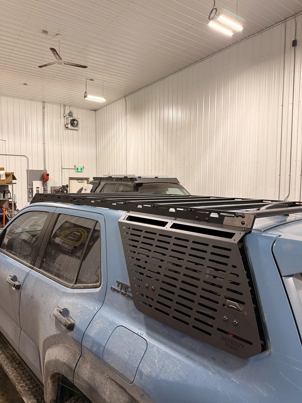

Next up, Westcott Design's Low Profile Roof Rack + Molle Panels installation. This was quick as I had Kevin at CKAutoFab in Winnipeg install it.
2025 2026 4runner 6th gen 🇨🇦 Ice Fishing Build - Dual Swing-Outs/35”/Winch IMG_5730
2025 2026 4runner 6th gen 🇨🇦 Ice Fishing Build - Dual Swing-Outs/35”/Winch IMG_5727
2025 2026 4runner 6th gen 🇨🇦 Ice Fishing Build - Dual Swing-Outs/35”/Winch IMG_5762
2025 2026 4runner 6th gen 🇨🇦 Ice Fishing Build - Dual Swing-Outs/35”/Winch IMG_5764

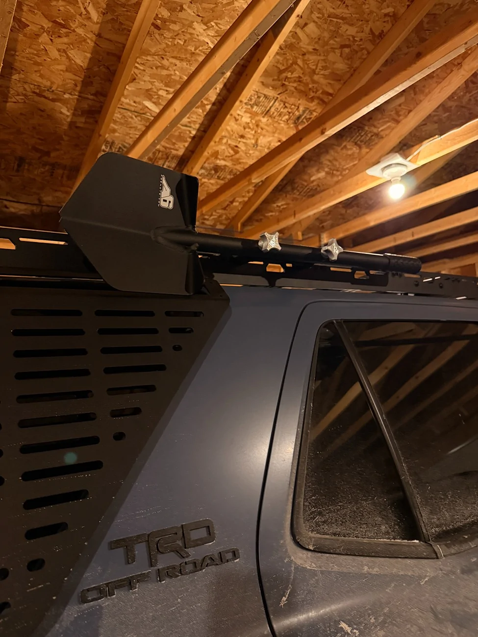

Agency6 shovel and grab handles. I'm going to need to find better security bolts
2025 2026 4runner 6th gen 🇨🇦 Ice Fishing Build - Dual Swing-Outs/35”/Winch IMG_5791
2025 2026 4runner 6th gen 🇨🇦 Ice Fishing Build - Dual Swing-Outs/35”/Winch IMG_5790

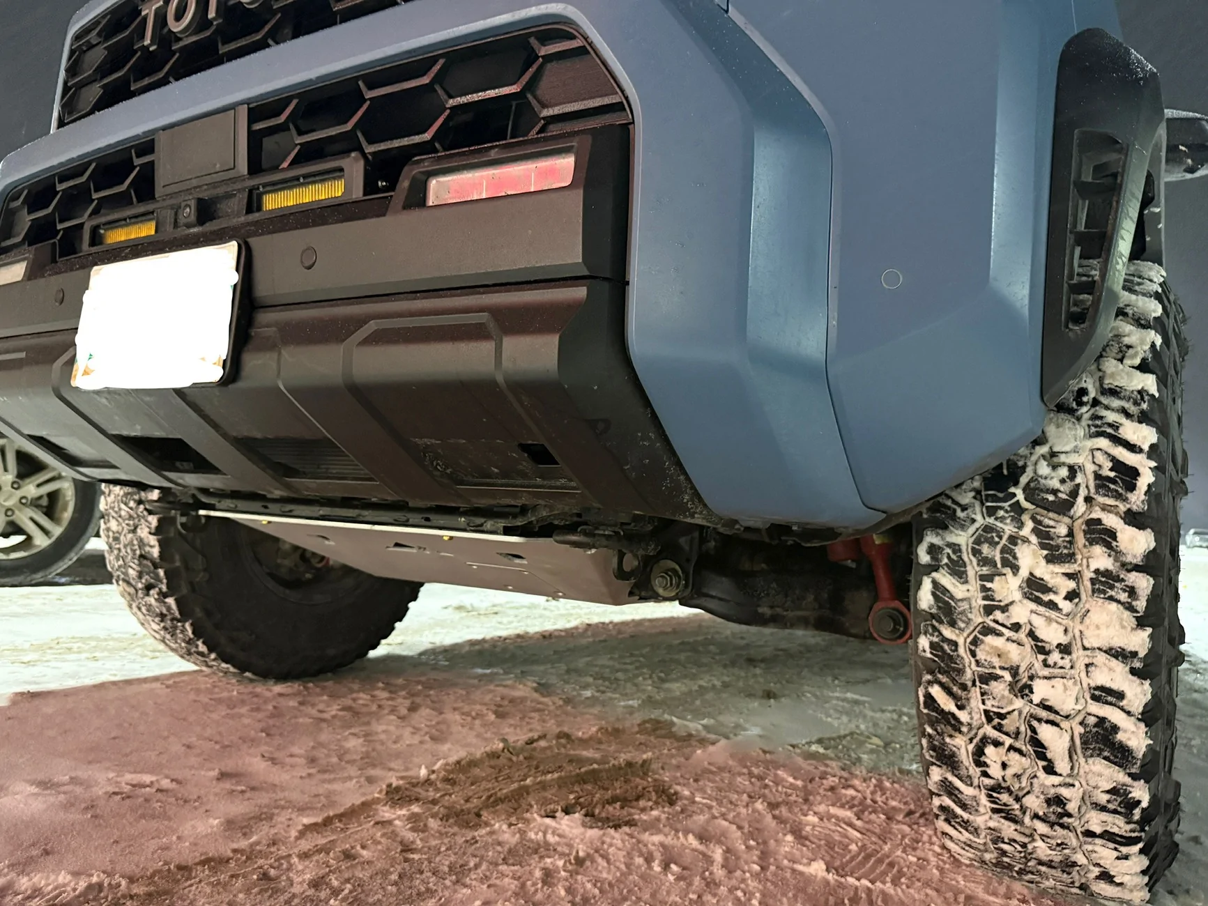

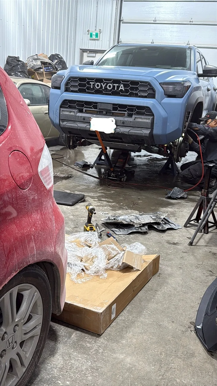

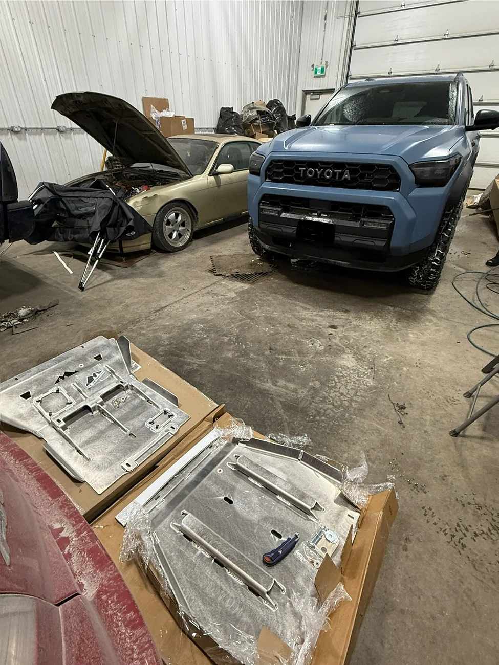

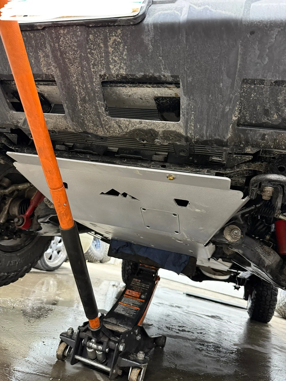

Woolwax installaton and OkExpedition's Skid Plate. You can find it by clicking here. I picked this because it allowed for easy oil change (removeable panel for filter and oil drain plug) and I also did not have to deal with shipping from the USA.
2025 2026 4runner 6th gen 🇨🇦 Ice Fishing Build - Dual Swing-Outs/35”/Winch IMG_1761
Figure 1. OkExpedition Skid Plate.
Figure 2. Woolwax treatment to the entirety of the underside and wheel wells.
Figure 3. Skid Plates Installed.
Figure 4. Air Dam Removal for winter.
Twomstone
Connor
Jan 28, 2025
Manitoba - Canada
2025 TRD ORP Heritage Blue
Nice updates! I'm between Greenlane off-road and OK Expedition for skids. Might go Greenlane as I want a low-pro winch bumper too and rock rails so might try and get a discount if I buy all 3.
Was the thoughts for woolwax just the rough winters we have here for corrosion? How much was it?
