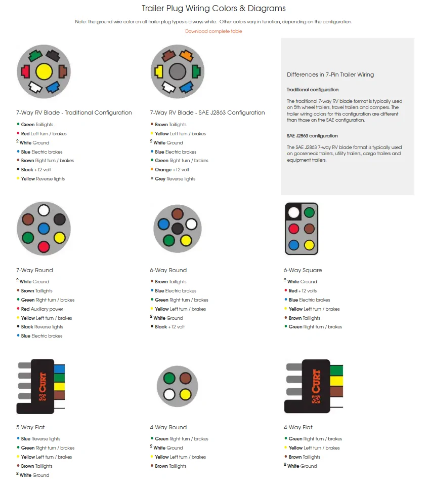

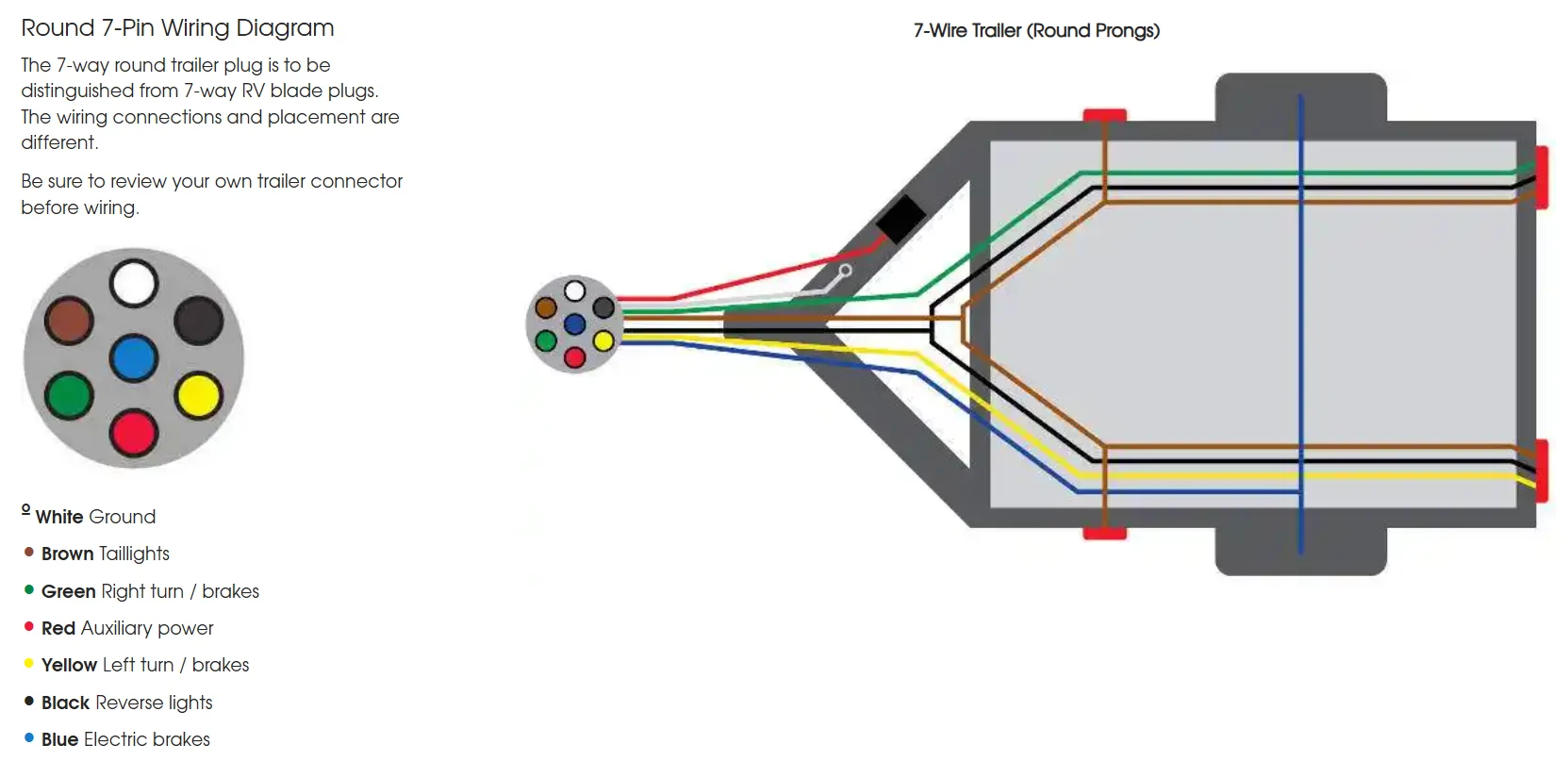

Hmm.... I used a very old round connector last week and it worked. I thought those things were all standard and we have the two main standard variants available on the 6G4R (7 pin SAE Round and 4 pin flat/straight - I think). I think there might be a 6 pin round variant out there and maybe that is what you have.
I know I had some trouble finding the proper rotational orientation - the connector is keyed as you would expect and I struggled to find the key slot. Seems unlikely but maybe that is the issue for you?
2,372
1,348
um toyota has been using 7pin connectors for a long time not just on the 4runner.
my 2014 had a 7pin requirement per the owners manual.

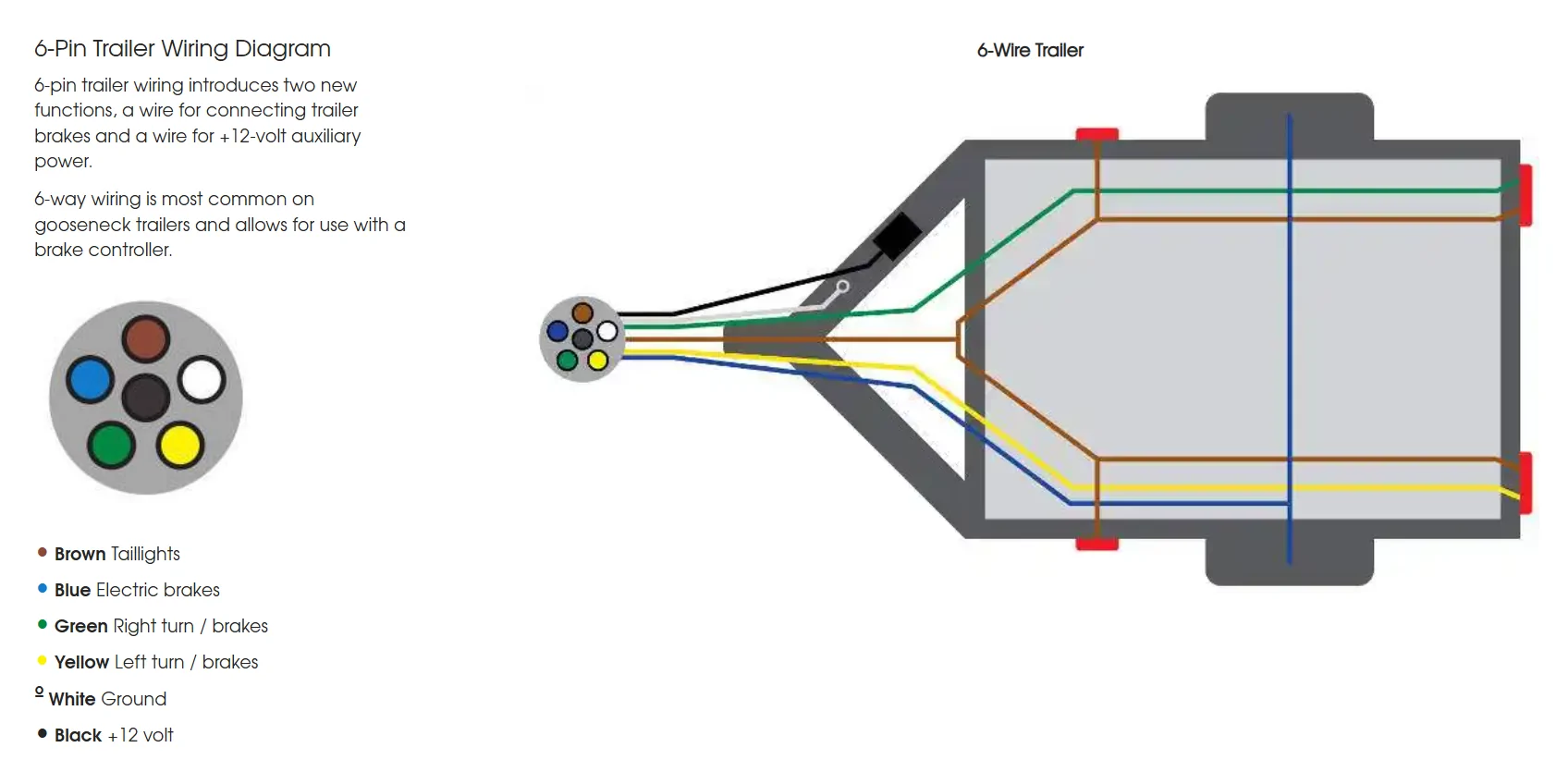

only reason to have a 6 pin is if you are using old agriculture equipment if i remember correctly like horse trailers or old goose necks.
i mean the hitch connectors can get confusing really quick

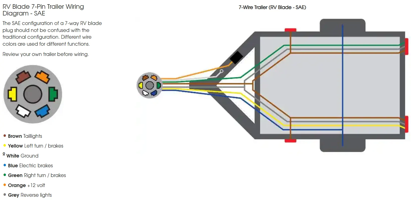

good example is the RV 7pin, its one way on the blade version and different on the round version
