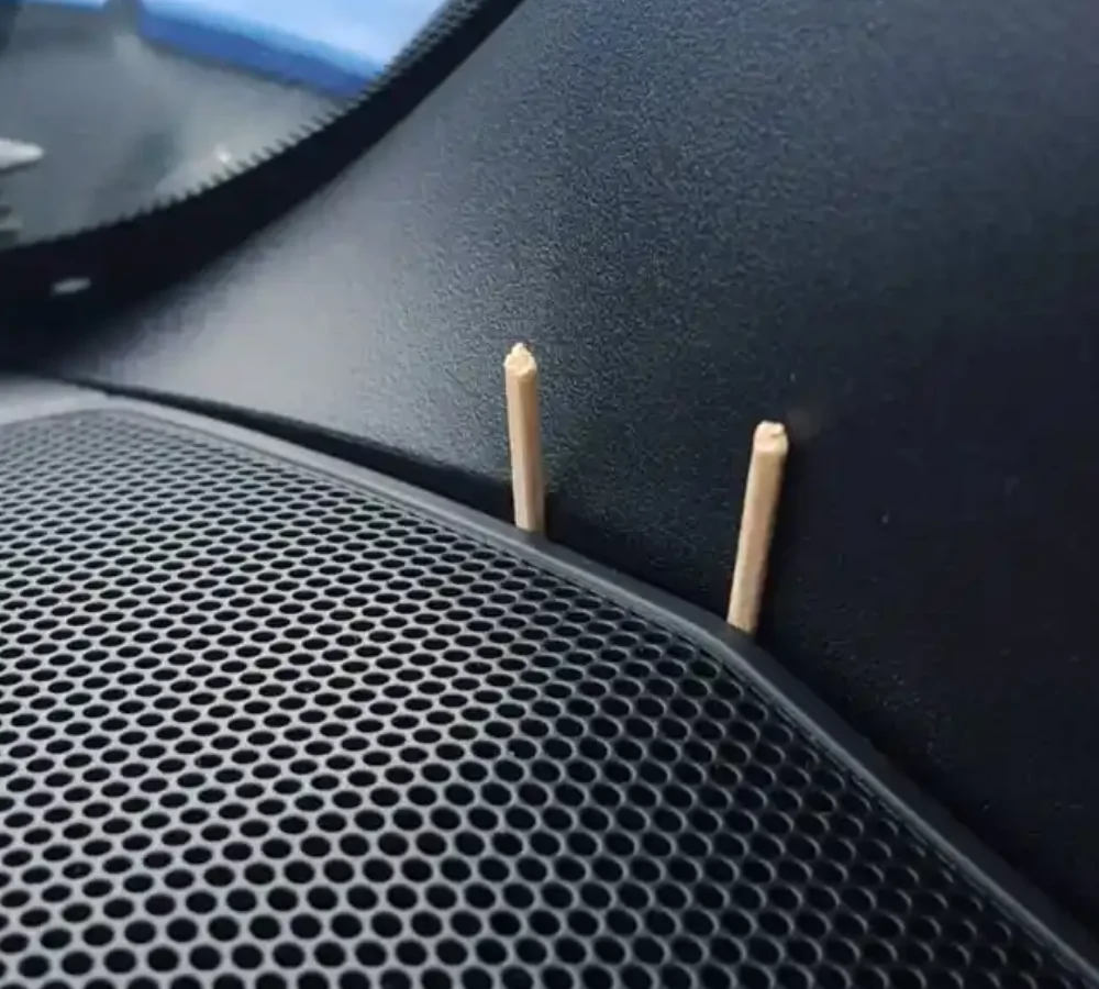

from my sleuthing days on our 2016 taco, eventually replaced the toothpicks with felt between the A pillar and speaker cover to get rid of the plastics from rubbing and causing them to squeak.
