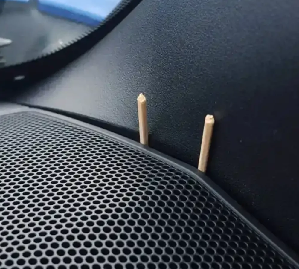

most likely a clip under the dash, or most likely a plastic panel is rubbing.
had this happen on our 2016 taco, the speaker cover was rubbing in the corner.
funny pic of me putting some toothpicks in the corner to isolate the sound and fixing the issue.
eventually added some rubber felt along the base to give the 2 plastics and easy way to flex without making noise
