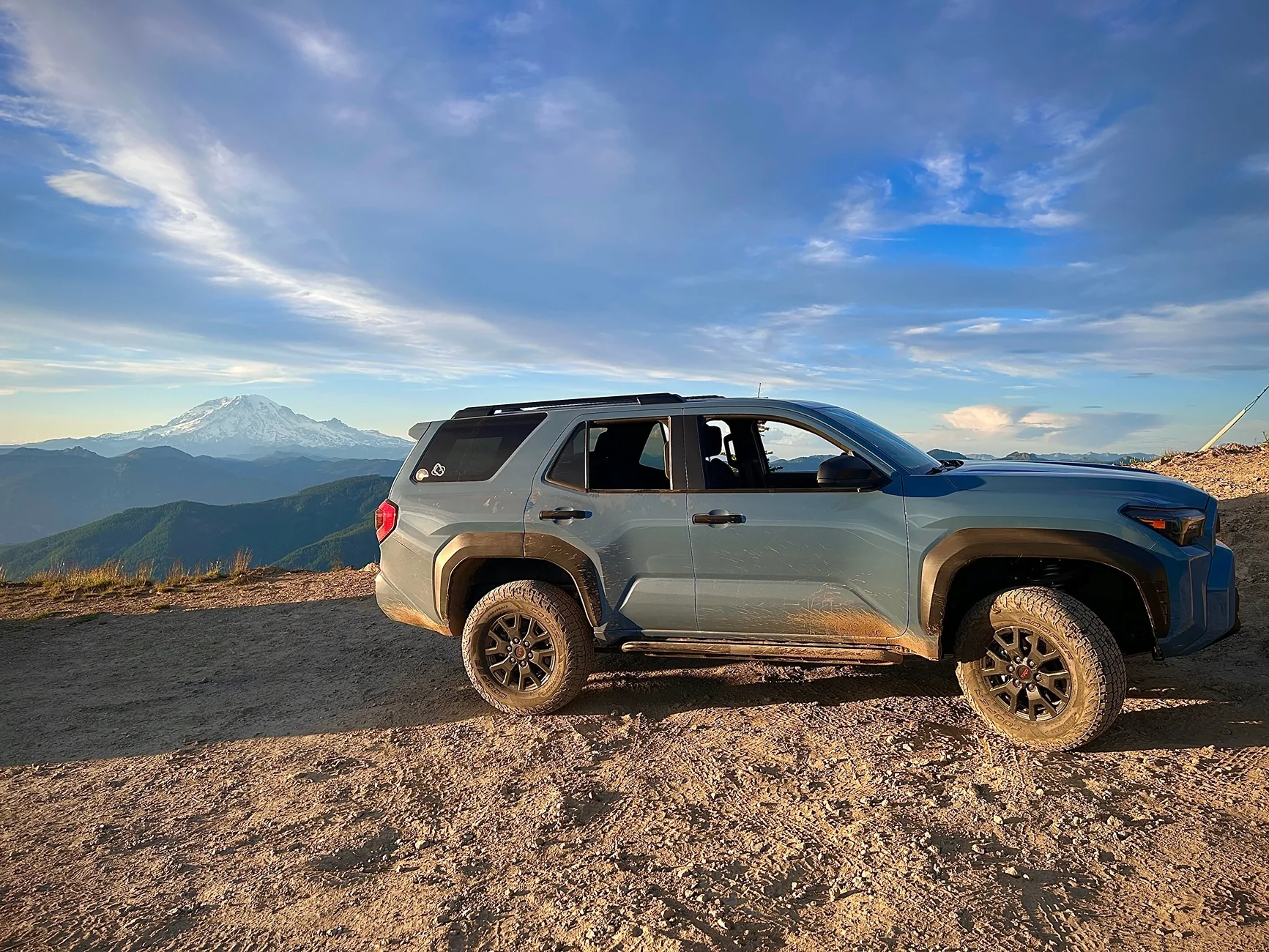

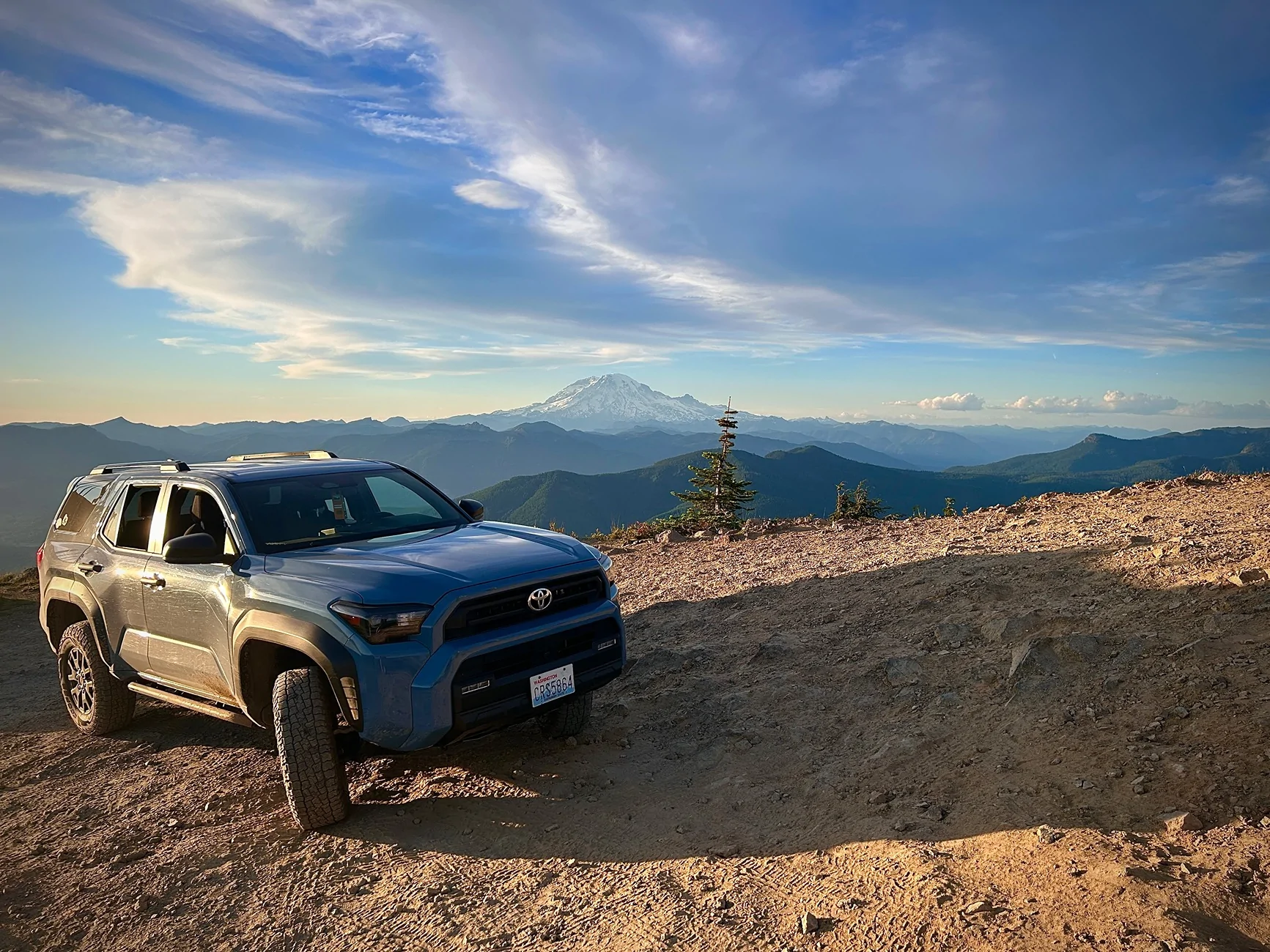

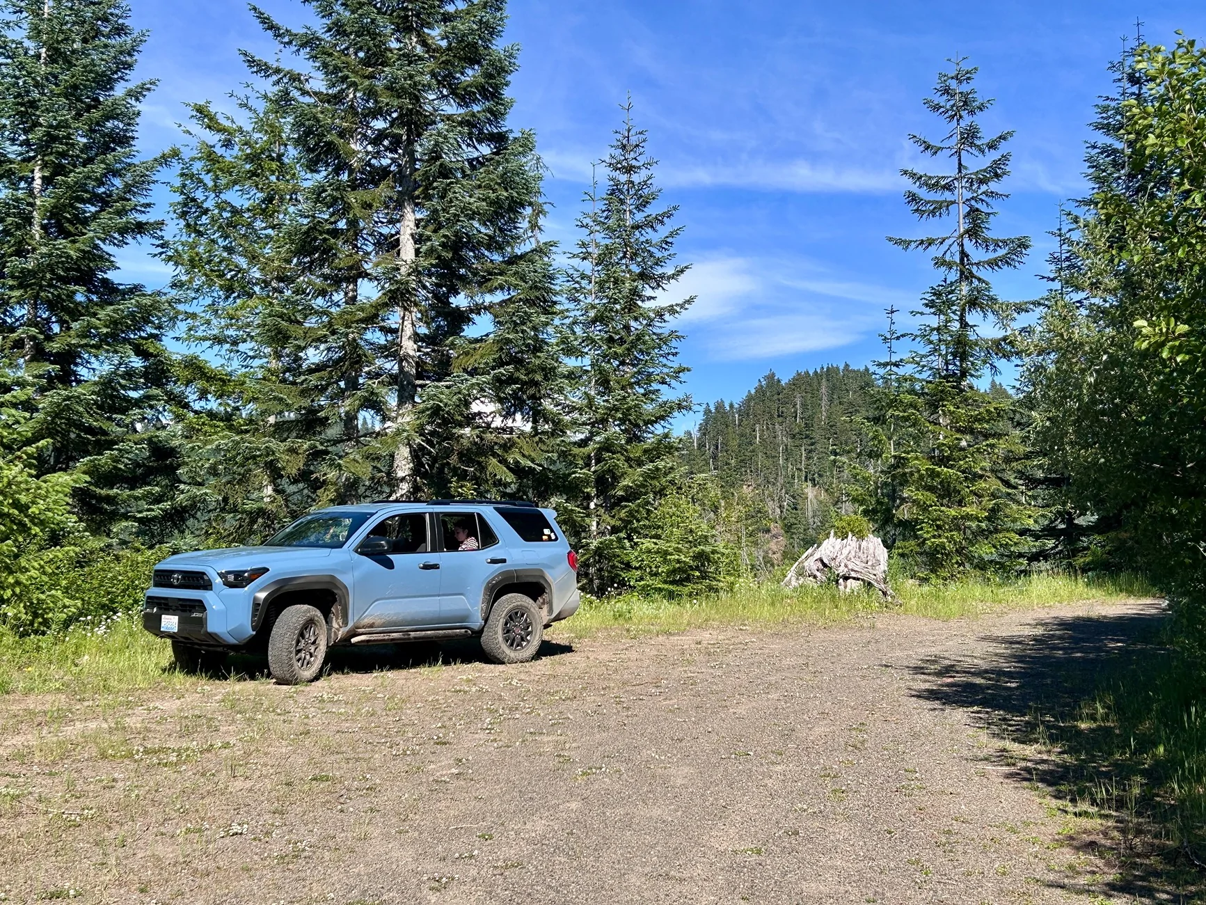

The 2025 Heritage Blue SR5 that I picked up back in March of 2025 crossed over the 15,000 mile mark this week while I was camping. At the time I bought it, there was a fairly large difference in price between the SR5 trim and the next one up which was the TRD Sport- roughly $12k. I decided to see if I could make an upgraded SR5 using (cheapish) parts from higher trims and high quality aftermarket parts. The first addition was a new set of tires and picking up a spare wheel so I could have a full size spare. The wheel was $199 and I picked up a used tire for $80. I chose Cooper Discoverer Road+ Trail in a modest 255/75 at $235 each. No complaints on the tires whatsoever, they have handled everything from rain to moderate trails perfectly. Looking back I probably should’ve went one size up.
Taking advantage of a Toyota sale gained me front and transmission skid plates for the TH trim at $650. I then picked up the matching rock rails as take offs from a local guy building out his Trailhunter for $440. I tackled the suspension early this spring adding Fox 2.0 rear shocks and Radflo 2.0 sport adjustable front coilovers. This was the biggest expense at $400 and $1150 respectively. Obviously the biggest factor in all these upgrades was being able to do my own labor, which kept the costs low. The remaining upgrades were cosmetic, TRD shifter ($100), TRD center caps ($60) and front window tint ($170). The last thing I swapped in was a TRD air filter that I got on sale for $40. All in I didn’t spend close to the amount that I would have on the next trim level, but that was also knowing going in that I would likely not needing some of the features of the higher trim for what I do.
