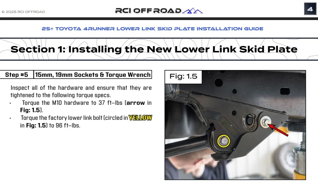

Does anyone know if there is a downloadable list or a printed book that we can get that spells out the various torque specs for the various bolts on the undercarriage and/or engine?
I am going to install my RCI skid plate armor and the front lower links bolts need to be loosen to add the skids, and then retightened. I cannot find a list for that torque. Then I figured it would be a good idea to have all torque specs in one place either in a list or book.
Thanks for any help.

WTFBBQ!!! I downloaded all their manuals when I ordered them a few weeks ago and they are totally different than this one. Looks like they updated them all since I got them. Looks like the ones I got were the same as the Land Cruiser that did NOT have any torque specs.
Thanks for the file and now I know that they have updated them.

This forum has everything but sometimes you need to remember it exists and use Google to find it because the search function on the forum is too literal. I googled "4runner6g list of torque specifications" and shazam: suspension torque values/spec list
Its not everything you might need but its a start.
Chad from All Dogs who posted that thread is a straight shooter and an active member of the forum.

I had seen that list but the lower front link was not listed.
I am getting really tired of every company hiding specs behind paywalls. It would be easier to just do books and charge the same. I know paywalls are cheaper for them, and they make a LOT more money, but I don't want to pay monthly for something that I may need pretty much as long as I own this truck. I miss the old days of Chilton books.
EDIT - Some manuals, like the engine skids, are still the LC250 manuals.
I also installed the RCI Shock Mount skids and Lower Link Rear skids. No torque spec provided with either yet the instructions state, " **Use hand tools, impact wrenches may cause damage if over torqued. "
Their Lower Link Rear skid instructions are a mess. Hardware shown and provided does not align with the instruction steps. I contacted them 2+ weeks ago for clarification. So far nothing but crickets 🦗🦗🦗
Skids are solid.
