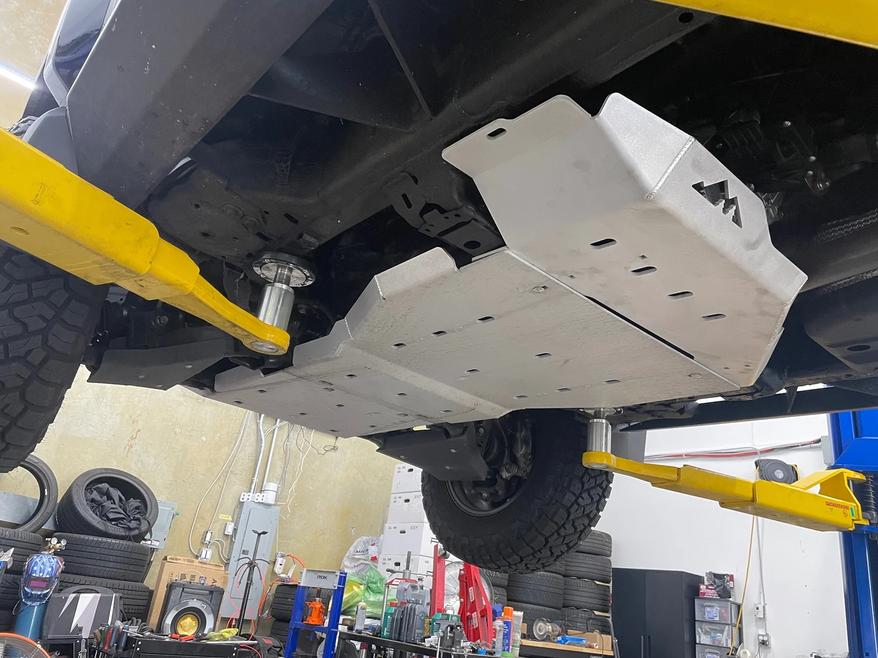

Jim,
If you go on snow covered trails to get to your destination. I would have full undercarriage protection. Engine, transmission and transfer skid plate. The factory TRD Pro skid plate isn't going to protect everything underneath. Those can be damage and leave you stranded, especially hidden rocks and tree stumps covered by the snow.

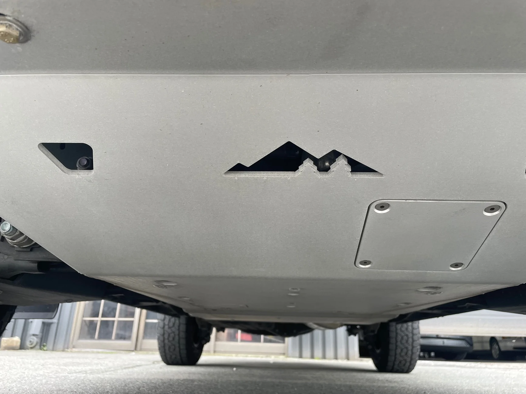

Thanks 4Everest & Pelo. I've done a fair amount of deep snow bashing in the backcountry with my old 4runner (3" lift/Ome shocks) and definitely will consider a full skid. Pelo, it looks like there's a small square cut out with four bolts for oil filter change? Is this a CBI plate? Lastly, without adding a pre-collar lift, AI says I can get a 285/70/R18 and that some owners have stuffed a 295/70/R18 on a stock TRD Pro. What sizes are you running?

Jim,
Yes, it's a panel for oil filter and drain access, without having to drop the entire plate. Not CBI plate, it's OK Expedition.
