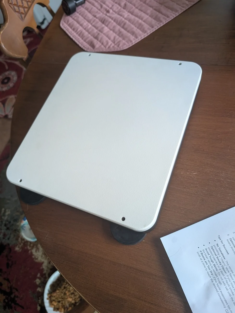

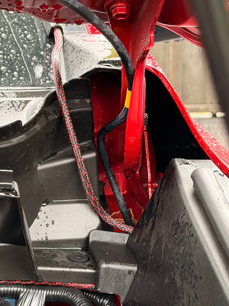

I'm using the starlink mini mounted in the veritas vans mount with the magnetic feet. I have a trail hunter and it fits exactly between two of the roof rails and can't be seen from the ground. The power cable I have running by the roof rack through the molding down to the power outlet in the back of the Trail Hunter. I do run it through a jackery battery so that when I stop to get gas the whole thing doesn't have to reboot. It works well, although on my trips I do take it off of pause and get the unlimited plan since we seem to go over the 100 gig constantly this from the non-stop live streaming from my passengers. This setup also lets me make phone calls and have internet and all those no cell phone areas but I travel through.

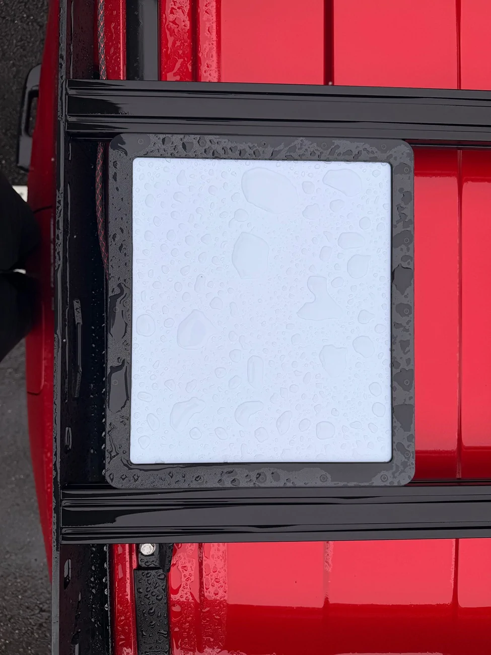

If you are referring to the Starlink mini? I use these mounts, mounted toward the rear of the my roof rack and run the cable through the rear hatch door. This method Is secure and is less likely to deter theft vs magnets.

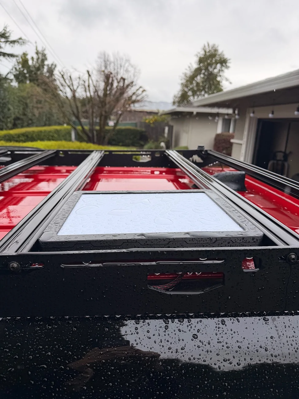

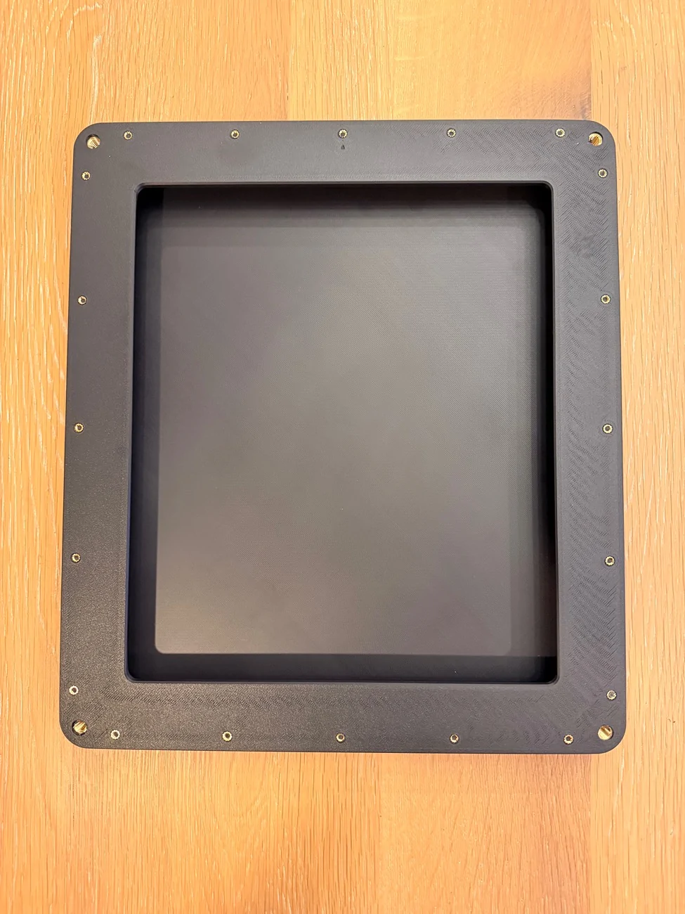

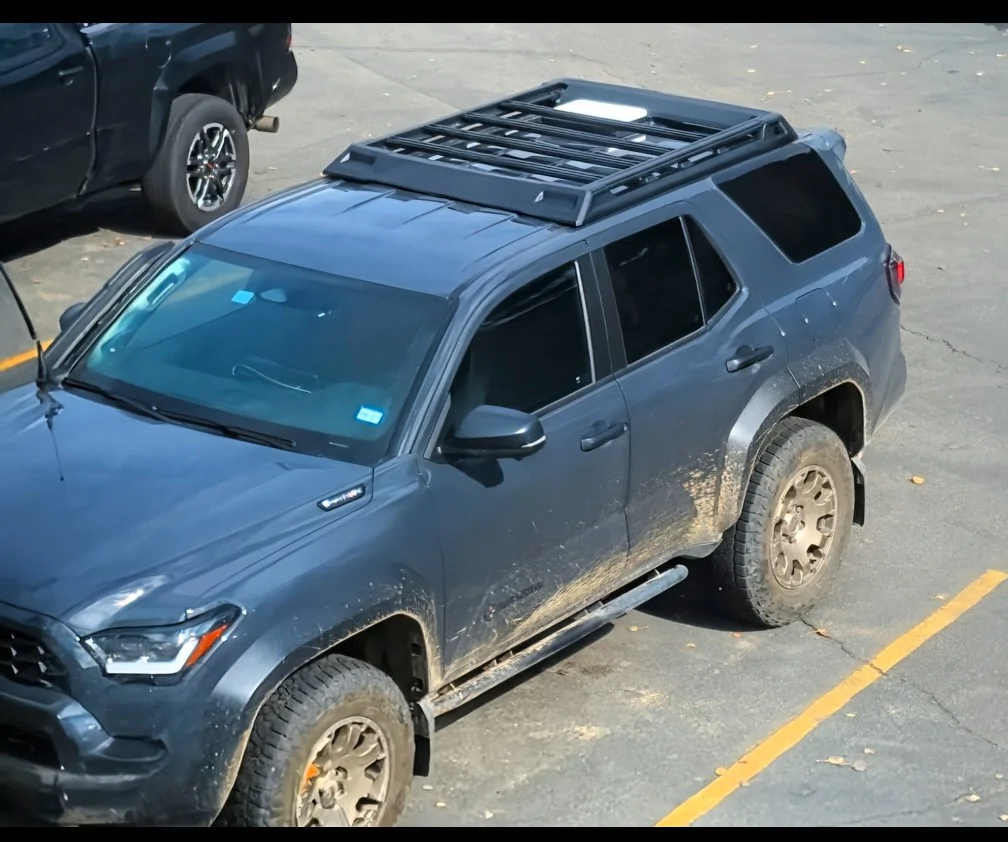

I have it mounted on the roof rack. Enclosure is custom made 3D printed. I designed it so it stays flush to the rack frames. It’s very inconspicuous unless you watch with attention. I’m experimenting with a new fully enclosed top design so it doesn’t shine all white. It has 1/4 threads in case I need to remove from the vehicle and use with rentals/turo, in which case I use suction cups similar to Veritas Vans or magnet mounts, depending on the vehicle roof shape/material. In my 4Runner I get power from a pre-wired aux in the front. The only annoying thing is it goes off when you switch off the vehicle. For my use case, it’s still ok. Hope this helps with your project
