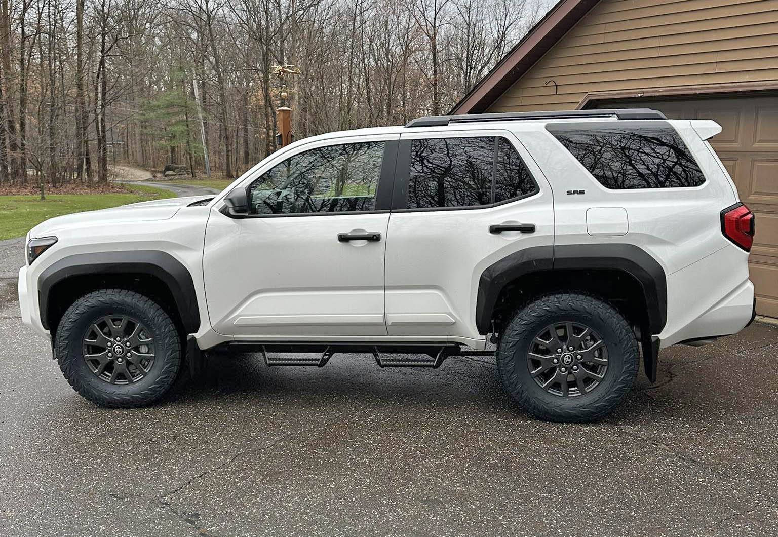

Agreed on looks. Your SR5 does look good.
Did you notice additional road noise?
Did the larger tires help reduce the impact of bumps and potholes?

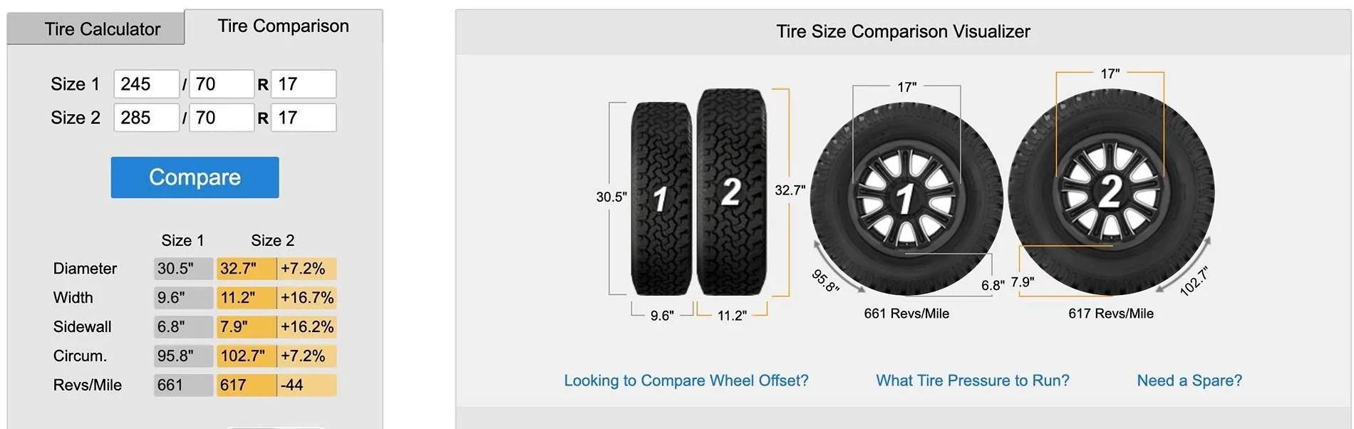

If going from a stock 245/70R17 to a 285/70R17 I am just increasing the width and not the sidewall size, right?
So, in theory, more tire, more air in larger space to absorb bumps and defects in road?
